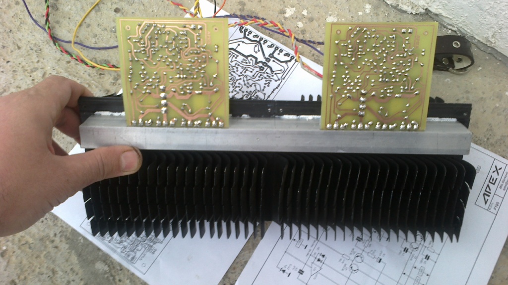

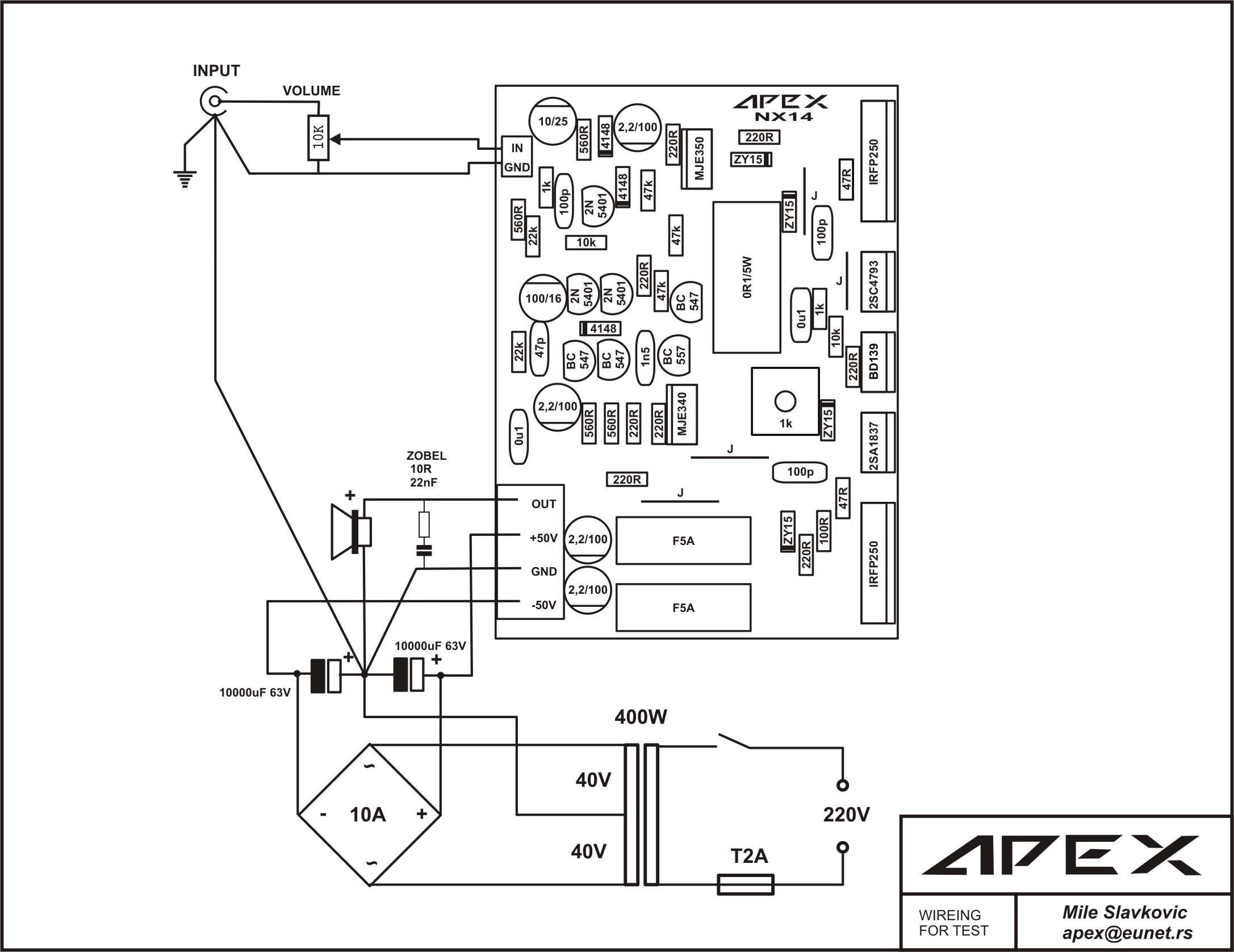

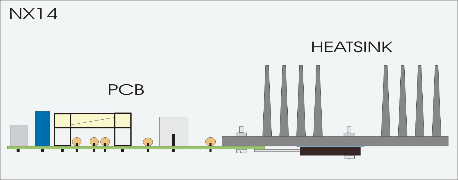

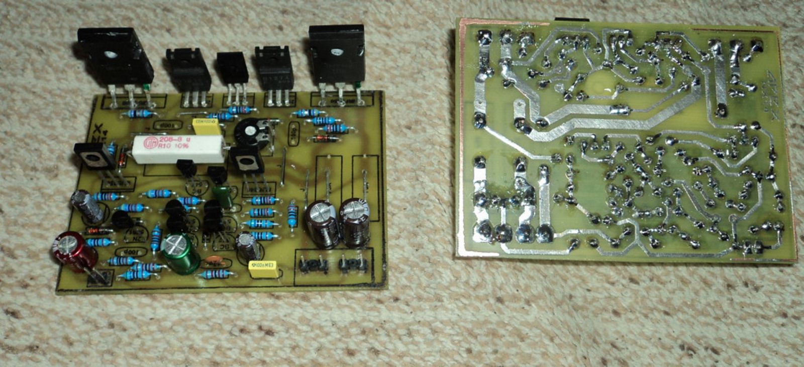

All NX14 files at one place:

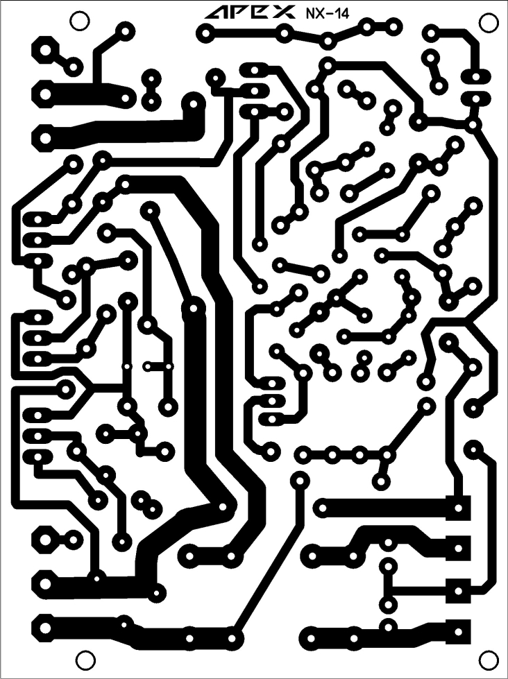

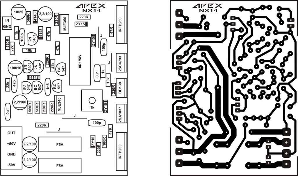

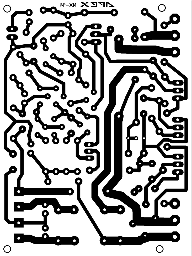

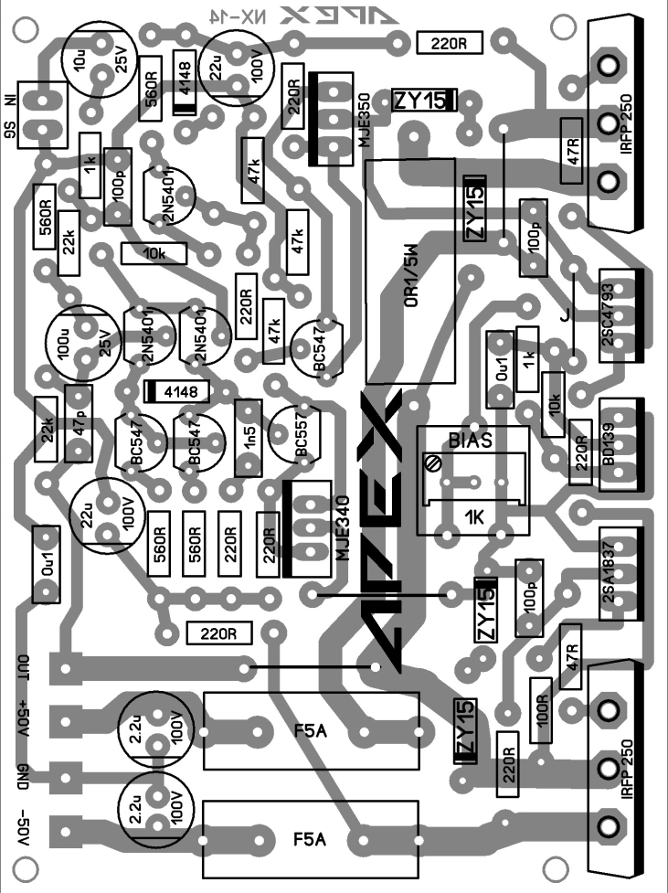

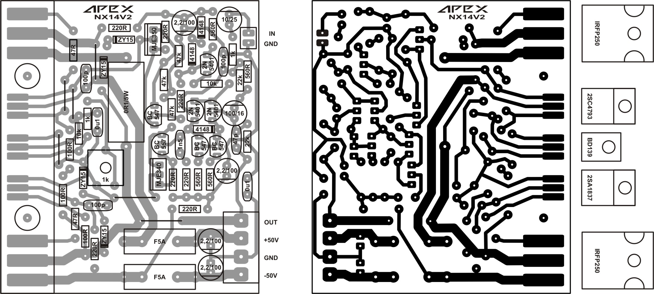

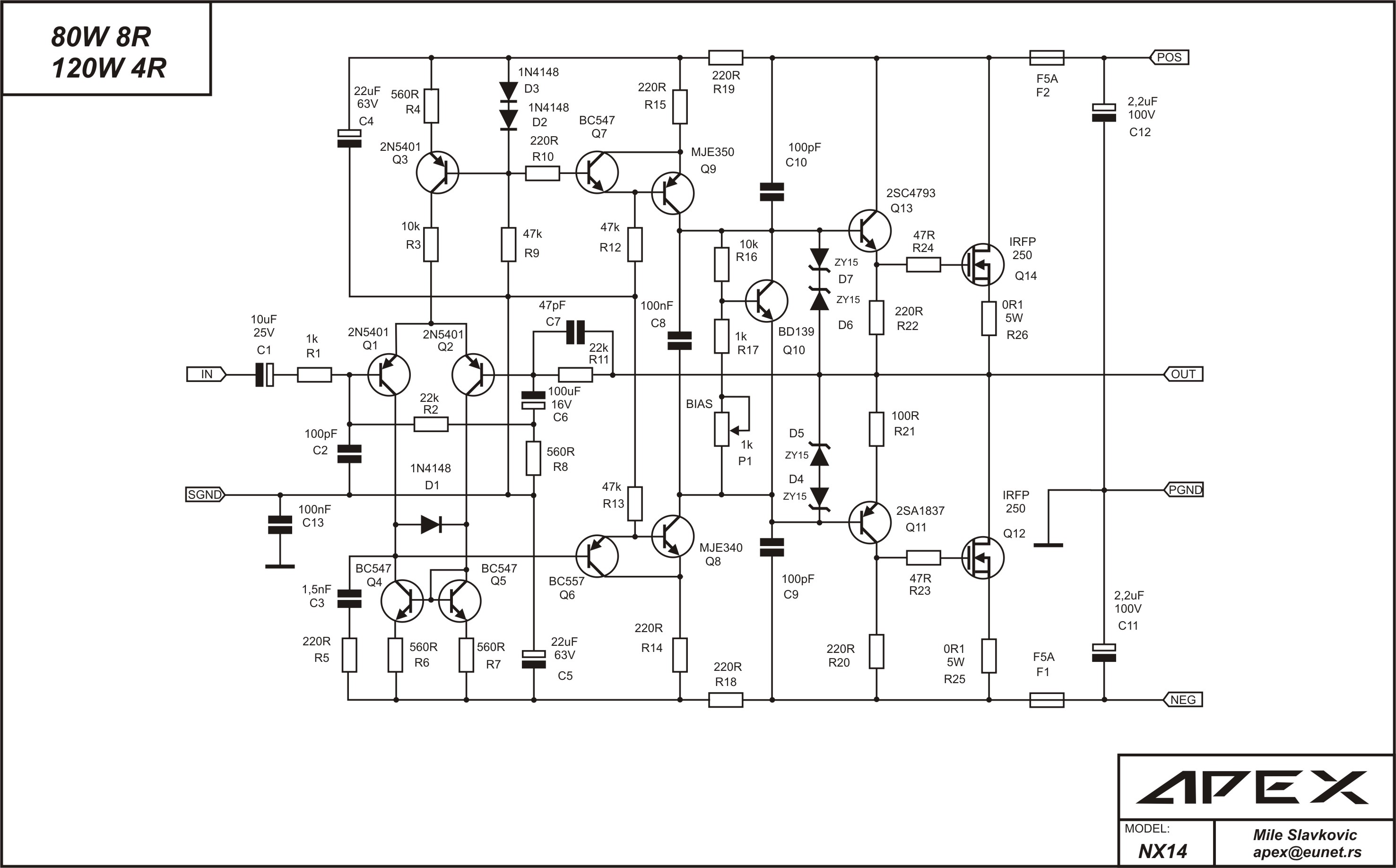

I forgot to place zener diode. Here is correct one in image and pdf format. AndrewT I made modification just to place multi-turn trimpot, can u verify this board.

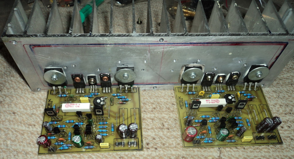

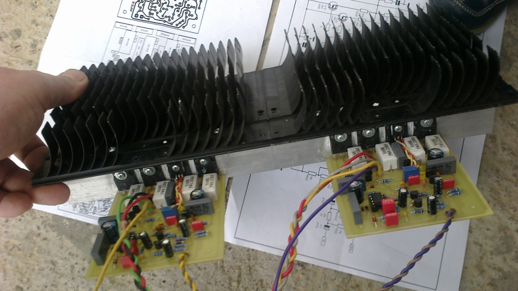

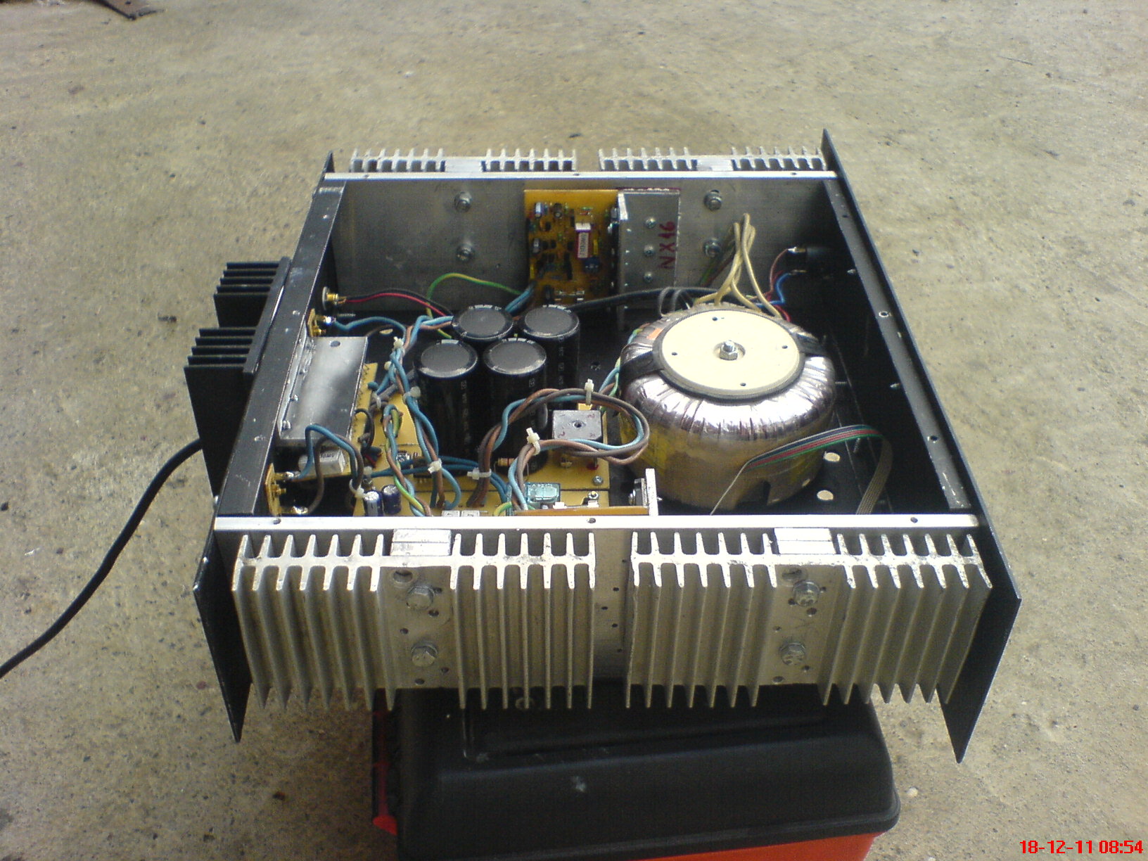

Which PSU is that in the finished amp pic?
I have not seen that one.
PSU5 from thread
http://www.diyaudio.com/forums/solid-state/173462-studio-reference-amplifier-3.html
Regards
PSU5 from thread
Regards
Yes,that´s the one-only i did it with two pair of output transistors. That would be PSU10.
apex. would it not be a better Choice to use 2 pair of irfp240 instead of a single pair irf250?
Is IRFP250N OK for NX14 ?
Here (http://www.diyaudio.com/forums/soli...l-interview-bjt-vs-mosfet-77.html#post1206850) I found a related question:
"What's the difference between IRF parts with and without suffix "N"?
For example IRFP250 and IRFP250N." But I couldn't find any answer in the same thread.
A general look at the datasheets tells us that IRFP250N is newer than IRFP250, with lower capacitance figures, among other slightly better measures.

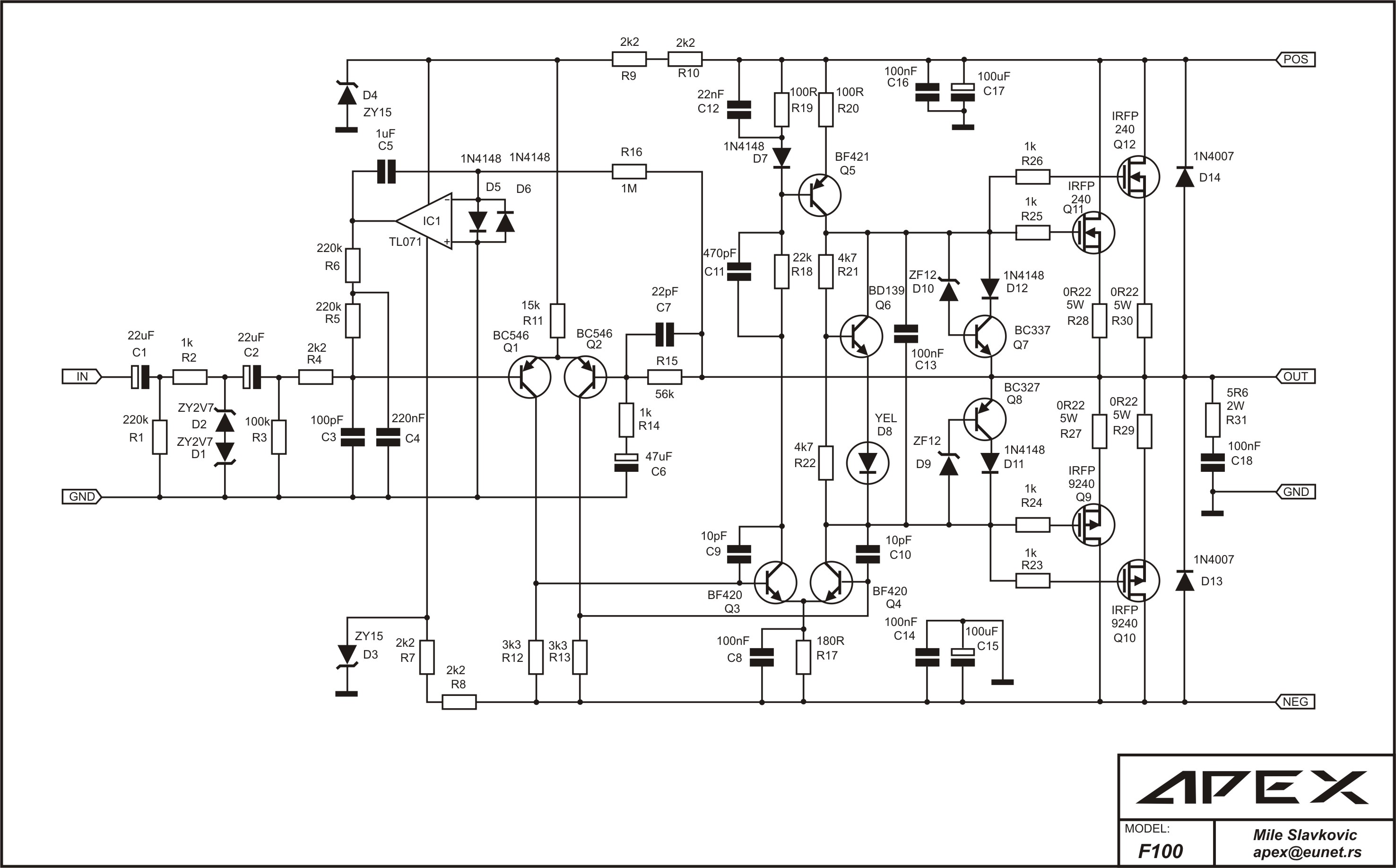

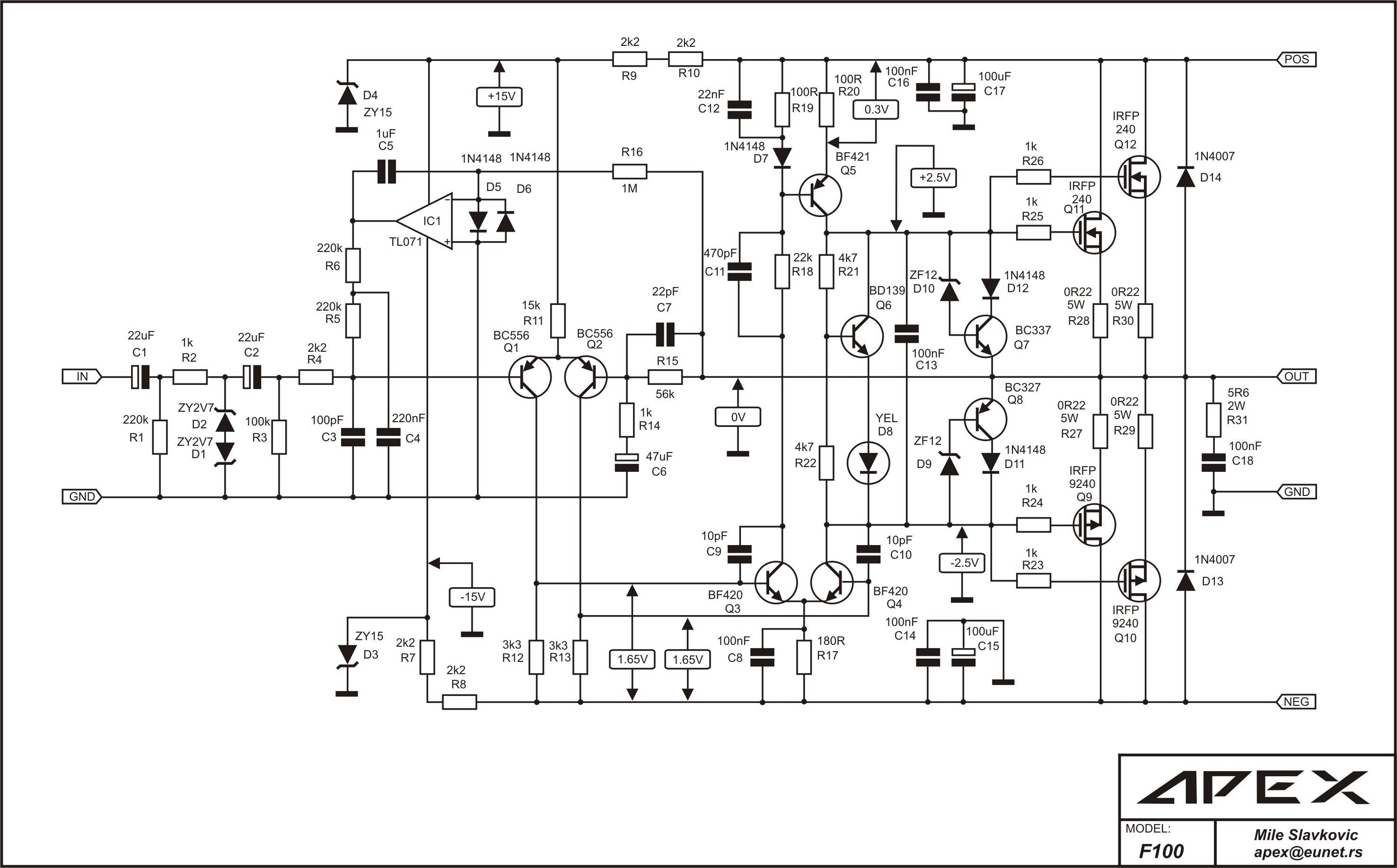

Apex F100

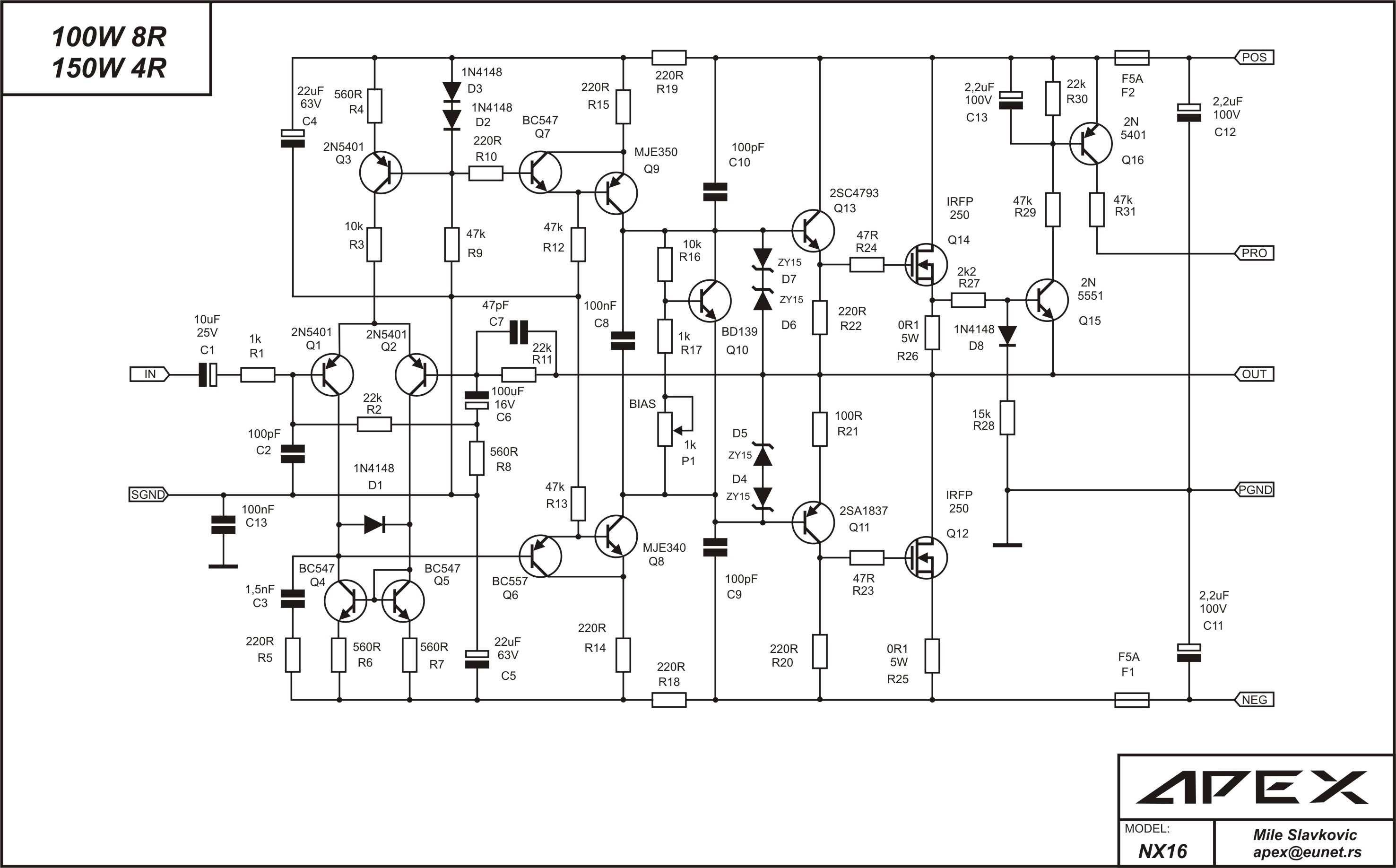

In this thread http://www.diyaudio.com/forums/solid-state/162081-dc-servo-mosfet-amplifier-4.html
I found this
It is almost perfect for my application except for availability of BF421/2 are there any alternatives?
I found this
The MSPA42/43 and MPSA92/93 might be what you are looking for.
Shouldn't Q1 and Q2 in the schematic be BC556?
BC546 is NPN...
Product Folder - BC546 - NPN Epitaxial Silicon Transistor, Fairchild Semiconductor
Also, R9 and R10 seem to be in the wrong place. Shouldn't they be on the left side of R11?
BC546 is NPN...
Didn't read the entire thread, but that schematic with complementary MosFets, does not belong in a non complementary amps thread.
