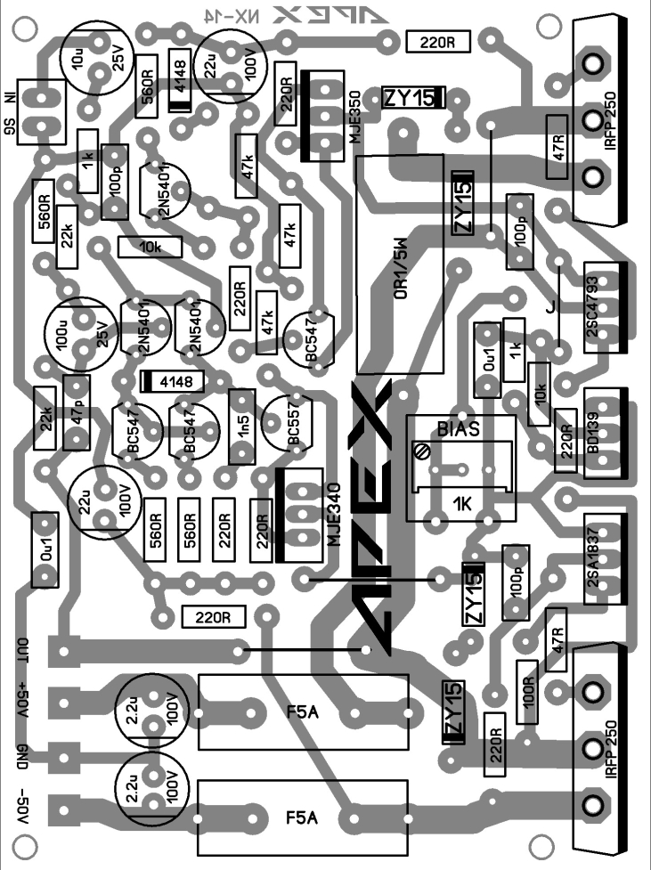

Just confirming that this is the final and working layout for the NX14? I have plenty of IRFP250's lying around at home that I can use. Always an issue getting the output transistors where I stay, and this is perfect for me.
Thanx
Thanx

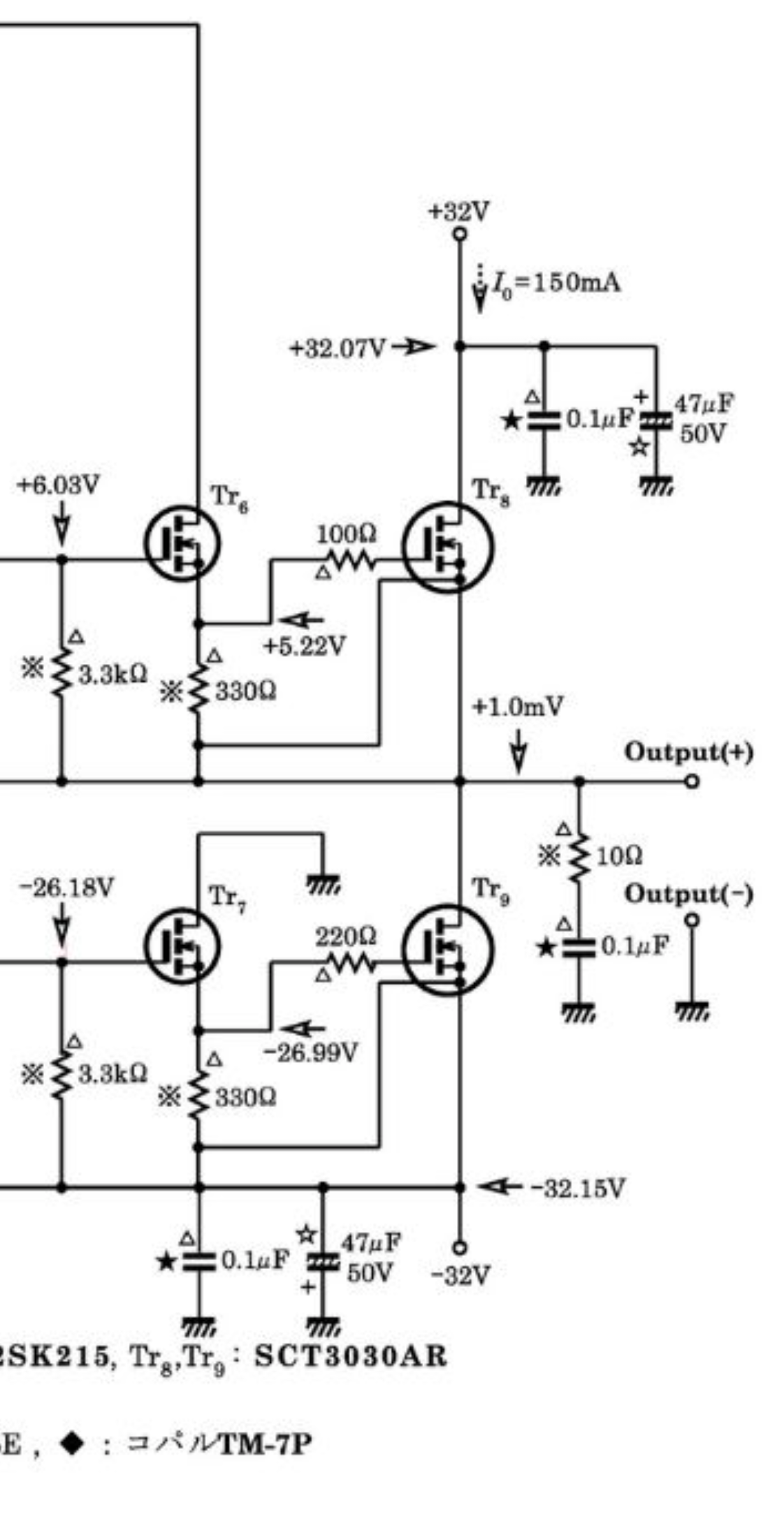

Despite not being a MOSFET, it seems it can handle a lower maximum current than IRF540N, for instance. But we need an engineer to clarify things.
"SemiSouth Laboratories of Starkville, MS, USA, which designs and manufactures silicon carbide (SiC) based discrete electronic power devices, says that its highly efficient, normally-off SiC JFET (junction field-effect transistor) has been adopted for the first time by a consumer electronics company for use in a new audiophile-quality power amplifier.
“These new JFETs have a very low distortion characteristic that makes them superb for use in linear amplifiers.”
Semiconductor Today
Semiconductor Today

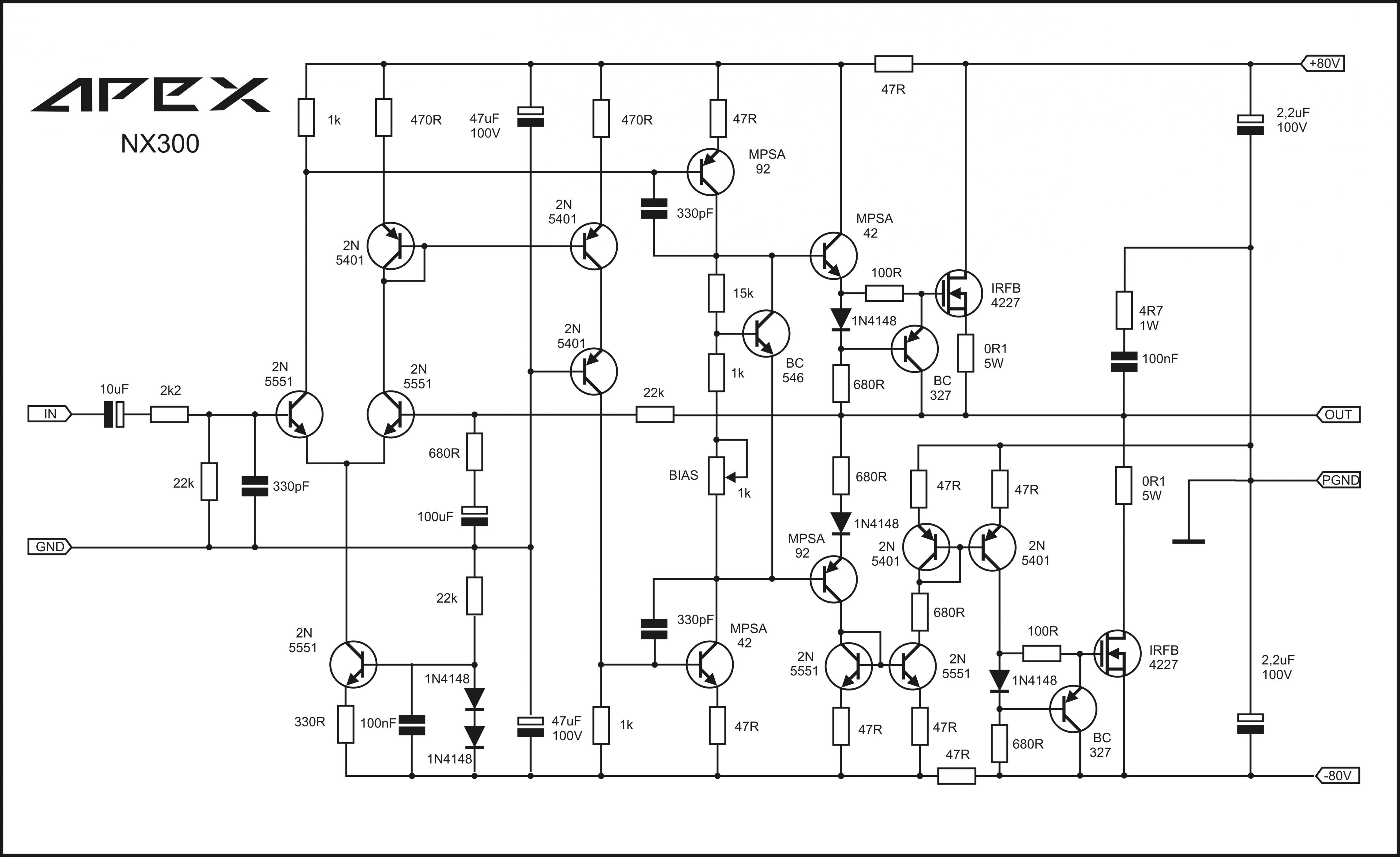

Question , this transistor can be used as OT in NX200 or NX300 amplifier? See attachment .Thanks .😕
Alex great to see you ... those are super rare and I think nearly 100usd each now 😱
Enjoy them 🙂
A complete aside, but the first semiconductor devices made from SiC were detectors for early radio sets in the 1900's - its taken a long time for any other semiconductor applications for it since!!
One day diamond devices may appear...

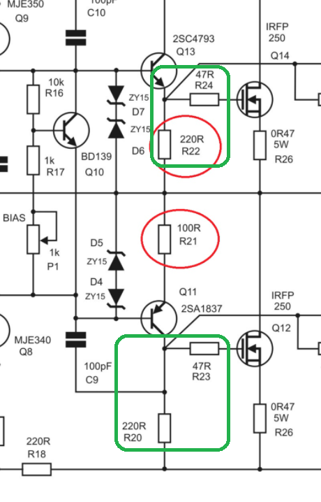

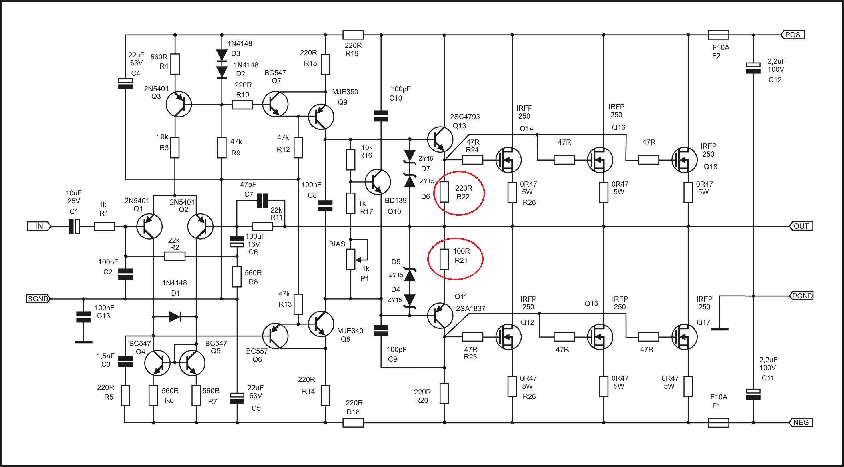

Hi ,
can someone explane , why Q13 and Q11 emiter resistor are with different value ?
Maybe you should focus on these arrangements.
- 150W MOSFET Amplifier with IRFP250x2
