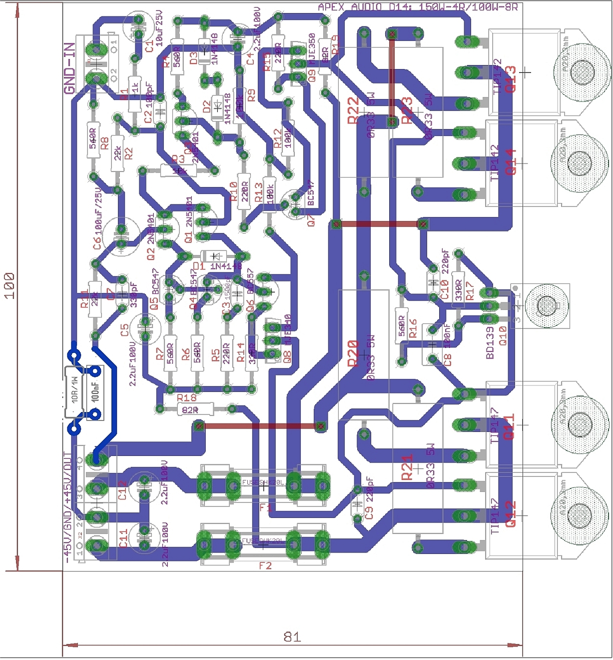

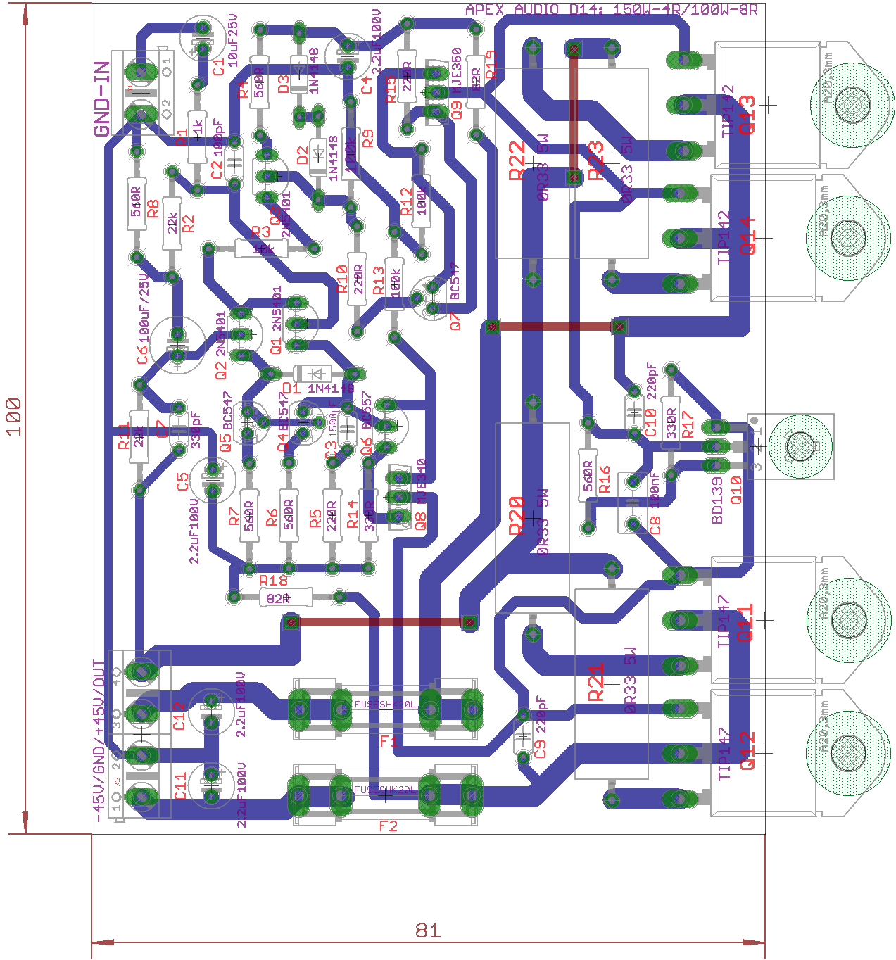

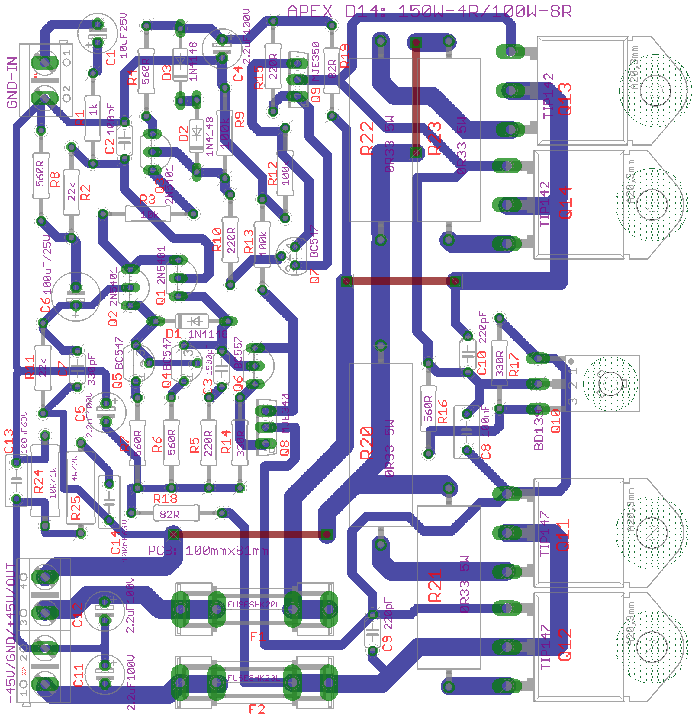

Pl find below apex D14 kelvin amp pcb with TIP141/142. Supply voltage +/-45V. rest of the components and their values are as per original apex layout. would you be kind enough to tell me if there are any errors?
regards
prasi
PS: I have made a larger pcb (100x81 versus original 82.5x62.5) as my soldering skills are awful and dont want to short different pads/tracks.

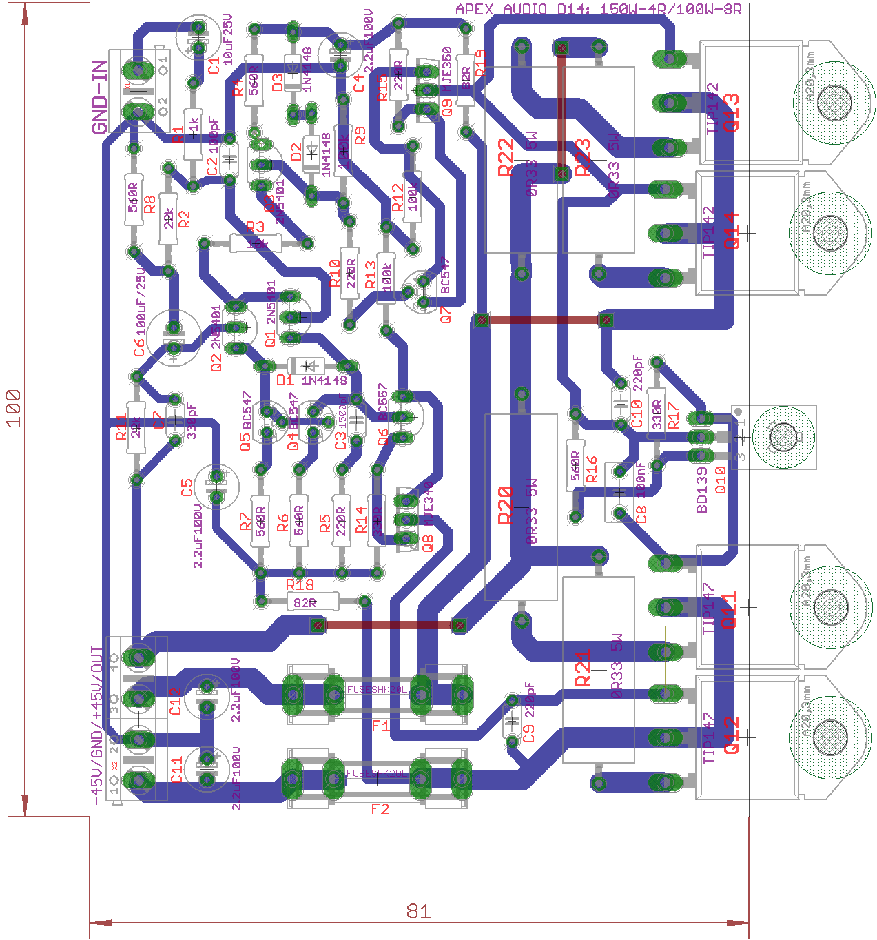

made Small corrections in routing one /two unrouted wires.
PCB attached.

Nice work,

Hi Prasi, use 10R/1W resistor to connect power ground to signal ground parallel with 100nF capacitor. Look at image posted, I have used it on all of my Apex NX and AX series amps I have made.
There is lots of space on pcb, add zobel to output of amp. Use 4R7/2W in series with 100nF capacitor.

Hi Sonal,
Thanks for your reply and inputs. I have modified the board accordingly and attaching the PCB. I have connected the zobel across amp output and gnd.

Dear Mile sir,
Thanks for the compliments!. Do you have any comments on the revised PCB attached with Post # 286 which includes a zobel on the o/p and parallel cap and res between signal ground and supply ground?

Hi Prasi, layout is ok, but pad size of resistors, capacitors and some transistors is small for hand drilling. Use any one of eagles design rules files I am posting or edit design rules as you like.
Regards
Sonal
Hi Sonal,
Thanks for DRU file. I checked my PCB with sparkfun.dru and no errors. However, as suggested by you I will go with larger pad sizes for all res/cap/power res/transistors.

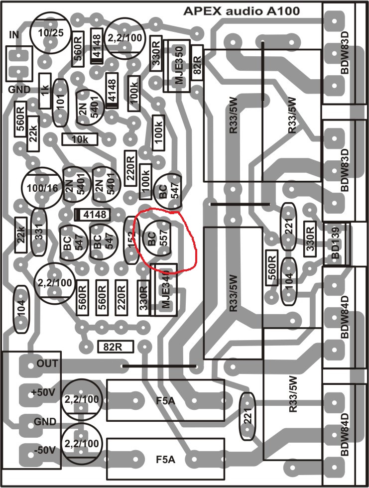

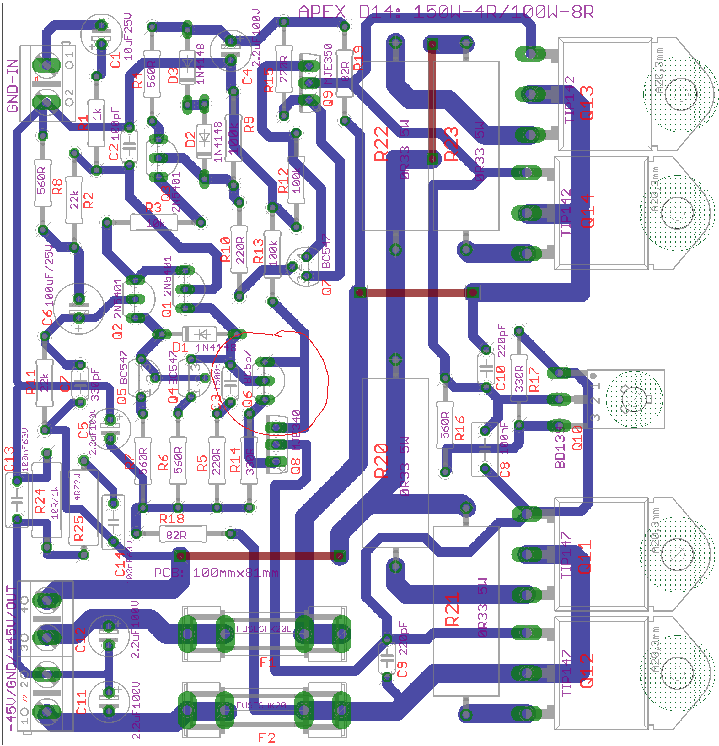

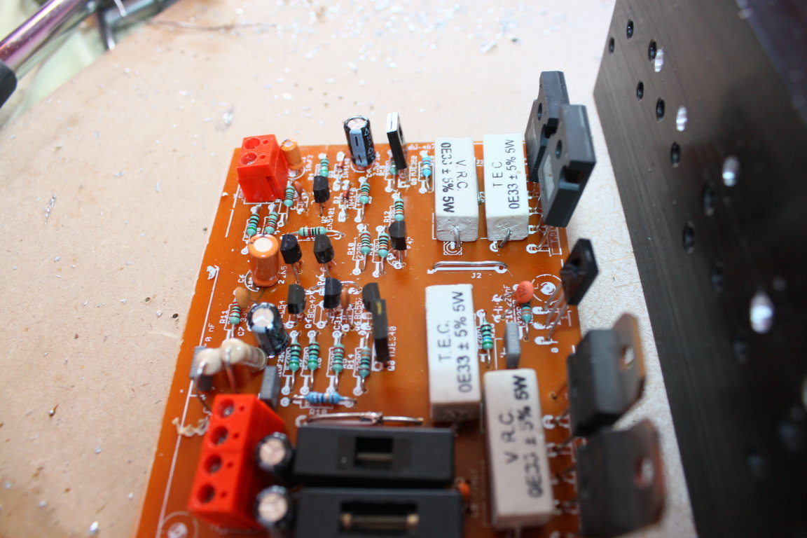

Hi Sonal,
Have a doubt in the layout prepared by me and the amp photo attached by Apex (post no.31, http://www.diyaudio.com/forums/solid-state/163159-150w-mosfet-amplifier-irfp250x2-4.html).
I have made the PCB layout as per schhematic of apex , but Orientation of Q6 BC557 is reversed on the photograph posted by APEX in the above link.
can you confirm, which is correct?
I have attached pics of both circling the difference.
regards
prasi
regards
prasi
Hi prasi,
Apex one is correct. I think orientation of BC557 in eagle is wrong, collector should connect to negative supply.
Sonal
Sonal
Hi prasi,
Sonal

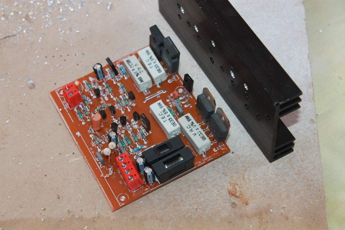

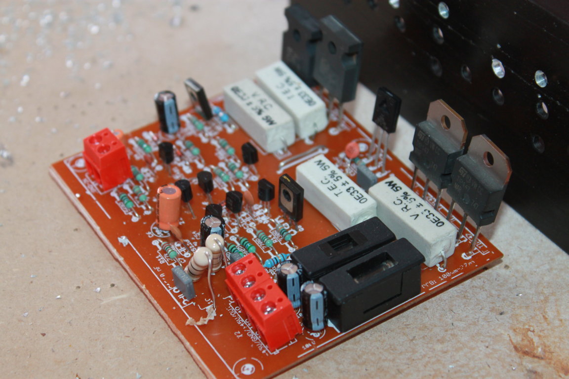

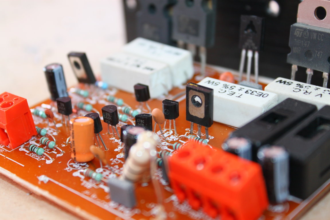

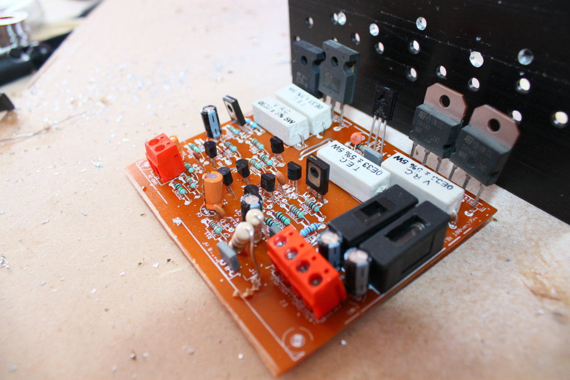

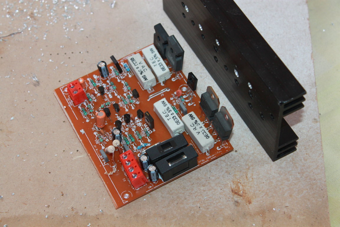

Hi Sonal and others,
i am attaching herewith my apex kelvin amplifier build . i just need clarification on the MJE350 and MJE340 orientation. whether i havemounted correctly?
As suggested by you earlier, the power ground and signal ground are seperated and also a zobel is incorporated on the amp pcb itself.
reg
prasi
Hi prasi,
MJE350 and MJE340 orientation are ok but heat sink is small for this amplifier. You should check http://diycomponents.in, http://diyaudiocart.com and http://www.gajsupply.com for heat sink.
Sonal Kunal
Sonal Kunal
