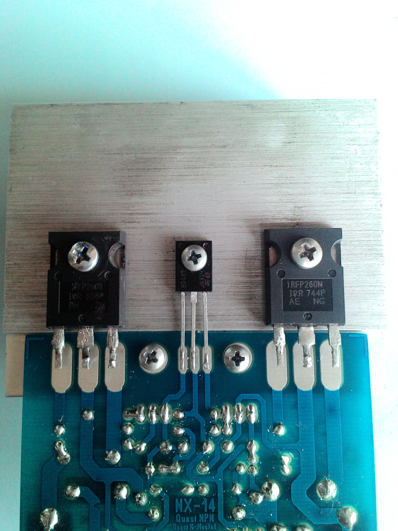

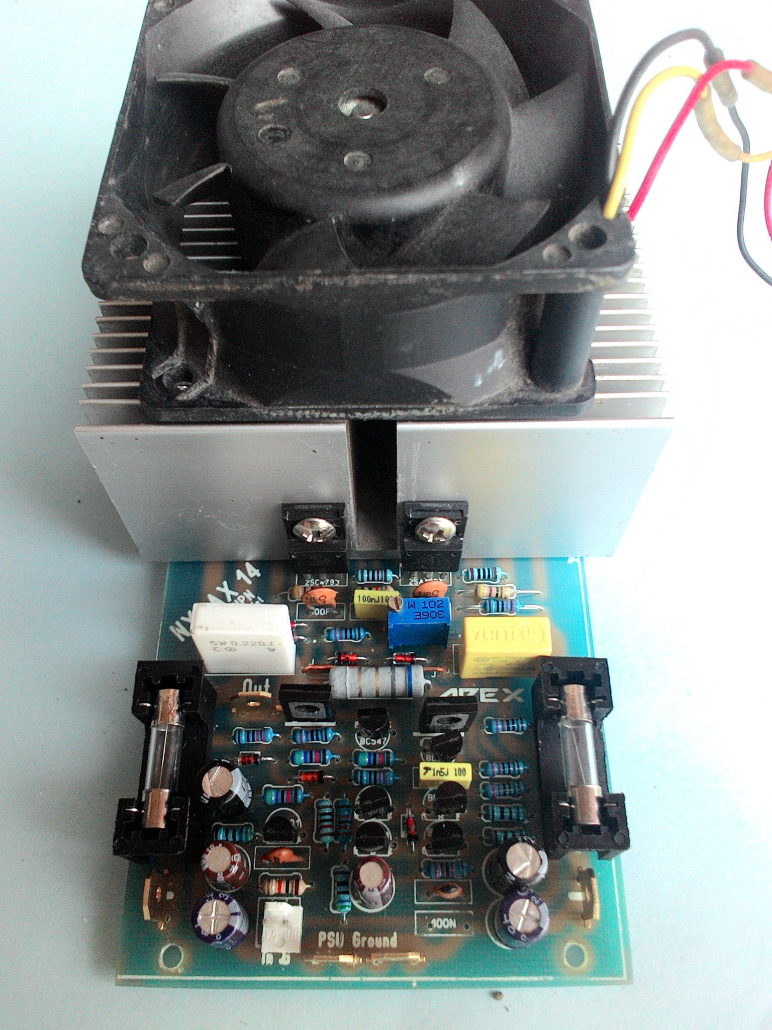

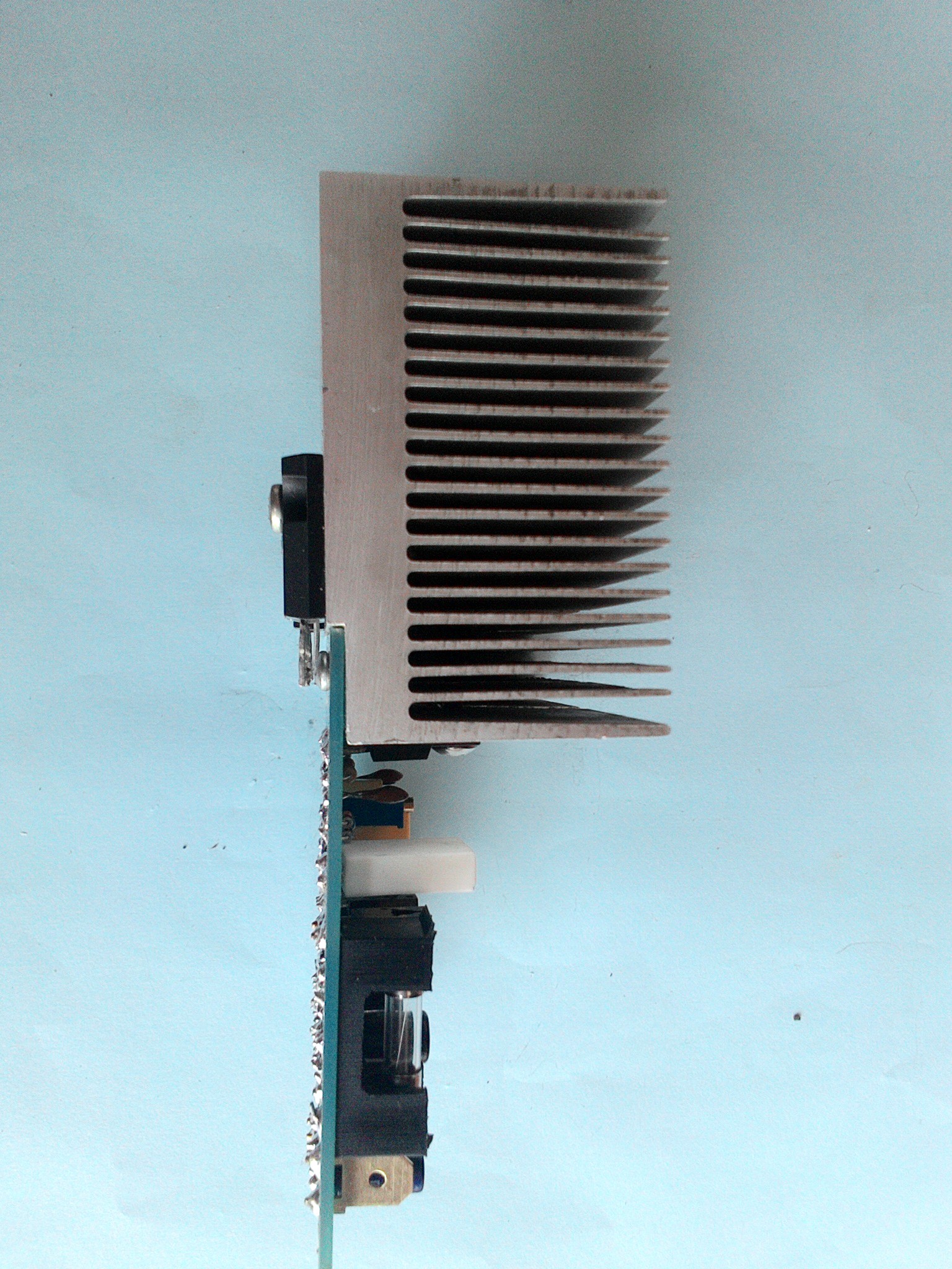

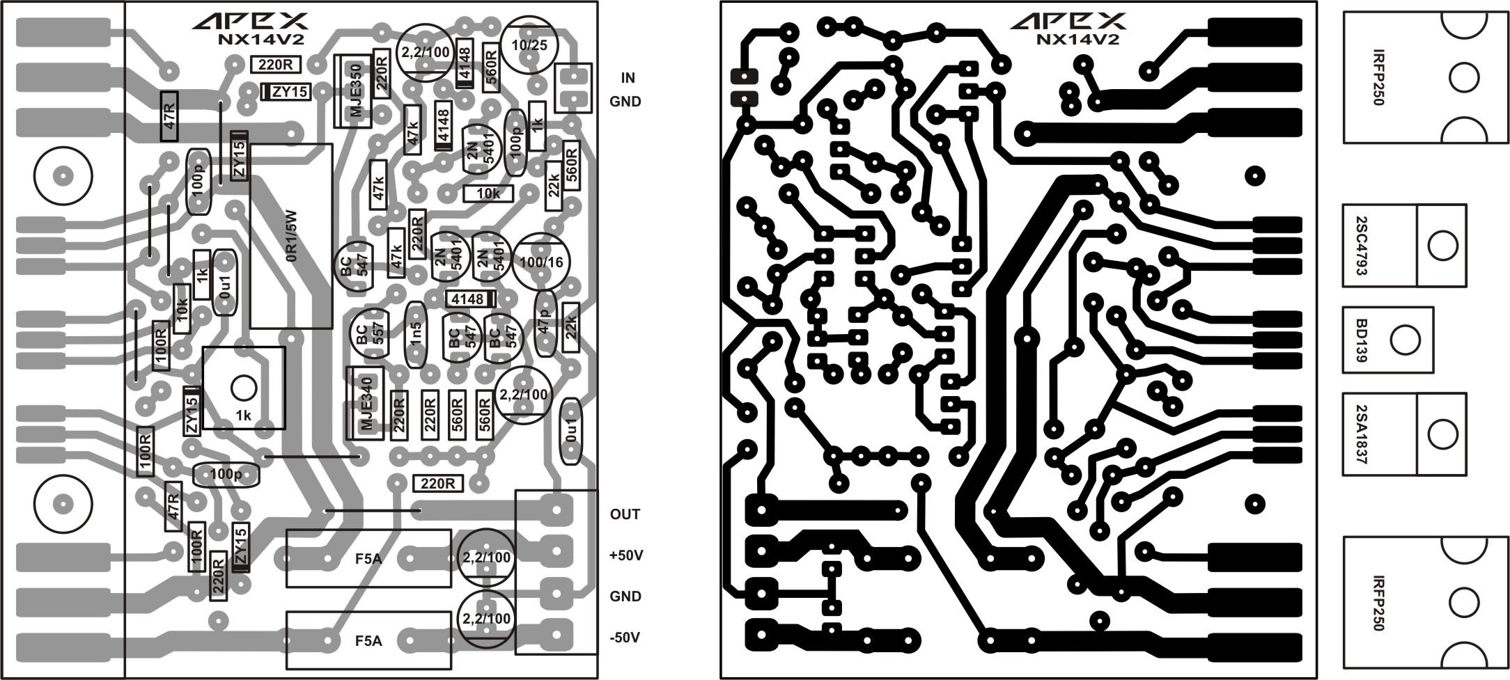

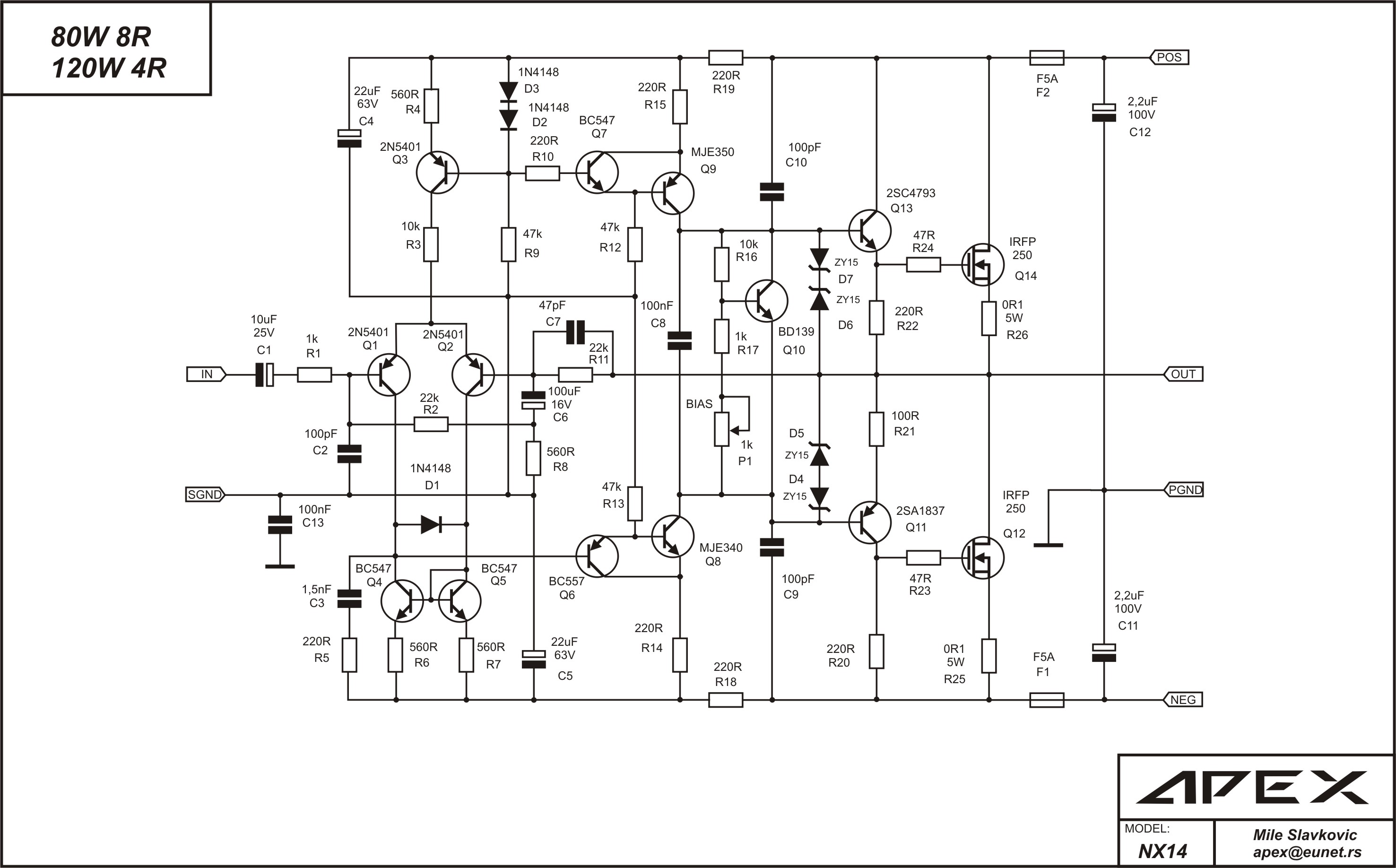

150W MOSFET Amplifier with IRFP250x2
NX-14
Finished NX-14 with zobel
Regards

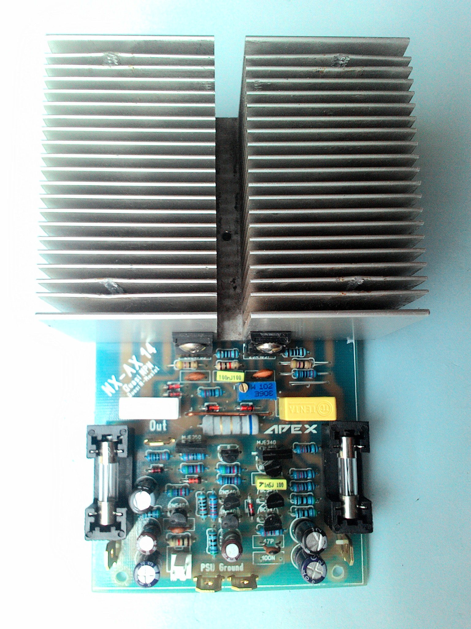

R1-1k
R2,R11-22k
R4,R6,R7,R8,R16-560R
R5,R10,R14,R15,R17,R18,R19-220R
R9,R12,R13-100k
R20,R21,R22,R23-0R33 5W
C1-10uF/25V ELKO
C2-100pF KER
C3-1500pF KER
C4,C5,C11,C12-2,2uF/63V ELKO
C6-100uF/25V ELKO
C7-330pF KER
C9,C10-220pF KER
C8-100nF MKS
D1,D2,D3-1N4148
Q1,Q2,Q3-2N5401
Q4,Q5,Q7-BC547
Q6-BC557
Q8-MJE340
Q9-MJE350
Q10-BD139
Q11,Q12-BDW84D
PCB size:62,5x82,5mm
Q13,Q14-BDW83D

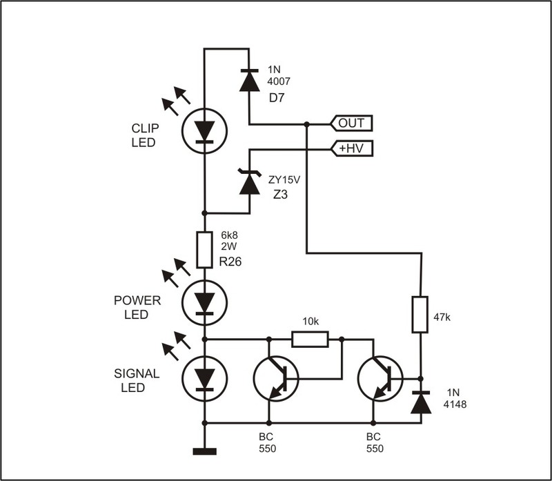

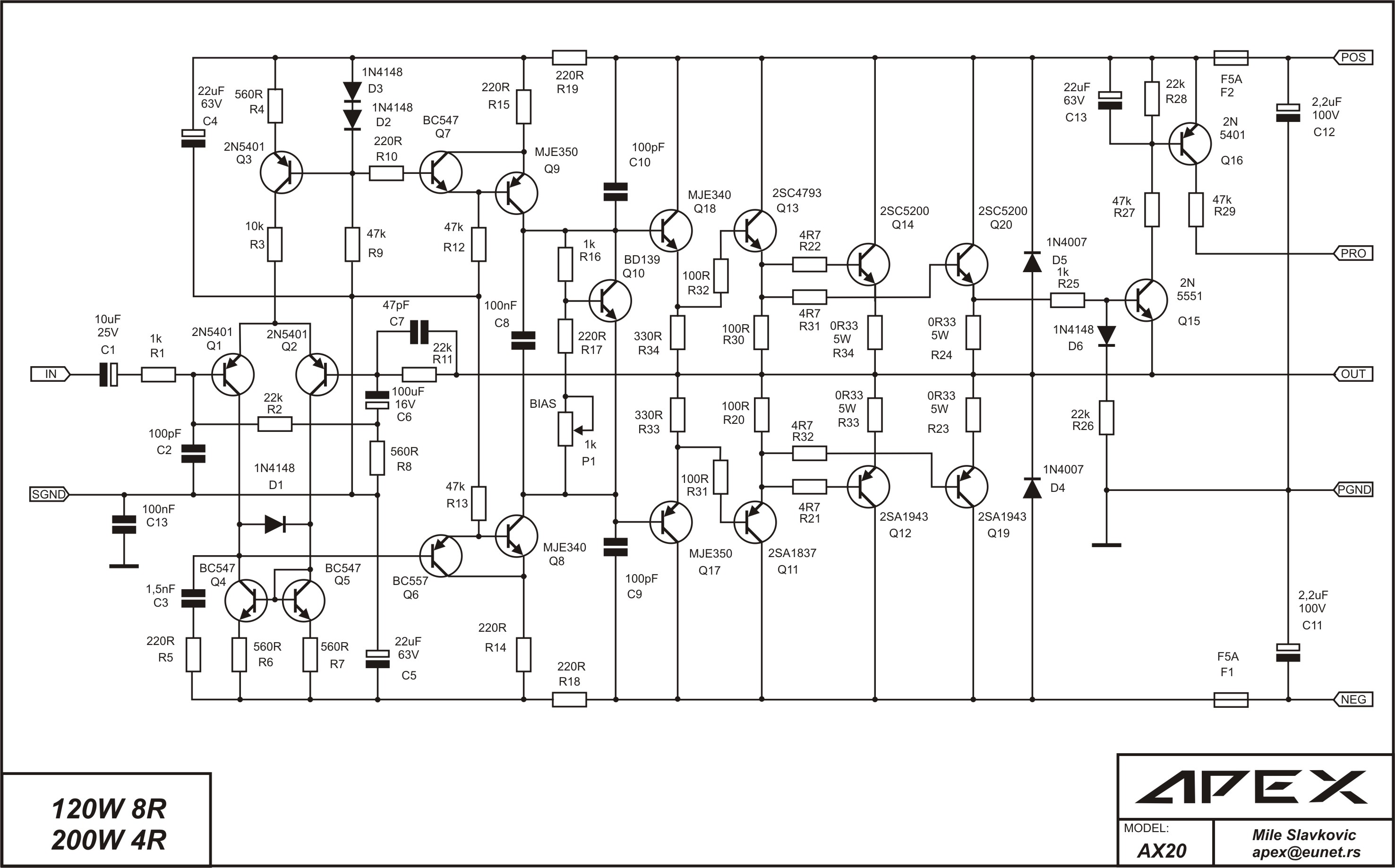

Could you post schematic for PROT clip signal power circuit?

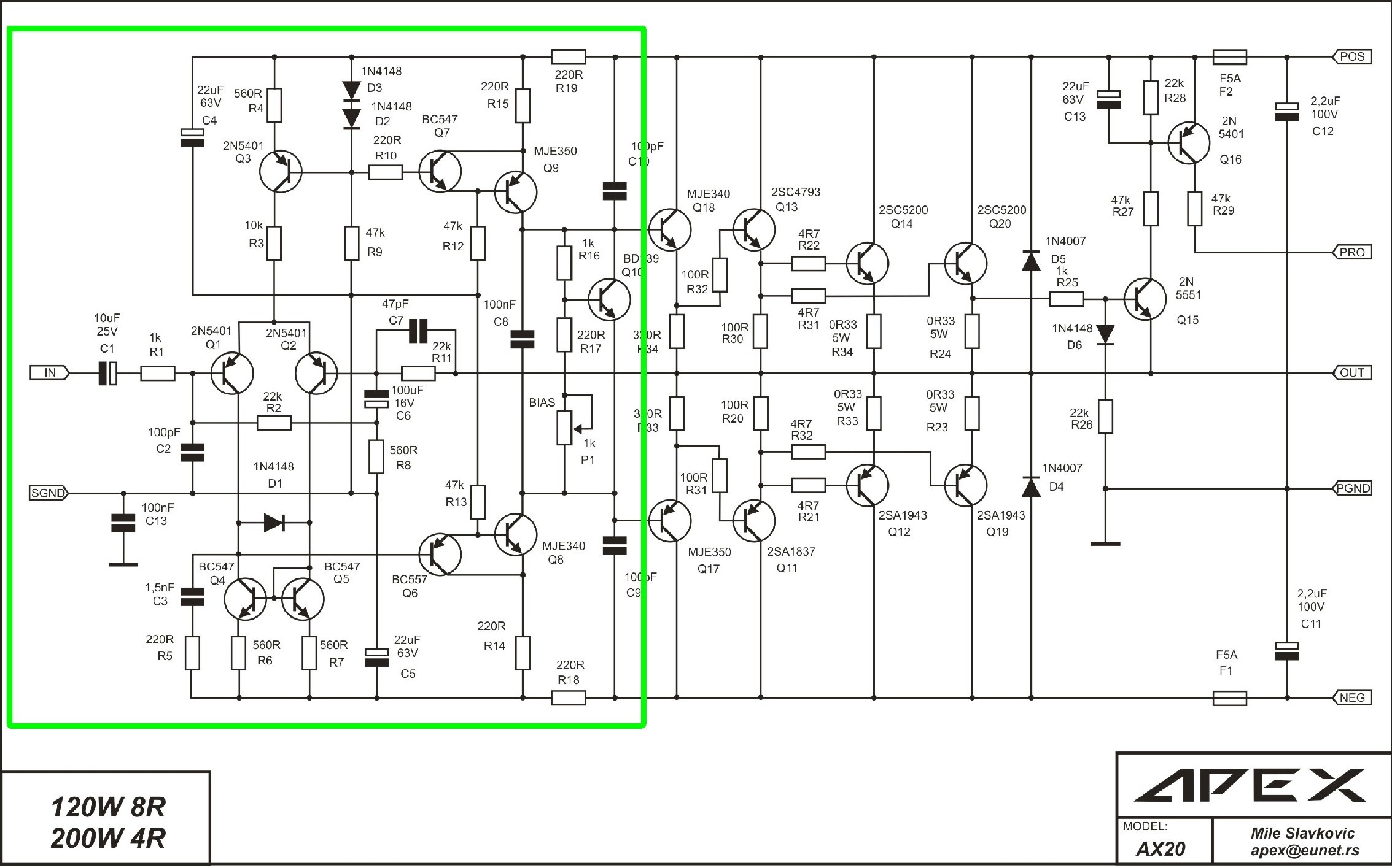

Schematic was posted by Miles some were in 100w-ultimate-fidelity-amplifier thread, I have forgot where protect schematic is on my PC. AX-20 schematic will help, Miles told this protect can be added to any amplifier.

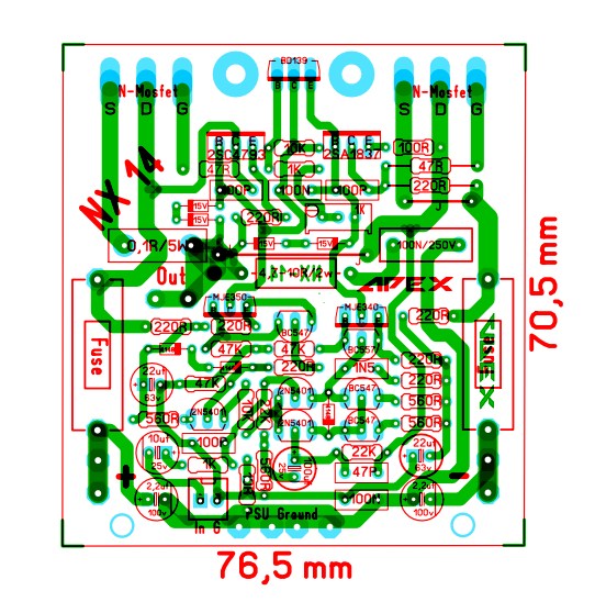

NX14 Reverse Mosfet
This my laout PCB using ex processor heatsink.
Regards

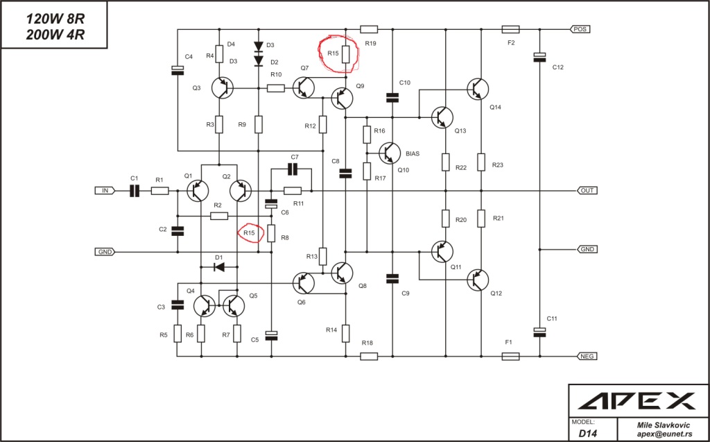

Hi Mr. Mile,
I was planning to build the Kelvin Amp. However I observed one ambiguity in schematic, PCB layout and actual photograph of the amp posted by you.
1. capacitor 104 (100nF) connecting signal ground and supply ground present on layout and not in schematic and unconnected in the amp photo. should use this capacitor or not?
what are the alternatives for MJE 340 and MJE 350?
appreciate your reply
reg
prasi
HI Mr. Mile one more observation,
C6 polarity is reversed on the layout. which one is correct? I dont want to blow things. hence pl suggest whether schematic is correct or the layout!!
Reg
Hi Prasi, C6 polarity and D1 are reverse on schematic, place components as shown in layout. As you can see this IPS is used in other Apex amplifiers NX-14, AX-14, AX-20 etc.
