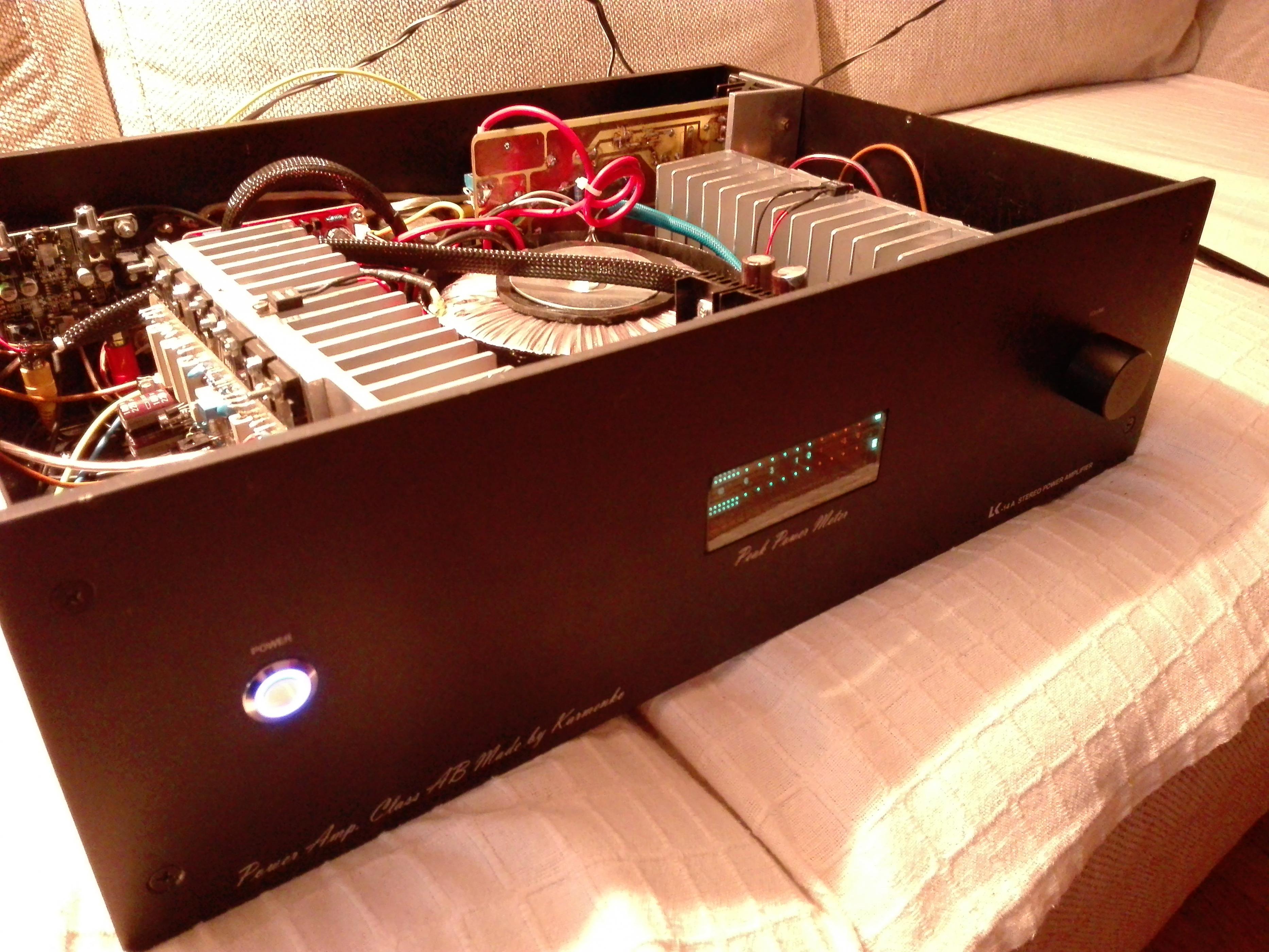

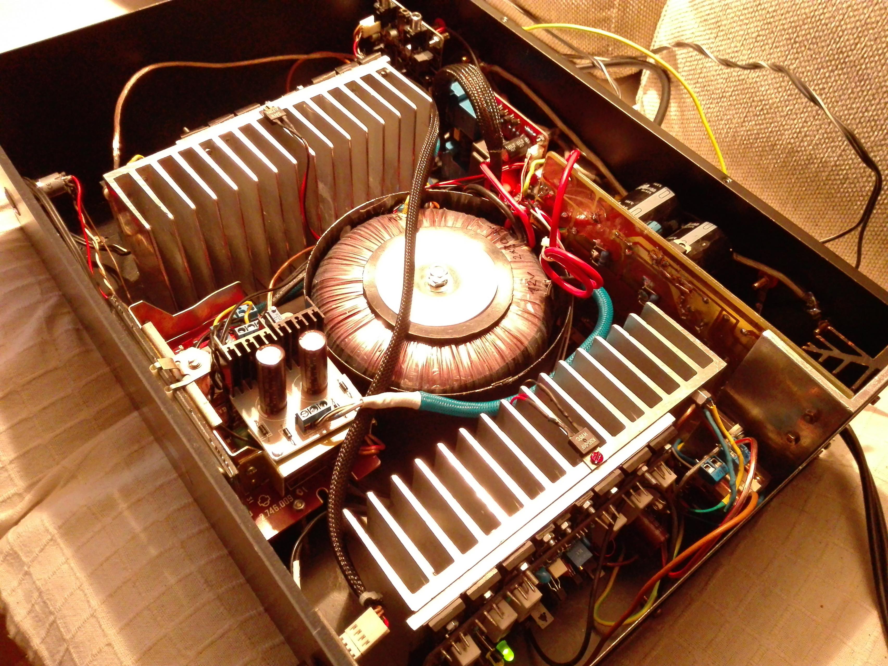

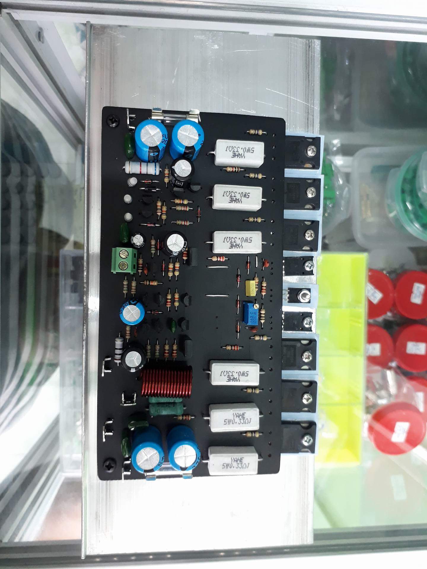

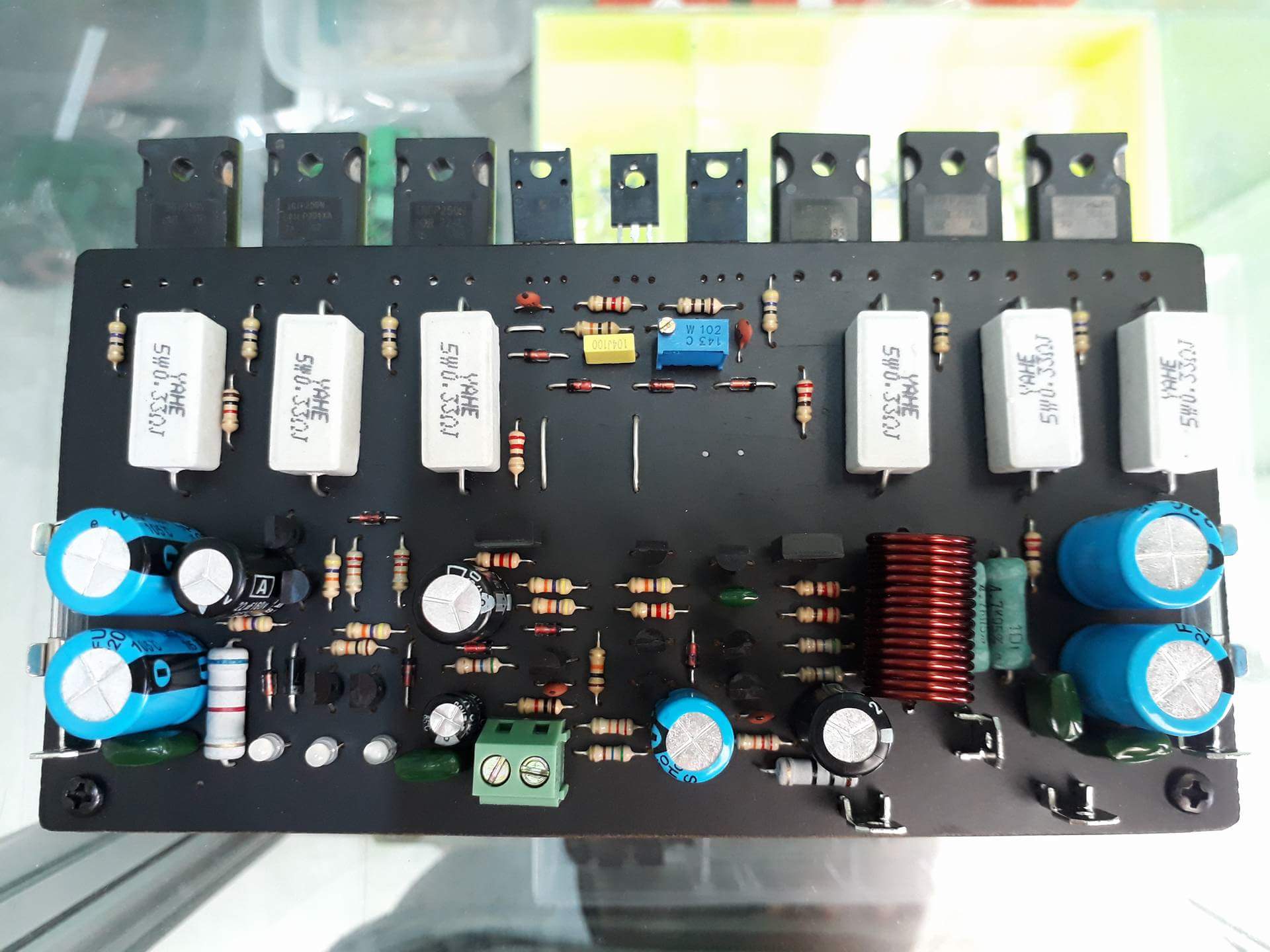

Dear Mr Miles,
This is my NX-400.
Thank you Mr Miles so much.
ThaiKy
Nice work.
Regards
This amplifier Apex NX16
Dear Mr Miles,
This is my NX-400.
ThaiKy
Nice work/
Regards

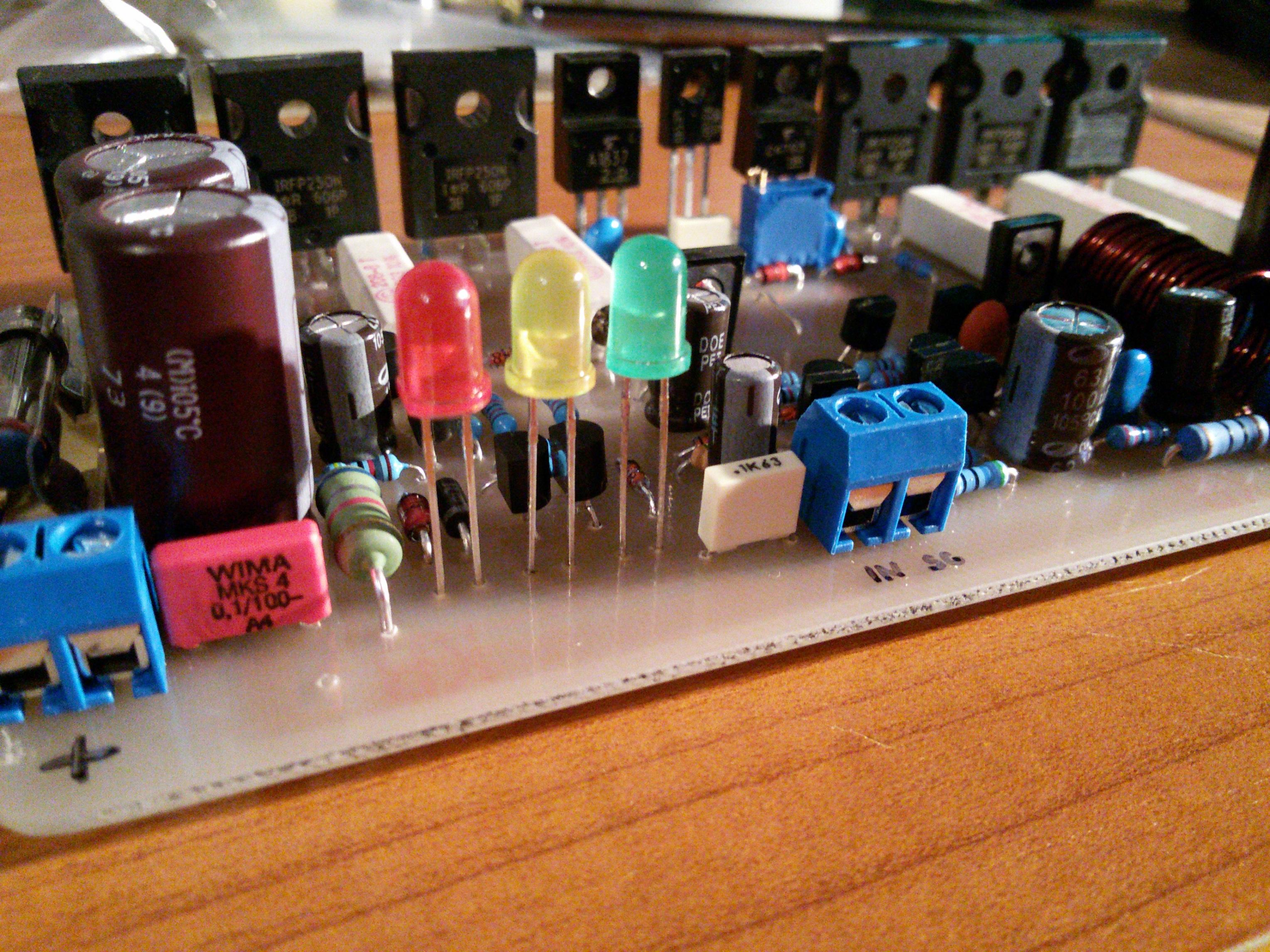

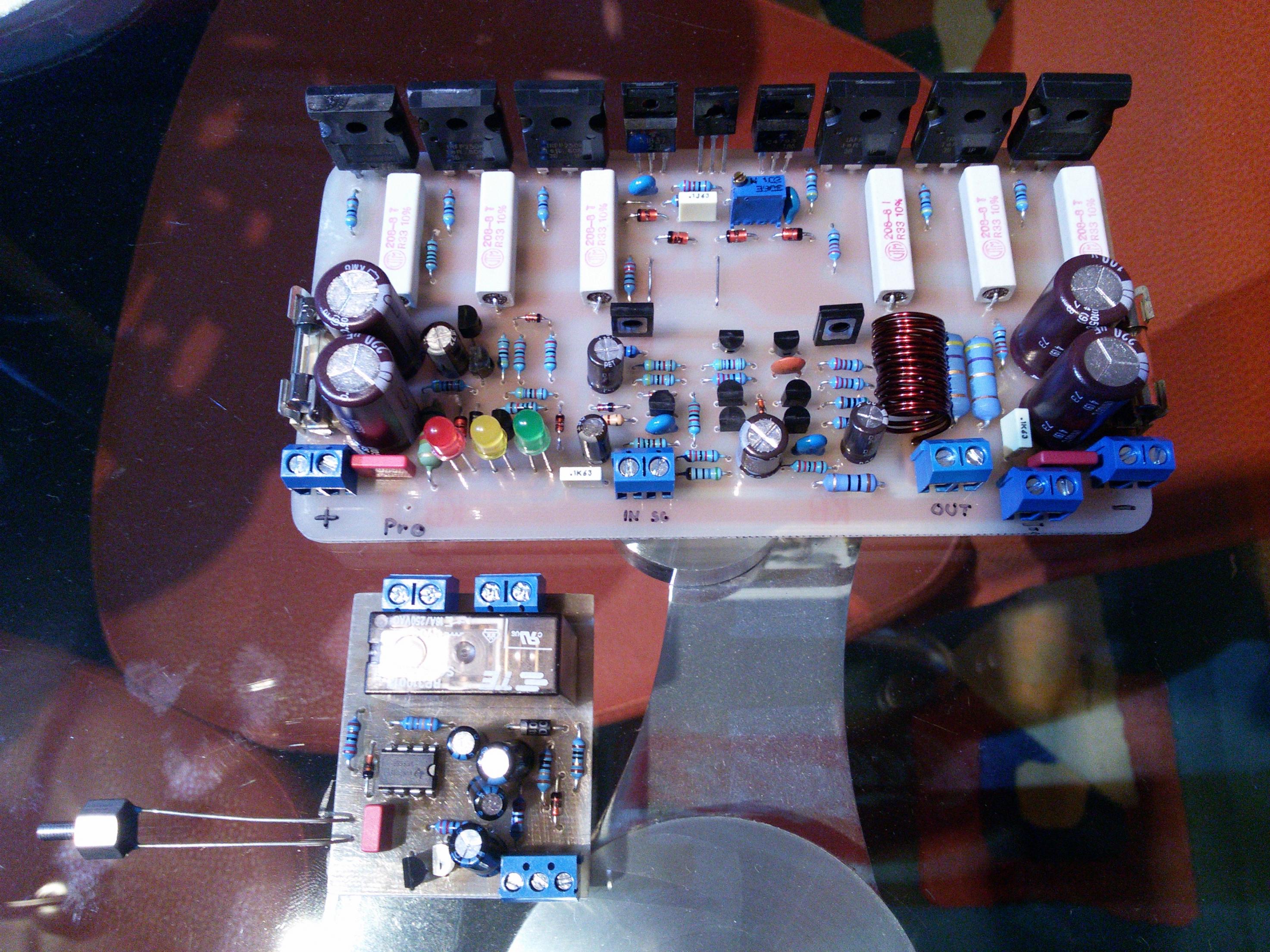

The following amendments practicing NX 14 and put NX 400 with clip protection, and then comes the A40

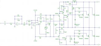

Hi. No N10 layout? 🙄This circuit is upgrade on BUZAMP from Elektor. Use only N-mosfets, with +/-50V DC give 150W on 4R load.
Thanks.
Hi, Mr. Mile! Tell me please nominal and maximum voltage PSU for amp APEX NX400, and what is the power per load of 8 and 4 ohms. BIAS - ??? mA. Thank you.

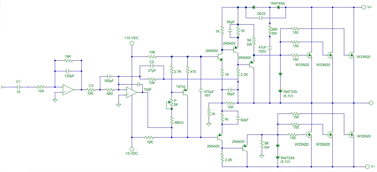

Two inverting input stages means having to have at least 10k of Johnson noise added to the input. One non-inverting input stages would avoid that and save a stage.
No RF filtering on the input is a bit risky these days.
- 150W MOSFET Amplifier with IRFP250x2
