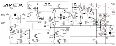

Hi M. Mile, the first skecht APEXN20
hi sir Miles
can 1n4148 be used in n20 instead of bav21?
hi sir Miles
No, use UF4004...

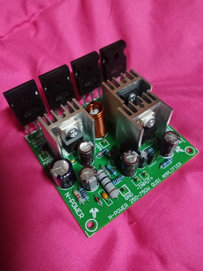

nice andrew , neat and compact . great job sir.

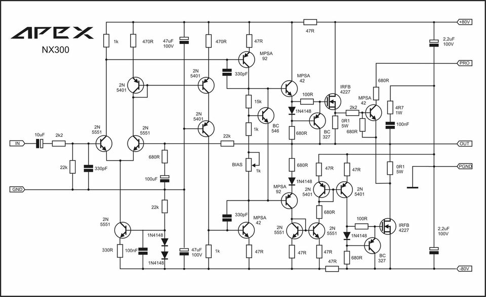

Use PRO detect from N20.Hi Mr. Mile, can I run NX300 with +75VDC-0-75VDC at 4R. About the pro detect, should I use 555 protection?
Thanks in advance
Pozdrav
Ok Mr. Mile, thanks for your the reply about protection. But again, can I run this amplifier with +75VDC -75VDC at 4R.
Pozdrav
Pozdrav
Pozdrav
Yes,

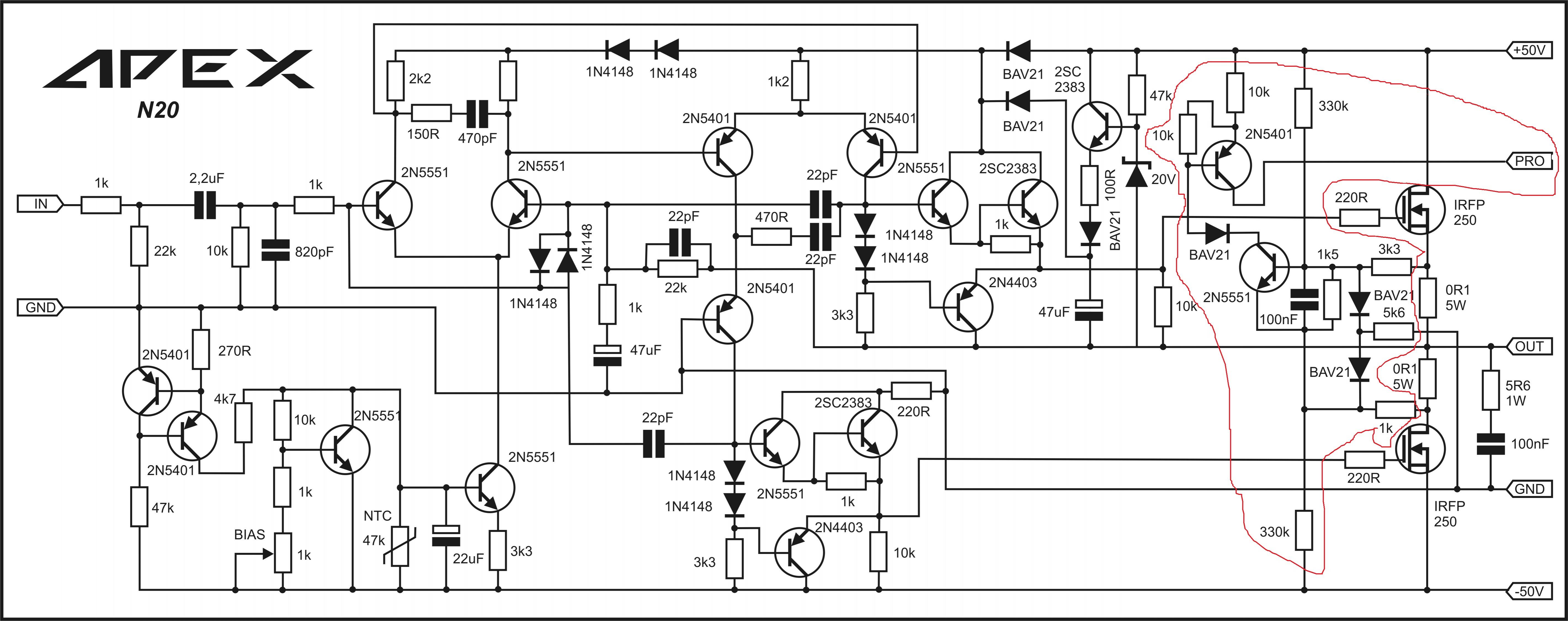

Hi Mr. Mile when you talk about N20 detect, do you mean this.
Pozdrav
Yes
