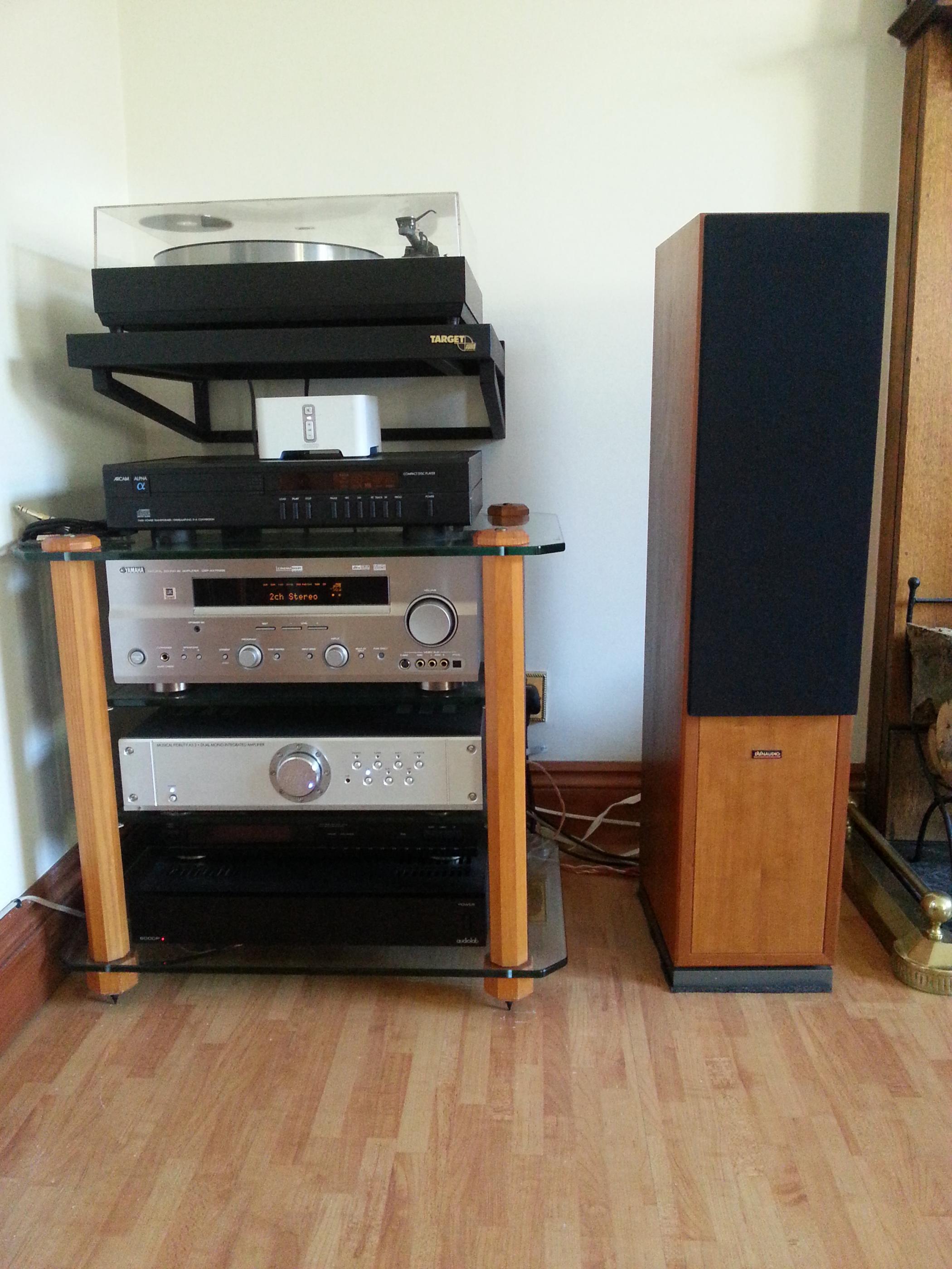

Hi Earl,

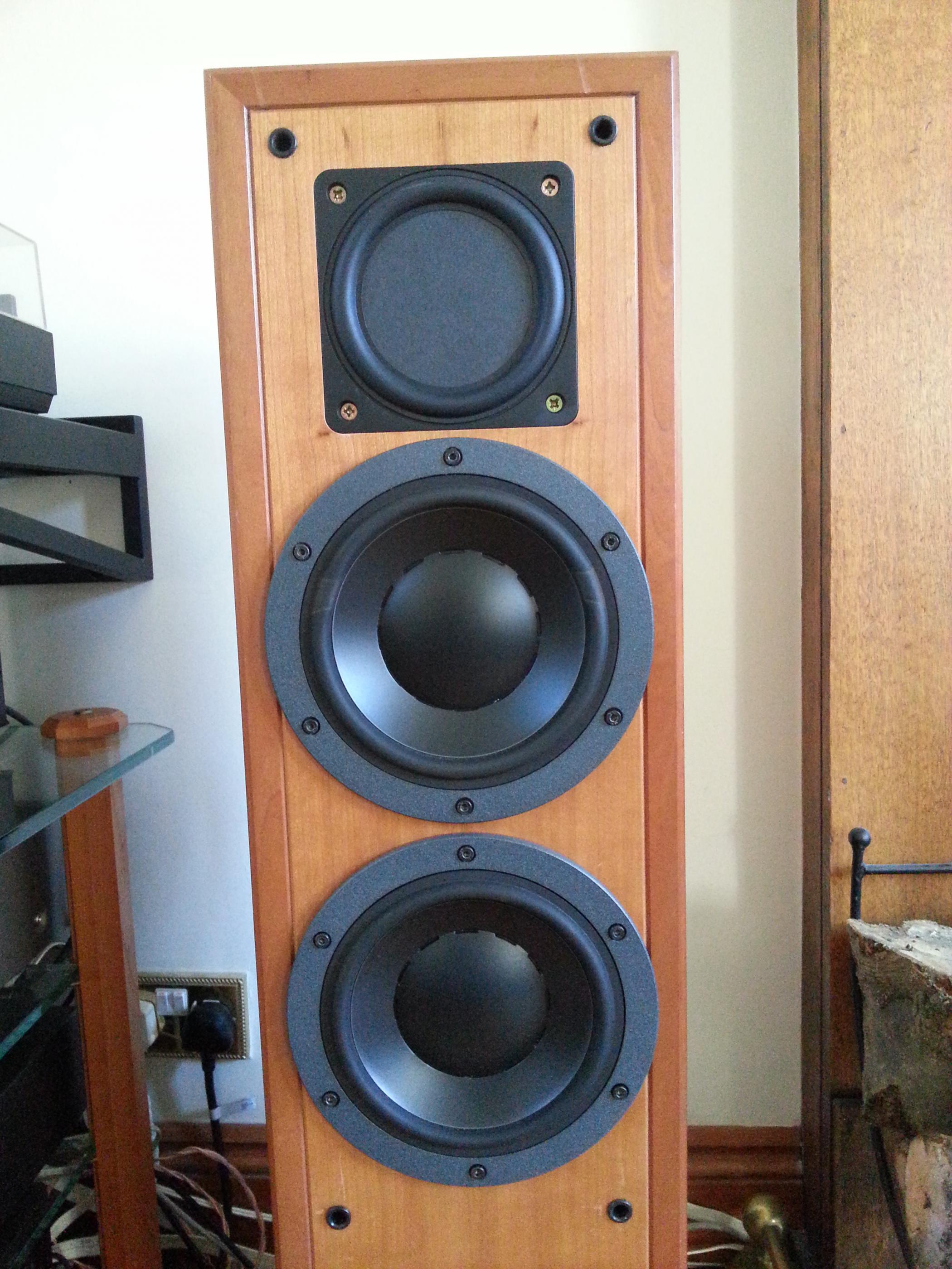

I just recently had a great result using an 4 year old Yamaha AV receiver and an 8 year old Audiolab power amp ( worth approx. £150 for the pair) to actively power and DSP crossover a pair of Dynaudio Contour Mk2's.
I used the Yamahas DSP crossover at 200Hz ( 24dB slopes I think) and the pre outs to connect the customers Musical fidelity amp to power the BMR's, and the Audiolab powers the 6.5 inch Dynaudio drivers.
End result is really remarkably good.
Before the mod I couldn't get £300 for the Dynaudio speakers...After installing two BMR's and including the two amps I got £1,500....!
The customer is a top session musician and used to very high grade studio sound, he is blown away and has given me a great reference / introduction to some other guys.
Buying up classic passive speakers and older AV amps and power amps could be a great little add on your trade in business!
Cheers
Derek.
