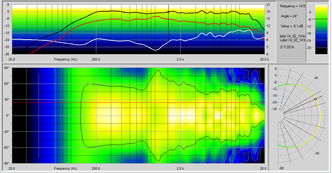

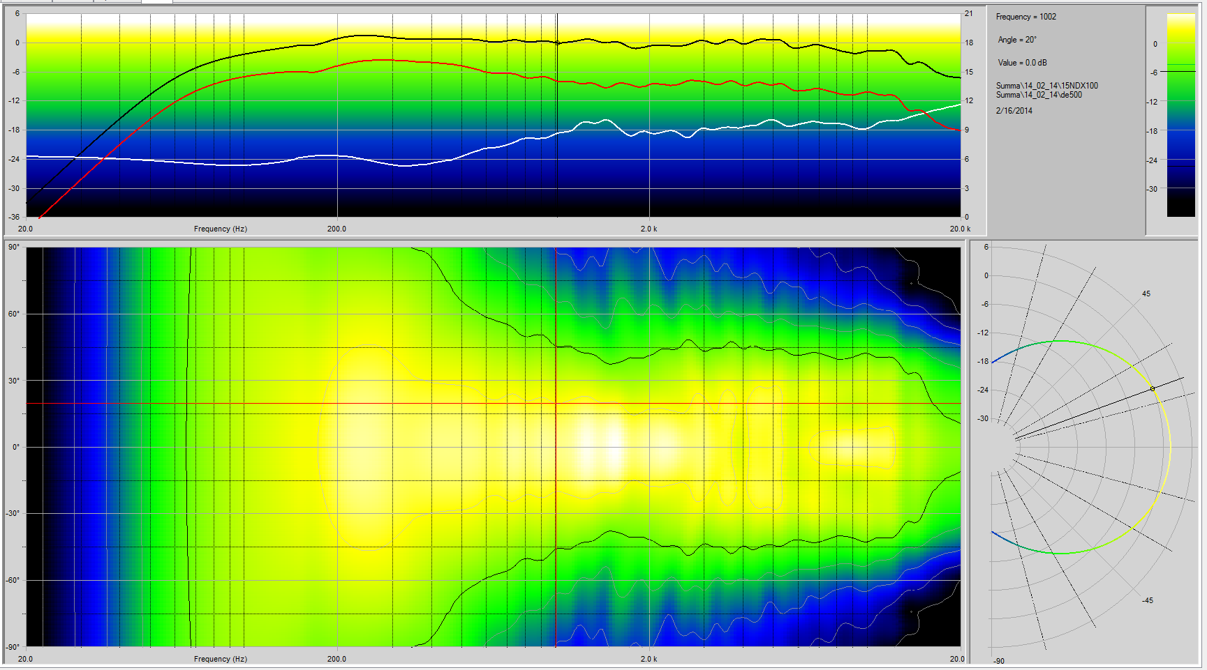

Thanks for the compliments.
Yes, it is the same size, basically exactly the same design, just made differently. The cabinet is a touch smaller than the original, but not much. The drivers are basically neo versions of the originals in order to take some weight out. The New Summa is quite a bit lighter than the original.
The new B&C NBX line of woofers are very impressive. The lower weight got rid of some persistent resonances that were problematic.
The new cabinets use 1 inch poly instead of the 3/4 inch in all the other speakers. The baffle is almost 2" thick and is CLD as is the back. The cross bracing is done as a damped cross member unlike the rigid cross bracing I used in the past. All in all the new enclosure is lighter but much better damped. The lighter drivers means less resonances all around and the extra well damped bracing has reduced all the resonances to nonexistent. There is still a slight dip in the response ( a slight bump in DI) at about 1500 Hz. This is because the woofer narrows too soon. This is why I think that a 12" woofer may be the better choice. But overall the much lower small resonances which occur in all loudspeakers have been effectively removed (as can be seen from the polar map).
Before someone asks, the polar map uses ERB bandwidth smoothing which is frequency dependent to match the bandwidths of our hearing. It is about 1/3 octave at low frequencies to about 1/6 at 1 kHz and about 1/20 at HFs. If there were any resonances you would see them.
Basically this Summa is just using those little tricks that I learned along the way to get that extra dB of precision out of them.
