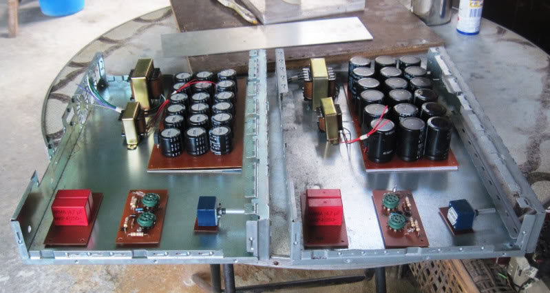

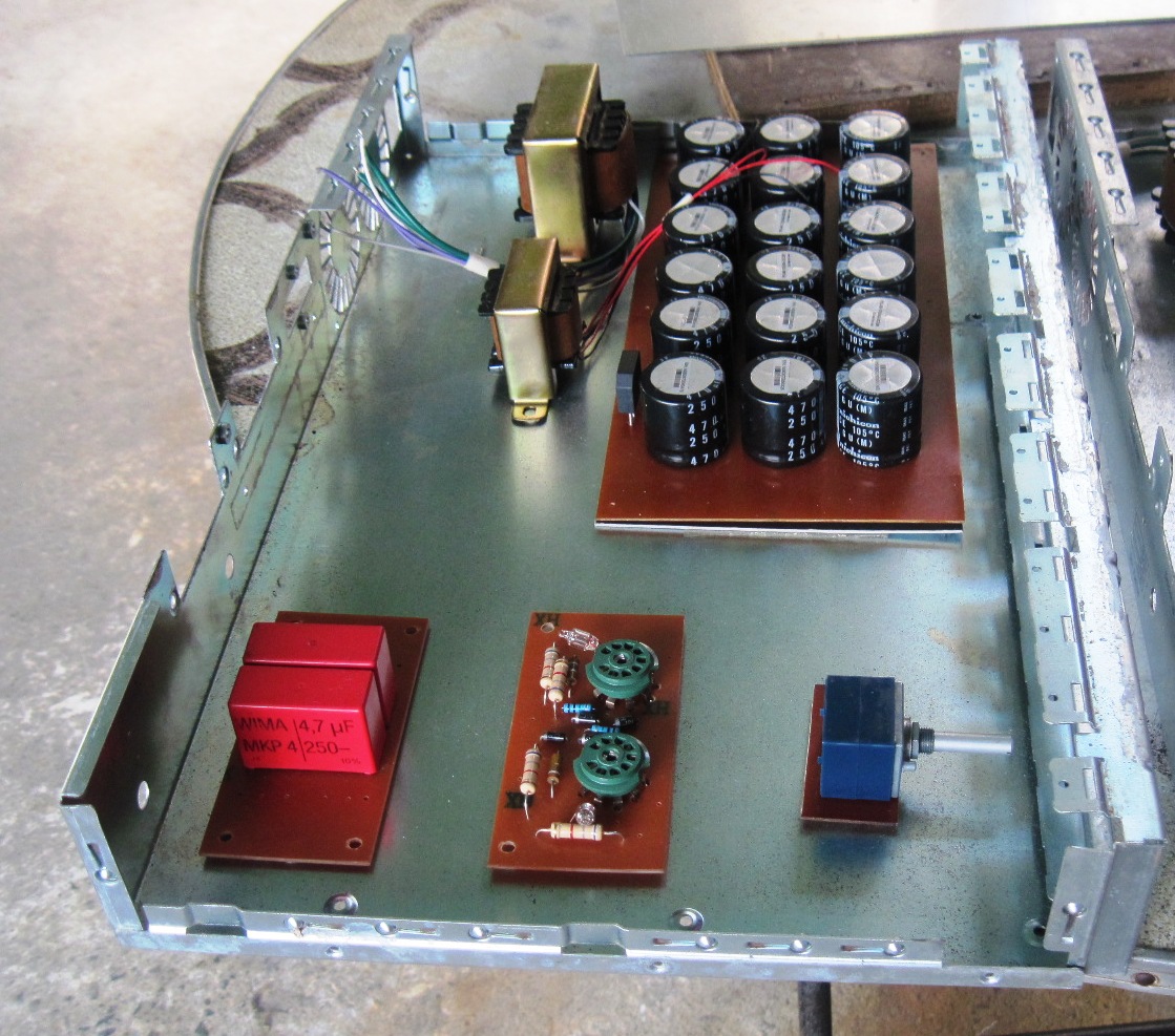

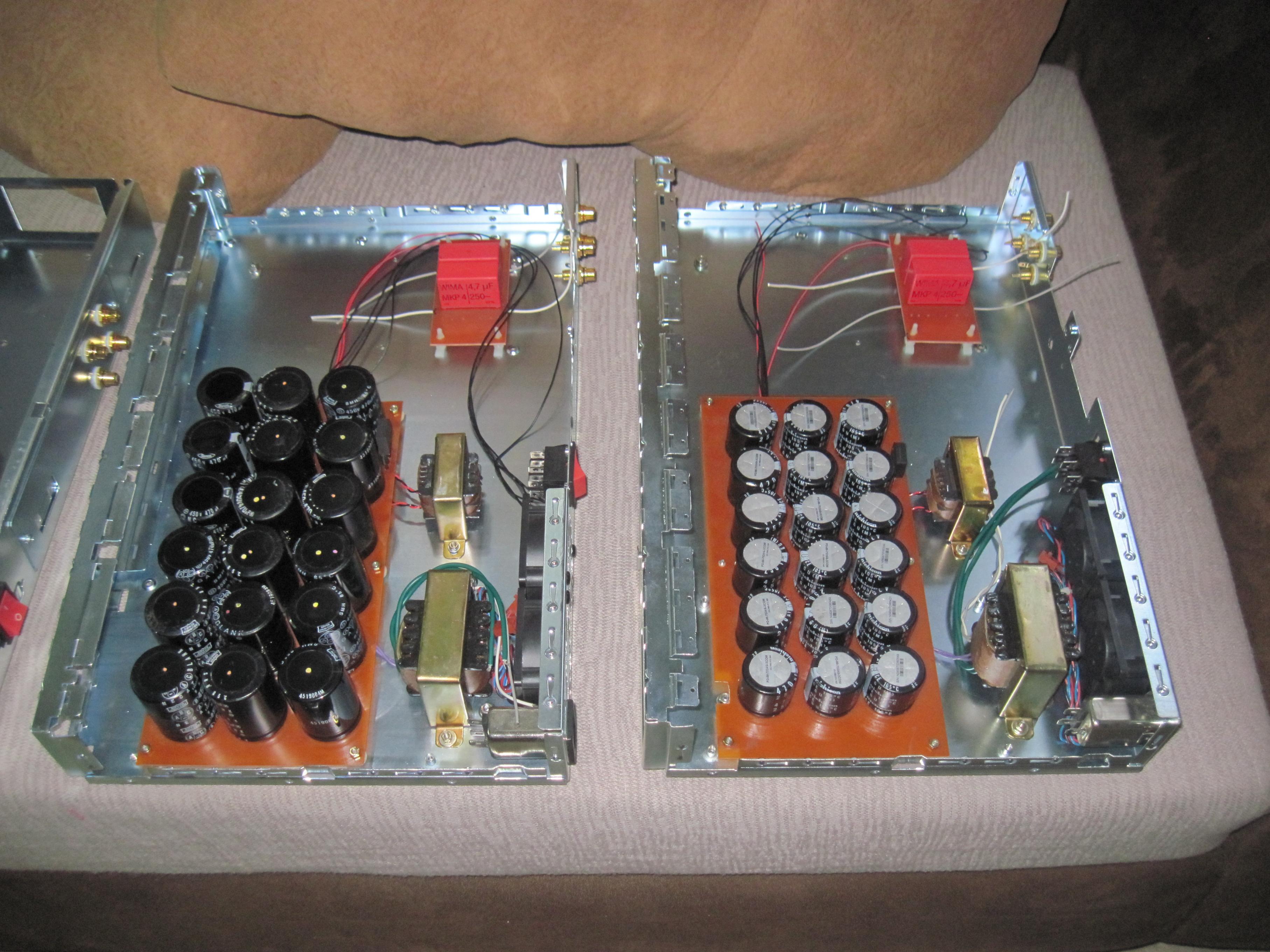

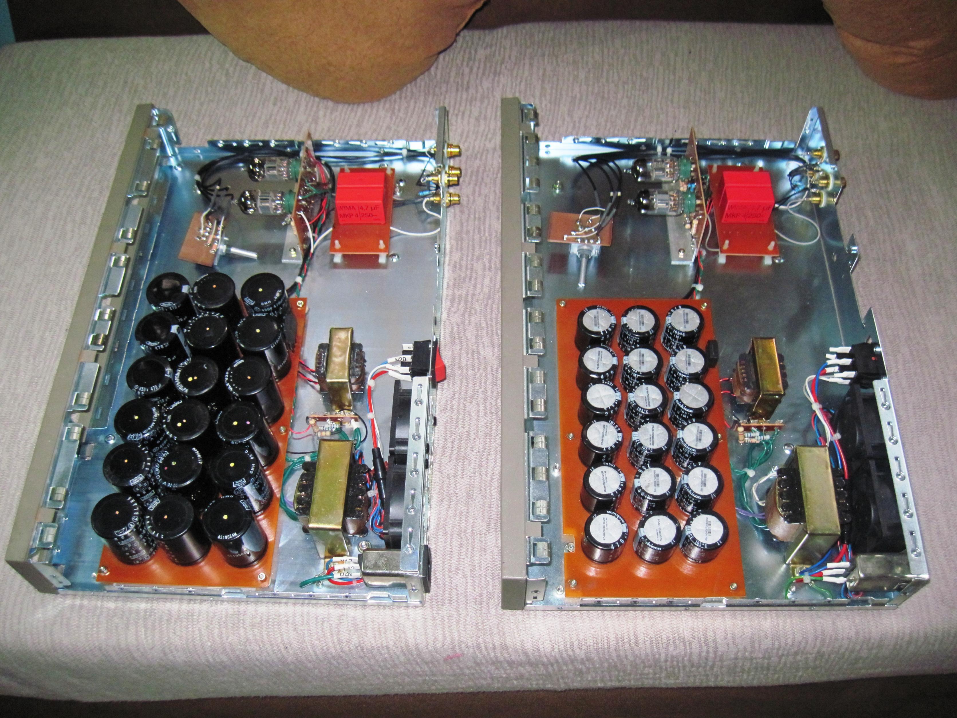

i had a client about 8 years ago asked me to build him a 6H23 ccda line amp....he specifically wanted as many caps i can put into a router casing.....who am i to tell him he is nuts????? 😀

No biggie capacitors like 1000uF's involved there..... no obsessive banks of cans like I see in these photos.....
