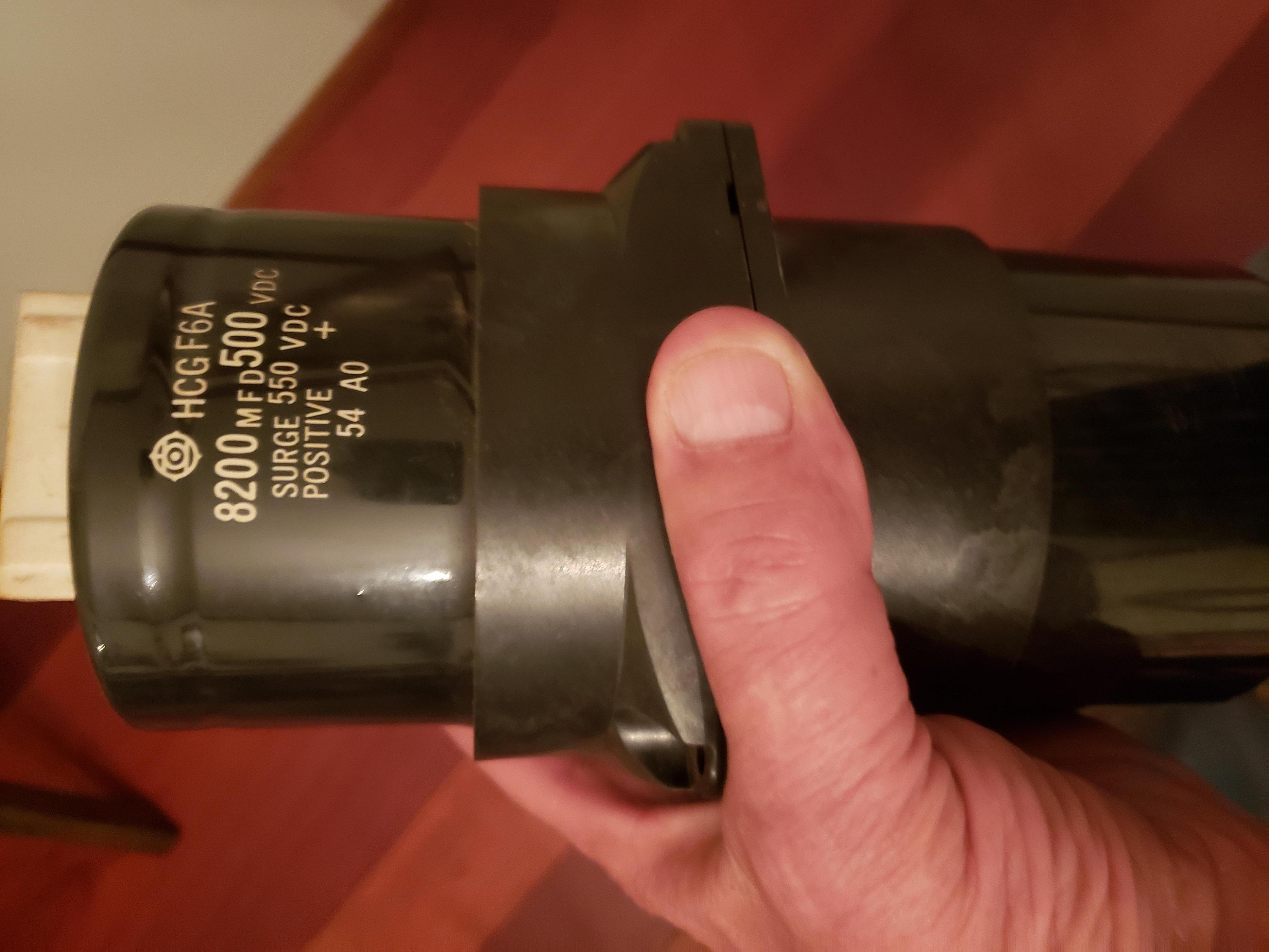

Just curious, how many of them do you have? Currently building another magnetizer.
My son is coming over to the house on Sunday so we'll see. He rescued a bunch of rack mount and general networking / telco stuff from the dumpster too. Subsequent opinions in this thread indicate they can be used if cautious about safety, circuit, and taking the time to reform them in a controlled manner.

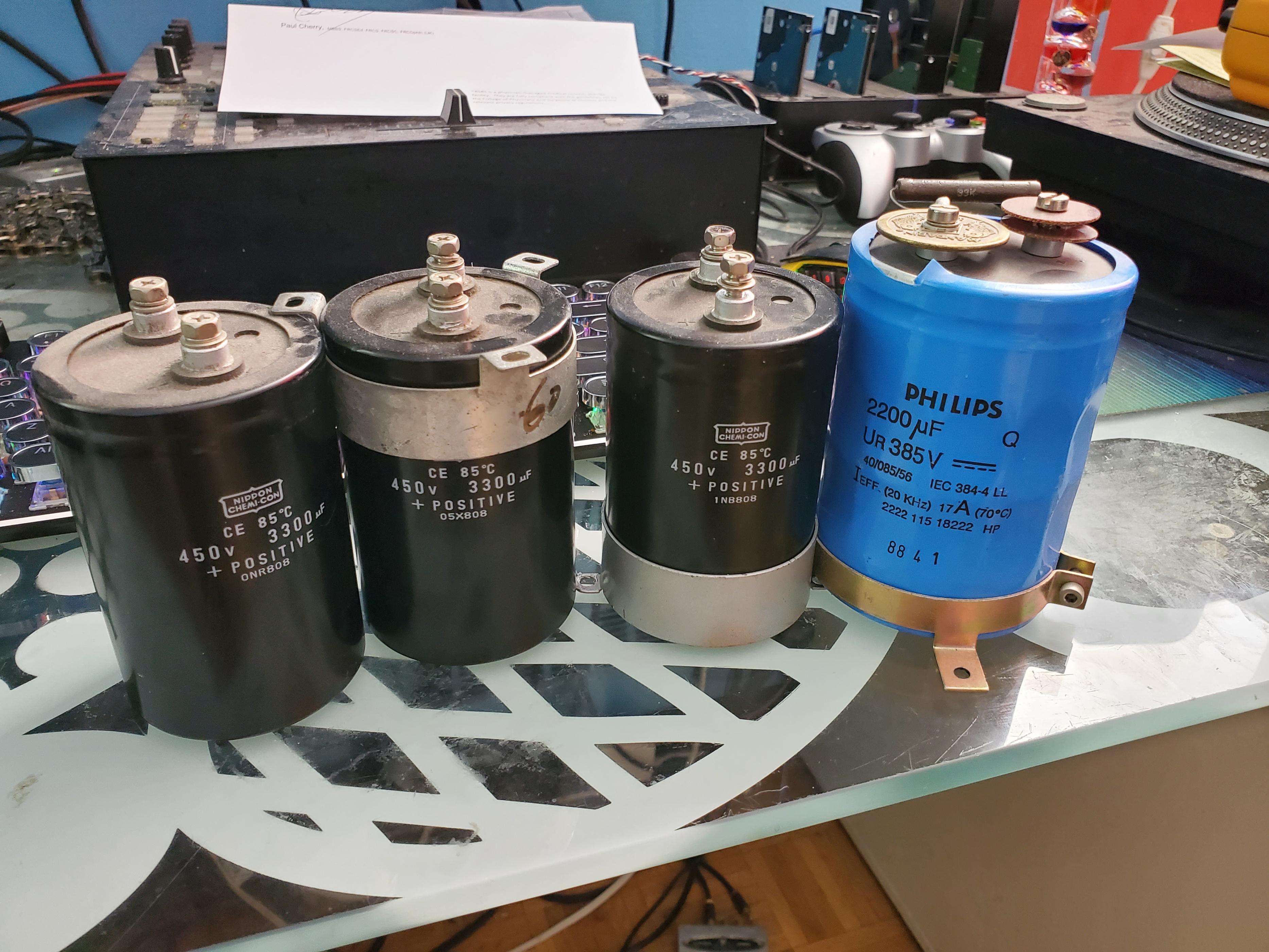

The black ones were pulls from a UPS so they had probably been used within the previous year... I've had them for 2 years or so as you can see by the layer of dust!
The blue one is from 88/41 if that's a date code. I bought it for 5$ at a surplus place. Who knows the history of it but I threw 330V at it and nothing bad happened.

speaking of pulls, i had Cornell Dubillier caps with part numbers that do not appear in their websites.....
i suspect they were special orders for special costumers....but they tested very good...
3300ufd/450 wvdc, no vent seals, 2.5 inch x 5 inch tall

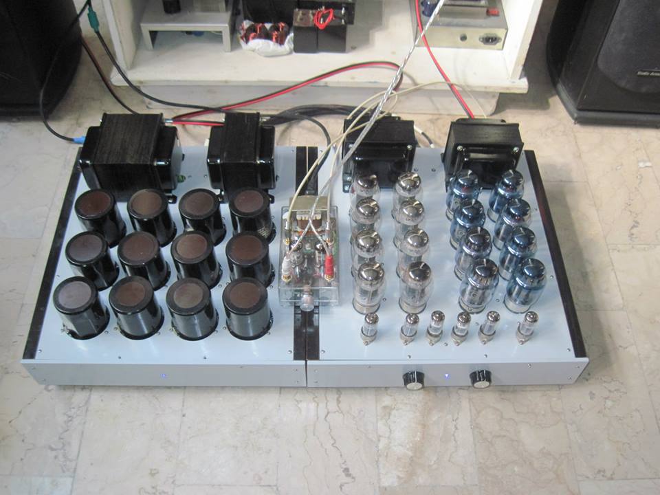

1400uF is overkill for a tube amp supply. You'd need a soft start circuit to fill it up.
it looks overkill alright, but consider this, the overall impedance of the power traffo even reffered to primary will be higher than that you find in SS amps, so that that alone will act to soft start the psu as the filaments brighten up....
also the dc resistance of the chokes, the series resistors installed all mitigate the start up currents....i even installed 10 ohm NTC's.....what's to be afraid of?
but the caveats follows, do not do this if you are unsure of what you are about to do......
I would never do this with small electrolytics though. Just replace them with aluminum polymer caps and they will outlive you.
me too, small electrolytics are not worth the effort, just replace then with new ones and when opportunity presents itself, and when film types can suit in, then by all means do it.....
i made a 16 kt88 triode mode pp amp years back, the separate psu block contained a lot of 470ufd/450volt caps wired in series parallel connection...
