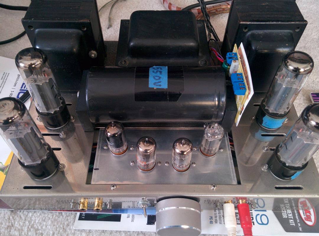

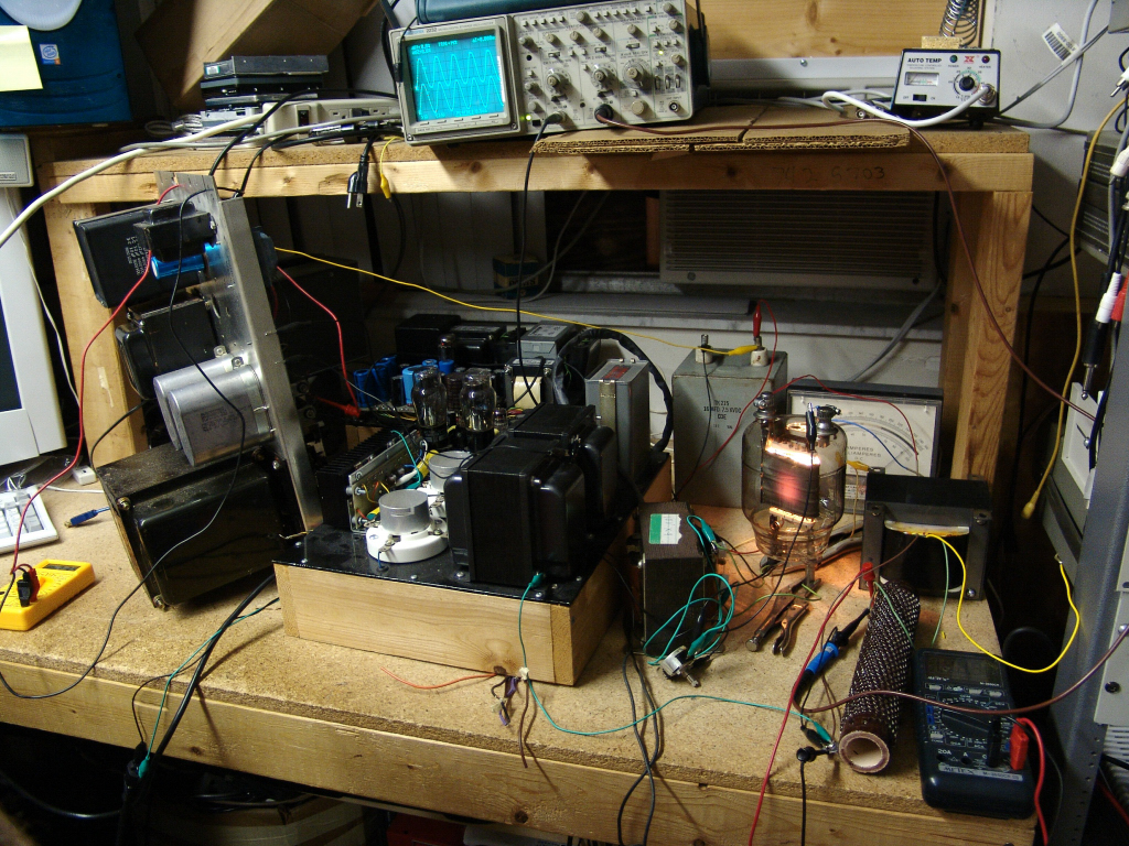

9100uF on 6C33C B+
FWIW, I also use the big blue computer caps on B+. Each B+ on my 6C33C OTL mono's have a CLC supply. The first cap is a 4700uF bule can. The second is a pair of 2200 snap ins. The amps sound great. Fast, natural and uncolored. Each mono has about 20000uf total caps in the PS.
