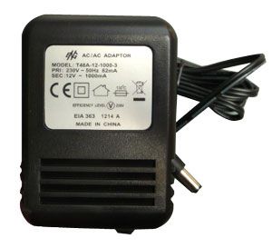

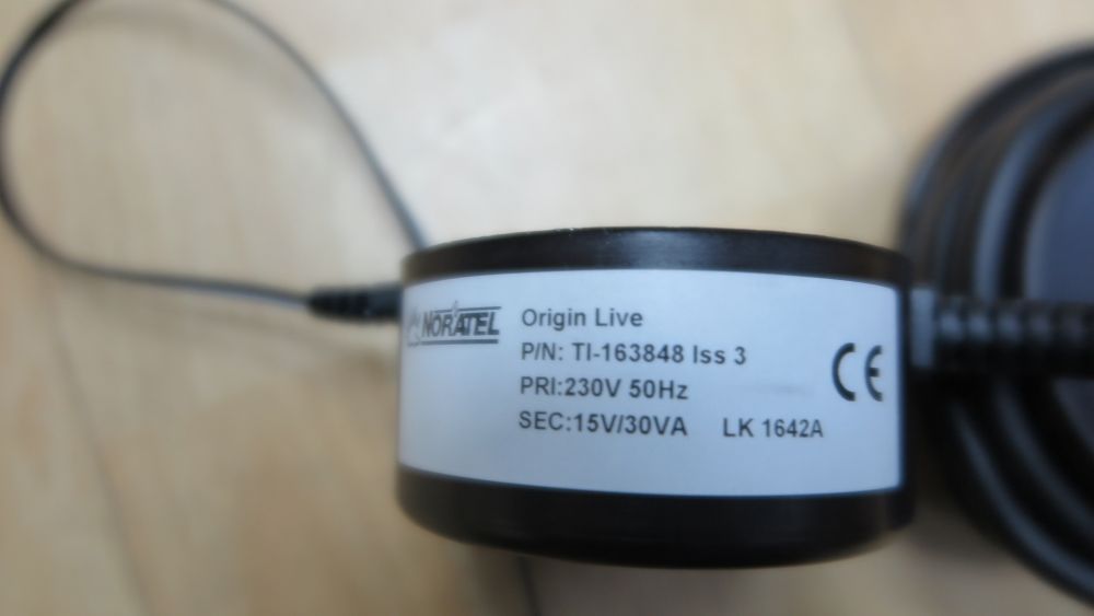

The OL controllers are not designed to run from 9v. Where did you get this information? The original wall wart, as supplied by OL, is a 12v transformer. It supplies 12v AC. The first step up the upgrade ladder is the round transformer which is rated at 15v AC.
These photos were uploaded from OL website.
Their top model upgrade is the large balanced transformer. This is boxed so I can't see the rating but it is also 15v AC. I think it is 300-400VA.
The small 12v transformer will give, after rectification, a DC output of about 19v.
The round 15v transformer will give about 23v as will the large balanced transformer.
The voltage across the power supply cap in the controller will be about the same using OLs power supply as it is using your 24v supply. I ran my Advanced controller from 24v supplies for 5-6 years with absolutely no problem.

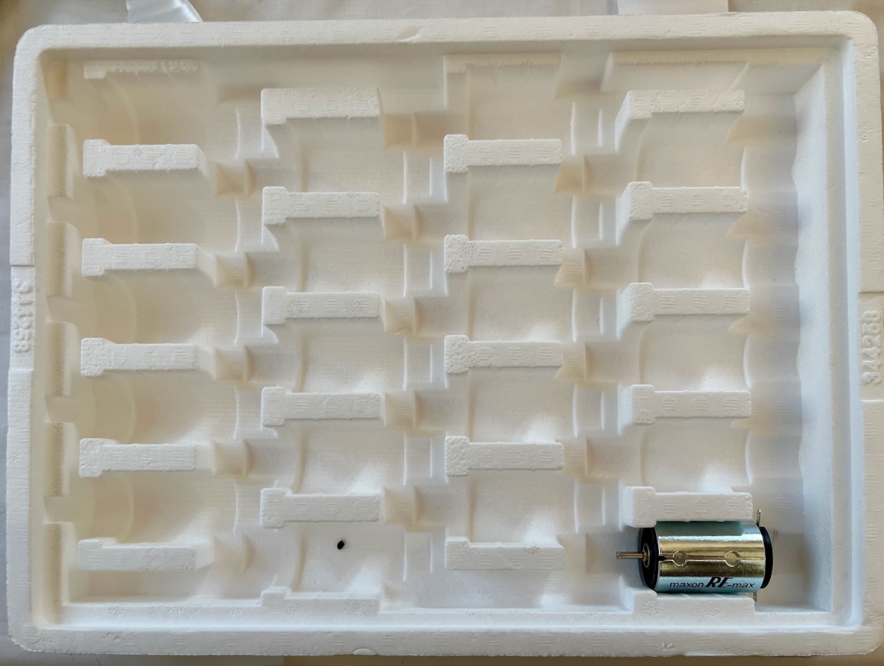

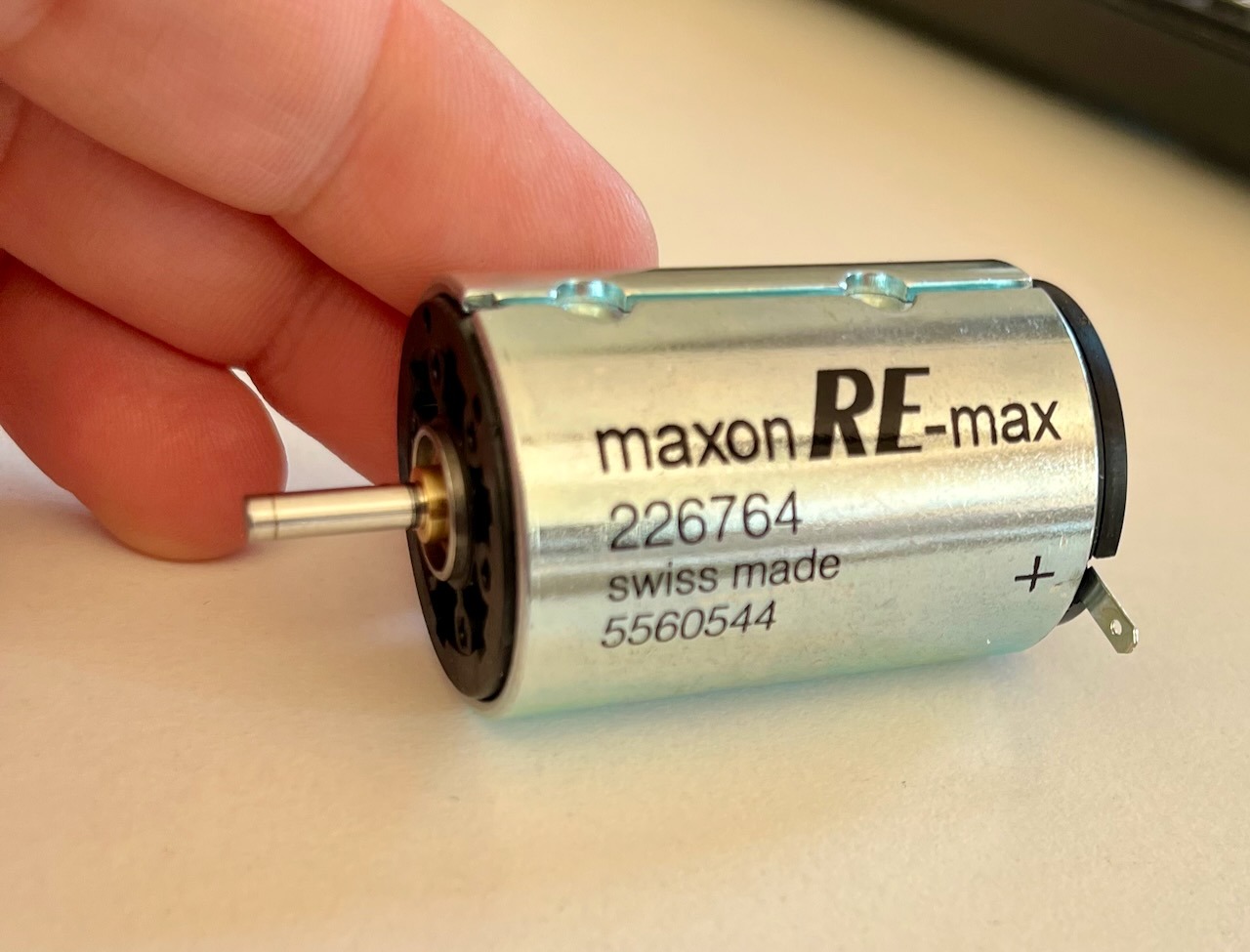

I selected my Maxon motor so that the controller would be outputting around 5v, seemed like a good healthy voltage. OLs decks run the belt around the outside of the platter. Using the same premotec motor as they did on most of their TT range when I purchased the controller would require around 4.5v for 33 1/3rpm. I figured that if OL aim for 4.5v for their own decks this would be a safe option.
With the Sondek, which is the main deck upgraded with OL, the output voltage would be around 2.4v.
All DC motors have a specification called the speed constant. This is the motor speed per volt (RPM/v).
To calculate the required speed constant ;
Divide the sub-platter diameter by the pulley diameter.
Multiple this by 33 1/3. This will give the motor speed.
Divide this by the required controller output voltage.
This will give the required speed constant.
The Premotec 18105, as used by OL, has a terminal resistance of 12.5Ω. I would be cautious of using a motor with a much lower resistance than this, 6Ω?. Higher resistance shouldn't be a problem. Bit like not using too low an impedance speaker on an amplifier. My Maxon is around 100Ω so is safe.

By the way, today I am expecting the Maxon RE-max 226764 motor. But it will take me some time to have a new motor pod created, that will allow me to perform the various experiments I have in mind. One thing at a time, so that I can appreciate the respective improvement (or deterioration).

It's very exciting about the arrival of your new MAXON DC motor!! Can you confirm the voltage of your current AC-DC supply for the SCU?
Sondeknz,
with my current Premotec motor the voltage is 2.52V, if that's what you are asking. As soon as I receive the Maxon motor, I will inform you about the voltage.

Hi Sondeknz,
sorry for the misunderstanding. My power pack provides variable output ranging from 3V up to 12V. With less voltage the motor runs more quietly, so I tend to use 7.5V. But to be honest, I have not experimented long enough with the input voltage.
https://www.amazon.de/gp/product/B09FT9DHSQ/ref=ppx_yo_dt_b_asin_title_o01_s00?ie=UTF8&psc=1
If I remember correctly, the Origin Live people advised to try a 15V power supply (I have to check my emails to confirm).

And while I was reading your above post, the door bell rang, and this is what was delivered. A big box (but no so heavy in reality). So, I open the box, and what do I see? Just one small motor. Anyways, not bad at all. Just what I have been waiting for. -))
I will definitely go ahead with the caps upgrade. And what is the takeaway about an additional bypass cap? Yes or no?
Panos,
Your MAXON has arrived... YIPPEE DOODLE! The fun begins!

Yes, it has arrived and connected it for a just 20 seconds to the controller. Yes, the motor turns, which is a good start. It is quiet. At some point you can hear some noise come and go, but this is probably due to the bearings that have not run at all. As a first impression, it seems to have much less vibration that the Premotec motor.
Of course, I will take your advice and connect the new motor when the new caps have been installed.
