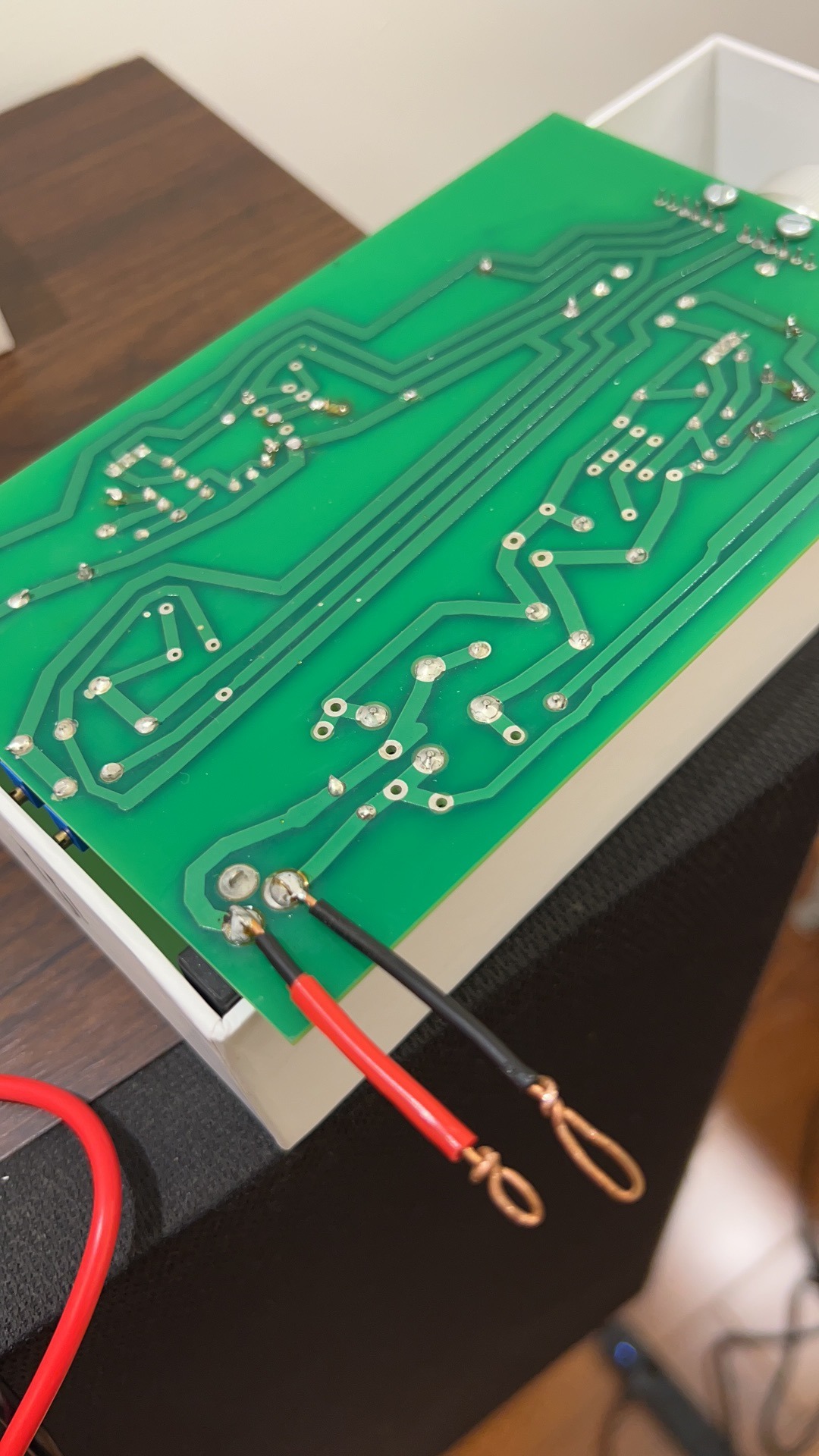

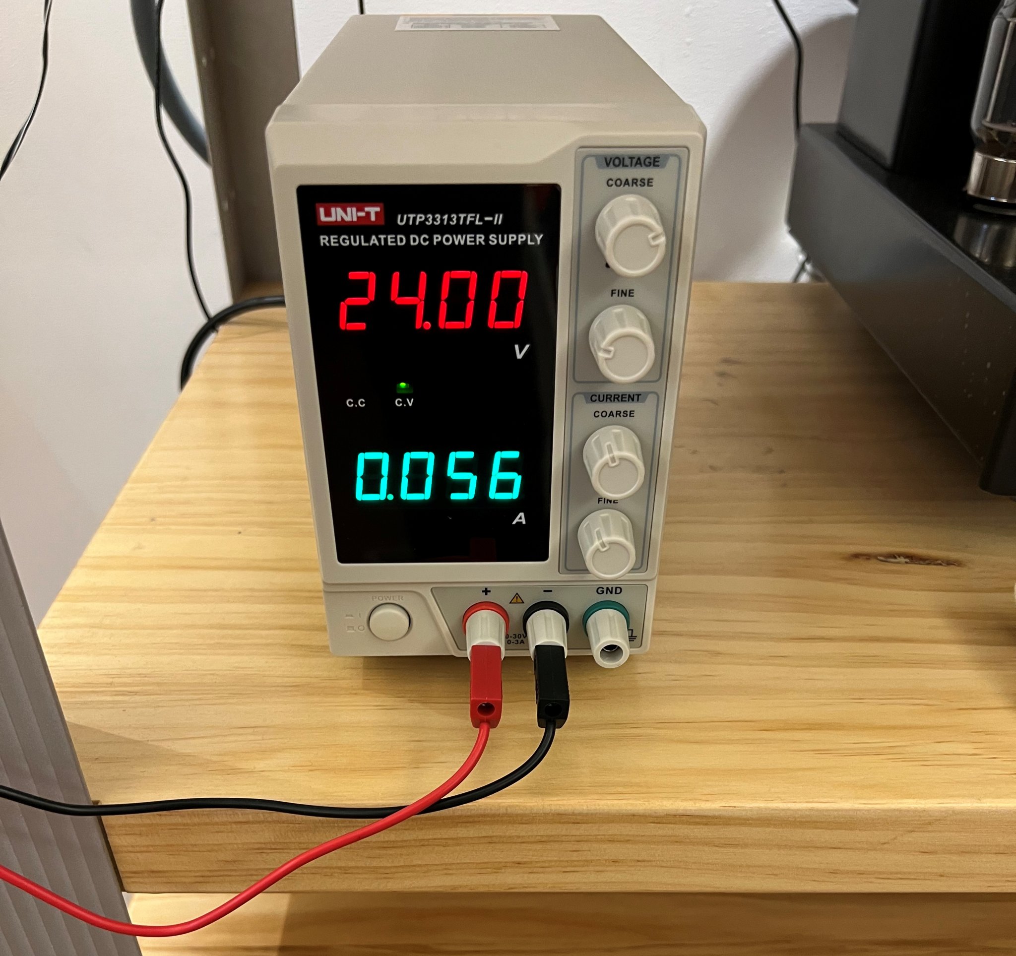

Over the last week or so, I have tested three different PSUs to power our OL DC SCU.
No major improvement in speed stability was achieved, until yesterday, when I finally tried a new LINEAR POWER SUPPLY [UNI-T UTP3313TFL-II 30V 3A 90W] delivering exact amounts of DC-24V - more than double the output voltage of the previous two PSUs.
(For safety reasons, I did not raise the voltage above DC-24V...)
In a nutshell, at DC-24V the speed stabilized nicely, and sound quality was primo.
Surprisingly, the speed drift problem still lingered, running the OL SCU at DC-12V, DC-15V and even DC-18V. I cannot explain why.
So, comments from Niffy in support of running the OL SCU at DC-24V input have now been verified before my own eyes and ears. Always pleasing.
Interestingly, some of the OL SCU PCB components started to get pretty warm at DC-24V - particularly the first stage voltage stabilizer transistor - and I was very glad that I had previously upped some of the resistor power-handling values (from 1/4W to 2W and 3W) and added some additional heatsinking to both transistors.
Summary: DC-24V works! But I must confess, that I suspect that the substantial increase in input voltage - from the DC-9V that OL recommends to DC-24V - is providing remedy to something else that is not quite right in the OL circuit.
From my perspective, a bit more discovery and testing of other ideas is needed, BEFORE deciding to permanently run the OL SCU on DC-24V.
Unfortunately, the UNI-T UTP3313TFL-II LPS had massive fans that ran full-time, so I have packaged it up and returned it. A nice machine in other respects.
If DC-24V supply is where I finally end up, I will definitely repopulate the OL SCU PCB with higher power handling components - and dramatically increase the uF of the ageing EL cap.
I welcome any thoughts on all this.

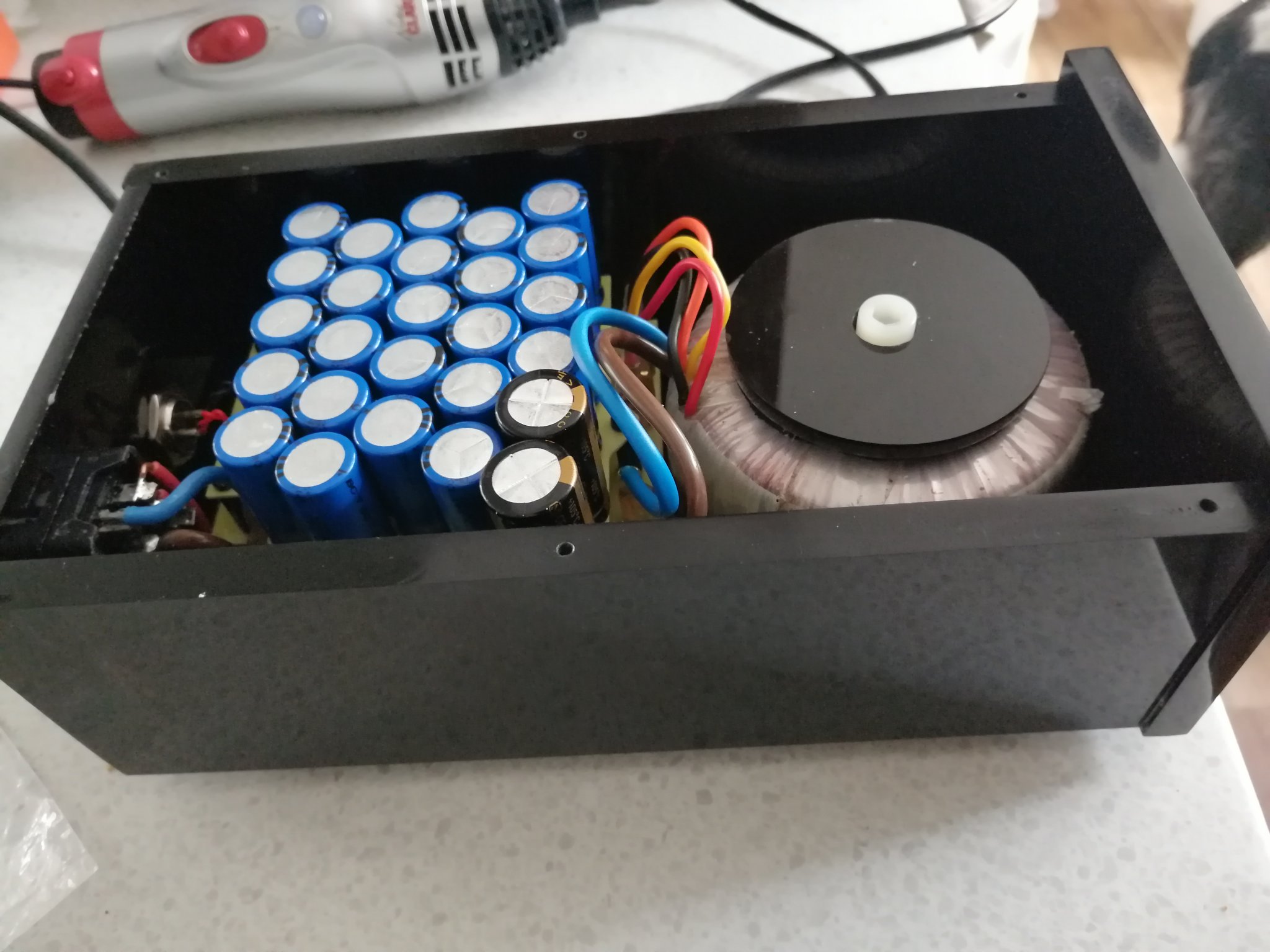

The Origin live upgrade power supplies are just a 15volt toroidal transformer in a box. The smaller round transformer, £160, is rated at 30VA. I don't know the rating of the larger £400 transformer though I suspect that it is in the region of 300-400VA. Both transformers are manufactured by Noratel in the UK.
A 230v/15v transformer should result a DC output of about 23v after rectification. A 24v DC supply will supply the controller with about the same voltage as OLs own upgrade supplies.
I have been running my Advanced controller from several different 24v DC supplies for several years without any issues. I don't think that upgrading components for reliability is necessary but if it improves sound quality then I'm all up for that.
The size and quality of the supply both make a big difference. My current supply, that I have been using for a couple of months now, is basically the same as you might build for a power amplifier. It is about the same size as my previous supply but uses higher quality components. Sound quality notably improved. It has a 120VA toroid and over 50,000μf of capacitance. It has a bit of filtering on the mains input as my mains is not the best.

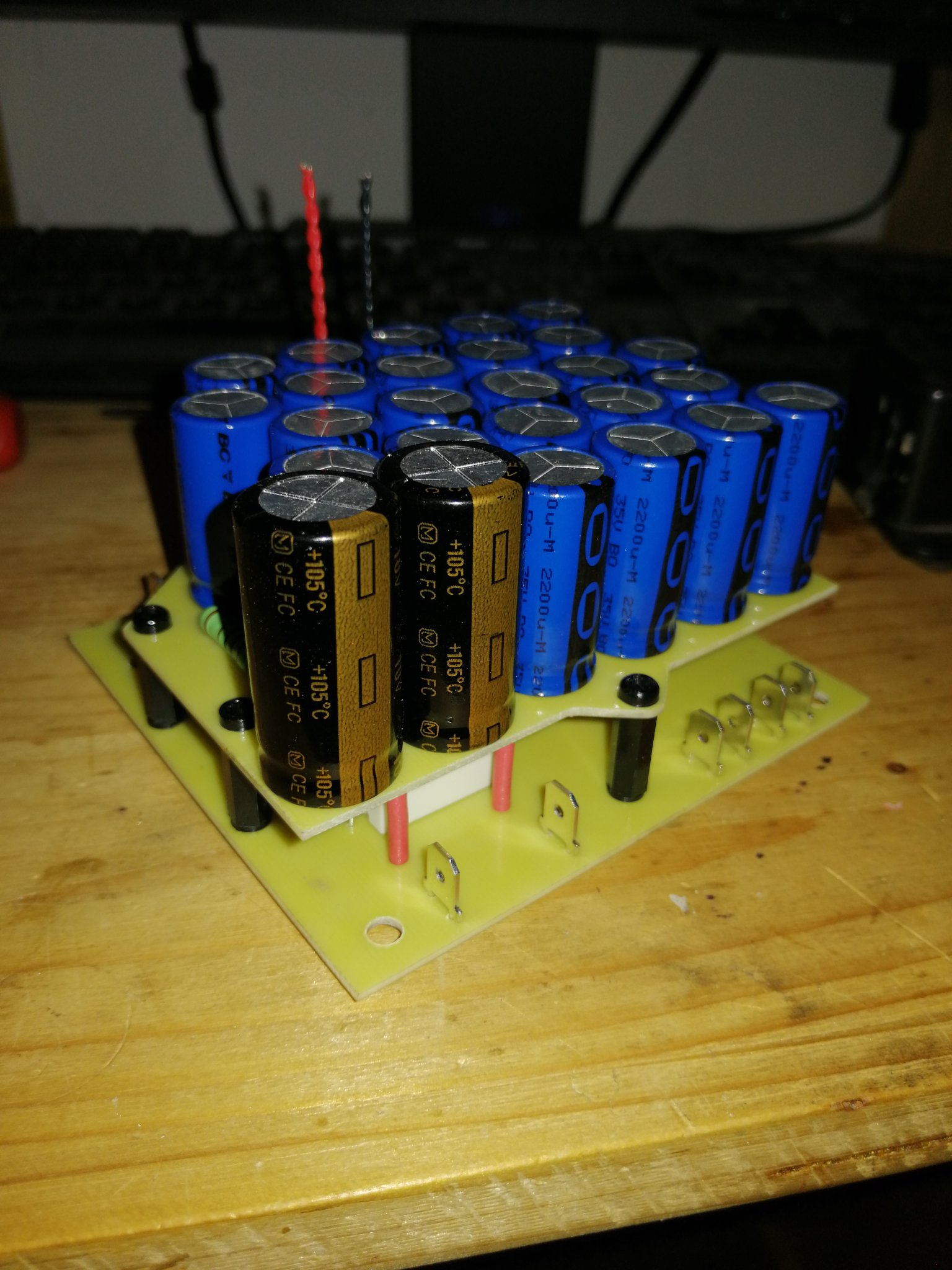

For anyone who is still interested in improving the ORIGIN LIVE ADVANCED DC SCU, I've finally made some progress.
Recently, I uprated all resistors to 2W Metal Film, at current specified impedance values.
Frankly, I could not hear any improvement - and the inevitable speed-drift continued - but I have no regrets in uprating, as this hopefully provides something of a safety margin, as I explore other further opportunities to improve this SCU.
Today, I removed the single NICHICON 1,000uF/63V EL cap and replaced it with two NICHICON 4700uF/63V EL caps, wired in parallel.
Following this change, I needed to again recalibrate for 33RPM - a process that continued to require adjustment for the first 30-mins or so of play - all the while listening and measuring speed.
There was a nice sonic improvement immediately obvious after the new caps were installed. A nice surprise.
What I wasn't prepared for was the rather dramatic improvement that continued over the first few hours of playing. I guess the new EL caps were (are) continuing to "form" to slowly become their best. Not sure how long that takes.
A few hours later, it's a bit of a shock! I am now listening to LPs my parents owned - well-known albums that I have listened to my entire life - and I'm hearing them anew! I kid you not!
I am keeping a close eye on speed-drift, which also seems to have improved - but I feel it is too early to say for sure. I will need to listen and measure some more, particularly during the peak power usage periods around our way, which previously always had a big (negative) impact on speed stability.
I am still running our OL ADVANCED DC SCU on our iFi iPower DC-9V wall wart - with its active noise cancellation circuit, but in an attempt to achieve rock-solid speed stability, am still preparing to move up to DC-24V.
These interim sonic steps forward are a real unexpected bonus and will hopefully hold the OL SCU in good stead, for when the new 24V PSU arrives.
I had better get my act together and actually choose a 24V PSU! 🤣

I had expected that improving supply voltage stability and reducing noise by adding a voltage regulator would improve matters. As the current drawn from the supply was less than 100mA I figured that a 1.5A capable regulator would give me plenty of headroom. The transformer I used had 18v secondaries so would give around 30v before the 24v regulator, a nice healthy drop off 6v. This set up killed the dynamics and resulted in a shoebox size soundstage. Swapping out the transformer for a 15v model from the same range (nuvotem talema 25VA encapsulated) and removing the regulator gave the same 24v output. The resulting sound quality was vastly superior. It would appear that instantaneous current delivery is more important than noise in this application. This is not dissimilar to the effect of sticking regulators in the power supply of a power amp.
My next supply used the 120VA 15v transformer I'm currently using (nuvotem talema open toroidal) and a couple of 22000μf caps. The caps were nasty cheap ebay no-names. The sound quality from this supply was notably better than the previous small supply.
My current supply uses 24 Vishay 2200μf caps that are much higher quality than the previous big caps. I used these as they were left over from another project. I don't know if the improvement they wrought was due to using a big bank of smaller caps or their higher quality. Maybe a bit of both.
My experience would suggest that a higher current supply is more important than a lower noise one. OLs own upgrade supplies are just a bigger transformer with just the single 1000μf cap for smoothing. Probably not going to give the lowest supply ripple.
