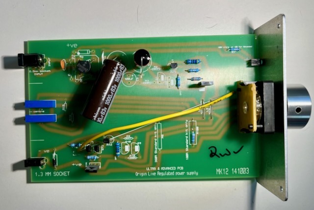

Today, I removed the single NICHICON 1,000uF/63V EL cap and replaced it with two NICHICON 4700uF/63V EL caps, wired in parallel.
although I am not knowledgeable in electronics, and please correct me if I am wrong, I understand that polypropylene caps are usually more precise and more reliable than electrolytic caps. Why didn't you go for polycaps instead of the EL caps you chose?

I also opened up my OL controller box (for the first time!). I realize that the controller board is designated as both Advanced and Ultra (dual personality? -))
Anyways, I guess that I may proceed and replace the electrolytic capacitor with one or two 4700 μF caps. How about also adding in parallel a much smaller capacitor, say 100 μF, to play the role of a bypass cap (that's common practice in crossover networks, as you probably know).
Any comments?
P.
Any comments?
P.

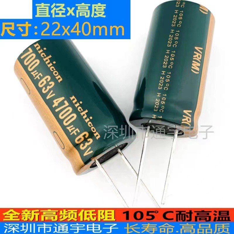

Hey Panos!
When it comes to filtering noise from circuits, bigger uF capacitors almost always do it better.
There are complex formulas for calculating such filter capacitance values - plenty on YouTube about that - but as a learner myself, I'm not the right person to step you through that.
For every dollar they spend, manufacturers need to add (rule of thumb) at least $10 to the final sell price, so understandably most manufacturers install the smallest and cheapest capacitor to get the job done. We understand - they need to work to a budget and turn a buck.
I don't need to multiply my investment, so I am happy to spend a bit more.
But there are a couple of other considerations other than buying a giant capacitor with adequate power handling.
Firstly, physical size and form-factor. It's got to fit the project!
Secondly, going overboard with a gigantic uF value cap could be very difficult to charge-up - especially with the DC-9V feed that I am currently working with! At worst - depending upon the project - this charge difficulty could potentially blow fuses or trigger protection circuitry to kick-in. Nobody is looking for those fun and games.
The NICHICON 4700uF / 63V EL caps I found offer a great compromise between capacitance value, power handling and form factor - in a brand renown for long life and durability.
Also, because of the size of these NICHICON caps, I knew that I could potentially fit 2 or more of them on the PCB, if I wanted to. This meant I could progressively install them and check the resulting impact on sound quality after each increase.
Two (paralleled) sounds better than one IMHO, so two it is!
It will be interesting to see how they perform when the OL SCU is fed with 24V - instead of 9V. As you know, I have up-rated all my resistors on the PCB for 2W power handling, just as a precautionary measure.
Again, I leave the platter to spin overnight, in order for the caps to form - and make friends. It really makes a difference.

The free space on the board, labelled with the arrow, is paralleled to the main 1000μf capacitor. This would be the ideal place to mount the second cap.
I think that the component above and to the right of this is a bypass cap so you won't need to be adding another one. I haven't looked inside of my controller so I'm not sure what the value of it is.
