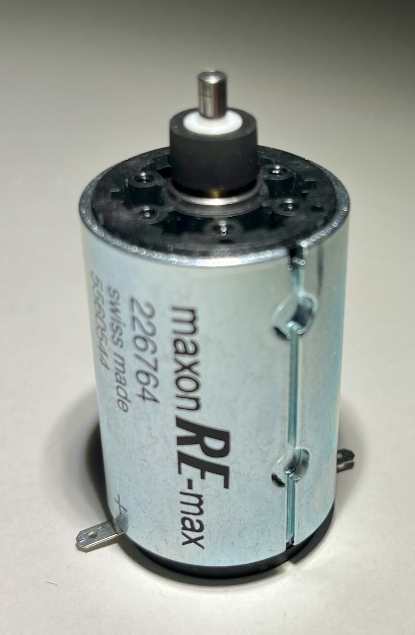

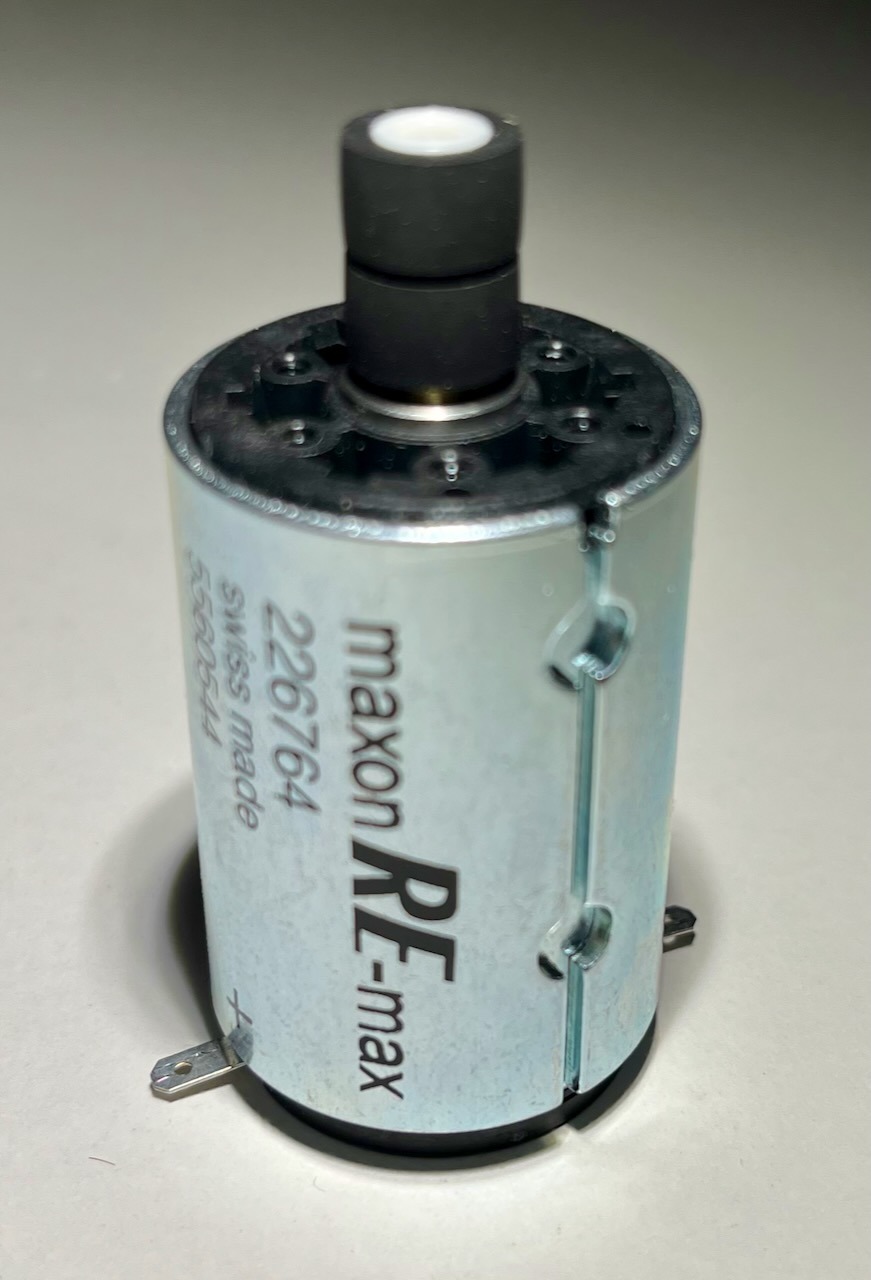

By the way, I know it may be off-topic, but since we are also discussing about the motor (apart from the OL controller), I've received a few components, that I am going to try as pulleys. The first two are for rim drive and the other two for belt drive.
Hey Panos,
Not off topic at all. Looking forward to reading all about it. Great to have pics too!
Are the pulleys held on by grub screws? If not, how do you get them on and off without damaging the motor?

Hi Sondeknz,
thanks for the feedback about your model of Nichicon caps. So, they are not the so-called 'audio grade'. Good to know.

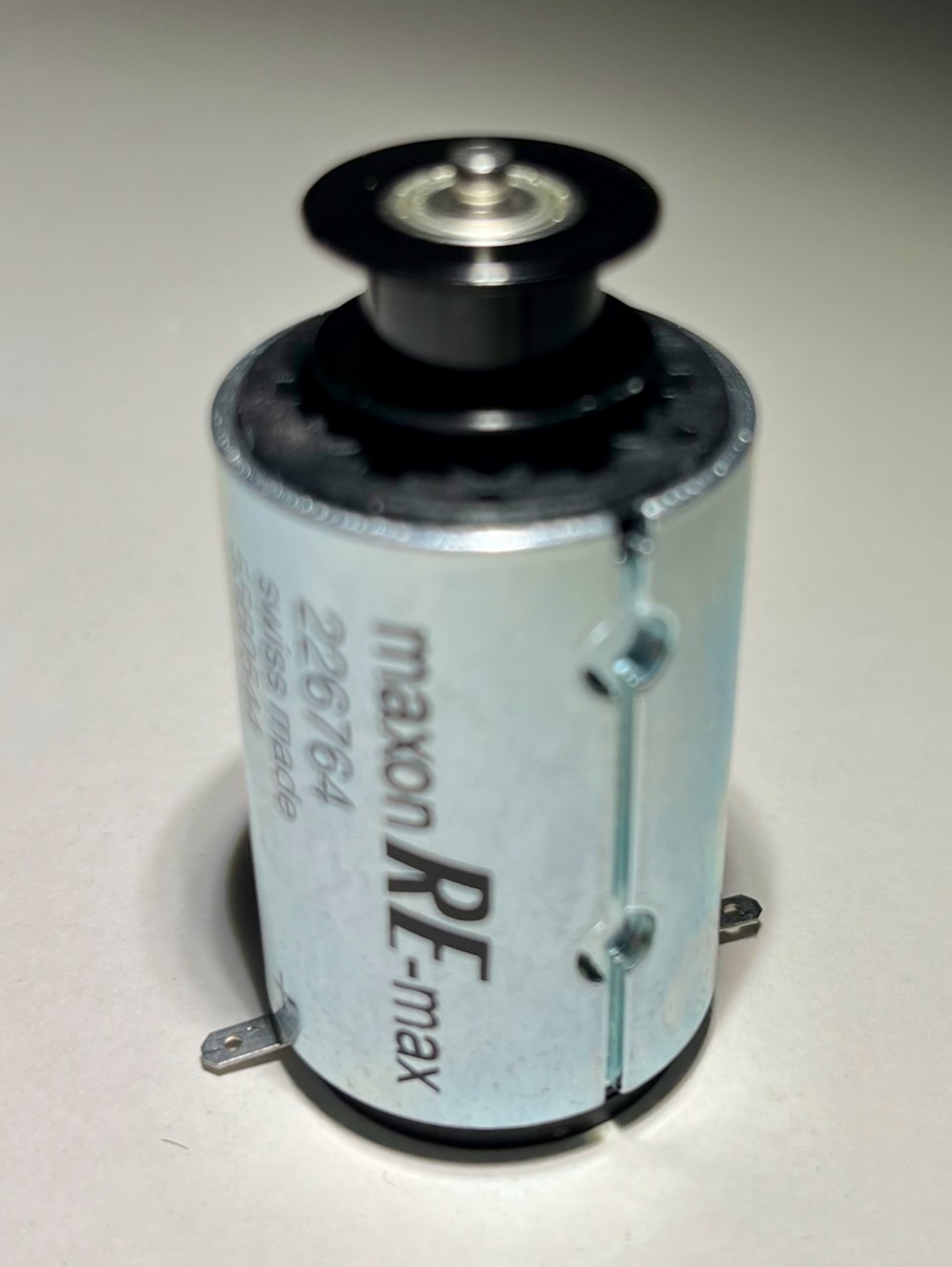

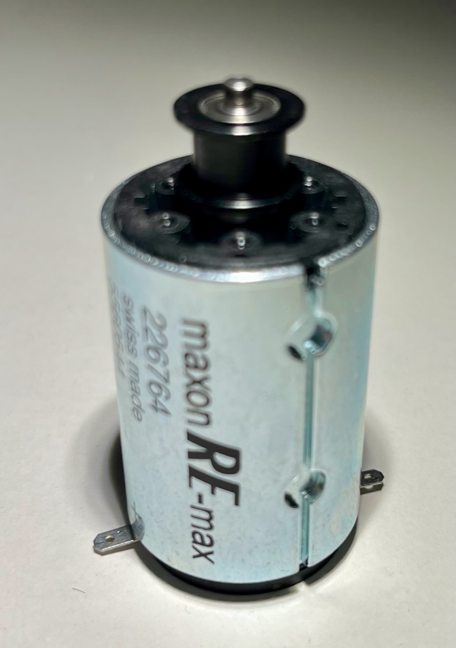

No, as a matter of fact I have not fastened the pulleys in any way yet. I just placed them on the motor shaft to take the photos. No pulley contains a grub screw. And their bore diameter is 3mm, i.e. equal to the motor shaft. This means that the pulleys slide into place. And two of them also include bearings. My idea is to use one or two drops of glue (or superglue), to fasten the pulleys on the motor shaft. I know it's not the most elegant solution, but I guess it will work.
If you (or anyone in the thread) have other ideas about attaching the pulleys on the shaft, please, speak up. Thanks.

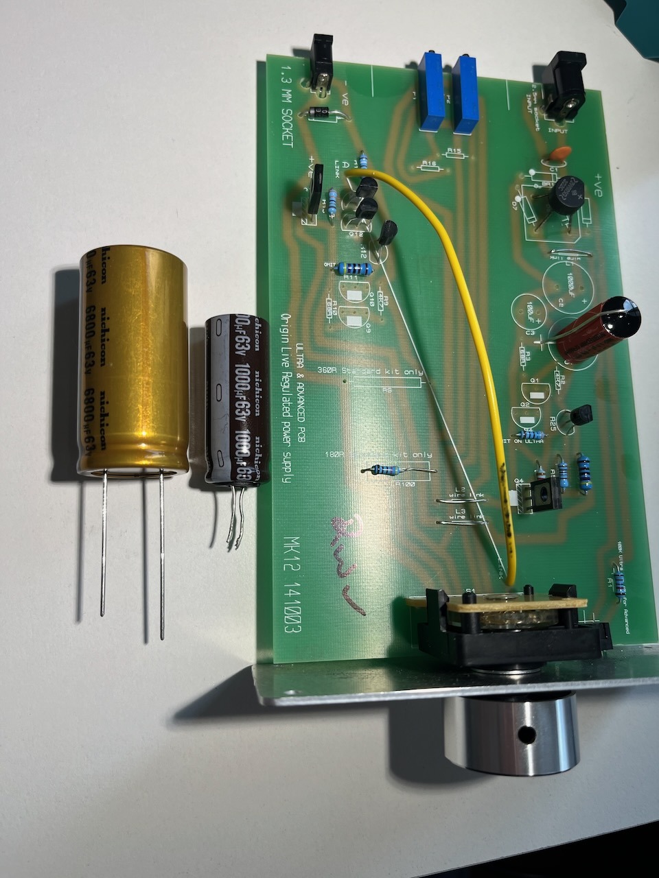

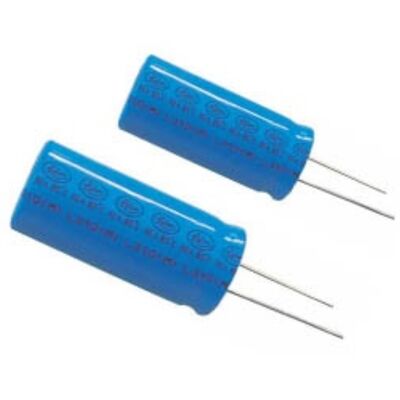

I am really struggling to find 4700μF / 63V capacitors, which are NOT snap-in, i.e. have wire leads. Are 'radial' capacitors vanishing from the market?
I have found a couple of axial capacitors with the right values, as well as other brand too (i.e. LEL). Would they be OK?

Excellent news on the arrival of your new baby. I look forward to hearing about how this motor works for you. If you are currently running your premotec at ~2.5v I would expect that you will need over 10v for the Maxon. You might need to up the voltage of your power supply in order to get to run fast enough. I don't know what the maximum output voltage of the controller is, minimum is about 1v.
As the maximum voltage that you are likely to be be feeding the controller with is only 24v the capacitor don't need to be 63v. 50v or even 35v would be perfectly adequate. A lower voltage capacitor will be smaller for the same capacity and more likely to have leads rather than snap in tabs.

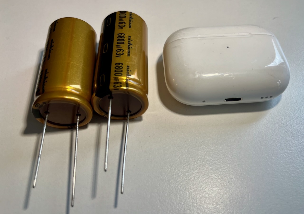

thanks for your kind wishes. I now have to have a sturdy / heavy motor pod built, that can accommodate both use cases that I intend to test (belt-drive and rim-drive). I would like the motor pod to be decoupled from the plinth and also allow for some height adjustment (+- 3cm). I do not know whether you have any recommendations or advice about what to pay attention to.
With respect to the Nichicon caps, I already had pulled the trigger on the 6800μF / 63V just before I read your post. Had I not been hasty, I might have saved some money and would have perhaps more choices. Anyways...
Panos
Wow, that's what I call FAST delivery. From Poland to Greece in less than 24 hours. And I did not ask for expedited delivery. Kudos to TME and DHL!
Then again, I cannot say that I was not surprised by the size of the caps... I will have to figure out how to fit those two bad boys in the controller box. 🙄

Panos,
Looks like your new caps measure 25mm x 50mm. At that width, the first cap will snuggle-in nicely between the 1uF polycap and the bridge rectifier.
I recommend a thin "mattress" of BluTac for the capacitor to rest on, which helps keep it in place.
I'd still recommend starting with just one new cap - particularly because its uF is quite high - and have some time with one new cap, before diving into fitting the second cap.
With the new cap in place, if you find that you are able to successfully increase the transformer voltage supply to 12V on your switchable wall-wart - without the motor vibrations that you experienced with higher voltage input earlier - that would be the best time to think about fitting the second cap. Not before.
[I worry that charging 02 x 6800uF caps (Total 13,600uF) with your present 7.5V DC supply might be difficult for your transformer - and cause problems...]
If you have any other concerns, just reach-out for some detailed thoughts.

yes the dimensions of the 6800μF cap are exactly the ones you said. 25mm diameter and 50mm body length. In the photo you can see how it compares with the current 1000μF cap.
I will try to do the soldering in a while and try to increase the voltage to the maximum my power pack can support (12V). I will report as soon as I can.
Thanks for the support -)

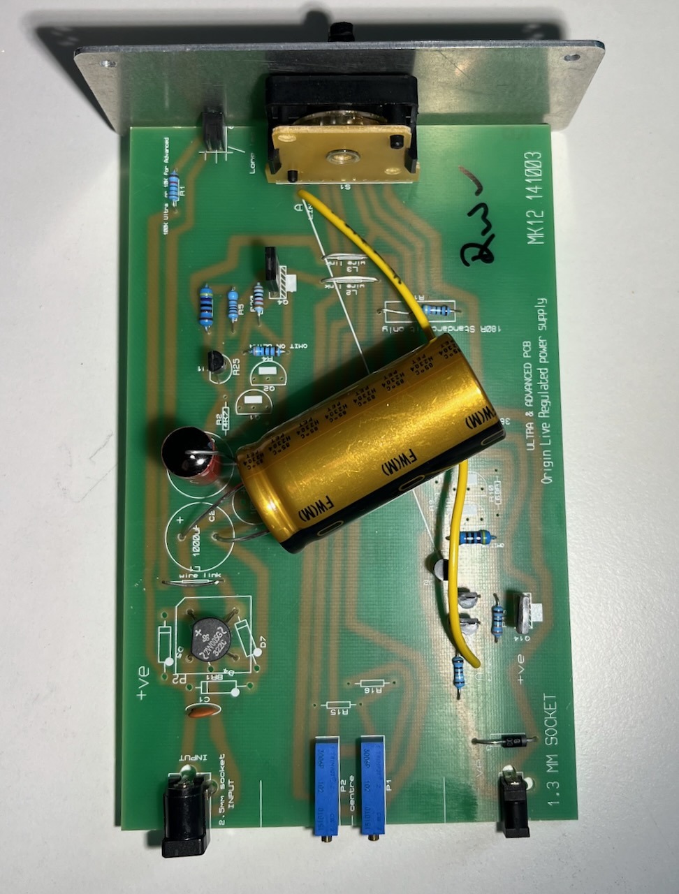

Hi again,
here is the new cap soldered on the board. It fits, but installing also the second cap will not be an easy task. I will consider it at a later stage. I have also increased the power pack to 12V and after connecting the controller (with the new cap) to the motor, the motor vibrations I could feel in my hand have simply vanished. And the Promotec motor is dead silent. Even placing my ear 1cm from the motor, I can hardly hear it running. Very nice!!!
I have not been able to have a listen, since my Roksan Xerxes has been moved from its usually place, substituted by a renovated Lenco L78.
For the moment I have left the motor running (with no load), so that the cap can form. And later I will connect my new Maxon motor so that its bearings can run in, too.
Let's see. It seems that the cap may prove to be a nice upgrade after all...

Hey Panos,
Nice work!
Great to get a good result with your DC motor performing smoothly under DC-12V supply.
It seems that our suspicions about the (removed) 1,000uF cap have now been confirmed.
There is still space on the PCB to fit both caps - but you probably need to move the newly fitted cap and park it straight between the 1uF and the BR.
Happy to circle this, when you are ready.
As an aside, I'm just in the process of ordering a decent CAPACITOR TESTER, as testing capacitors and ensuring their operation is pretty foundational with these electronics projects.
