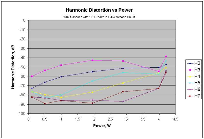

Speaking of the breadboard
Yeah, they are handy. Here's some preliminary distortion measurements of a pair of 5687s in cascode as the voltage amp. NO choke around the anodes, but the 15H in the cathode of the 12B4 pair. Clipping seems to set in earlier and harder and I'm not sure why. Shouldn't be overdriving the 5687 grid. May not be near optimized, although I tried quite a few settings. Couldn't get differential to work well at all. May be too much mismatch in the tubes and I've only got a couple.
Sounds very nice but not at all sure it is as good as the 6SN7 with 75H choke
Michael
Michael

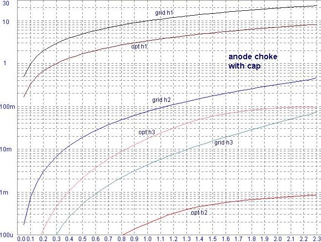

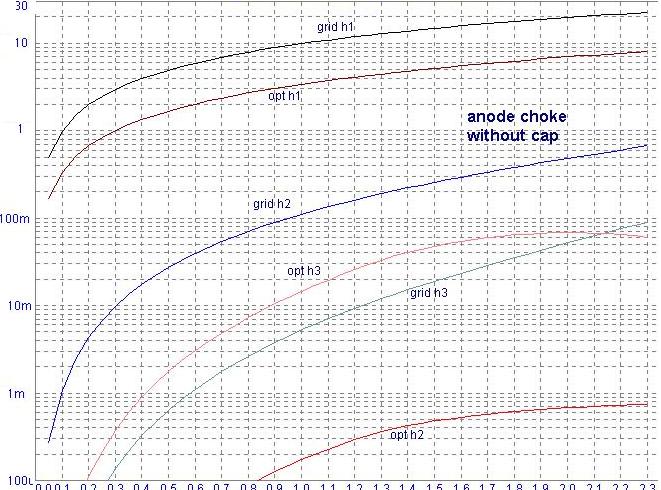

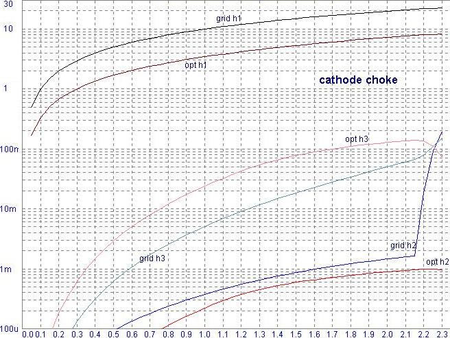

Hi Michael, All
I was very busy during these last days.
However I made a lot of stimulating study about your circuit.
It certainly is a perfect one to investigate on and to learn a lot of
things.
I changed a bit the model of my 6sn7 since my results were too
much distorted in respect to yours. I think the reason may be one of
the following two:
1) your 6sn7 are high quality tubes while my model refers to worse tubes.
2) due to some reason ( input transformer or too low input impedance) the input
of 6sn7 is distorted and cancels some intrinsic distortion of the tube resulting
in a better performance.
However the result in this new condition are:
Anode choke Vk=5.62, Vp=169
12B4 grid...................OPT sec
22.3V.........................8.0V
654mV.......................(0.74mV)
86mV.........................61mV
Anode choke with ultrapath cap
442mV.......................(0.84mV)
69mV.........................96mV
catho. choke Vk=5.97, Vp=179
(reduced input to avoid clipping)
21.7V.........................8.0V
19mV.......................(1.0mV)
79mV........................134mV
in agree (qualitatively at least) with yours.
I have some problem since I noticed to be very near clipping conditions
This is to be avoided. Thus I repeated sim with variable input.
I obtained these pics. Attention: left axes is in Vrms while orizzontal axes reports 6sn7 input amplitude (not rms but (Vpk-pk)/2).
I am very satisfied of these results since they agree with my hypothesis.
Bye
Federico

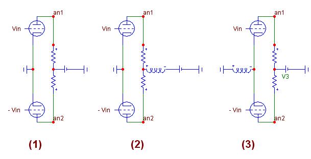

The choke issue - A little of theory
Hi Michael, All
A little of theory before facing to the optimization.
Consider the drive circuit reported in the figure, where Vin is the usual sinusoidal signal and, together with –Vin, it is the only independent signal source.
If for some reason (the presence of a current source or a choke), it is not possible for the current to flow toward node (a) or node (b), then, current will flow in the loop made by the two tubes and the depicted four elements and it can be mathematically shown that CURRENT will have only odd harmonics.
As a consequence of this V(an1,an2) and V(c1,c2) will have only odd harms.
If ,in addition, (b) is at ground for AC then V(an1) will have only odd harm and and V(an2) too.
If, instead, node (a) is at ground for AC, V(c1) and V(c2) will have only odd harms.
This irrespective of what the four elements depicted actually are.
Think about this.
Hi Michael, All
Think about this.
OK
Hi Federico,
Are you a professor, intent on making me do my homework? Ok, Ok, I will pull out my Circuits 100 and see if I can make sense of it.
I can only think that if b is not at AC ground and a is, then the odd harmonic current will not appear at the output. The loop current confuses me. Time to study I guess.
Michael

back to the real circuit
Excuse me, Michael
My intent was to focus your attention on the peculiar behavior of this circuit that, definitely, is not so simple as I believed last week.
Consider circuit #1 (I have used fixed bias to simplify things). It is the classic driver stage for PP output. One tube does not see the other. The output at an1 or an2 is perfectly single ended. This
Situation is similar to the presence of an ultrapath capacitor: current is not constrained to circulate in a loop.
In case (2) and (3) current flows in a loop due to the presence of the choke.
In case (3) the balance between (an1) and (an2) is provided by the value of the two resistors: if they are equal the V(an1) will be equal and opposite to V(an2) and they both does not contain even order harms.
It is not possible to influence this situation by means of a pot. in the cathode. Voltages are always balanced, since the reference ( zero AC volts) is between the two res. Yes, it is possible that unbalancing the cath. pot some amount of even order harm will appear in the current, but very little with a 50 Ohm pot.
Always in case (3) the cathode of the tube(s) oscillates a little at a frequency double than the fundamental. Signal at cathode have only even harm.
In case (2) V(an1) and V(an2) are balanced only in the sense that V(an1,an2) have only odd harmonics, this is important because means that even order harm will be cancelled in the following
push-pull stage. However V(an1) do have even order harm, opposite to the previous case (3).
The point in common to choke and resistors will oscillate as the cathode of the previous case (3).
A pot in the cathode will have a greater effect that in previous case since it will unbalance the path toward the reference that now is at the cathode. Unbalancing the pot will change the amplitude of
V(an1) and V(an2): the fundamentals amplitudes will be no more equal.
As you see, the behavior of the pot follows from the analysis.
Bye
Federico
