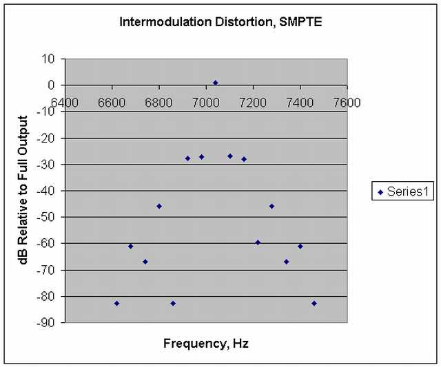

IMD
I measured, or tried, the SMPTE distortion method. The signal was one I downloaded and I am not sure if it is correct. I never looked at the output of the actual signal from the CD. Anyway the measurements were taken with 5.75Vrms measured at 60Hz and 1.35Vrms measured at 7kHz. Excuse the poor graph, I couldn't figure out how to get it to graph correctly.
If you have any questions, feel free to ask.
Micheal
Micheal

IMD
Hi Federico,
SMPTE is the Society of Motion Picture and Television Engineers. It is one of the standards setting groups for audio measurements.
The 155V was taken from a scope reading and is maybe off some volts.
Michael
Hi Federico,
Michael

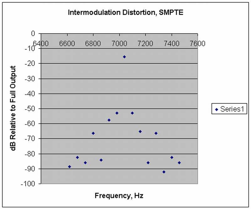

re:smpte
Here are the specs of the test: The SMPTE (Society of Motion Picture and Television Engineers) standard specifies a two-sinewave test
signal consisting of a low-frequency, high-amplitude tone linearly combined with a high-frequency
sinewave at ¼ the amplitude of the low-frequency tone. The SMPTE specification calls for 60 Hz and 7
kHz as the two sinewaves. When a non-linear device is subjected to a two-tone test signal,
intermodulation products appear as sidebands around the high-frequency tone. The percentage
intermodulation distortion is defined as the percentage of amplitude modulation, represented by the
second and third order pair of sidebands, of the high-frequency signal. Second order sidebands around the
high frequency tone are spaced at a frequency equal to the low-frequency tone (FH ±=FL). Third order
sidebands are spaced at twice the low-frequency tone or FH ±=2FL. (FH and FL correspond to the highfrequency and low-frequency tones, respectively).
In the case of the graph shown above, which was collected at an output level just below the onset of major visible distortion of the 60Hz signal, as viewed on oscilloscope, I think the number would be 2%. Interesting that the 3rd and 6th products on the high frequency side are asymmetrical with the low frequency side. I remember double checking those datapoints and wondering why the difference.
Michael
Michael

Cool
Hi Federico,
Most interesting. So it would seem that your hypothisis maybe finding support in the model. As I mentioned before, if there are any conditions you wish to have a measurement of or if you would like a repeat of any datasets I have given feel free to ask.
If I can ask, how closely do the results from equipment you have modeled and then built and measured usually match?
Michael
Hi Federico,
Michael

IMD with 15H cathode choke
I measured the SMPTE IMD with the 15H cathode choke, all else remaining unchanged from the results directly above. It seems to have increased about 10dB. I did not look for this to happen. Notice that the graph is normalized to 0dB for the 7kHz signal, whereas the one further back was normalized to combined output.
Michael
Michael
