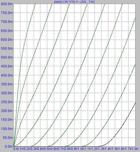

model

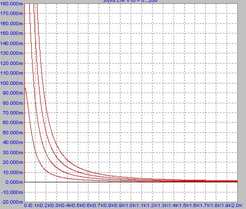

Hi
the instructions are here
at post #22 and #26.
I have just finished 845 model.
This are the model curves to be compared with
datasheet of T110-1 pag.9-25 (plate) and 9-26 ( grid )
Grid curves are not perfect but good for simulation.
I am preparing a library for you with all the model.
When it is finished I'll send you it and the cir file.
bye
federico
