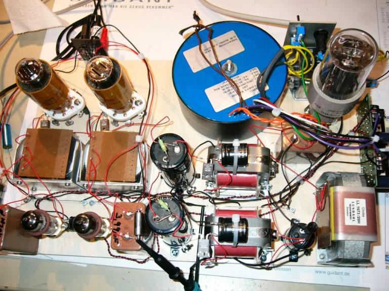

so, after a couple of testing szenarious; no news; the 12B4A Line Amp the noise (hissing like a waterfall) is still present and audible with my horn systems.
I did the following:
-bypass OD3 with 1,8nF cap's --no change
-change heater from DC --> AC heating with 6,3V --- no change
- remove first cap in PSU to lower B+ and remove OD3's --- no change
-swap some caps in PSU (bigger, smaller) --- no change
-change tubes; 12B4A; 5R4G, OD3's -- no change
-finally i use my high voltage power supply (Hewlett Packard) and plugged it to first cap --- no change
Any ideas guys!?
KR Hauke

Zen Mod said:
@barossi - tried cap from Ua to cathode ?
you didn't tell what's sensitivity of your amps ?
or I didn't saw that ...
what's sensitivity of your horns ?
what do you mean cap from Ua to cathode?
I will use the line amp as a smart driver for my bi-amping Horn system. Solid state amp for the 15" woofers; Single Ended 45 (Bugle) for the 2" Radian drivers and JMLC Horns from Musique Concrete.
..on my test bench i am using headphones; and of course it is very good audible with them ...
KR
Hauke

You have a very sensitive for SPL/W system and 12B4A is not the best for hiss. Has big cathodes and heaters. Your best bet is to keep the amplification factor low IMHO. Dynamic loading (CCS, Gyrator) or choke pushes the mu. Use resistor loading for the less mu and hiss possible, but expect more second harmonic, i.e. classic softer sound with less fine analysis.
I have the Terasonic speakers which are also extremely sensitive--104 dB. At full volume, with my ear 12" from the speaker, I cannot hear any hiss or hum--absolutely dead quiet. Same is true if I plug high impedance headphones directly into my 12B4 pre-amp. Amplification with 12B4 is already low--even with choke load. Using a resistor load won't change hiss by much, if the hiss is tube noise. You will drop only a few dB.
I have tried several 12B4's and I do not have hiss problems with any of them either. I did, however, have a bad 0D3 that caused hissing. However, I'm not sure I can put my finger on the problem. There can be a huge difference between tubes. In addition, heater voltage can really affect hiss as well. I'm running my 12B4's slightly starved--about 5.5V DC. I've noticed with 6CG7's that increasing heater voltage from 6.0 to 7.0 can multiply hiss by 4X or even 8X. I've also noticed that by selecting 6CG7's I can cut noise by a factor of 4. Based on the posts from some of the other members, it appears that there is a lot variability with 12B4's. I may just be lucky with a good batch. Then main thing I have noted is variability with microphonics.
But, with the huge hiss problem noted--one has to suspect something else is going on. The debugging done seems to eliminate the B+ and LT as potential sources of hiss. All that is left is the 12B4 circuit. Grids shorted directly to ground at the tube still hisses so that takes out the grid circuit. Choke fed eliminates the possibility of noisy load resistor, so unless the Lundahl chokes sing, that is not the problem. Output caps can leak--causing hiss, but I assume this has already been checked. Cathode circuit shouldn't audibly affect broadband hiss. All that is left is the tube itself and the input connection to the next stage amp.
Have I missed anything? The only other thing I can think of is external noise. I once spent hours trying to find a hiss source on my bench, and then realized it was coming from my lab light shining into the unshielded component area.
I confess I'm stumped at the moment.
I use about 6V with 12B4 and the hiss lowers. Starved heater works. I agree.
P.S. If your speaker uses a Lowther DX3, 104dBSPL/W is highly optimistic especially after 15kHz. DX3 is quoted 99.5dB alone.
Horns have completely different projection and if the tubes aren't the best or something more has to be done for hiss still, they can be very well accentuating.
