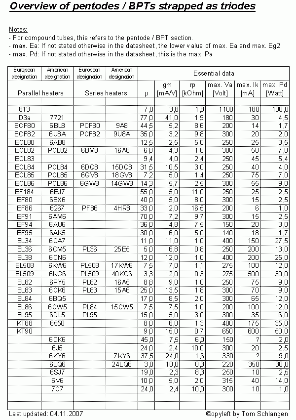

any measurements ( Ri, mu, S) or triode curves for EL86 ?
naah ...... 😉
disregard question , just found Tom's work in my PC
triode strapped pentodes

ok, i have not given up on this linestage yet but I have ordered some ecl86 valves, one is mullard yellow print, and the other is mullard white print. I bought these as i was unable to find 12b4 in the the UK and i just want to test my linestage for hiss. I have two 12b4's in the linestage at present and both channels have hiss, I am using ac heaters as dc heater produced more hiss..... so i have finally decided to swap valves to see if hiss is still present, can i just swap the 12b4's for ecl86?
