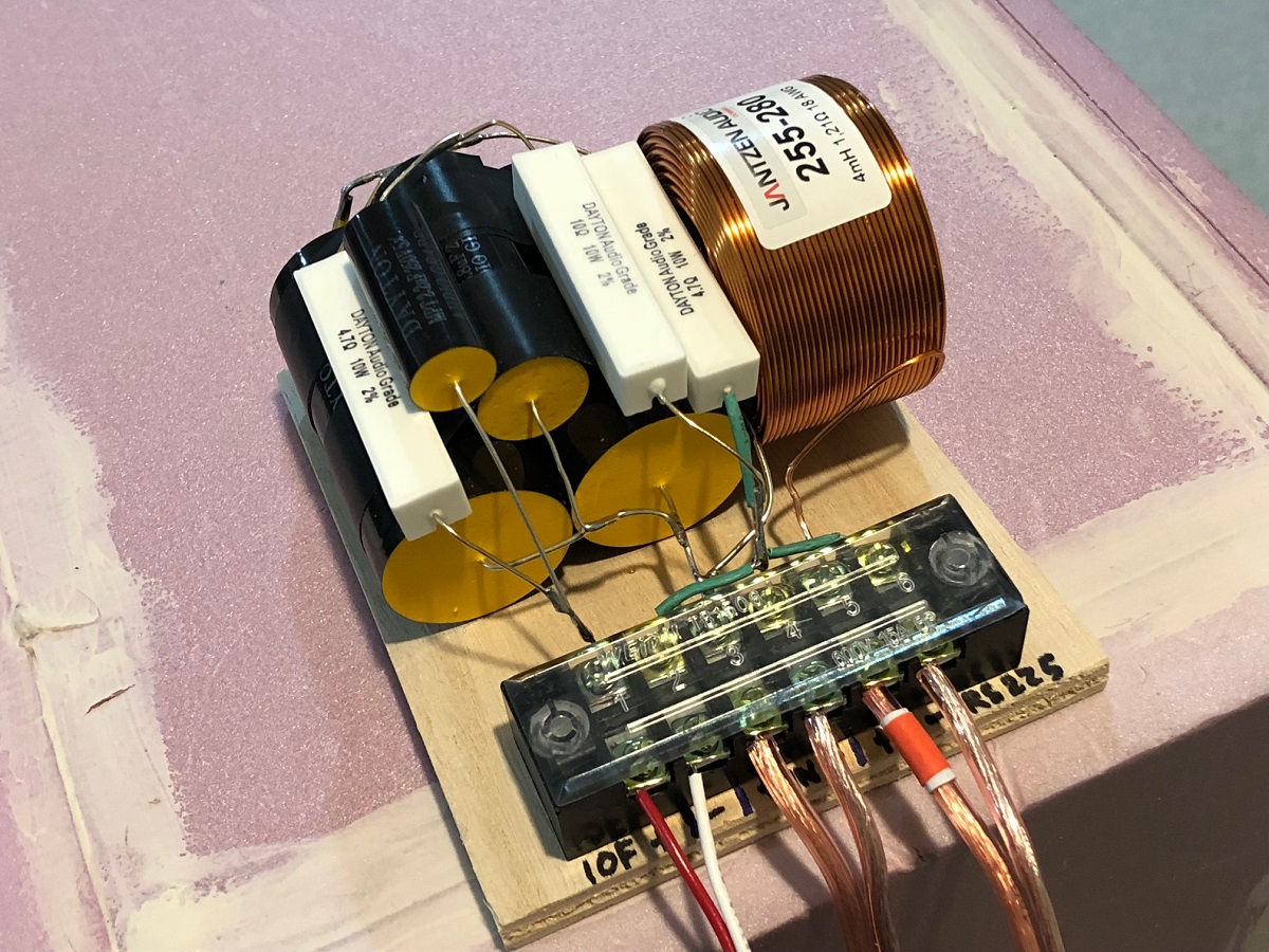

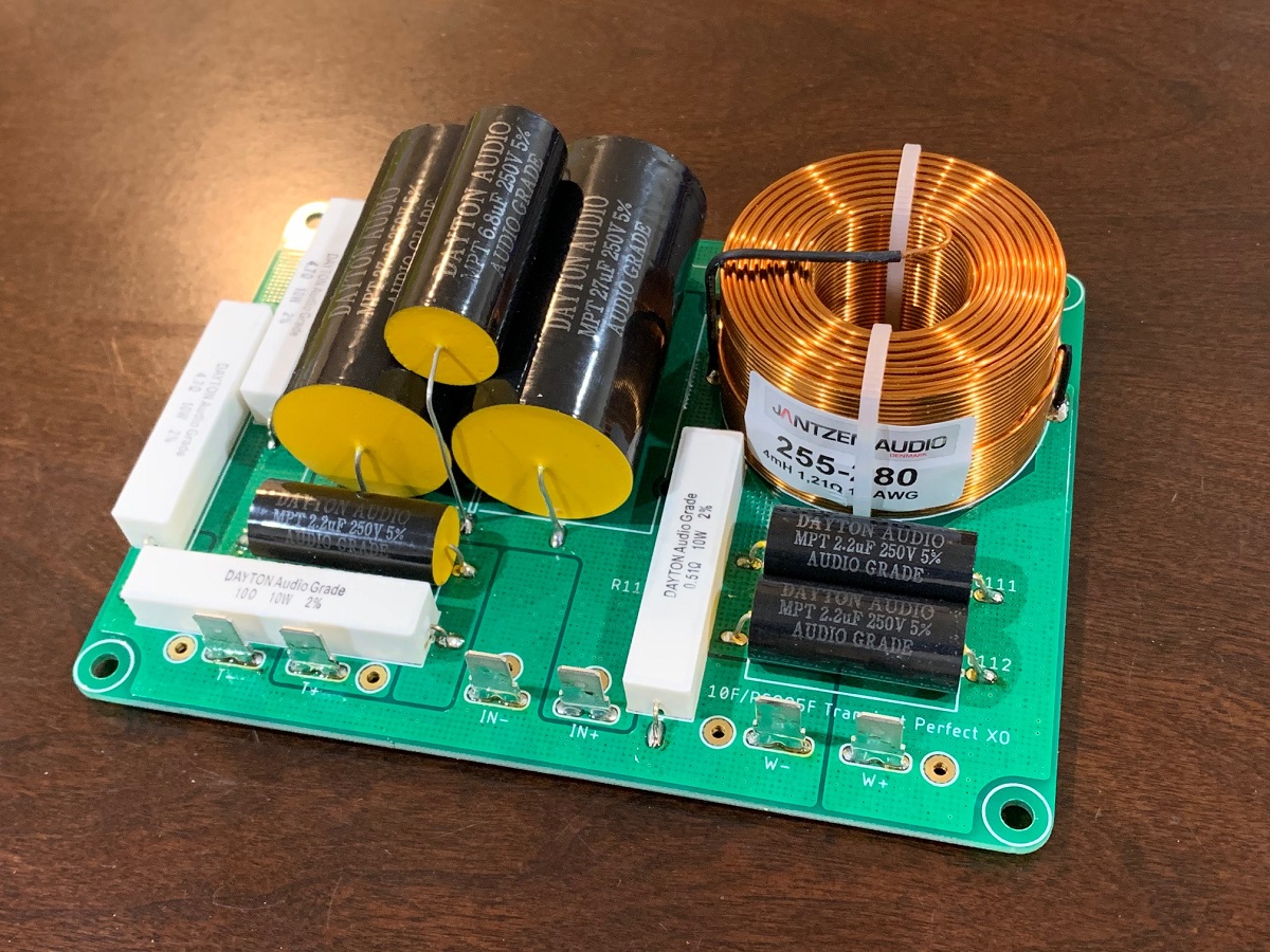

Edit Feb 9, 2020: XO PCB all built up with components from BOM

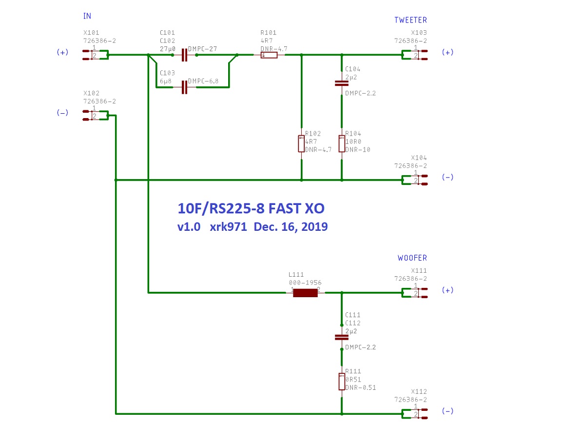

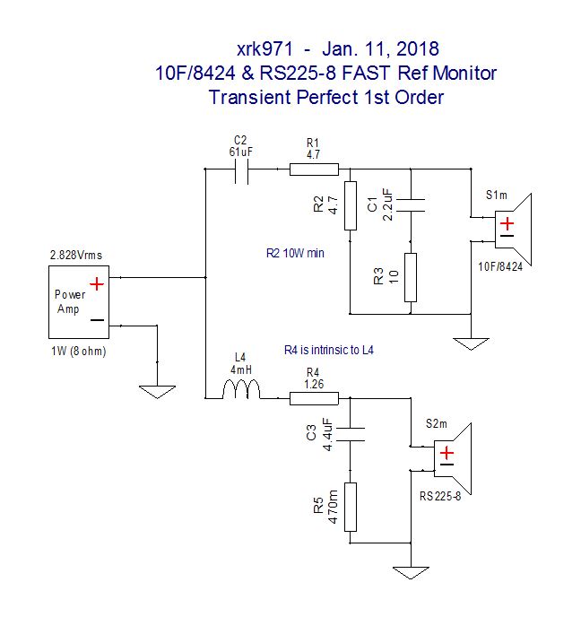

After making the XO using P2P for years, and at the request of members wanting to try this speaker, I have asked JPS64 to design a layout for this 1st order transient perfect crossover.
Here is the schematic from Xsim:
802764d1576593944-10f-rs225-fast-speaker-xo-pcb-gb-ab5faeb4-e6fd-4c24-a2ff-d3165da6ba74-jpeg

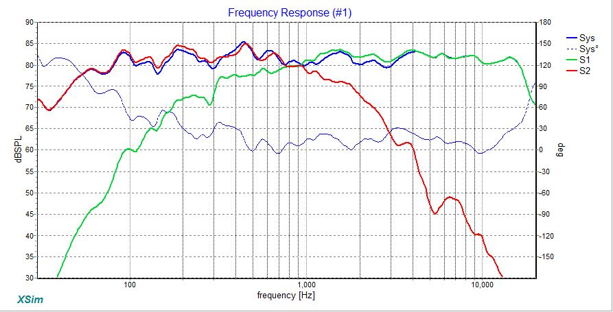

Here is the predicted response and phase using measured response:
802765d1576593944-10f-rs225-fast-speaker-xo-pcb-gb-66f2b891-d8bb-4172-9c01-531c8f40636b-jpeg

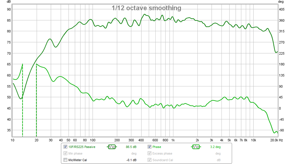

Here is the measured response - note the flat phase from 100Hz through 10kHz - essential for reproducing the transient dynamics correctly:
802766d1576593944-10f-rs225-fast-speaker-xo-pcb-gb-7309759b-62d2-437c-bcba-d69529fe47d4-png

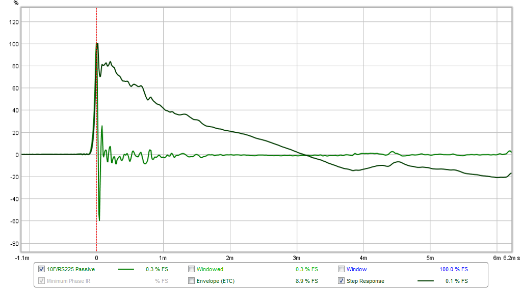

Here is the measured step response (right triangle is idea transient perfect response):
802767d1576593944-10f-rs225-fast-speaker-xo-pcb-gb-ebedf9ad-094c-44ff-b4ac-931bd13d405c-png
Here is what the P2P XO used to look like:
802768d1576593944-10f-rs225-fast-speaker-xo-pcb-gb-3dbd58e4-5b93-4ebe-a245-be941d6476ac-jpeg

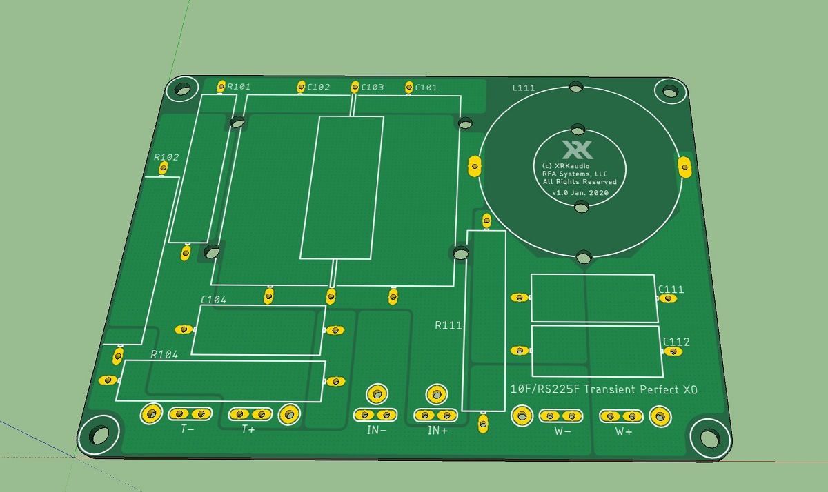

Here is the PCB schematic:
802769d1576593944-10f-rs225-fast-speaker-xo-pcb-gb-34934b34-511a-47c6-af69-944d8b33940e-jpeg
Here is the layout (board is 150mm x 110mm, 4mm dia holes are 140mm x 100mm). Connectors will be Faston spades with optional flying lead solder pads for 16ga wire. Holes will be provided to zip tie the inductor and heavy large capacitors to the board:
802770d1576593944-10f-rs225-fast-speaker-xo-pcb-gb-d2385983-f9bd-48cd-b213-656503d855d3-jpeg
Thank you to JPS64 for another outstanding design!
Here is the list of components (all from Parts Express) for a stereo pair:
Code:
Product       Name	Sku	 Qty	 Price	Total
Dayton Audio DNR-4.7 4.7 Ohm 10W Precision Audio Res	004-4.7	4	$1.09	$4.36
Dayton Audio DMPC-27 27uF 250V Polypropylene Capacitor	027-439	4	$8.58	$34.32
Dayton Audio DNR-0.51 0.51 Ohm 10W Precision Audio Res 004-.51	2	$1.38	$2.76
Dayton Audio DNR-10 10 Ohm 10W Precision Audio Res	004-10	2	$1.38	$2.76
Dayton Audio DMPC-2.2 2.2uF 250V Polypropylene Capacitor	027-415	6	$1.87	$11.22
Dayton Audio DMPC-6.8 6.8uF 250V Polypropylene Capacitor	027-424	2	$2.75	$5.50
Jantzen Audio 4.0mH 18 AWG Air Core Inductor Crossover Coil	255-280	2	$20.91	$41.82
Boards will be thick 2mm thick FRP, 2oz copper with thousands of via stitched holes to tie identical planes on both sides for low impedance), ENIG finish, green solder mask. Pricing will be $38 ea. Shipping will be the usual tracked first class parcel, auto-calculated in Etsy (about $6 in US, $14 CAN, $23 everywhere else).

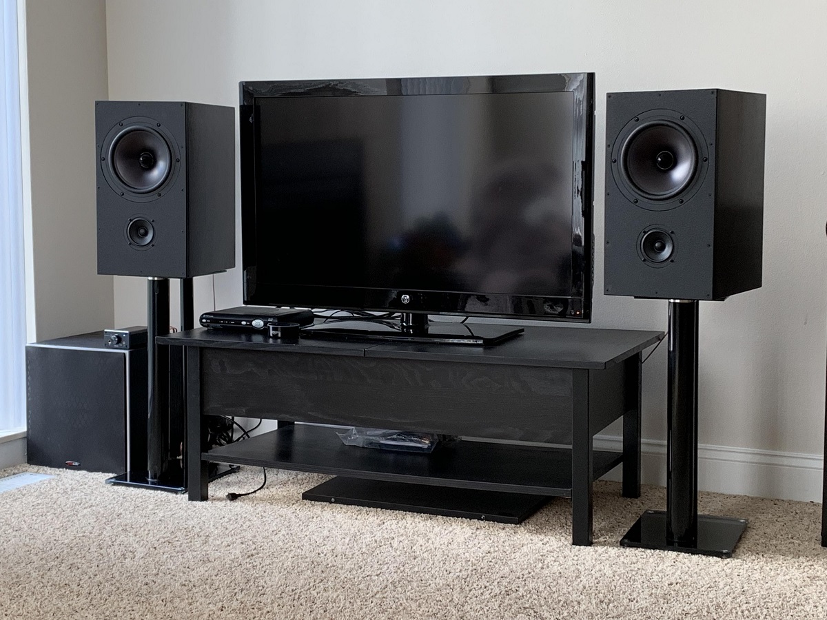

Anyhow, all the drivers for this speaker could be obtained for $206 to $246 for a stereo pair. The XO items can be obtained from PE for about $100.
The cabinet is simple to make, and you can have one of the nicest sounding speakers around.

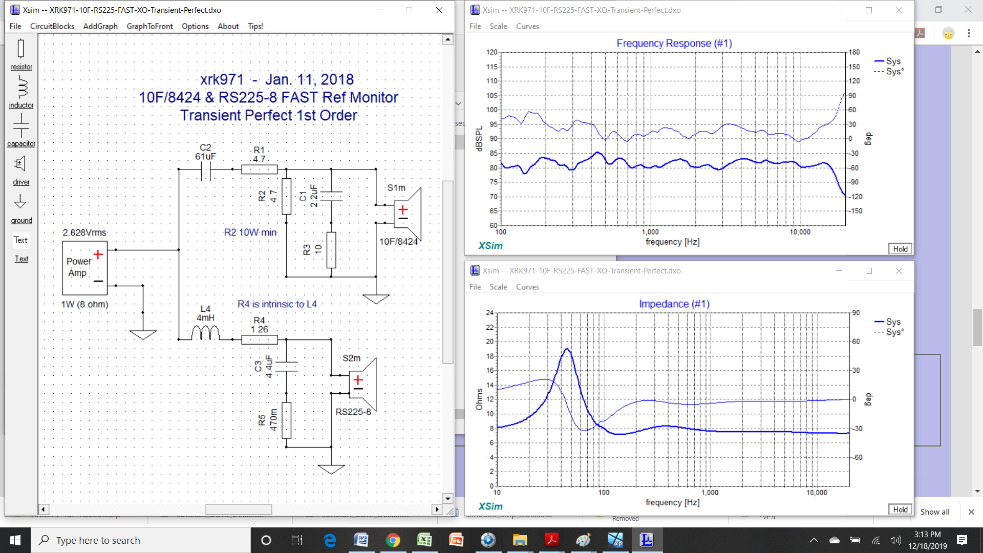

Hi Ray,
I think my Xsim file looks fine - I just downloaded it and opened it up. Looks to be the correct one from jan 11, 2018. Here is my screenshot. Maybe you are opening a cached file?
X

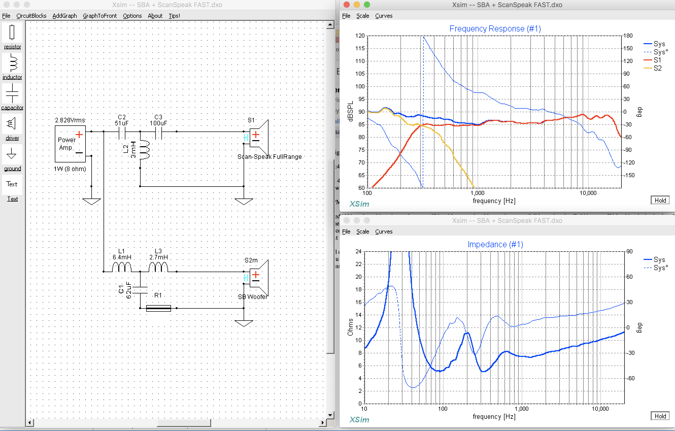

Nice to see some interest in this project. I was trying to design a floorstanding version of this speaker today for Vunce. That gives a lot more volume and so I decided to make a tapered TL sort of like a PMC monitor. I was able to get a -3dB point of 32Hz with the same sensitivity as the sealed alignment. The TL should be a lot higher quality tighter bass than a bass reflex. Here is the Akabak sim so far for a TL:
803262d1576714640-10f-8424-rs225-8-fast-waw-ref-monitor-10f-rs225-fast-tl-freq-v01-png
Hi Ray,
X
OK, that was weird. I must have goofed up and loaded the wrong file. 😱
It shows up as correct to me, now. Thanks Xrk.

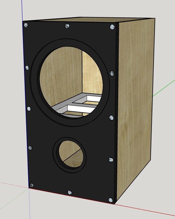

Hi jwjarch and X,
I have a few questions about XPS, and since there is not a large amount of info about building enclosures using XPS, I thought I would ask here.
Are you working with the 2" XPS which would be common for house construction.
Have you ever tried cutting 2" XPS down to 1", using a fine tooth craft saw. I do not have access to any hot wire foam cutters? I do have sharp craft type cutting blades but they are maybe 1-2" long.
I have only found 1 reference to a speaker made from XPS and the designer commented that the sound was damped and bass was bloaty. Not a lot of info.
I have a lot of this pink type XPS that I would like to experiment with. If you have any comments or links to using XPS for box type enclosures, please let me know. I am following the DML threads also.
Thanks for any help available,
Myles
Hi Myles,
I use the 1in thick which is common in the US at Home Depot and the like. Use lots of bracing - if you look at my thread for the speaker, you can see how it was made. I cut it with a metal straight edge and a brand new utility knife razor blade. Use 8-10 strokes each time going a little deeper. A dull blade will tear and rip it with rough edges. A new razor is a must. I would not bother splitting it to make 2in to 1in. I used non volatile organic compound Liquid Nails to glue it. Give it 2 days to cure before applying load of driver air compression.
479650d1430055468-10f-8424-rs225-8-fast-ref-monitor-10f8424-rs225-fast-bracing-tl.png
Bond a thin 3/16in sub flooring plywood as the baffle face to give strength for the screws to attach the drivers. I used Liquid Nails to do this too although PL Premium would work well also. Or even latex caulking I think.
Hope that helps. The foam will actually absorb some resonances common in wooden boxes. The measured performance of the XPS cabinets was about same as much more time consuming 3/4in BB omg boxes. I had to add mass loaded butyl rubber audio door panel sheets to the inside of the wood cabinets and then line with eggcrate foam. Whereas XPS I just added fiberglass stuffing. Stuffing is needed in wood too of course.

I just finished folding the new RS225 TL - then re-entered the new dimensions in Akabak and it is even better than previous estimated sim. Smoother mid bass. Now will put into SolidWorks to make sure the dimensions can physically be built. I am thinking 3/4in BB ply for main walls and 1/2in ply for internal separator walls. Height is 39in and can be elevated higher with unused lower portion. Will post design soon.
