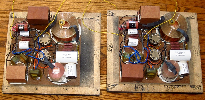

It is any intriguing idea. I spent as much on the updated/upgraded components as I spent on the JBL's when I bought them in the mid 70s.
Attached is a photo of the two crossover assemblies.

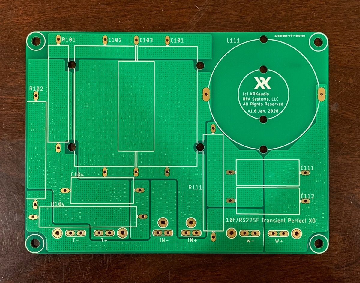

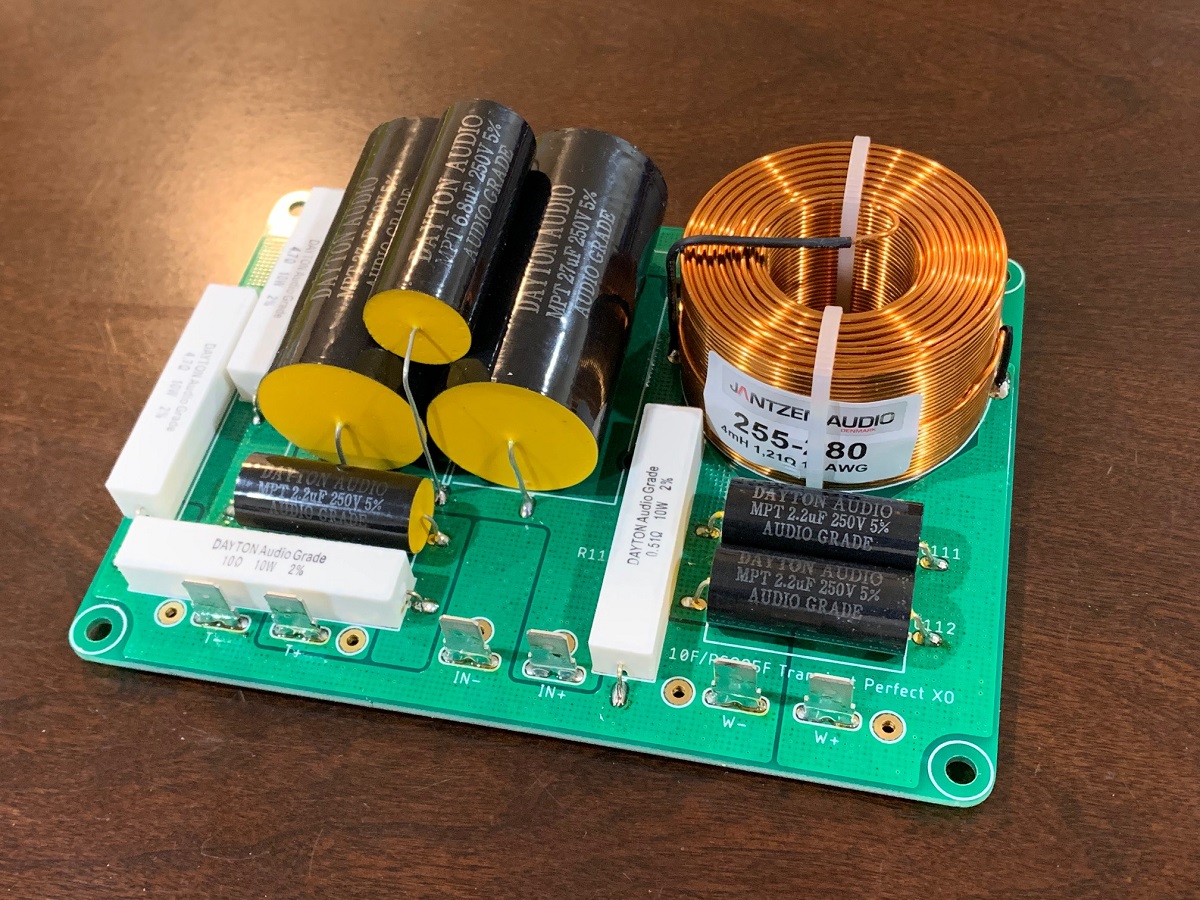

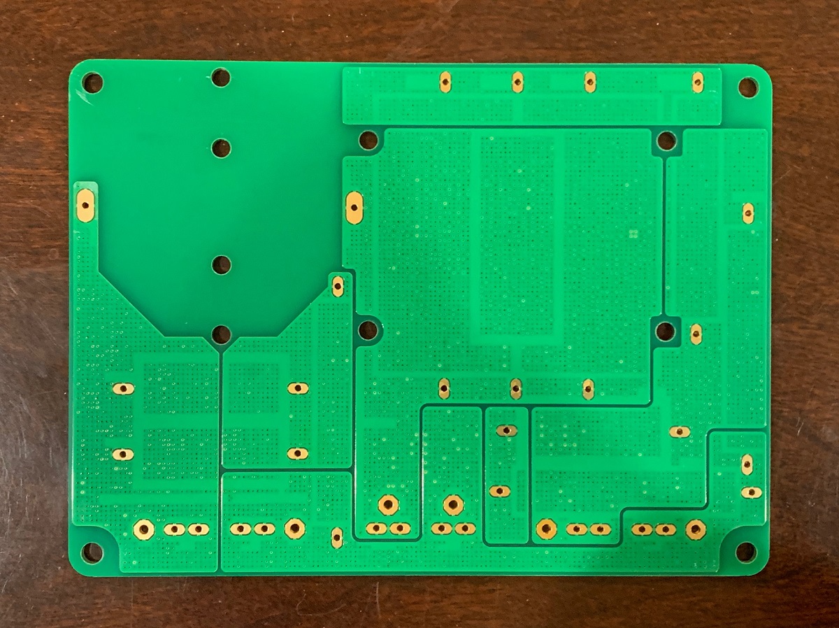

Very easy to build and everything fits perfectly! JPS64 did a fantastic layout here. There are thousands of vias connecting both sides of the board for essentially 4oz thick copper traces for super low impedance paths. It's a beautiful looking XO.
