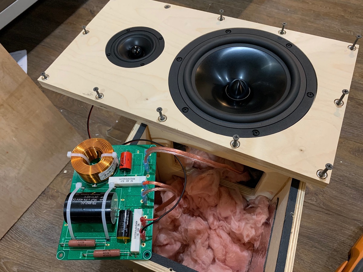

Great, thanks for letting me know that they are working out well. I am finding all sorts of uses for these boards. They seem perfectly suited for a nice 2kHz crossover for an MTM with a pair of 6.5in Peerless woofers and 1in dome tweeter. I have a second inductor where a capacitor C104 once went.

I'm working on sourcing all the parts needed to build these speakers and I noticed your crossover BOM shows a quantity of 4 of the 2.2uF caps. When looking at the crossover schematics and a build of the crossover PCB, I see 3 of the 2.2uF caps being used per channel. Can you verify this?
I plan on building mine from laser cut 12mm BB plywood with .25" walnut added to the baffle for driver recessing.
Thanks and excited to get these underway!
Nate

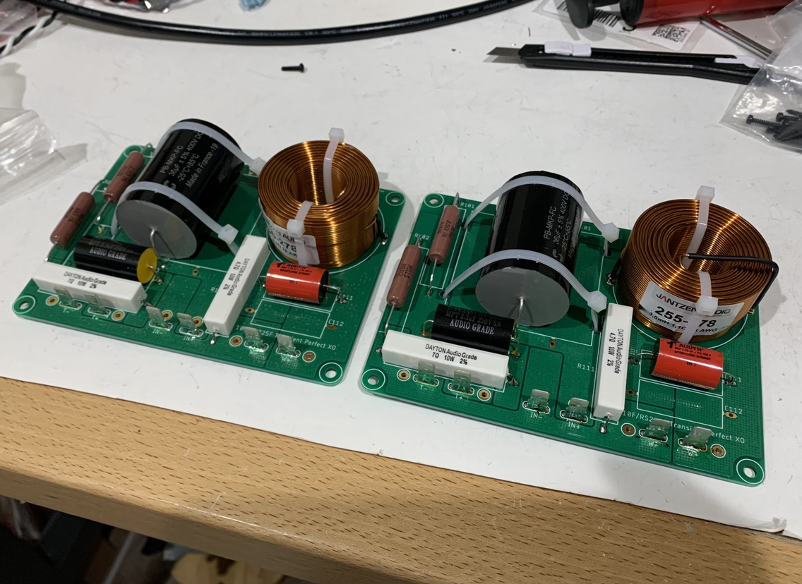

Yes, there are three 2.2uF caps per XO. For the paralleled pair I used a single Sonicap 4.4uF in mine.
Your cabinet plan sounds great! I also love the look of Walnut. When the weather gets warmer, I’ll start my “real” cabinets. Although, I’m thoroughly enjoying the XPS foam prototypes 😀
Thanks for pointing that out. BOM on Post 1 updated to 6x 2.2uF film caps for stereo pair.
Product Name Sku Qty Price Total
Dayton Audio DNR-4.7 4.7 Ohm 10W Precision Audio Res 004-4.7 4 $1.09 $4.36
Dayton Audio DMPC-27 27uF 250V Polypropylene Capacitor 027-439 4 $8.58 $34.32
Dayton Audio DNR-0.51 0.51 Ohm 10W Precision Audio Res 004-.51 2 $1.38 $2.76
Dayton Audio DNR-10 10 Ohm 10W Precision Audio Res 004-10 2 $1.38 $2.76
Dayton Audio DMPC-2.2 2.2uF 250V Polypropylene Capacitor 027-415 6 $1.87 $11.22
Dayton Audio DMPC-6.8 6.8uF 250V Polypropylene Capacitor 027-424 2 $2.75 $5.50
Jantzen Audio 4.0mH 18 AWG Air Core Inductor Crossover Coil 255-280 2 $20.91 $41.82

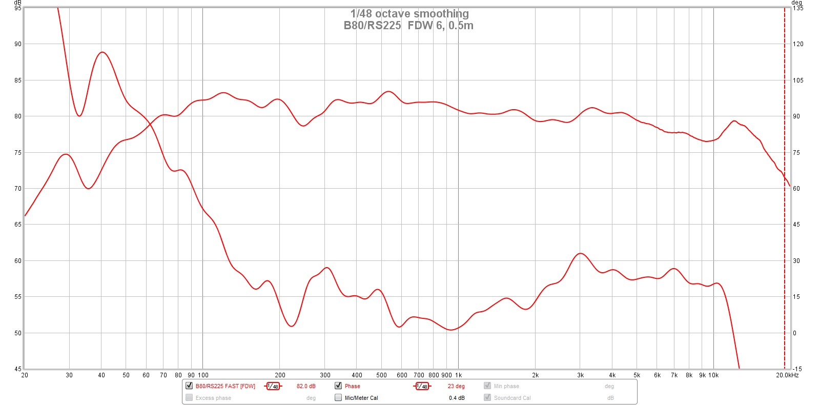

Here is a variant of this crossover for a B80 and RS225-8. Will try it out later tonight.
Here is the speaker with new test baffle that fits the B80:
828413d1585383617-10f-8424-rs225-8-fast-waw-ref-monitor-b80-rs225-fast-build-finished-04-jpg
Here is how it measures with the stock 10F/RS225 XO (R1 changed to 3.2ohm) phase varies by about 30deg from
120Hz to 12kHz:
828553d1585427034-10f-8424-rs225-8-fast-waw-ref-monitor-b80-rs225-fast-freq-phase-mid-axis-jpg
Here is a superb step response:
828555d1585427033-10f-8424-rs225-8-fast-waw-ref-monitor-b80-rs225-fast-freq-step-mid-axis-jpg

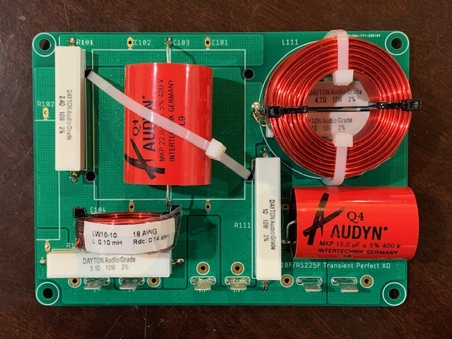

This is the new XO that I just assembled:
828798d1585500885-10f-8424-rs225-8-fast-waw-ref-monitor-cb2a9f2d-ed27-4caf-be57-1dae2c081ea2-jpeg
828885d1585517801-10f-8424-rs225-8-fast-waw-ref-monitor-0996b827-2eea-4a83-b639-bfbe049b8955-jpeg
