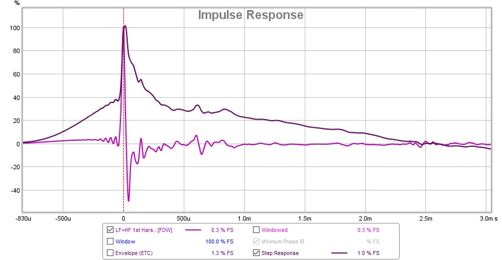

Zoom in the time scale to first 20ms. You should see something that looks like a right triangle with tweeter at leading edge in phase with woofer. Your mic might be reverse polarity so it may be upside down - but you can click invert polarity in the IR response dialog box.
Something like this:
Haha 😀 Thanks man, i just followed what you guys did, Appreciate well documented process, and it took me only an hour from scratch 😀. i will post this at Harsch thread as well and YES ! it does sound fantastic of course !

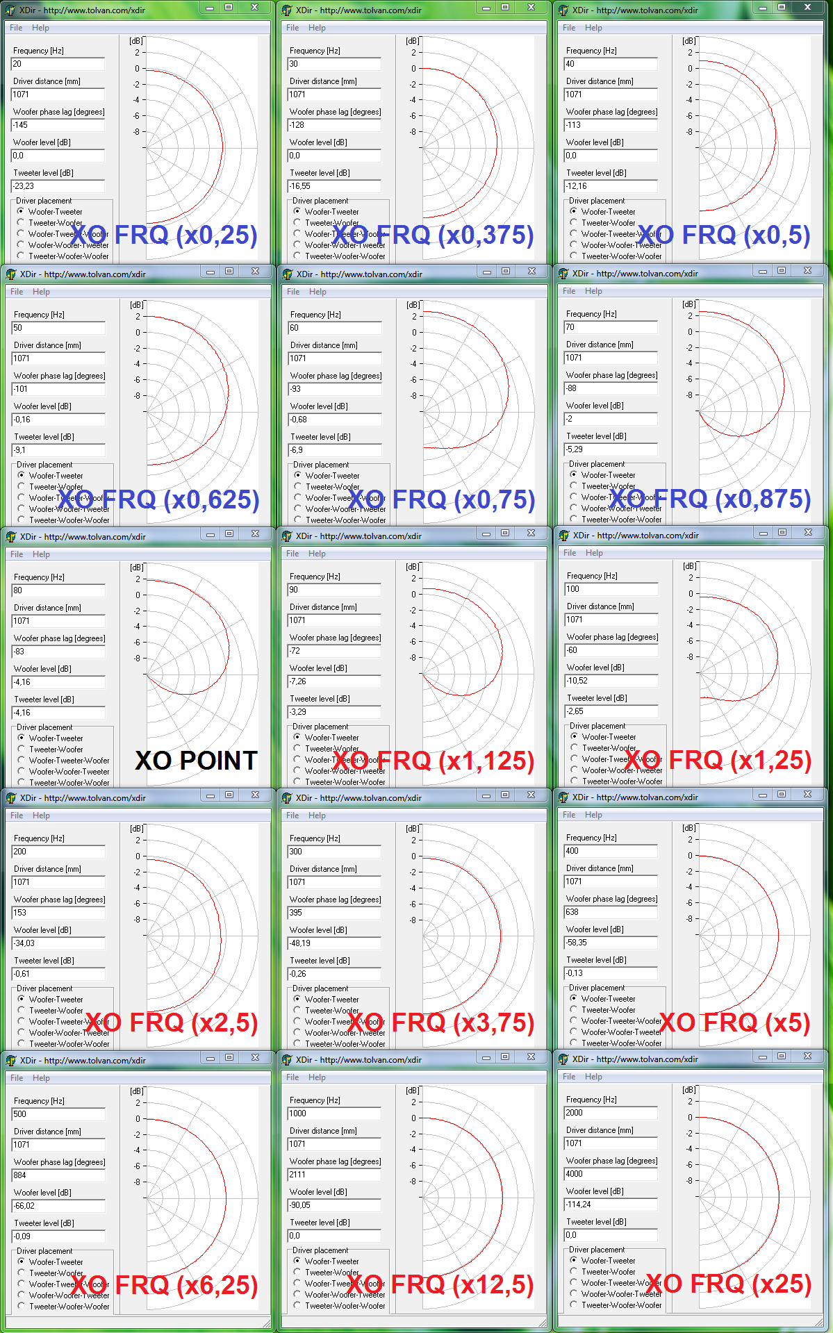

Below is pointers to expected power response errors, first is how 68mm verse 25mm driver beams, second is how HARSC within 1/4 wave center to center distance have some tilt and power response errors in area of 0,5 up to about 2,5 times the XO point frq.

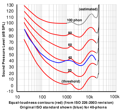

If JRiver is new territory to you throw a PM for quick guide help setup the important first steps to get bit perfect audio stream and create/load a linear phase filter, also if you find it good (suggest use 64bit version if OS support it) can help setup feature of R128 algorithm tracks leveling and if soundcard is 24bit or more then dynamic feature "Equal loudness ISO 226-2003" is so fantastic a experience when dialed in.
