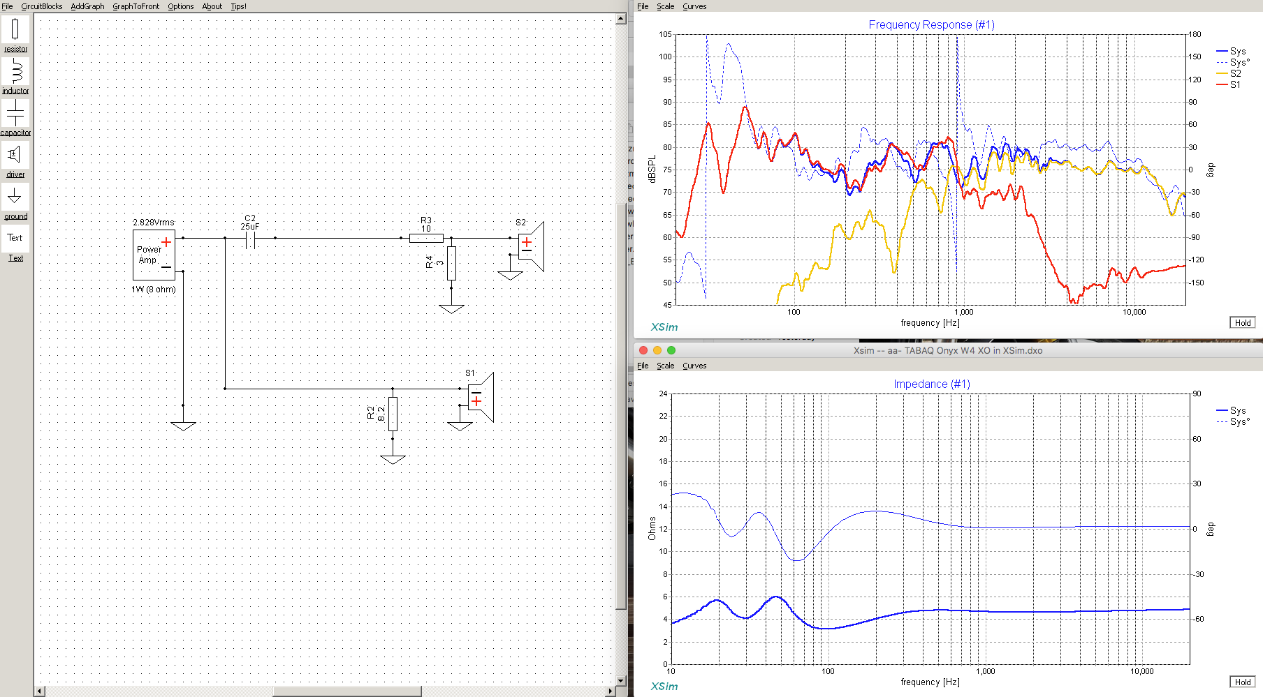

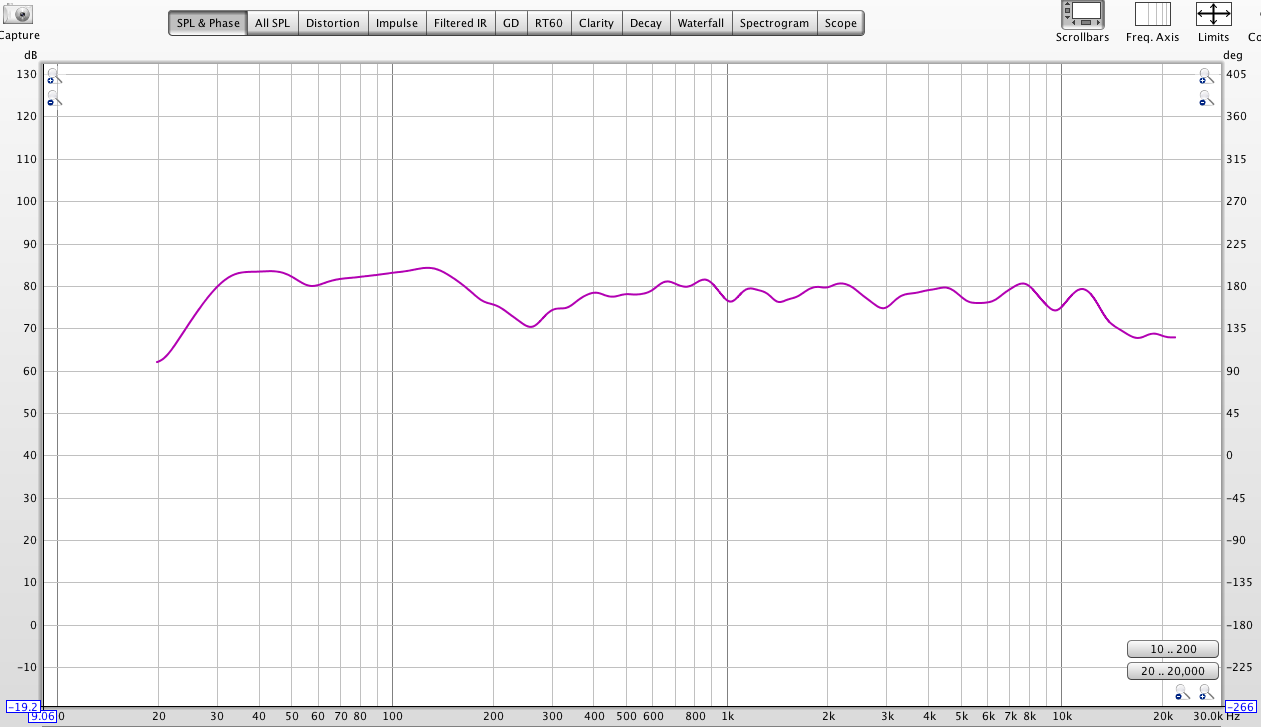

I said I wanted to try this, but using my Brio clone instead.
Basically, it's a W8-1363SBF in a vented enclosure, the middle B80 with downslope "ceiling" to look like a dagger above that, and then a B80 in OB on top... so variations on your theme.
Variations didn't stop there, as I let the SBF run free. It has an ok down slope after 1kHz.
The dual B80s are on a single 25uF cap, and a small L-Pad. A 8 Ohms resistor to bring global impedance down. That's it. Super simple.
My XO is much higher than your 500Hz point, though. I'll look into adding a bigger cap to see if I can let the B80s play a little more of the spectrum. 25uF is the biggest I have at home right now.
Didn't have much time to take measurements, but it does look very promising! The 200Hz dip is room related, and I would only need to move the speakers around to get rid of that.
The drop at 13kHz is probably due to the B80s spacing and position... I'll need to play with that.
But I'm pretty stoke with this first shot!
XO measurements taken at 1m. FR sweep taken at listening position, about 3m away.
Looks pretty good actually for running full range on the woofer. A 4mH inductor may help to lower that to maybe 800Hz, and a 50 to 60uF cap will lower the XO point. Just use two 100uF electrolytic caps back to back (+/-/-/+) bypass with 2.2uF film cap and it is a cheap and good sounding way to achieve larger values. For inductor, you can use iron plate or ferrite core ones to reduce cost vs aircores.
