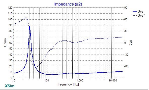

Do you see a problem using a 8 Ohms, 20W ceramic resistor across the terminals of the woofer to bring the whole system impedance down?
I'm not using a tiny D board.
My amp is rated at 210W per channel. I rarely listen to music above 83dBs, so I am not using all those 210W !
The amp is stable down to 3 Ohms, and lower if not pushed too hard.
No, I'm running the woofer free, as it is only 84dB and need all the power it can produce.
I was trying to make the total system impedance flatter, in case someone with a tube amp would like to try them. Solid State amps should have no problem with the original impedance peaks, but I was led to believe tube amps like a flatter impedance response.

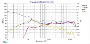

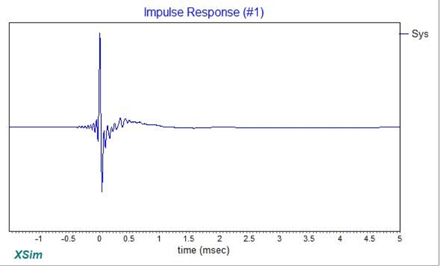

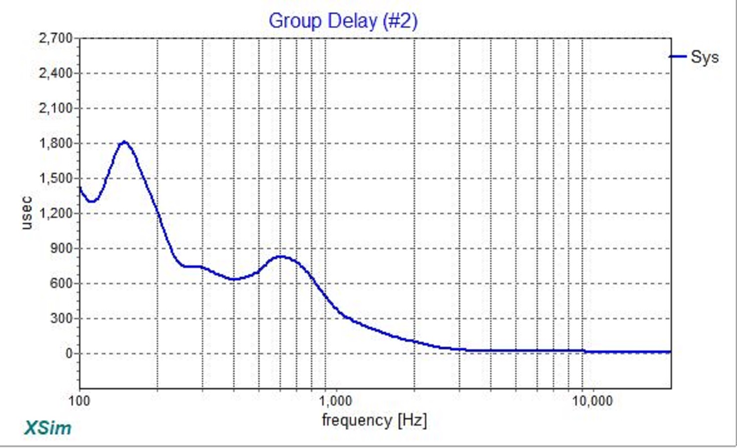

so what do you think ? 😀 couldn't achieve TP or Harsch. suggestions ?

I would make the XO frequency lower for a FAST and it also relaxes requirements for CTC spacing of tweeter to woofer as that needs to be less than 1/3rd wavelength at XO frequency. It looks like you have a 4th order low pass on the woofer. You want first order and add a notch with RC across the terminals to kill off any cone breakup at higher frequencies by still keep slope 1st order. That’s the 4.4uF and 0.47R strapped across woofer on mine. Woofer should only have that notch and a large inductor maybe circa 4mH to keep it first order.
On tweeter have only cap no inductor to ground as that makes it 2nd order. Pad (attenuate) the tweeter with R until it level matches woofer. You will need to manually add spatial delay of maybe 1in to 3in to tweeter (right click on tweeter dialog) to get phase to match and prevent dip/notches near XO frequency.
Start with my published XO and go from there.
What you have here is a far far away from TP (must be 1st order). Don’t bother doing Harsch with passive as you can’t provide the huge time delay (0.5ms) needed unless you move tweeter 5.5in backwards. Although that’s doable if you flip speaker so tweeer is on bottom and lean box so woofer is forward a few inches. Looks ugly that way.

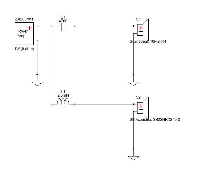

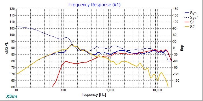

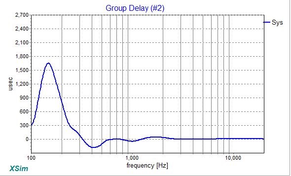

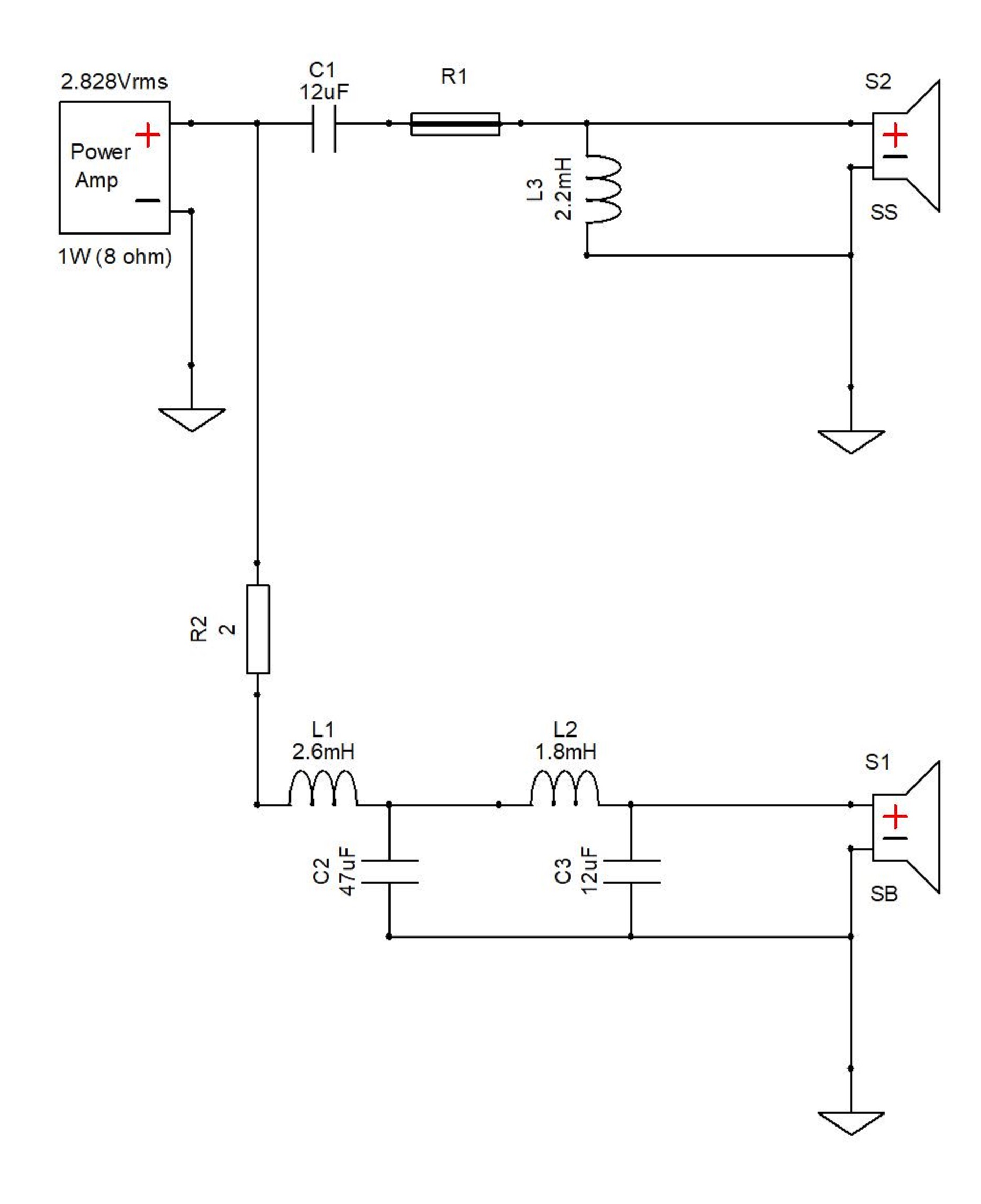

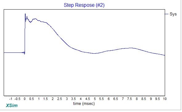

Thanks for the reply X, what do you think ? i added the notch filter but it did not had a huge effect on cone break up, woofer probably behave ?
also does not look like it need a resistor at tweeter, i was thinking maybe add a small one to woofer to make the tweeter a little brighter.
Not sure about that 150Hz peak, tried to calculate a notch there and it looks like it works but it has some crazy cap value.

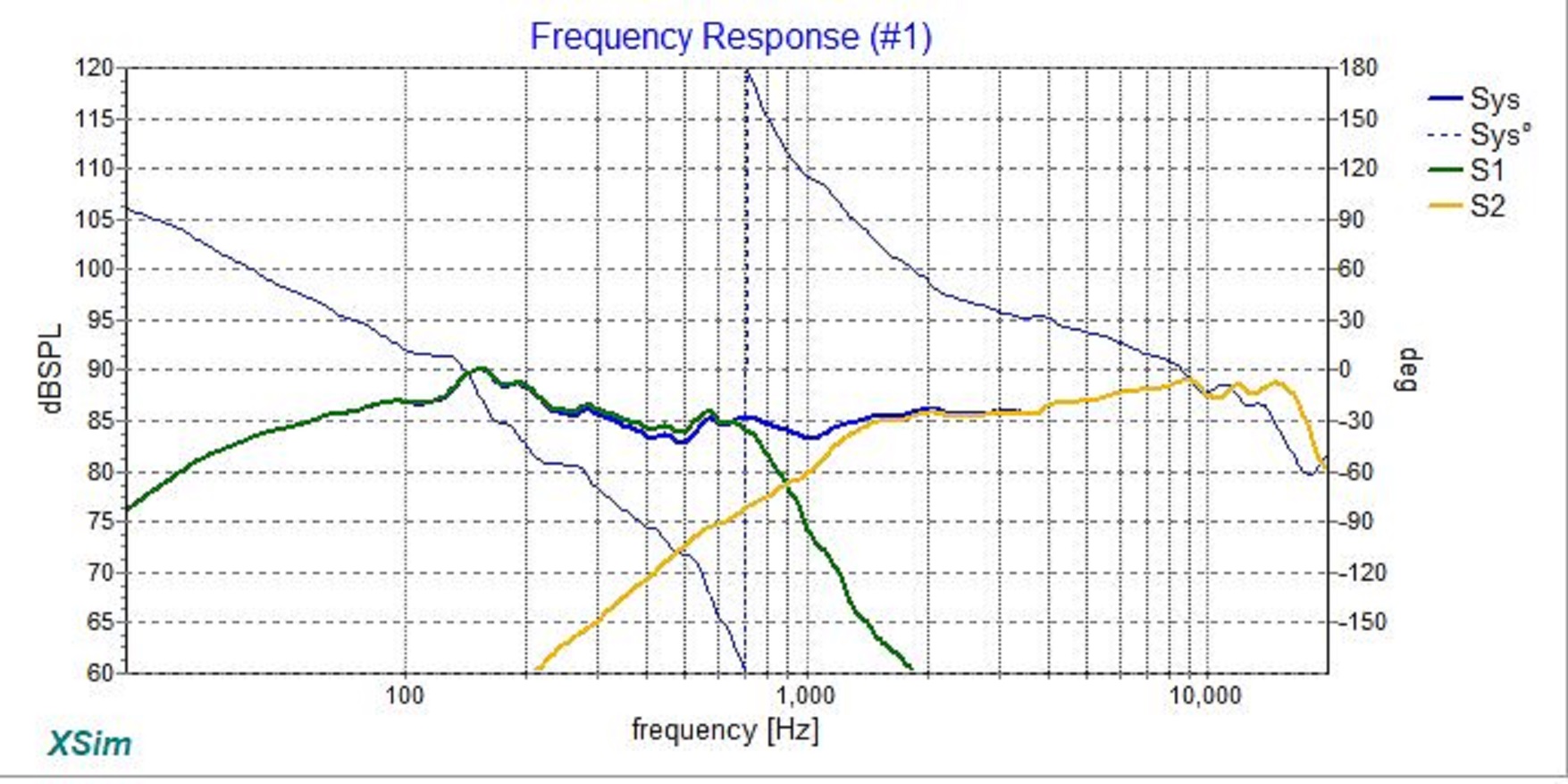

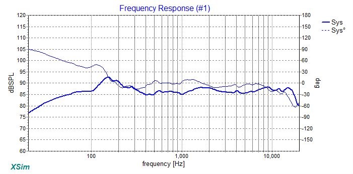

Nice work! That’s a pretty good step response. Is the woofer response measured in your box or factory curve? Usually, factory one is on a large flat open baffle so doesn’t have baffle step loss of 4-5dB. 10F is 87dB driver and SB is 89dB driver so will be about 85dB after baffle step. You may need mild -2dB padding on 10F. Probably 4ohms in series. Can you show the S1 and S2 woofer and tweeter curve so I can see where XO is? The phase plot is is very flat so probably good. Don’t worry about 150Hz bump. In a real speaker there is a 150Hz floor bounce dip so this maybe perfectly suited to cancel that out. You should test it - it doesn’t get simpler than this for a passive XO. I predict it will sound very good.

The FRDs were provided by Earl and are traced from factory datasheets. the box is already made, this is for my SS/SB FAST speaker i posted while back,I have not simulate this in a box yet.
the XO is at 550Hz, the 10F is in a 0.6 liter cone and large ported cab tuned to 35Hz for woofer.
any suggestions before i buy the parts ? 🙂
Edit : forgot to mention there's also no mod Delay on 10f.
