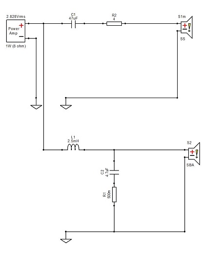

thanks for the replies guys,

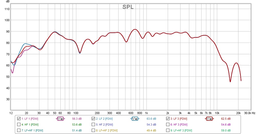

I followed the 1st order cross over simulated in xsim as in post #1187, crossed at 550Hz, followed by a notch on woofer and a pad on tweeter , and the plots doesn't look anything like what has been simulated, the cross over is way to simple to make any mistakes but i just finished printing two plates and will do the cross over again anyway.
the weird thing is such dips would be audible as it happened to me before and I use to hear dips and peaks while frequency sweeps but not here, the speaker sounds good i did another compare with my JBLs and even my headphones and still the speaker doesn't sound weird at all, so i measured it again this time i positioned the mic even closer about 1.5ft to eliminate any reflection and it s still the same and it s definitely the drivers as x said.

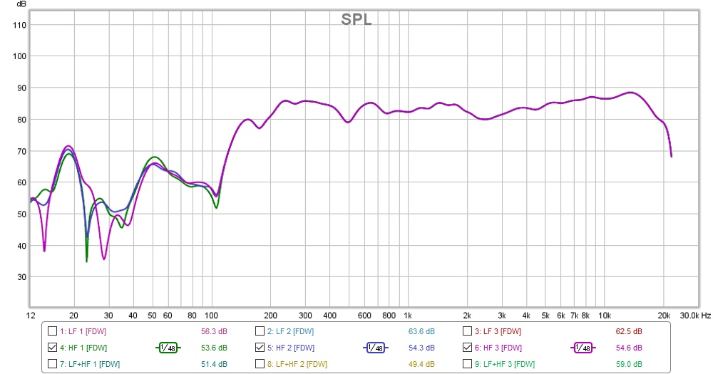

You can simulate the response based on actual measurements as you have a calibrated mic now. You need to measure 3 responses, each without touching the mic or speaker physically, but only changing wires. Measure the woofer by itself, then mid-tweet, then both in parallel (with two independent amp channels - not tied in parallel). All without XO electronics and full range 10Hz to 22kHz in REW. Then put the measured responses into either Xsim or PCD and your goal is to now adjust the axial delay of the tweeter until the resulting sim matches the combined curve *exactly* down to every little wiggle. Now you have determined by experiment the acoustic delay between the channels. Any additional delay you may need later to match phase will be on top of this.

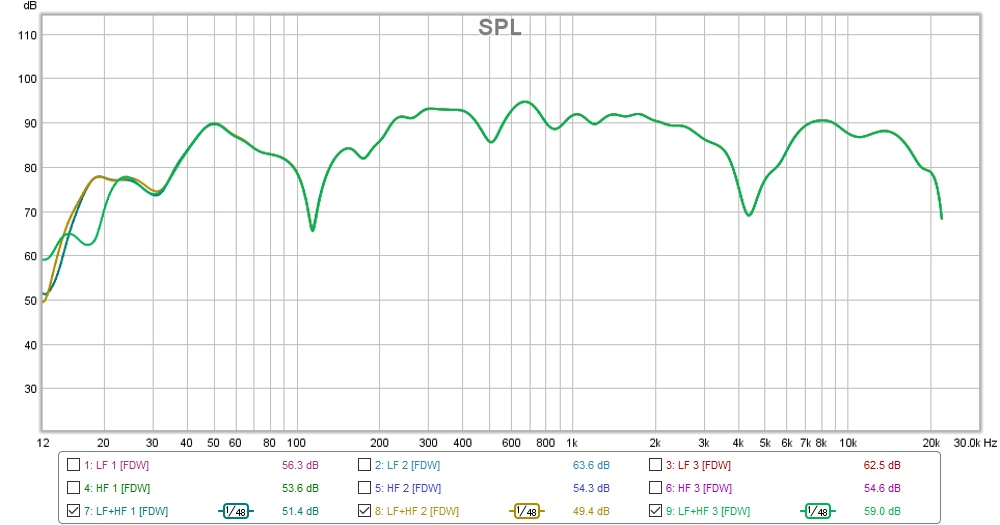

Those look good, now load them into Xsim or PCD and see if you can generate the sum in the simulation. Once you have that - the electrical transformations via XO components will follow the sim almost exactly.

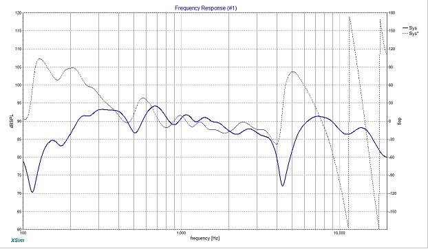

ok, this is weird, i m not sure if it's the xsim or I m doing something wrong here, loaded the files into xsim, and by adding a 1.8" delay to tweeter it matched the respond that i got from measuring.
then without changing anything, i added the XO components and it rolls the woofer just right and the dip is gone. the weird part is it did roll the HF just like what i measured w XO.

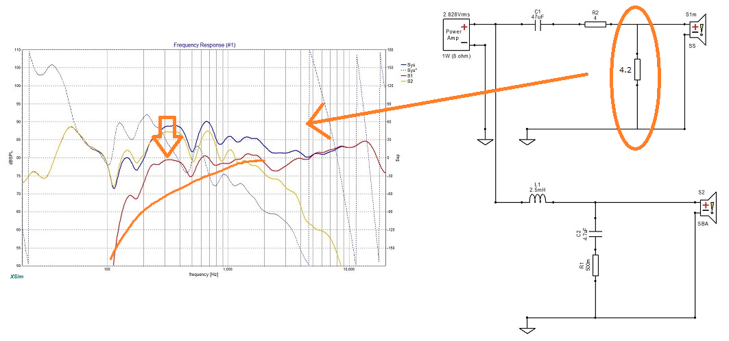

thanks for the tip, will add this in the sim as well.Using serial R2 alone adds overshoot where a L-Pad helps for that situation, suggest either add about 4,2 ohms as in below or go to "CircuitBlocks" menu and add a adjustable L-Pad should help a bit on overshoot.

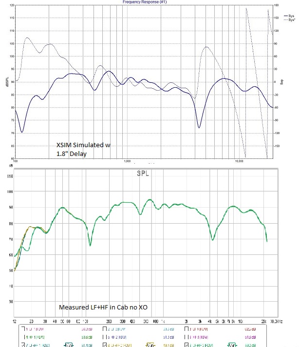

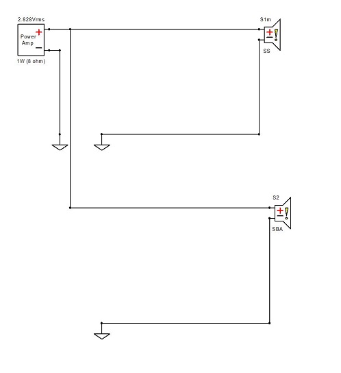

I meant that the measurement should still be in the same cabinet/baffle - just no XO. Xsim needs to be able to replicate the two drivers (played together or SUM signal on mic) in the cabinet without a XO correctly before trying to model it with a crossover.
I get what you mean, or at least i think i do ! don want to hijack your thread and make it about my problem. so i will try not to, and also maybe this will help someone later on.
so we need to simulate what is actually happening in the cab into sim, so i added separately measured (in the cab) HF and LF drivers into xsim, and with added 1.8" delay to HF the simulated slob matched the measured result of LF+HF in the cab (no XO at this point).
this is what you mean right ? so from this point I can start a crossover around this.

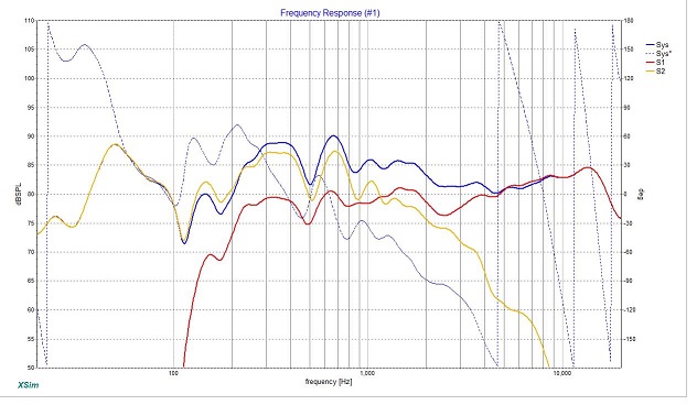

so I did as i stated, i matched the Xsim to real measured HF+LF in the cab with no XO.
Now if i add the inductor to the woofer, it will roll off nicely and the 2-3k dip is gone in Xsim. but this does not happen in real world, if i add the inductor to my woofer it does not roll it off as simulated and i will still have the dip.

That might mean that you do not have the correct impedance curve. Did you measure the impedance sweep with say, a DATS? Are you using a digitized factory impedance curve?
Are you using correct 8ohm vs 4ohm curves? Something seems really off. The response through an inductor has to fall off as frequency goes up. Try 4mH in real life and see if that helps.
