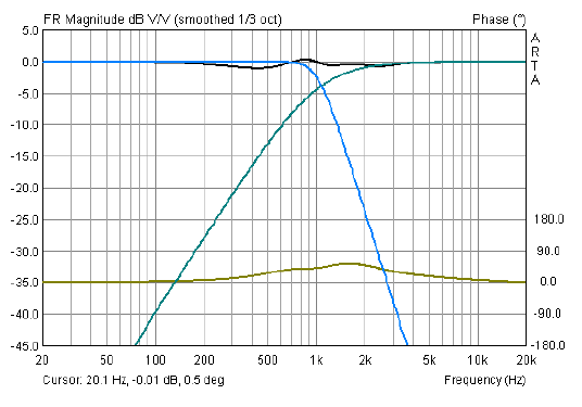

I did try the Harsch XO, brought down the XO point to 500Hz, and with a few EQ I got this :
above is XO at 500Hz with Bessel for HF and Butterworth for LF with about 0.7ms delay for HF. Five Sweeps at 1m from speaker.
But as soon as i changed the Mic to listening position the FR was all over the place, nothing like 1m measurement, i m living in a relatively small flat but it was worse than i expected . but with importing REW settings to miniDSP and some tweaking around i got this :
I think the dip before 300Hz is perhaps baffle diffraction, and peak before 30Hz is probably the room.
anyhow, yes the reason it looks so flat is because of scaling of course, but overall the 2 drivers looks like a good combination since it relatively has almost flat respond without much tweaking.

You need to set the smoothing and windowing to FDW 6 cycles (this essentially allows you to look at the intrinsic speaker response independent of room reflections). Measure at 0.5m with mic on 10F/8424 axis. You are already elevated >0.5m so that will prevent any floor bounce from affecting measurement.
Here is where FDW is located:
Here is the dialog and click check box for FDW and set to 6:
Then measure the 10F only and SB23 only and the combined curves and plot on same graph. The phase should have a characteristic 55 deg rise bump at the XO freq if you did it right. It is tricky because you need to first EQ your woofer responses to fit the textbook 4th order low pass curve, then EQ the midtweet to fit the Bessel response high pass, then delay the midtweet by 1/2 the time of one period of the XO frequency. For 500Hz that is 1ms (plus any physical offset that the drivers have as woofer voice coil is typically 3in or so behind the tweeter, so tweeter needs about additional 3in of time of flight delay (220usec) or total delay of 1.22ms.
The curves should look like this with characteristic slight rise of woofer (or dip in combined response) to the left of the XO freq, and small 0.5dB wiggle as it goes through the XO like this:
The proof that it works is when your step response looks like it has the tweeter peak aligned with the leading edge of the woofer bump like this:
You will need to read the Harsch XO thread carefully - there was a recent example of how member mkane77g tried to get the Harsch XO working.
Here is the theoretically or textbook perfect Harsch XO as presented by Harsch himself:
If you have more questions, I would recommend posting questions in that the Harsch XO thread. Byrtt is really good at giving tips on how to make it work.

Don’t be afraid to use the parametric EQ to flatten the native driver responses before using it on the XO. Use wide bandwidth cuts, not boost. Your mid tweeter response has a deep 7dB dip at critical 2.5kHz “presence” range. That’s why it sounds muffled. First apply EQ to get your driver to fit the curve on miniDSP exactly with nothing more than level adjust to get top height correct. It will take a shelf cut filter above 1kHz for the baffle step. Your woofer amp FH9 probably has more gain than Alpha amp so decrease woofer maybe 5dB to level match midtweet. That will bring more midrange presence back. The best way to do this is to use the built in EQ dialog in REW to capture your raw response and compare with textbook and play with PEQ (simulation) in REW and then when it matches, use the export to miniDSP function and it creates a PEQ curve file that then gets everything to work. It takes the guesswork and iteration out and does it in one try.
Thanks for the input, the puzzling part is that on paper my 2nd attempt Harsch should sound better but it doesn't to my ears.I switched back to my original settings and everything is there. it's probably my lack of patient and knowledge that i couldn't get the Harsch XO right, but i m gonna start from scratch again and stay away from textbook this time, from my days of mixing and mastering I do afraid of EQs in general, this time I will try to do some more EQs and trust my ears more, from my very limited experience a good example may not always apply on a certain situation.Don’t be afraid to use the parametric EQ to flatten the native driver responses before using it on the XO. Use wide bandwidth cuts, not boost. Your mid tweeter response has a deep 7dB dip at critical 2.5kHz “presence” range. That’s why it sounds muffled. First apply EQ to get your driver to fit the curve on miniDSP exactly with nothing more than level adjust to get top height correct. It will take a shelf cut filter above 1kHz for the baffle step. Your woofer amp FH9 probably has more gain than Alpha amp so decrease woofer maybe 5dB to level match midtweet. That will bring more midrange presence back. The best way to do this is to use the built in EQ dialog in REW to capture your raw response and compare with textbook and play with PEQ (simulation) in REW and then when it matches, use the export to miniDSP function and it creates a PEQ curve file that then gets everything to work. It takes the guesswork and iteration out and does it in one try.
Your last plot shows a series of dips, starting at ~1650 Hz, meaning something is causing this wobbly frequency response.
The plot has 20 dB division between the lines, which is a huge difference to the 5 dB scale that XRK used. While on this scale it may look relatively flat, it isn't within the plus/minus 2.5 dB of XRK's measurements. You're plus/minus 10 dB or more between 1500 and 5 KHz.
Look at your IR, that will show if there are any big reflections in your measurement that create that series of dips. It almost looks like a stereo measurement measured just outside the sweet spot.

I followed X instruction here and got good results. did get rid of dips after 1.6KHz, but i got series of dips at my LF FR now, not sure what causes such deep dips, any ideas ?
Getting IR is a good idea, i noticed the louder i do the sweeps more dips i get !
This is listening spot by the way.
Try moving the speakers' position a bit, 30cm (or more) to the left, or to the right, forward and backward and look how it affects the FR
150Hz is classic floor bounce cancellation. Did you move mic to 0.5m and make sure mic is about 1m above floor? Then use 6 cycle FDW (which it looks like you might be doing already). Don't worry, it takes time to master this - not an easy concept actually to see that the individual driver responses must match the textbook profiles before you try to use them in the XO.

Looking better. Can you show the crossover curves of woofer tweeter and combined? Also need to see phase in high resolution to see 55deg bump in phase at 500hz. Also impulse / step response.
I think you have it there. For step response choose %FS rather than dB. But the tell tale is the mild dip in combined below the woofer to the left of XO and your curves look like the right shape of 4th order and 2nd order Bessel. Good job.
How does it sound?
Listen to acoustic guitar, drums (rim shot), stand up bass etc. - crisp attack is the signature.
