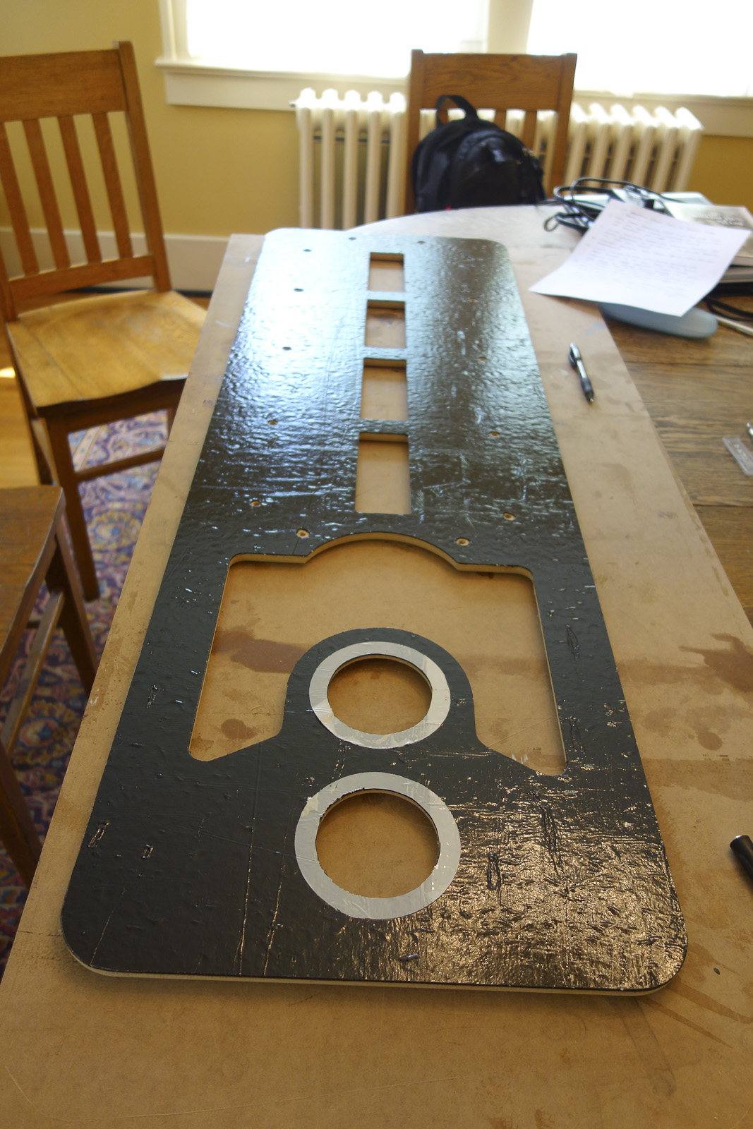

If laminating 12mm, use a non-hardening glue land you get a extra dampening from mass constrained layers effect. A non-hardening sub floor adhesive like liquid nails might work, or even latex exterior caulking. Even better is to spray 3M 77 Fast-tack onto a butyl rubber pond liner sheets (2mm thick) and bond MDF panels to that as a sandwich.
Pond liner sheets, damn clever idea!
I used this:
http://a.co/icPfIFv
Glued to the interior walls, then 1/2" wool felt.
Constraining pond liners between laminations is a good idea, I may have to experiment with that at some point.
Pond liner wasn't my idea. It was Z transform's idea from this thread. He recommends this:
You can see it in between the MDF sandwich:
But I recall there were conversations about pond liner...
Novel Open Baffle Construction Techniques
I use the exact same Noico sheets on the interior wall of my cabs. They work well but leave your fingers and whatever they touch a black yucky mess. They sound a lot like the roofing material above.
The damping sheet is roofing "ice shield" commonly used here in the Northeast to stop water from backing up underneath shingles and leaking in the winter. It's made from a combination of slag, asphalt and binders with an aggressive pressure sensitive adhesive (PSA) on one side and a thin plastic "foil" on the other. It's heavy and just a little gooey- and completely dead. A roll big enough for all the hobby speakers you ever want to build costs $75.

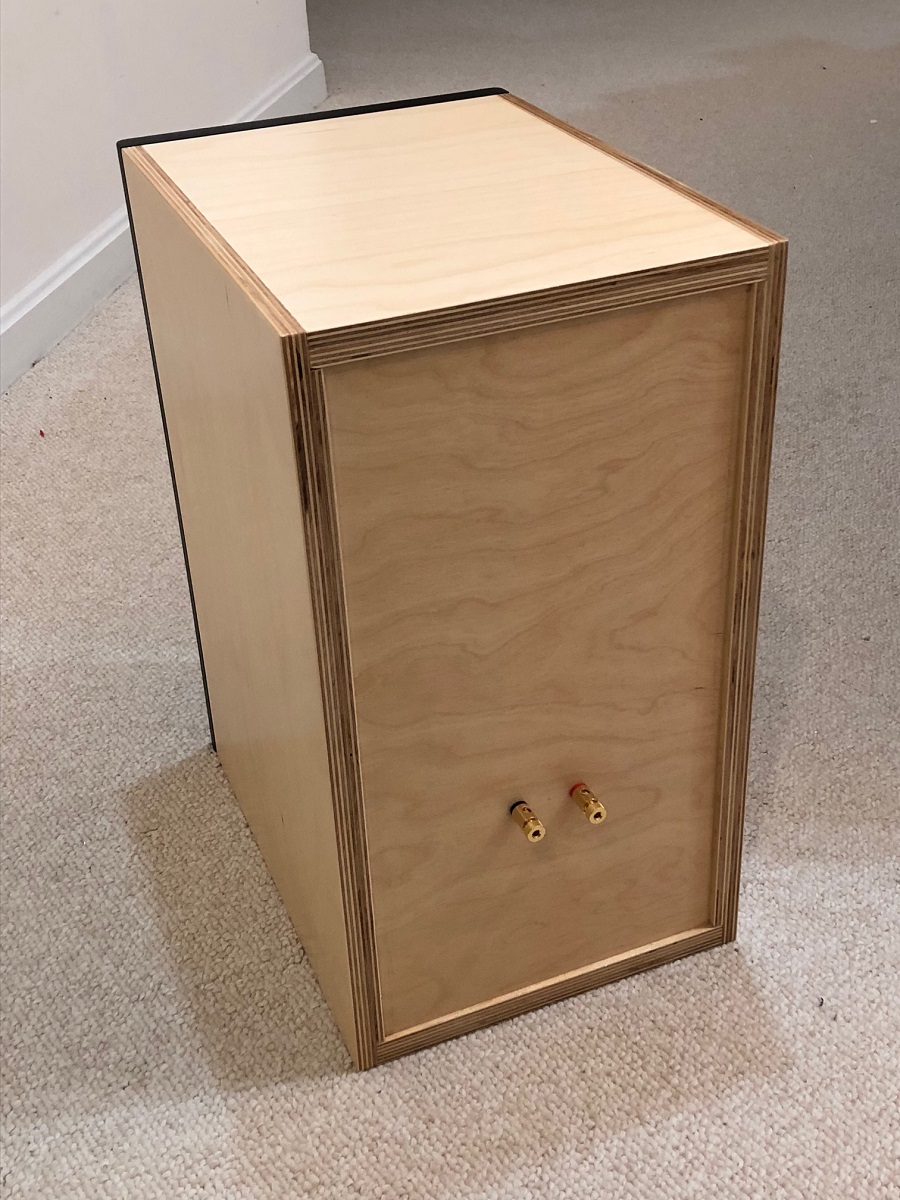

Finally, real wood speakers

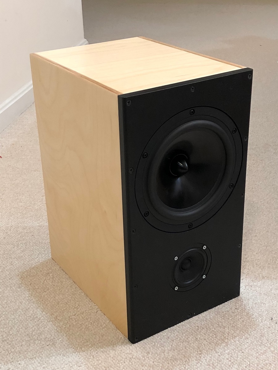

My 10F/RS225 FAST speakers arrived today and they look beautiful in satin blonde sides and crinkle Duratex baffle.

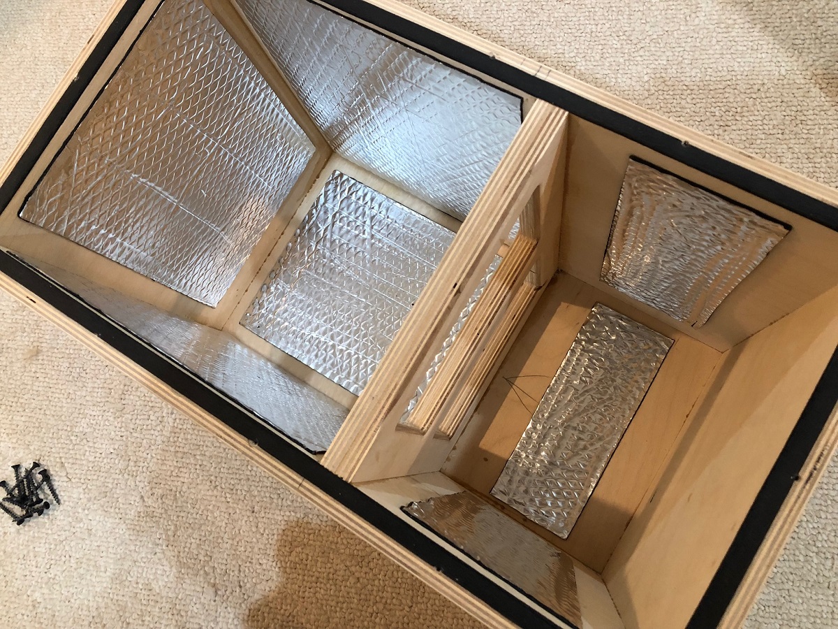

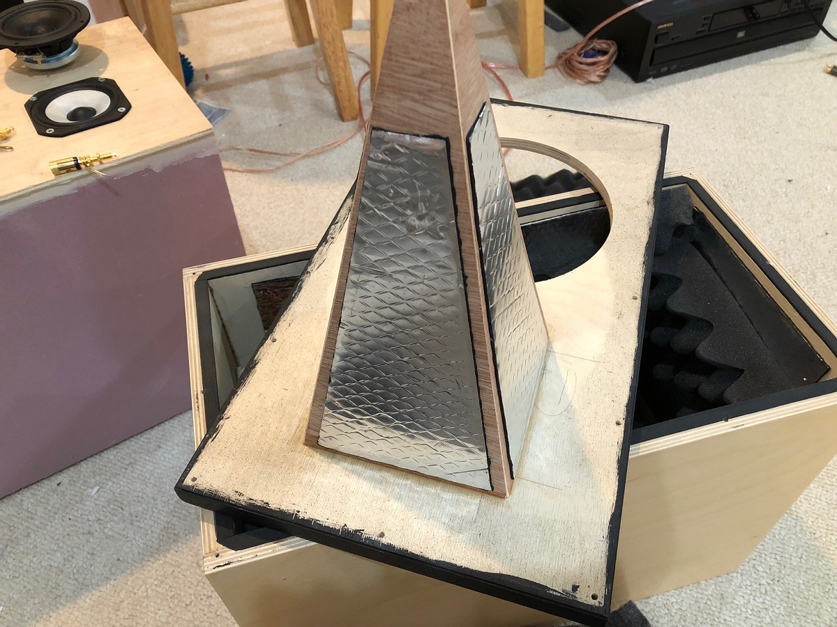

Here are some photos installation of the sound dampening material, crossovers, and the drivers.
Noico liner on most surfaces to deaden the ring of 3/4in BB ply:
Here is a detail of the Dagger back chamber, it is also covered with Noico liner (inside is stuffed with fiberglass, and periphery around cutout is lined with felt):

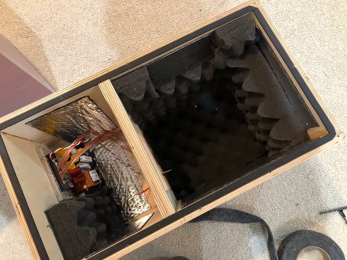

Here is the inside now covered with acoustic foam on some walls and crossover mounted:
Completed speaker:

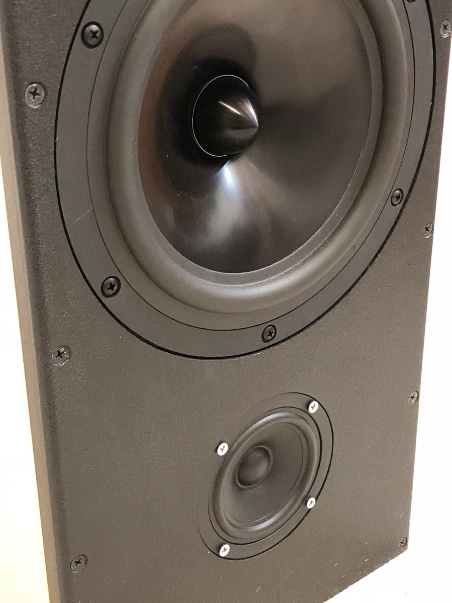

Detail of baffle (Duratex finish):
Backside with gold binding posts:

Very nice X!
Ran out of black screws for the 10F? 😉
If you ever want to do a stone version... 😀
X,
Those look very nice and well constructed. The ply is beautiful with many layers, and the construction is using lap joints - so they should be very strong. First time we are seeing a "dagger" cabinet in plywood?
The Duratex finish on the baffle is looking good, and Perceval is right - the 10F need black screws! 🙂
A stone baffle should be done some time... Perceval, black granite maybe? 😉

Thanks, guys. If it was just me, I would keep listening to my XPS foam boxes, but these are going to be the showroom models for my shop - like my Pocket Class A headphone amps, I will sell these on XRKaudio as well.
After taking the drivers out of them it’s still amazing to me how light weight they are - like air. They have worked well for over 2 years and any design that lasts that long in the speaker lab deserves a better looking (and sounding) box. I am quite sure that this will reduce some of the wall rattle distortion from the older ones. The flush rebate mounts should reduce diffraction. A stiffer cabinet should increase midbass and bass articulation and accuracy. They sound great but haven’t had a chance to measure them yet.
I ordered a bag of the slightly too large #6 black screws. I guess I needed #4 so will take a while before the order gets here. I still have to build the second box. These things take so much more time than one anticipates.
I have some orange sports pylon cones that someone recommend - they would in fact, be perfect. I may use those on the other test baffles. But I figure that for a showroom speaker, an all plywood Dagger would be best. It needs the Noico sound dampener sheets. That’s one thing nice about foam core - very acoustically absorbent (not reflective). This speaker has a removable baffle and I have a quiver of spare baffles made up. One with a cutout for SB23NXRS45-8, another for the B80, and another for variants of the 10F like TC9FD, TG9FD, etc.
