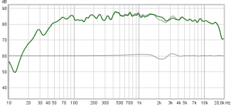

This is a dirty quick simulation using the edge to show difference when 10F is positioned offset or into center of baffle, grey trace at 60dB number on Y axis show the difference response between the two positioning and above that is green trace measured response from post 1 where 10F was offset positioned and another grey trace overlaid that show difference curve added to green trace.
Think positioning in center of baffle often is relative worse than off-center trick, but for center position it seems errors become symmetric same relative to left or right side of speaker so EQ correction will work, where off-center position seems will need different EQ correction scheme relative to left or right side of speaker.

The reduced baffle diffraction is minor (thanks to Byrtt for simulating that) compared to how many people visually like a symmetric looking speaker. If you look at most commercial speakers nowadays, they have pretty much gone away from offset tweeters. It makes production easier too as there is only one design. The visual aesthetic is an important overall requirement. But in terms of sheer performance, offset is better and even better is a trapezoid.

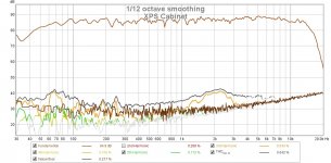

Some preliminary measurements of the new BB cabinet (left) vs the XPS cabinet (right), so not exact same drivers but the XPS boxes measured pretty close before.
Using a VHEX+ amp, Focusrite 2i4 DAC for source, and UMIK-1 microphone with Cross Spectrum Labs calibration, Dr Meter absolute SPL meter. Taken at woofer axis 0.5m awat and 2.83vrms as measured with Fluke DVM with 1kHz sine wave.

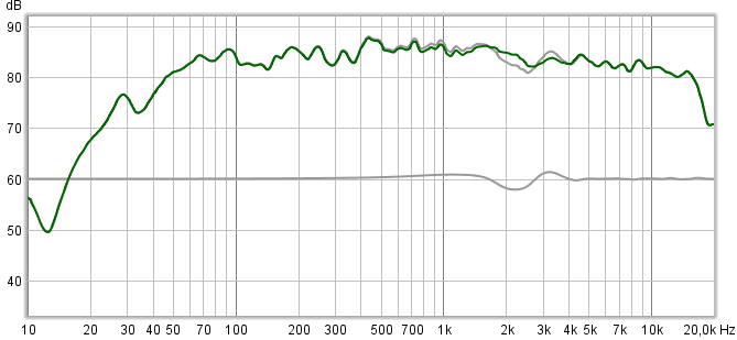

Here is the XPS speaker distortion as a function of frequency:
The bump in H3 distortion at 3kHz is from the woofer - I know this because when the XO was outside (with the XPS cab), I was able to measure just the woofer only.

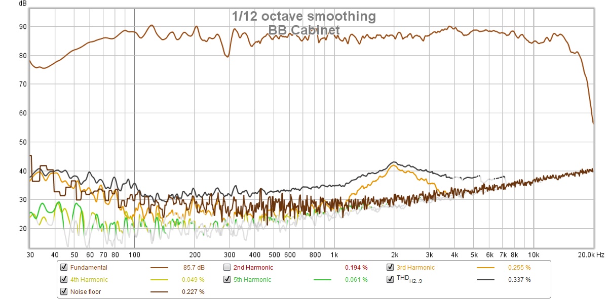

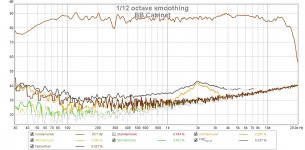

Here is the new BB speaker distortion as a function of frequency:

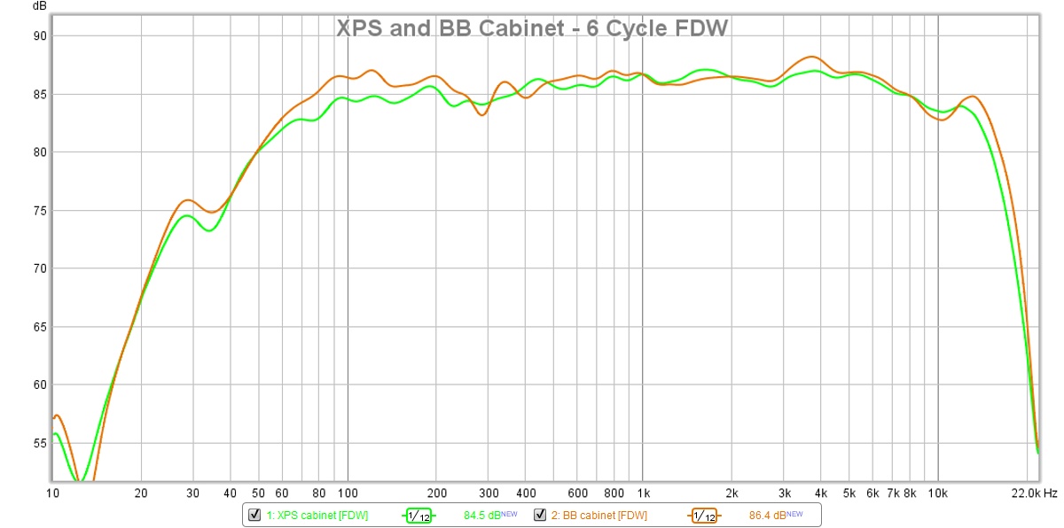

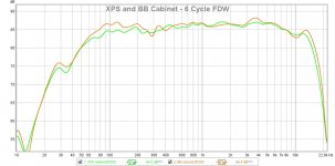

Here is overalay of the frequency response between the two:
It looks like the stiffer box gained about 2dB of bass output at 100Hz, and the bass distortion went down. The XPS box appears to have a smoother response in general. Not bad for a lightweight foam box. The BB cabinet has a sharp notch appearing at about 280Hz, and a notch at 10kHz. I am not sure what is causing the 280Hz notch other than floor bounce - but then why is nit not on the XPS? The 10kHz dip might be a reflection from the cone to the thick edge of the baffle. I did put a 0.5in radius round-over internally. But overall bass presentation is probably more accurate and less noise with the new cabinet.

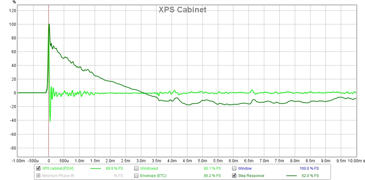

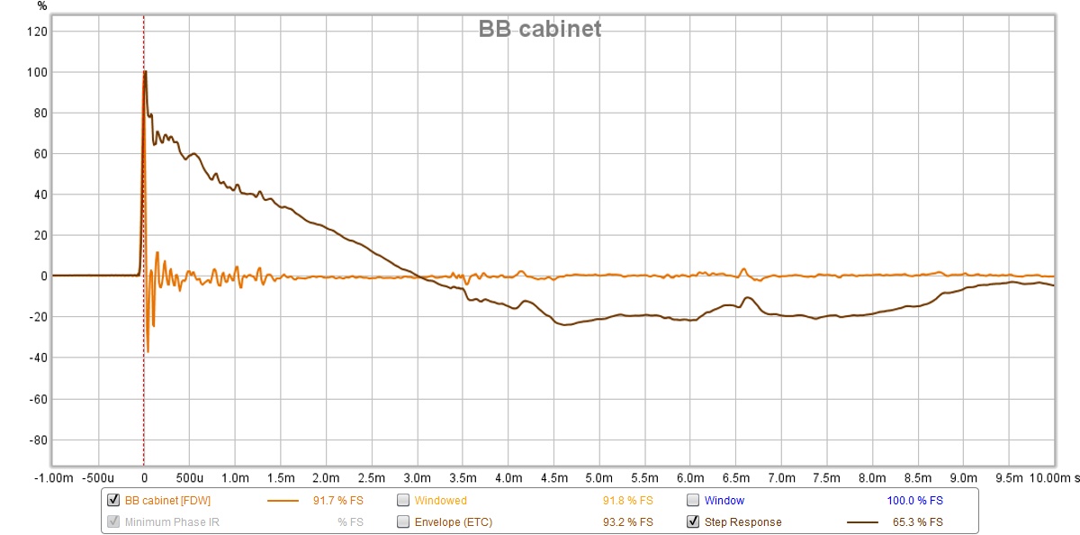

The step response of the BB cabinet seems to have a more right-angle looking triangle vs the XPS foam which had a slight sag. I suppose this can be interpreted as a more direct percussive quality.
SR for BB:
SR for XPS:
SR for BB:
SR for XPS:

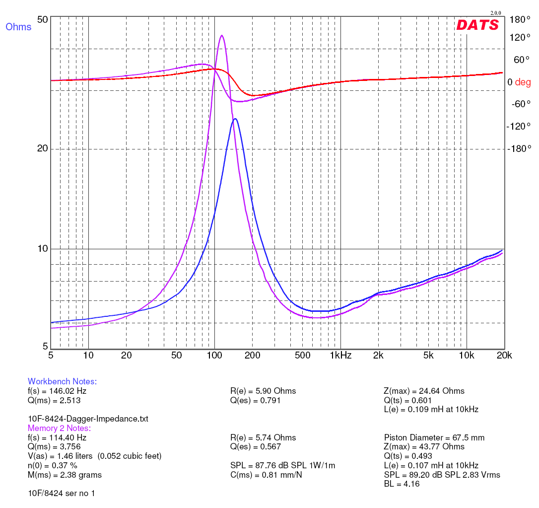

Back in Post 115, this is 10F in Dagger:
Looking back, it could probably use more fiberglass to flatten that peak even more. But I am highpassing way above 110Hz so that region is not that audible anyway.

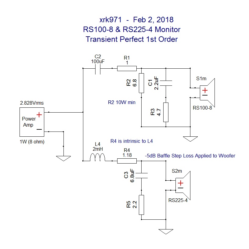

Sorry, I may have given you some wrong figures here off the top of my head. The RS225-4 is 4ohms so the coil value actually worked out well to go to 2mH (cheaper and lighter). I did not have the FRD/ZMA files for the TC9 on hand so used the RS100-8 as a surrogate. You, could of course build one with the RS100-8 and it would sound quite nice.
Here is the revised schematic for an RS225-4 and a RS100-8 midtweeter, I have already subtracted -5dB from the factory FRD file (which assumes a very large baffle). So look like overall efficiency is a true 84.5dB or thereabouts. Not bad.
Here is XO schematic:

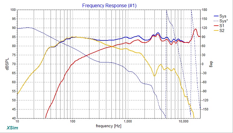

Here is predicted FR:

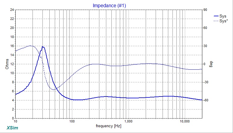

Here is predicted electrical impedance and phase as seen by amp:

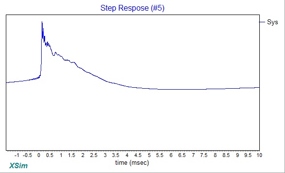

Here is predicted Step Response with tweeter having a 0.75in setback:
Byrtt will probably be able to do a better job at helping us to get the acoustic phase flatter. But the main thing is that you need a 2mH coil not 8mH!
Here is the coil I used for the sim:
Jantzen Audio 2.0mH 20 AWG Air Core Inductor Crossover Coil
For the 100uF cap, use two 50uF film in oil motor run caps in parallel, or two 220uF 100V electrolytics connected -+/+- or +-/-+ to act as non-polar.
