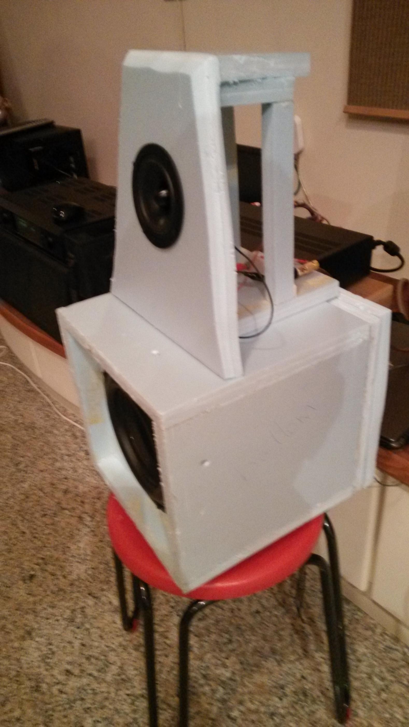

It should work OB as well, but the back wall reflections could be ruining the whole transient perfect timing thing.
656506d1515836784-10f-8424-rs225-8-fast-ref-monitor-img_20180113_174452-jpg
Your setup looks nice - it should work, so probably something off in the XO. Try to reduce the C-T-C spacing between the woofer and full range so that the sound appears to come from one source.
Is that 1in thick XPS foam insulation sheets?
It is 2cm XPS foam, more like 3/4".
I could play with them more, but there was something really fishy with the sound.
It was all garbled, no definition, no spatial cues. Nothing like my big OB setup. The magic of OB was not there with this smaller setup.
I will try again later, either trying to polish that 1st order XO, or just go back to the Harsch!

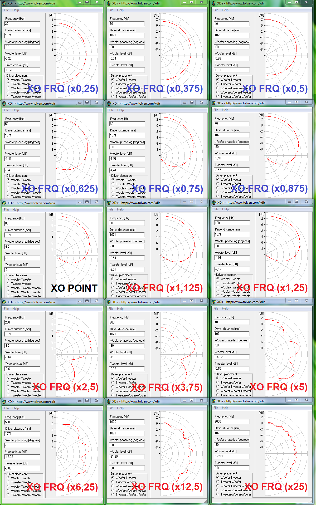

Its right 1st order sums transient perfect in electric domain or with a coxial unit but when physical spacing is used that develop a rather complicated unsymmetrical looking summing polar and that's maybe the reason Dunlavy used WTW config instead of WT. Say the two summing drivers have needed bandwidth plus exactly same polar dispersion and time aligned plus spacing is set exactly 1/4 wave then below visual should show what happens summing 1st order. For HARSCH XO 1st 2nd and 3rd row below is nearly same looks but in 4th and 5th row it will look better and symmetrical follow the 0dB spin.

I had the woofer at ear level, and FR higher up, I figured it would induce the same delay, plus, I placed the FR 5cm behind the woofer.

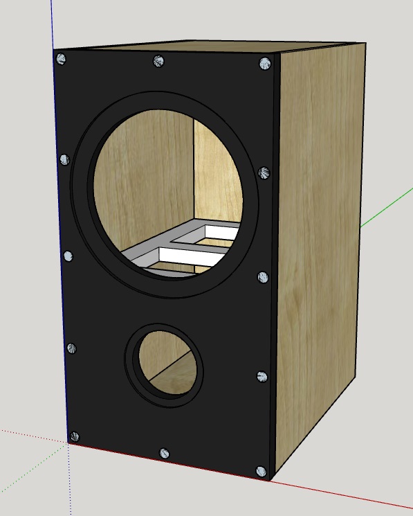

Thanks for your interest. The drivers remain valid: 10F/8424 and RS225-8. The RS225 is unique in its price range and exhibits TS parameters and build quality of something maybe 3x price range.
Cabinet is simple prismatic box 10in wide x 18in tall x 12.5in deep (external dimensions) and 3/4in MDF of 18mm B.B. ply. A single window brace inside is sufficient. Line walls with eggcrate acoustic self adhesive foam sound insulation pads or 12mm felt. Add loose fiberglass stuffing inside. For Dagger make three triangles 12in tall x 6in wide base. Glue together to make 3 sided Dagger. Glue 6in edge x3 mouth to baffle. Stuff with Fiberglas progressively denser towards vertex. Make sure airtight so woofer doesn’t leak into midrange chamber. Or use 9n tall sport cones stuffed with fiberglass as shown a few posts ago. Internal volume of main box should be circa 24L or so. Volume of Dagger should be about 1.2L to 3L max. Baffle should have drivers as close together as possible but to allow room for window bracing and Dagger, about 7.5in CTC is about right. Woofer in top above mid tweet.

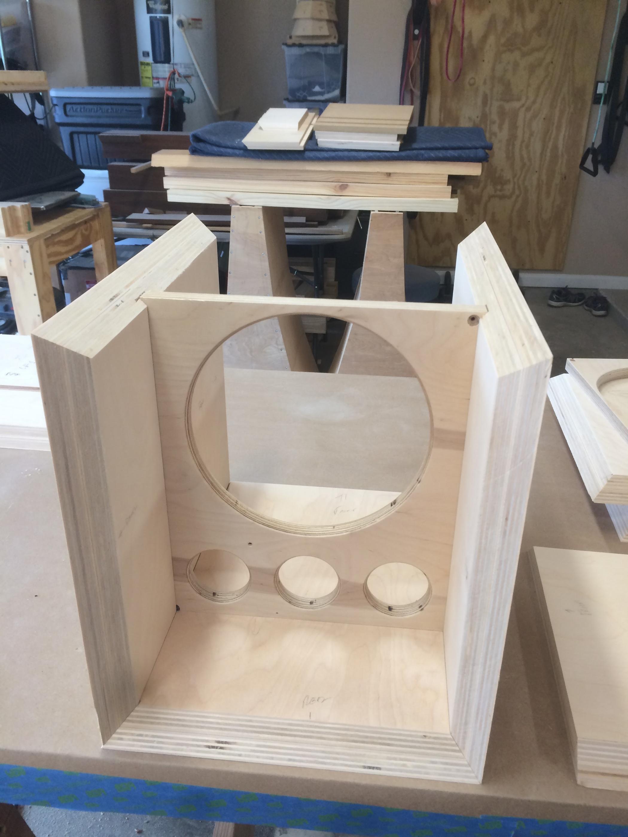

Here's a pic of the brace I made from my version of these. The enclosure is just for the rs225. The walls are 50mm baltic birch, and the brace is 18mm.
Wow, 50mm BB walls! 😀
I might line the inside of my 3/4in BB with the automotive sound panel dampening sheets (sticky mass loaded black butyl rubber faced with foil), then add the 1in thick eggcrate foam sheets. These details seem to make a difference with lower HD in the end.

Interesting, is this move inspired by a deficiency in your previous XPS foam build, or is it due to differences in the absorbent properties of BB vs foam?
I've seen Troels Gravesen recommend bitumen pads for lining the interior of some of his speakers (with felt on top). One thing he seems to keep mentioning is to glue them on with additional adhesive since the stuff they come with tends to weaken with time and cause them to fall off...
Another question, if one was to substitute the 10F for another driver, which of the TS parameters would you be most worried about matching? Or do you consider the 10F critical to the success of this speaker?
I definitely have some mild wall rattle that causes an exaggerated harmonic distortion reading at the lower registers. Gluing on a thin wood veneer with a pliable adhesive like I did for baffle helps a lot. For the BB cabinets, I am taking my cues from Bushmeister, when he built his point source horn cabinet, he used every trick in the book, including sorbothane sheets between the braces and the driver magnet, between baffle and braces, thick felt lining, etc. His distortion numbers, were without a doubt, heavily influenced by use of the superb SB23NRXS45-8 driver with remarkably low at deep bass frequencies while making 100dB at 1m. So, I will try some of the tricks that are easy to do.
