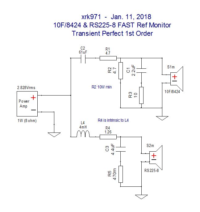

10F/8424 & RS225-8 Transient Perfect XO

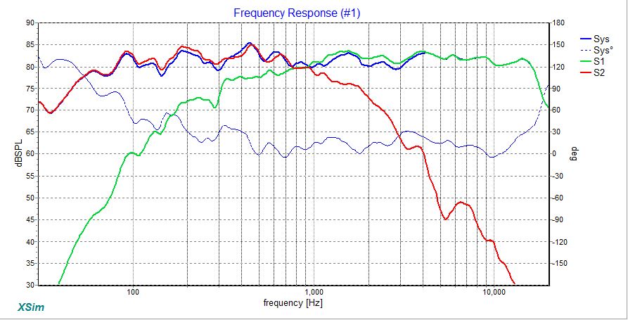

Here is the Xsim results using my measured FRD and ZMA files from early on this project. Nowadays, I would have used FDW gating of 6 cycles rather than the 1/12th octave smoothed data as shown here.
Here is the schematic (with 4.4uF & 0.47R filter added for woofer):
Here is the predicted frequency response & phase, it would appear that the XO frequency is visually somewhere closer to 800Hz:

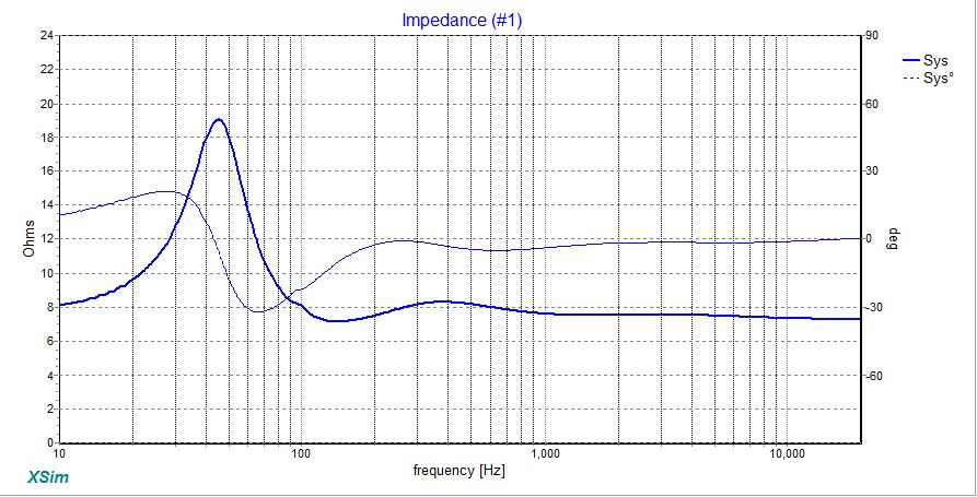

Here is the predicted impedance:

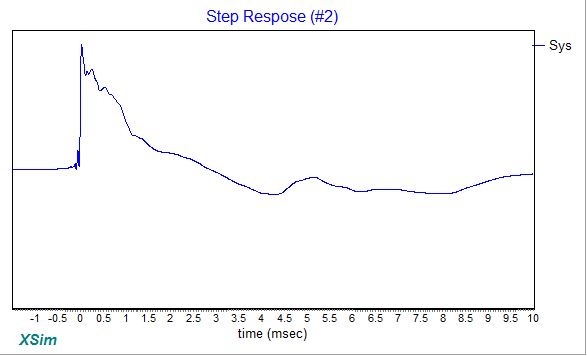

Here is the predicted step response:

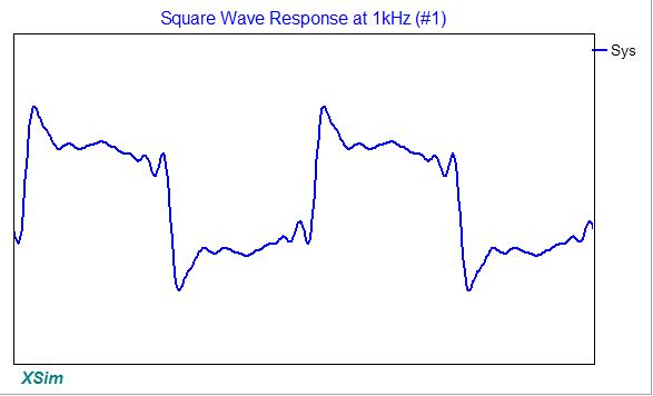

Here is the predicted square wave at 1kHz:
The Xsim project file is attached as a zip file.

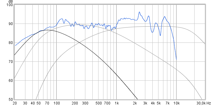

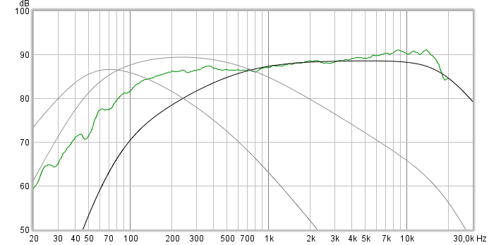

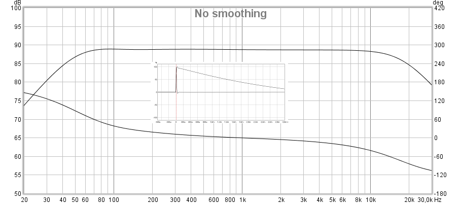

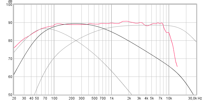

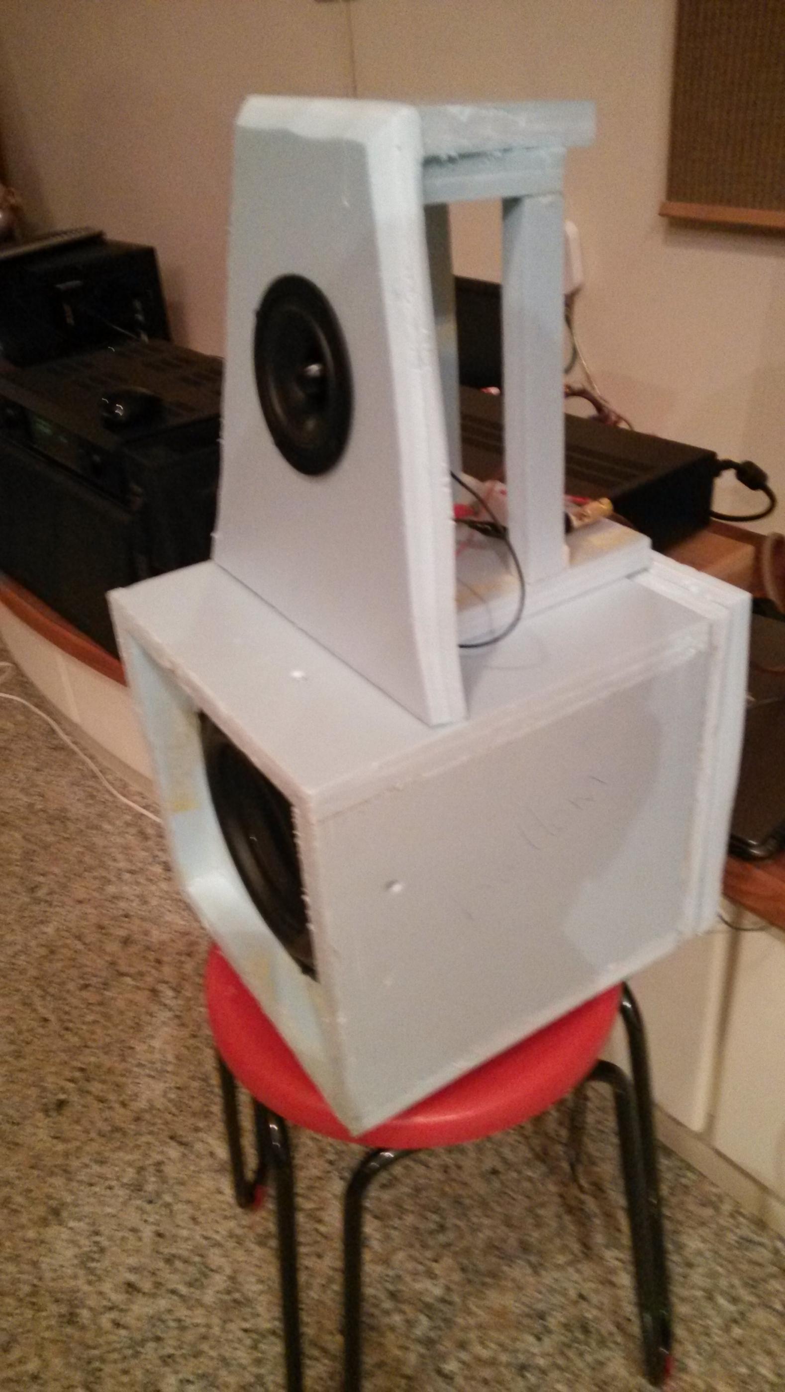

How about these graphs X : ) its still a 1st order XO and still 10F and AC130 can sit its own small enclosure with mid tweeter below woofer and then place SB23 on floor.
In theory think many improvements will happen, one is break up areas for AC130 and SB23 is relative better depressed, one is 10F/AC130/SB23 all show their own good distortion figures and smooth response inside these bandwidths, one is with these less driver diameter steps off axis coherency should be better covered between bands.
Target curve verse 10F datasheet:
Target curve verse AC130 datasheet:
Target curve verse SB23 datasheet:
System sum 50Hz-18kHz band pass (transient perfect):

We could almost do hole-filler with this scheme. 2nd order on SB23 and 10F and 1st order on AC130. AC130 is almost a wide band driver.
Yes but for real hole filler its scary in real world that SB23 slope shall be as smooth as 10F on and off axis up where they 2nd order meet and supposed to acoustic perfect cancel each other out.

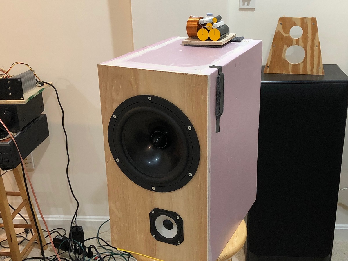

The SB23's showed up. They are really nicely made. I connected them to the RS225 XO sitting outside of the box and they sound quite nice. They are larger than RS225 by maybe 5mm so not a drop-in replacement. I will have to get some test baffles made.

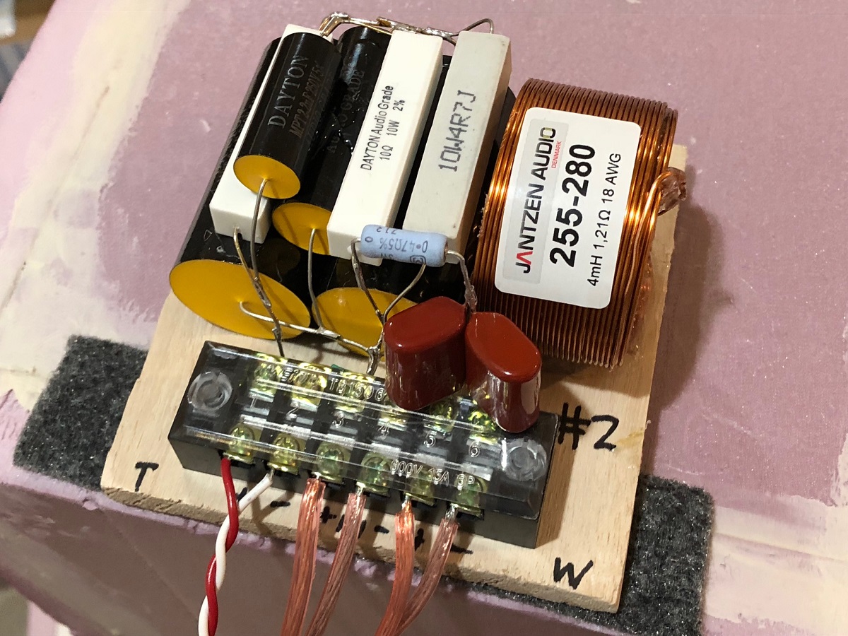

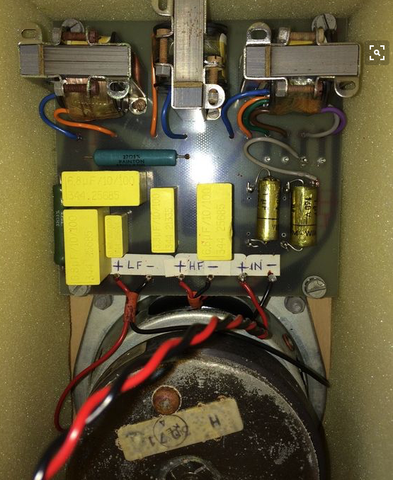

I just made another set of nice XO's, these will be for my own speakers, new BB cabinets on the way. Here I am testing them with TG9FD-08. Works well, sounds very balanced.
Closeup of XO with all film caps:
With TG9FD (8ohms)
With TG9FD (8ohms)
