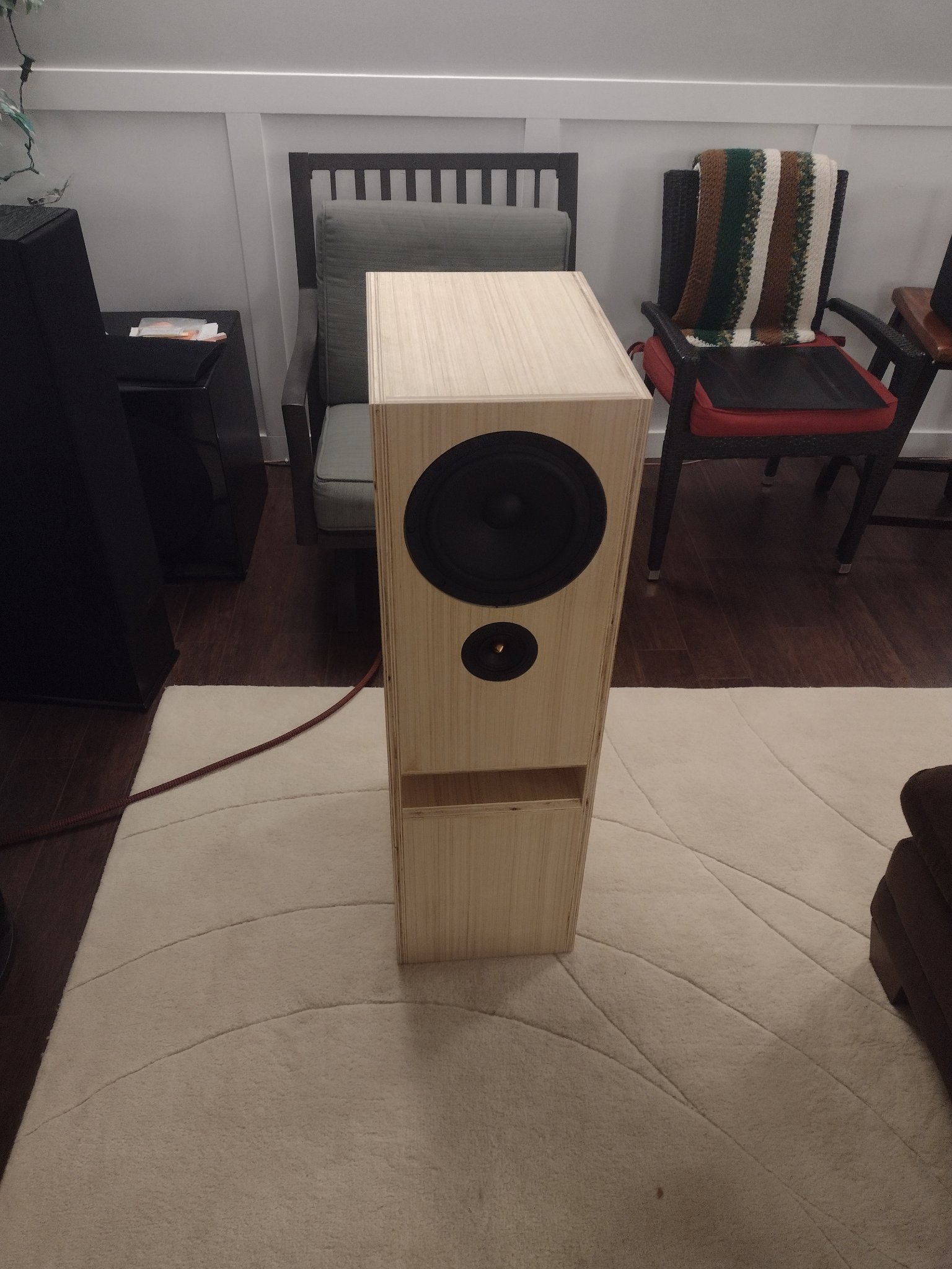

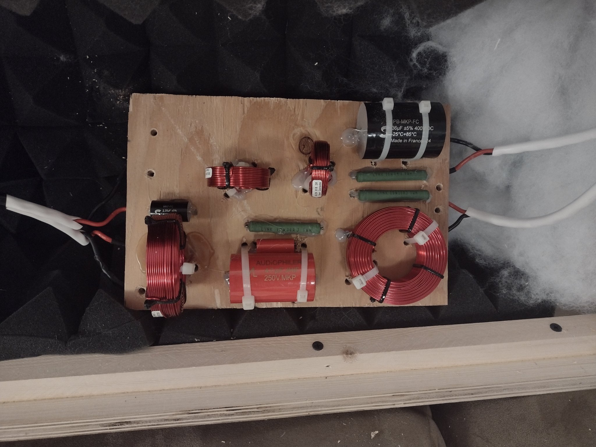

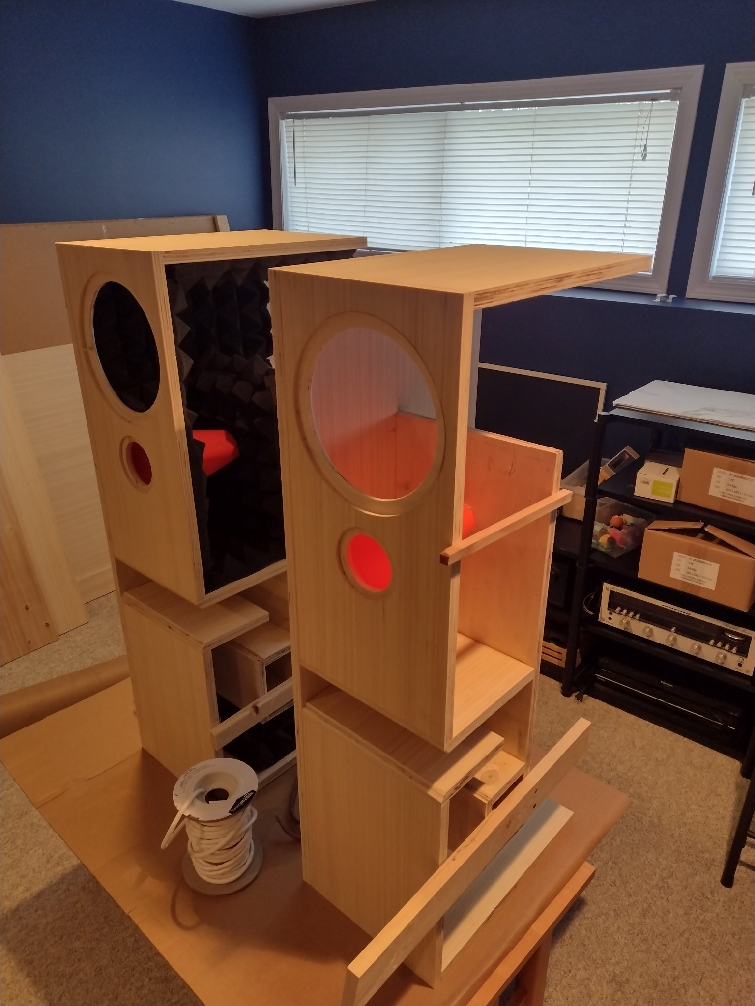

So I finally got to hear these. Using SB23nrx45-8 with PS95-8. The bass and midwoofer sounds about right, the highs are kinda there, but there is no midrange, or it is a very poor blend between the 2 drivers. I seem to have alot of volume with the SB23 but very little output from the PS95-8. I used the crossover schematics below
https://www.diyaudio.com/community/threads/10f-8424-rs225-8-fast-waw-ref-monitor.273524/page-211
What controls the cutoff and level of the PS95-8. Should I try a smaller capacitor in the tweeter section to try and gain some midrange. Unfortunately I have nothing to measure anything so I am kinda shooting in the dark. I just know it doesnt sound good. Going to break down the crossover and boards and set them up on a terminal block so I can change out values and test.

Gsrchrisu,
Nice work on the cabinets - beautiful woodwork!
Thanks for trying out the SB23 and pS95-8. I never tried the SB23 in the TL which was really designed for the RS225-8. So you mileage may vary on the bass.
As far as lack of midrange etc, I am not sure but it could be that the SB23 and PS95 was designed for the tweeter to be on top like a conventional speaker. That’s how it was voiced and measured.
Try reducing R1 from 3R to plain jumper (0R) and see if that helps.
1731413336303-jpeg.1394449
Alternatively, try C3 = 8.2uF and L1 = 1.5mH and adjust R1 by ear circa 1R to 3R
Reactions: gsrchrisu

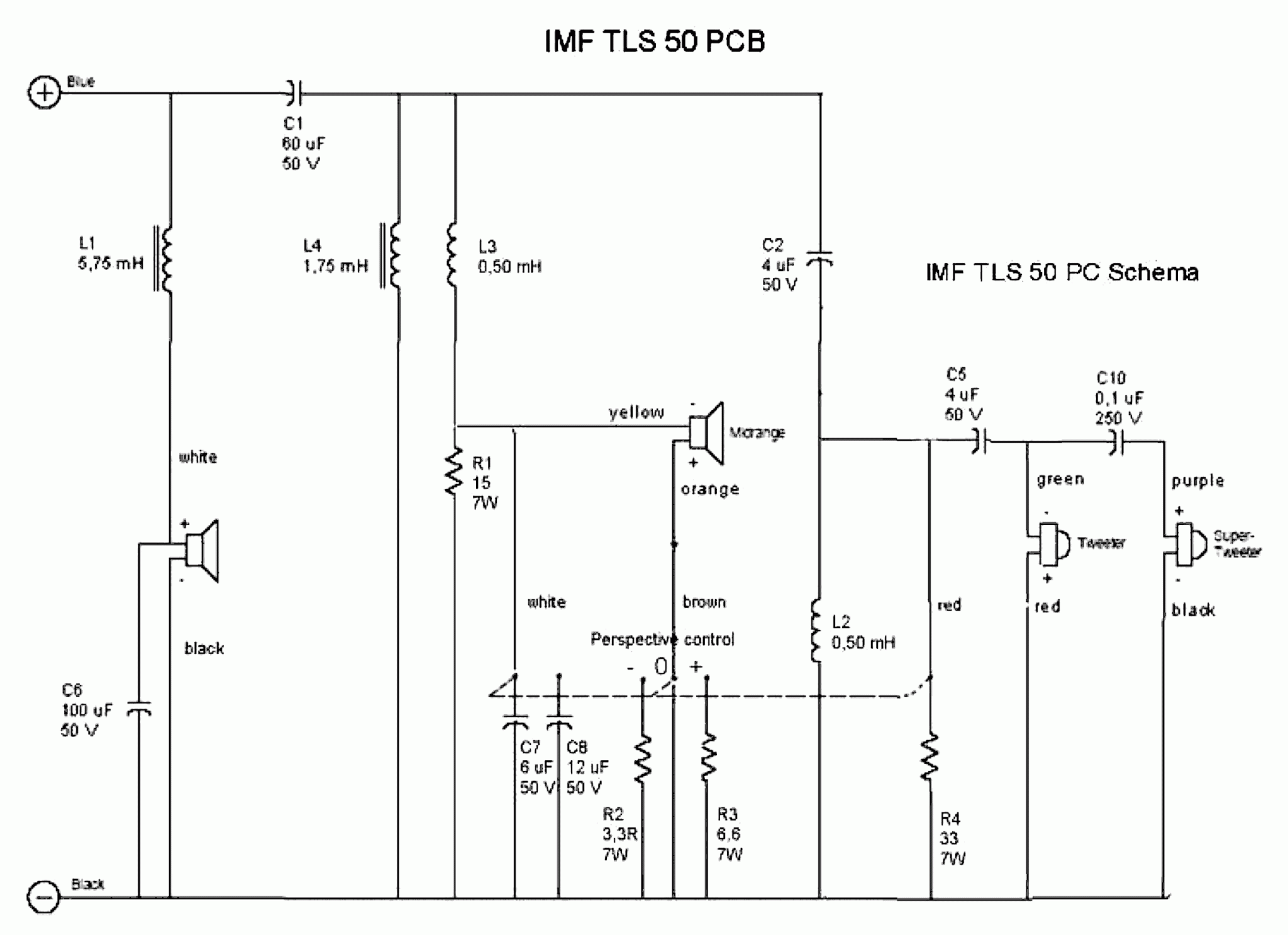

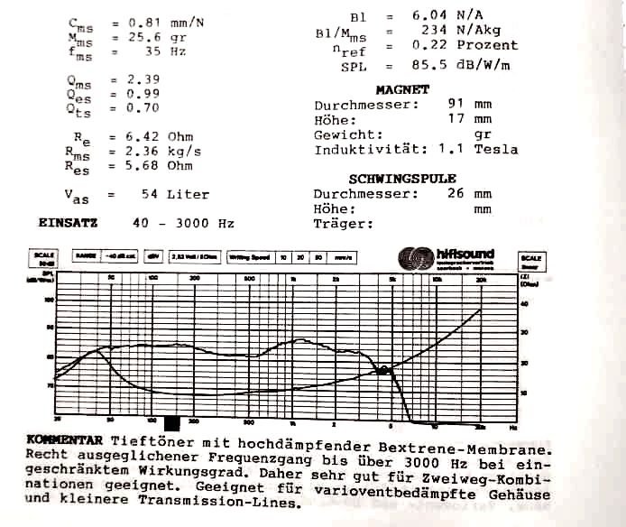

I just bought a pair of 10F/8424 so hoping to get something up and working. I'm well into retirement so unable to do any major carpentry and live in a London apartment anyway. So I'm looking to find a donor speaker with a bass unit that would mate with the 10F. I have a pair of Kef B200s so that's one idea. The crossover might be an issue since there's a hump in the response, see pic. It was used in an IMF 3-way so there's a specimen xover there to start with, but I don't have the tools to refine the response. There are some Mission speakers with 8" bass units and plenty with 6.5" units. It would have to be something available easily in the UK. I could just use the donor cabinet and buy a pair of bass units but I don't want to throw money at it - something good value with least effort involved.
One question - why does the 10F need a crossover filter to roll off the bass? It seems to roll of quite naturally.

First, I would say you need to use the correct crossover. It is quite simple and can be built point to point on some prototyping board. It is as important a part of the speaker as the drive units (actually maybe more...)
