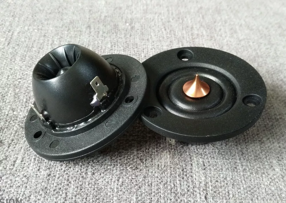

Once the entry level HiFi classic was 8"+1", but that approach had problems in the midrange. The high directivity of the midbass and the wide polar characteristic of the tweeter are not a good match. Today it is it is usually resolved with waveguide. on a tweeter.
This concept with a small full range + bass helper 8" I think solves that problem pretty cheap. Only now there is a directivity problem at high frequencies. Has anyone tried adding a cheap backfire tweeter to this configuration? I think it would be a very good move.
If someone wants to play, these are good tweeters for little money. "Vifa" XT25A, ebay or Aliexpress. Since the crossover is at fairly high frequencies, the wavelength is small and to avoid lobbing, they should be installed at the back. Experiment to determine which is better, to be in phase or out of phase with respect to the FR driver.

I did find that my ears in my room with my speaker placement prefer a bit more dispersion on the HF than the 3" FR can provide so I have been using a filler tweeter 10k up, currently a dipole GRS ribbon.
I have a pair of ribbon tweeters so that can be done. I don't know if my older ears would tell any difference - worth trying since it's probably just one capacitor for the roll-off at 10K or whatever.
