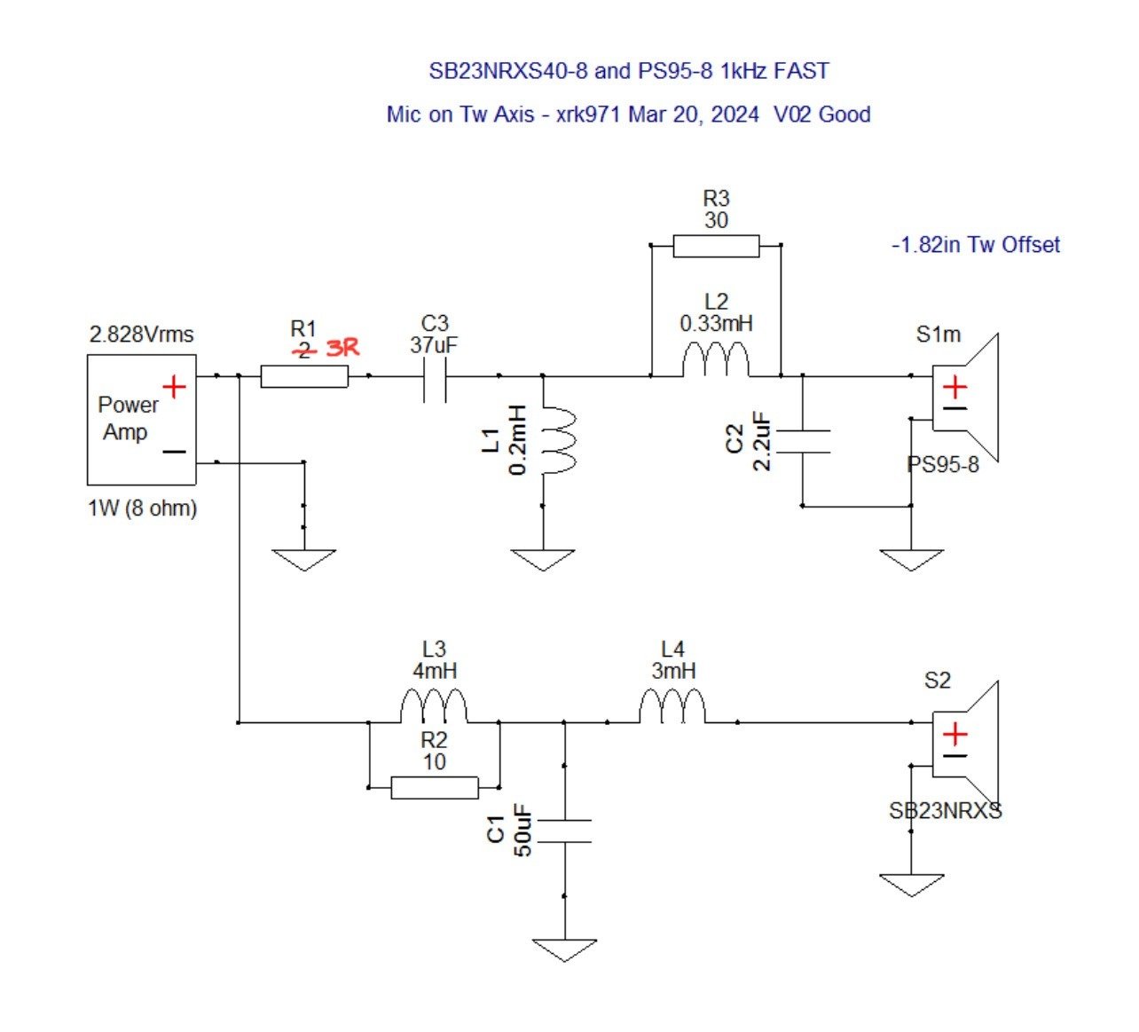

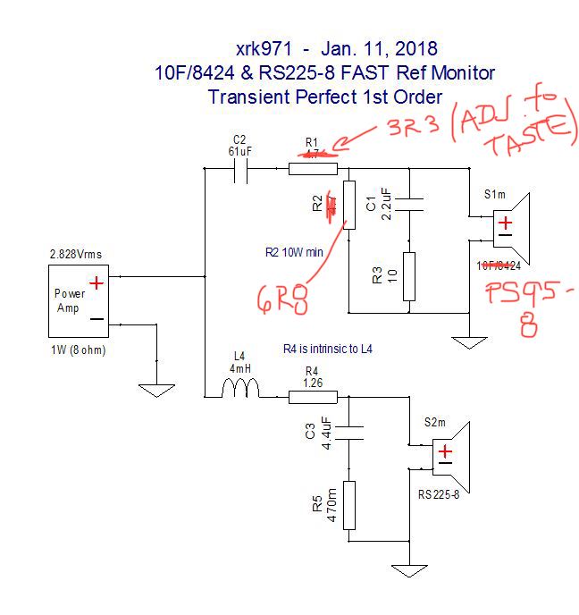

Question about the crossover. Which one should I use if I use the RS225 with a PS95-8? The one proposed by XRK in 2018? Or take the bottom half of it and combine it with the top half of the crossover for the PS95-8 and SB23NRXS45 seen in the second schematic.

Question about the crossover. Which one should I use if I use the RS225 with a PS95-8? The one proposed by XRK in 2018? Or take the bottom half of it and combine it with the top half of the crossover for the PS95-8 and SB23NRXS45 seen in the second schematic. View attachment 1394726View attachment 1394727
The second crossover is only for the SB23 woofer.
