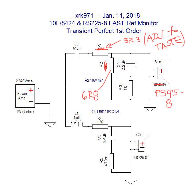

Hi everyone, I’m new here. I’ve been lurking on this thread for a year or so wanting to pull the trigger on a modified version of this using the Dayton audio ps95-8. I’ve used this driver a couple times and I love it. And I have some on hand already that need using. I saw another user who build a set using this driver but they used dsp. My question is, does anyone here have a crossover schematic for this combo? I’m guessing the origional crossocer wouldn’t work without some tweaking as the 10f seems to have a 4.5 db advantage over the ps95. But if there is some attenuation of the 10f, maybe I could lessen or do without the attenuation circuit? I’m still quite new and have yet to design a crossover myself. I’ve tried and it just doesn’t make sense to me. And I don’t know if this os even the right place to ask this, so if it isn’t, I apologize. I appreciate all the help and hope to become a more active member in the forum.
Hi X,
In post #4112 you showed the finalised XO for the SB23NRXS40-8 & PS95-8 speakers in the sealed cab.
Does this same crossover work for the TL version using these speakers or are there minor adjustments required?
Apologies for the stupid question, but I am just starting to re-read this thread and my knowledge of crossover design is sorely lacking.
Regards Richard

Hi Jim,
I’m really interested in building a fast speaker with these drivers as I have them both on hand. I love the ps95 so much. I’m curious what kind of dsp you used for this? Did you happen to make a passive crossover for this combination at any point?

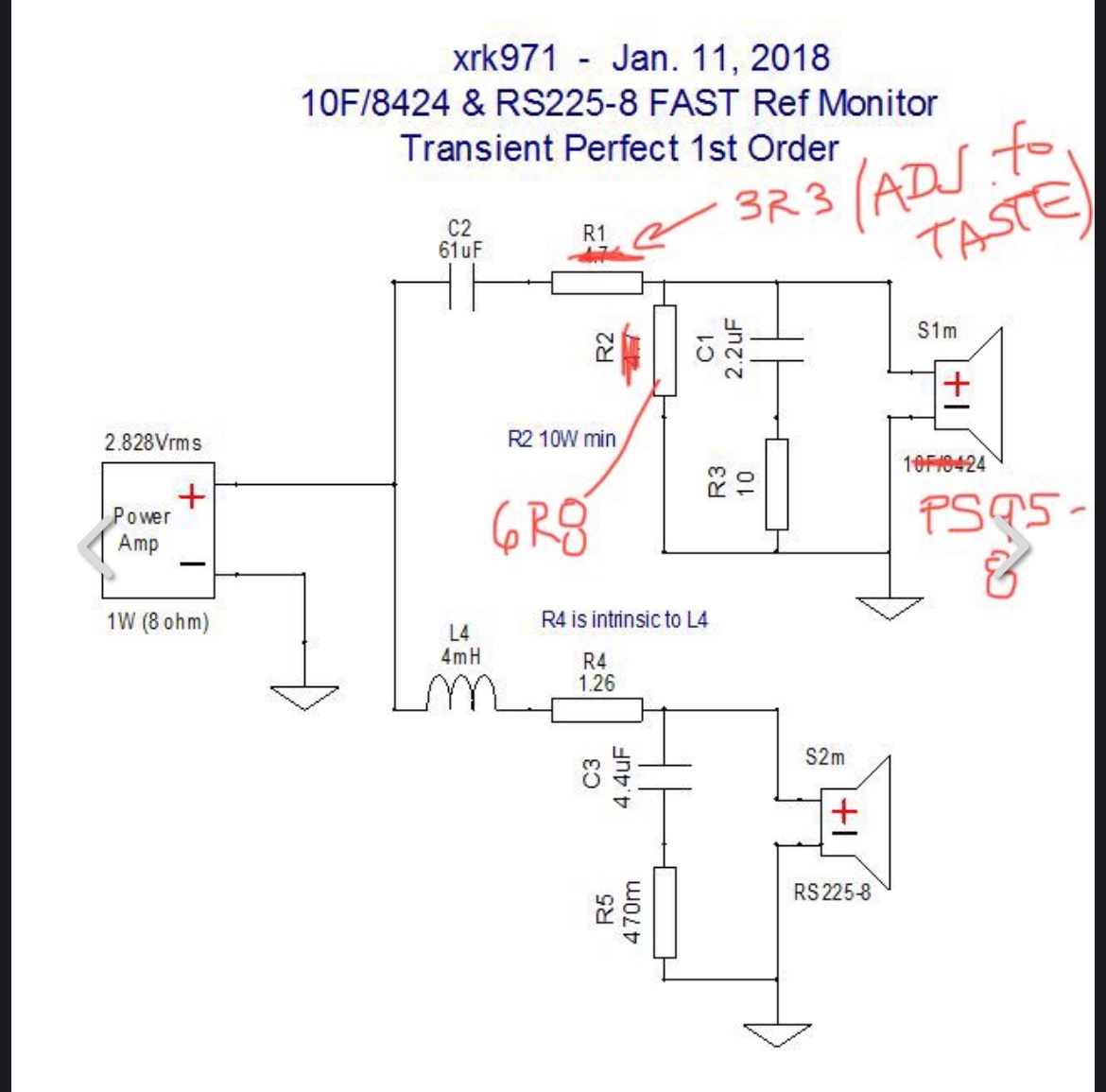

Hi. Absolutely yes they were fully passive. I just followed the XO for the design proper in this thread but ended up lowering the padding to the PS95 to give some more 'highs'. I found my PS95s rolled off quite a bit after 14khz, although I can't hear much above there!
This is maybe what I went with...
Ok thanks! Question though. Where it says 3R3, and 6R8, I don’t really know what that means…are those values for the resistor? 3 ohm and 8 ohm respective?
Edit: oh never mind that’s not what it means at all. Ok so just adding an extra 4.7 ohm on r1 “stacked” if you will? And that will reduce the padding on ps95-8? Sorry, crossover stuff still is not something I can wrap my head around yet.

Ohhhh ok. Ha! That’s a great little piece of shorthand for me to know! Ok. I will try that. Are you happy with them still? I can’t hear above 13,000 hz anyways so that’s fine with me. And my wife, well she can’t hear above 11,000! Or was it 10,000? And we are only in our 30’s. Too many concerts maybe? Or it it normal at this age?
Have you heard them before using the 10f instead of ps95? If so how do they compare? Have you ever taken FR measurements of your speakers? I’d be curious to see how it compares to the original design

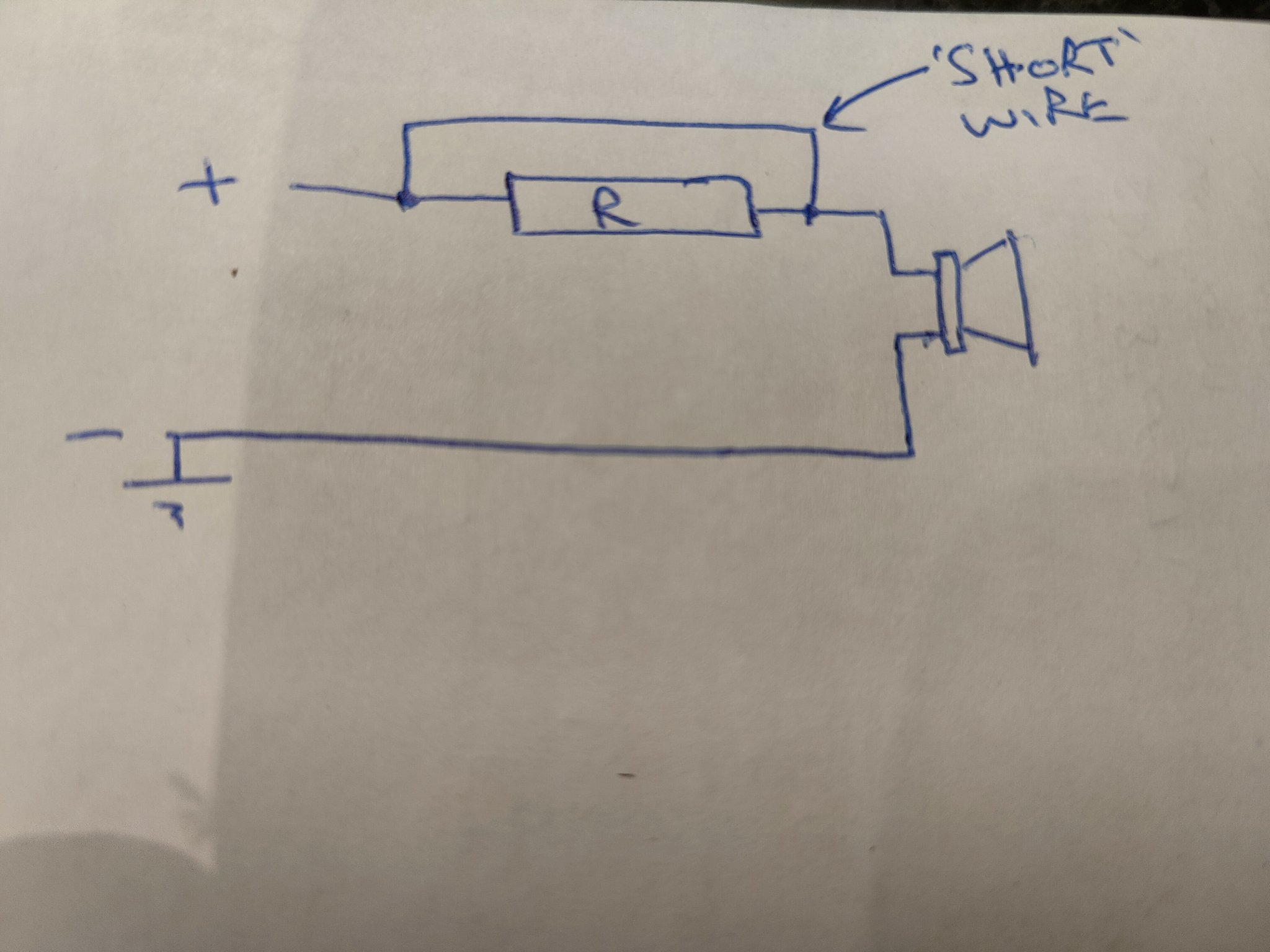

Hi. It is a convention to use 'R' as the decimal point , so here we have 3.3ohm and 6.8ohm.
You will see it for capacitance aswell using 'C' for the decimal point. So 3.3uf will be written as 3u3.
Hope this helps

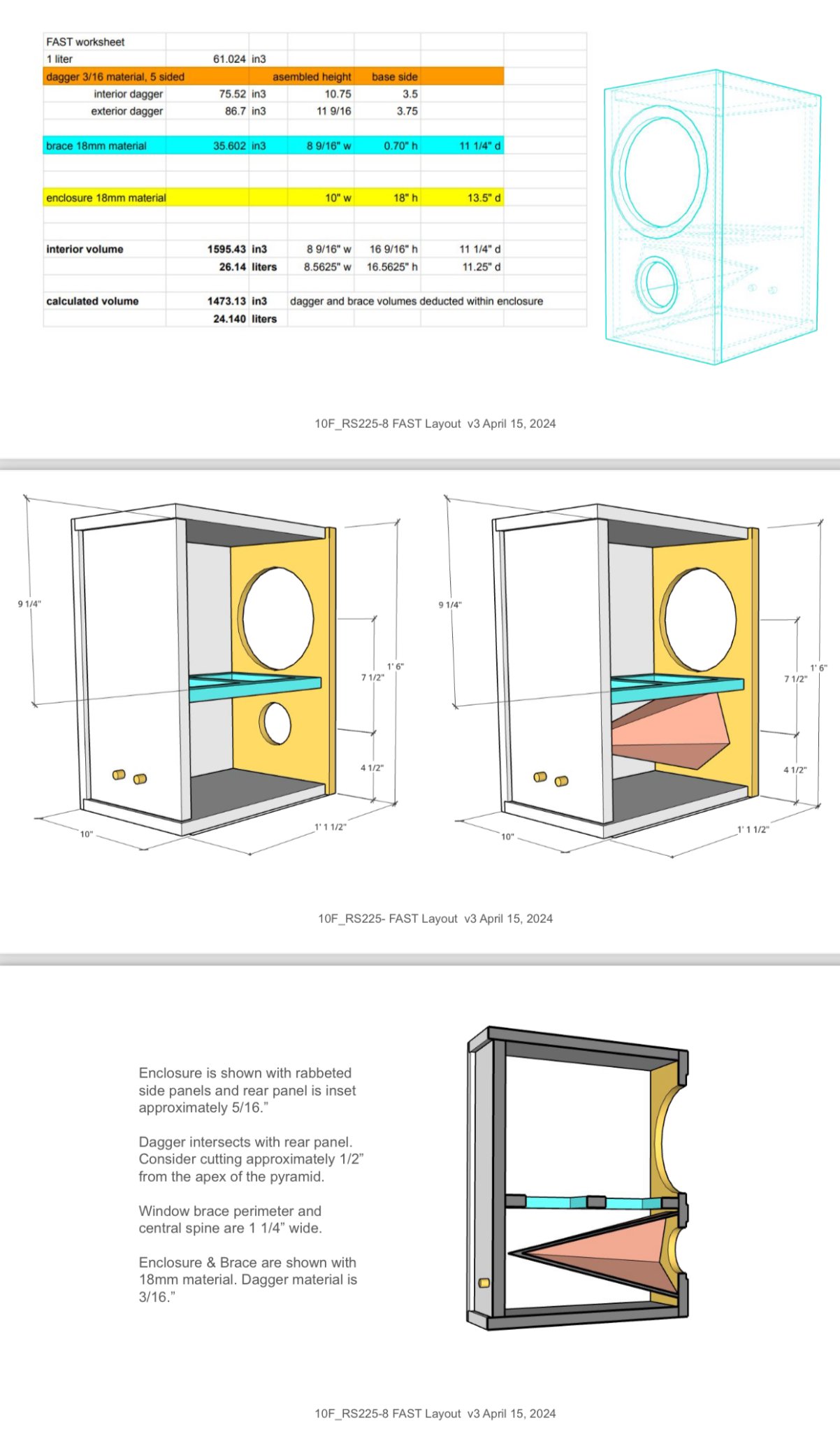

Dimensions of sealed box version: most important is to make the width 10.0in (external) and CTC spacing between drivers 7.5in and adjust the depth and height so that you have about 24 liters volume. If you make it out of 18mm plywood it ends up about 18in H x 13.5in D. The 10F is located 4.5in top to center. You will need a rear chamber for tweeter (fullrange) so use a sports cone or wooded “Dagger” tall 4 to 5 sided pyramid. Stuff Dagger and main box with polyfill or fiberglass to taste.
New SketchUp Plans by @jrKC for sealed version here.
The short sealed TL is made of three 6in wide x 12.5in long triangles. Construction will use 1in thick pink XPS foam and regular foam core for the short TL. The front baffle will also use a thin sub-floor plywood in order to provide adequate support for the heavy 8in driver. The design will have the option of a bass reflex vent that can be sealed for use with a Linkwitz transform, or opened up for some additional bass when group delay is not an issue. The system will use miniDSP for XO and EQ duties and bi-amped. Here are predicted results in 4pi space with baffle step and diffraction effects accounted for. XO will be at 500Hz with 4th order LR. The RS225-8 is an exceptionally flat response driver and choosing a slightly higher XO frequency will keep the distortion on the 10F very low while giving more weight to the mid bass as it comes from an 8in woofer. Calculations show that with Linkwitz transform, bass extension should be about 42Hz (f3) with max SPL around 101dB.

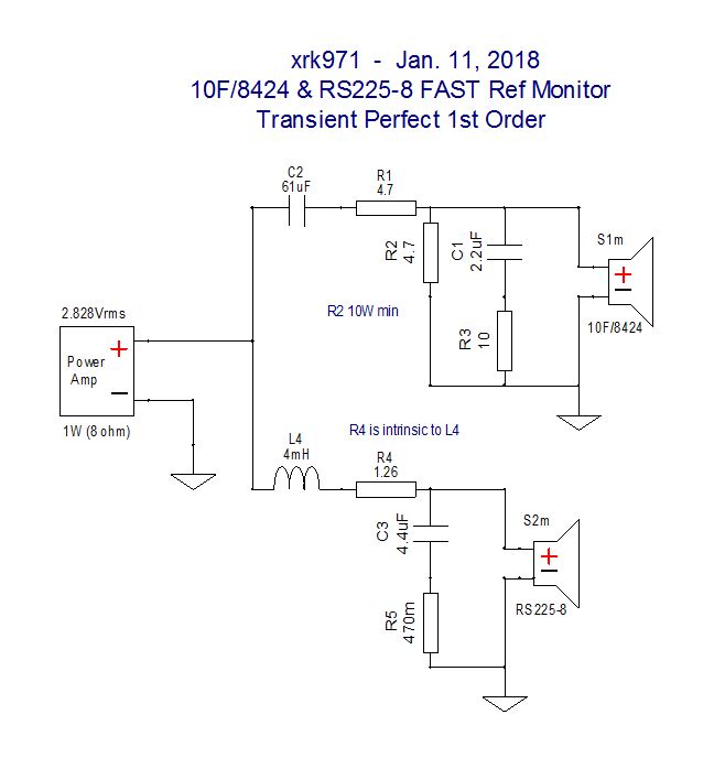

Edit Jan 5, 2018: using passive 1st order transient perfect XO for past 2 years.

Latest tweaks to the passive 1st order XO with simulation files:
10F/8424 & RS225-8 FAST Ref Monitor - Page 95 - diyAudio
656203d1515700364-10f-8424-rs225-8-fast-ref-monitor-xrk971-10f-rs225-fast-schematic-jpg

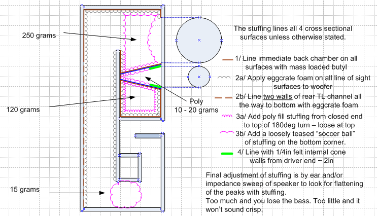

Nice stuffing/padding plan collected by GUJoe:
For the crossover for the 10f/rs225, is R5 47 ohm or 470 ohm?

I suggest building as per the schematic with your PS95s. The learning process will be invaluable and you get then tweak or swap out drivers from there once your knowledge grows.
You could add another 4.7ohm in parallel for effective 2.5ohm at R1 and about 5.5ohm overalll tweeter impedance. If you short it you will get full sensitivity. Plus apparent 3ohm impedance which isn’t the best for some amplifiers. Full sensitivity is 85dB so bass will sound about 3dB weaker than now as overall sensitivity is 82.5dB after baffle step loss on woofer. For trial and error testing I suggest keeping XO outside and use Wago connectors. Is XO a PCB or P2P?
To be clear, here is what I am suggesting:

Ok I’m sorry for so many questions. But what is meant when you say, “ if you SHORT it, you will have full sensitivity?” What would you do to short it? And if you don’t short it, you should end up attenuation of ps95 to around the same sensitivity as rs225?
