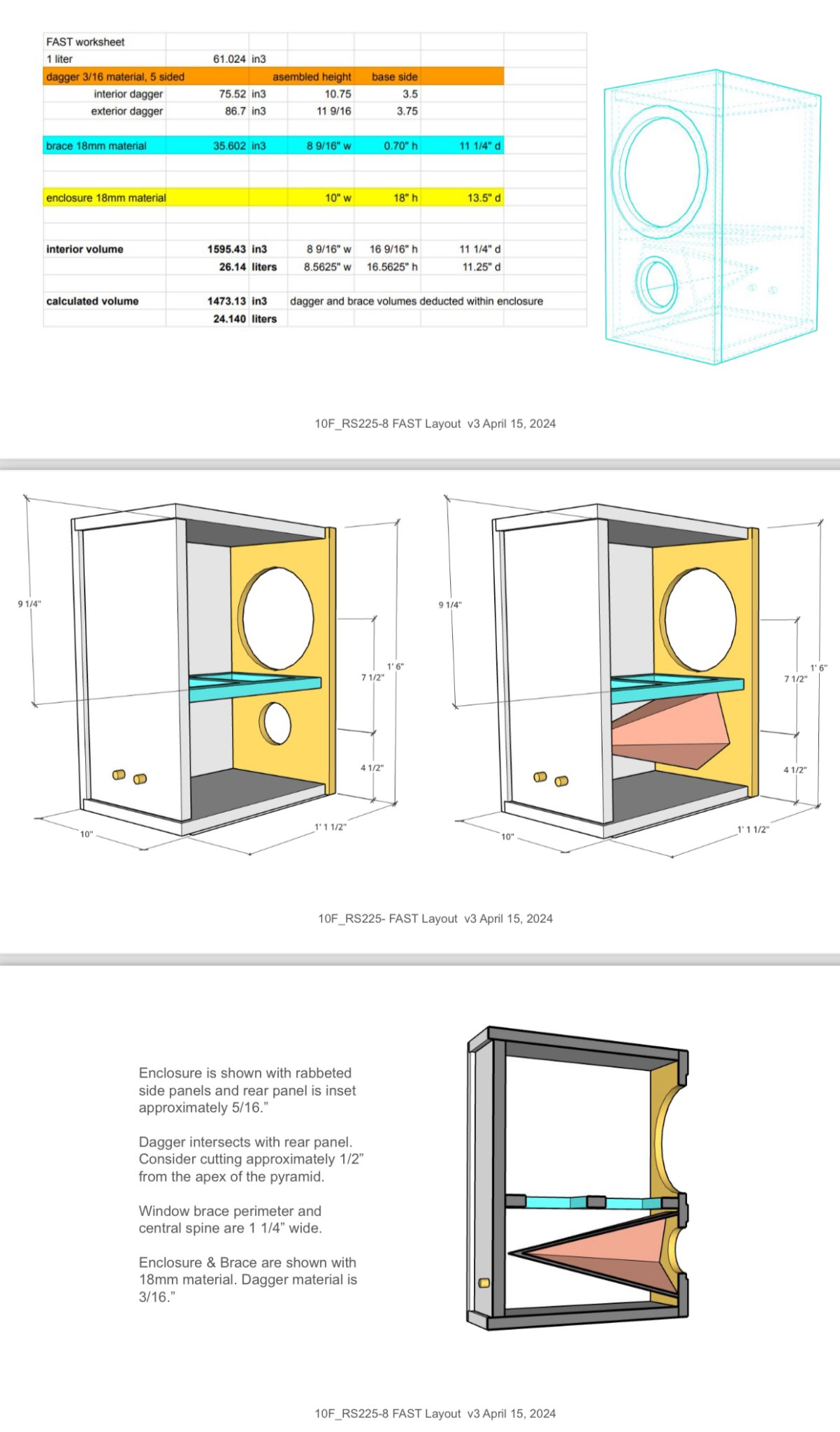

@xrk971 Hello! I am wondering, how do you decide what size dagger to use for a driver? I am curious about how you arrive at the internal volume, and then how much of that space to allocate to height vs base diameter. I'm guessing the shape of the dagger will depend on the range of the passband? As for the volume, my intuition was to just treat it like a regular sealed box..but I'm second guessing myself
I tried to find an instance of you talking about this already. Maybe I'm just not using the right keywords, but I couldn't find anything 😕
So, sorry if this is something you've already talked about!
Mostly it is based on practical considerations like fitting the driver and keeping the size compact enough. The volume as a sealed rear chamber not having to reproduce any bass makes it easy. Almost anything will do but just not too small. If on the other hand, you need the full range driver to make bass, then you need enough volume to be at least 1/2 of the Vas. In this case, it might make more sense to use the spiral Nautaloss design.

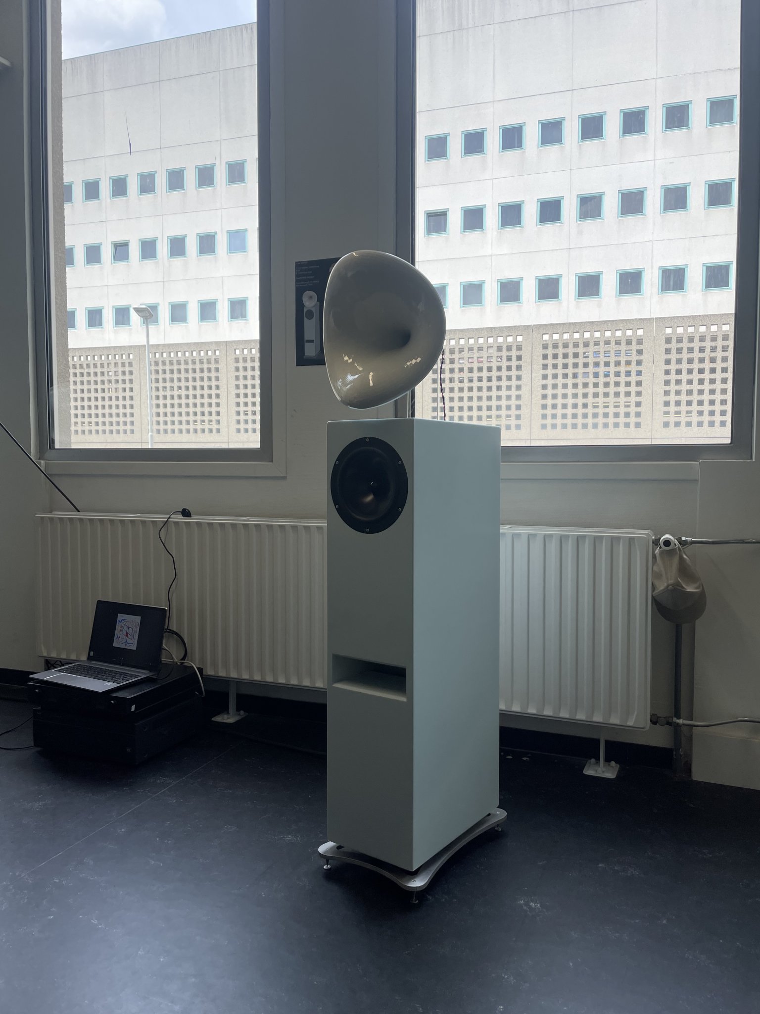

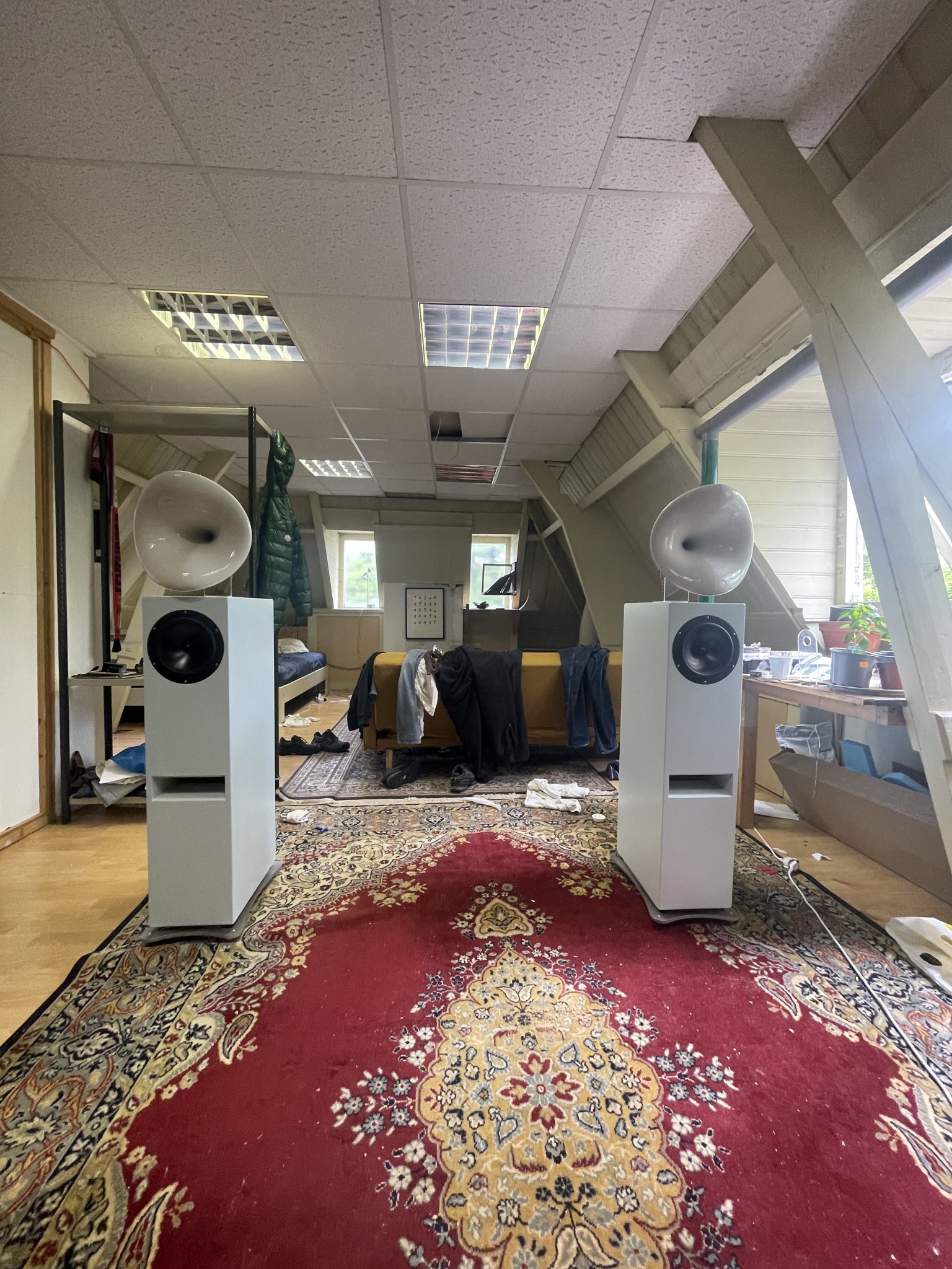

Finally finished my version of the TL’s
Absolutely Beatiful work!
I'm probably just a weirdo but my mind wandered to "Little Shop of Horrors" 😀
Compression driver with hornThat looks good! what's on the top?
Which driver? I think those horns are designed by you! phenomenal! do share some measurements, if you can!Compression driver with horn
cheers!
Yes and then paintedVery cool looking speakers. Are the horns 3D printed?
Indeed i used ath by marcel batek for the designI think those horns are designed by you!

So I have searched and searched, Why the dagger? why not just sealed off? Im actually going to re-try this build. I have TEN RS225-4 I need to use or throw away. I also have 5 RS100. But im ordering some PS95--- Got test one up now no back to it but rs100 is sealed off and seems fine.
less standing waves due to non parallel walls...................
