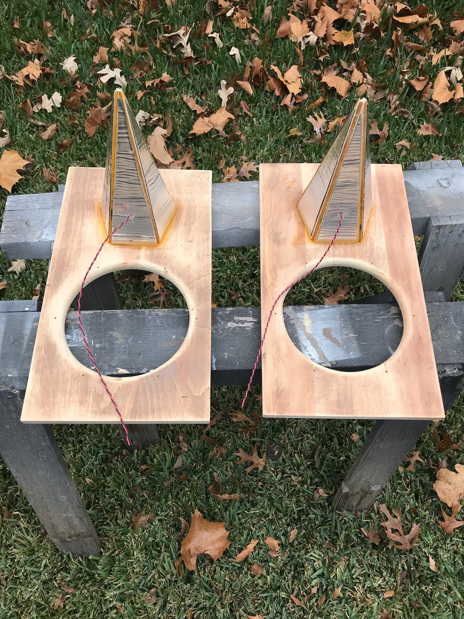

Keantoken is using the standard baffle and sealed cabinet dimensions described in post 1. 10in wide and 7in CTC spacing between the woofer and tweeter. Probably an 11in tall sports cone for the full range rear chamber?
The subchamber is pyramidal in shape constructed from flat sheets and I think it has aluminum tar sheets on the outside. I've seen the construction method somewhere in this thread. I didn't make these boxes so I don't have the construction info on hand.

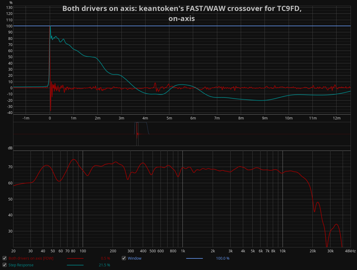

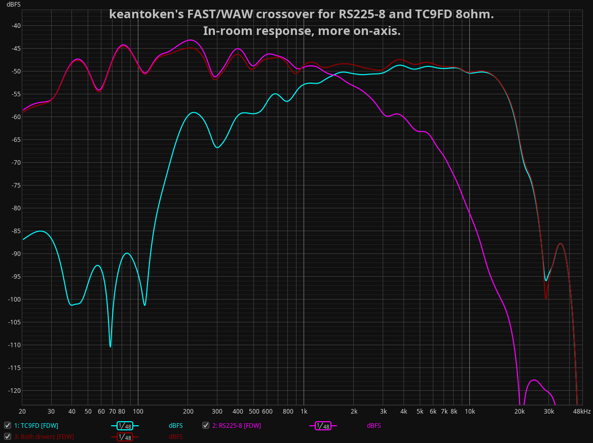

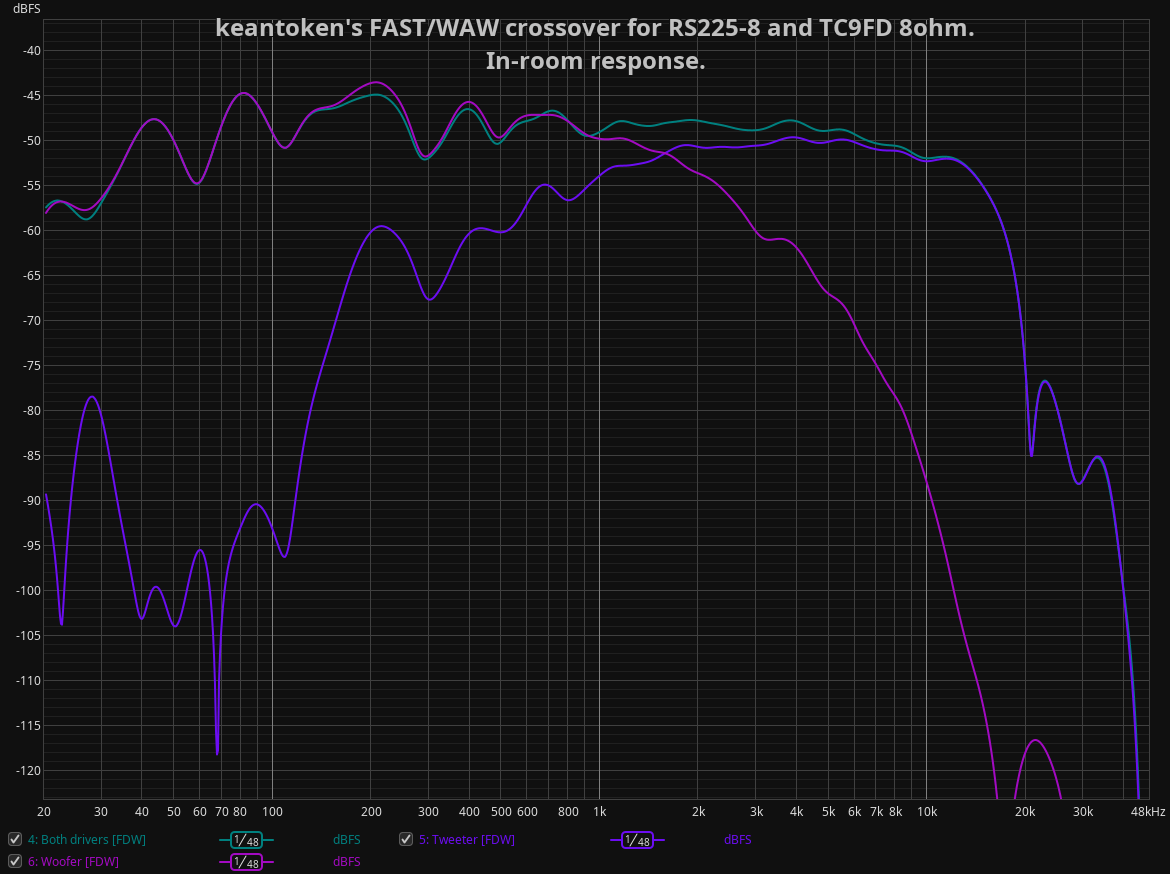

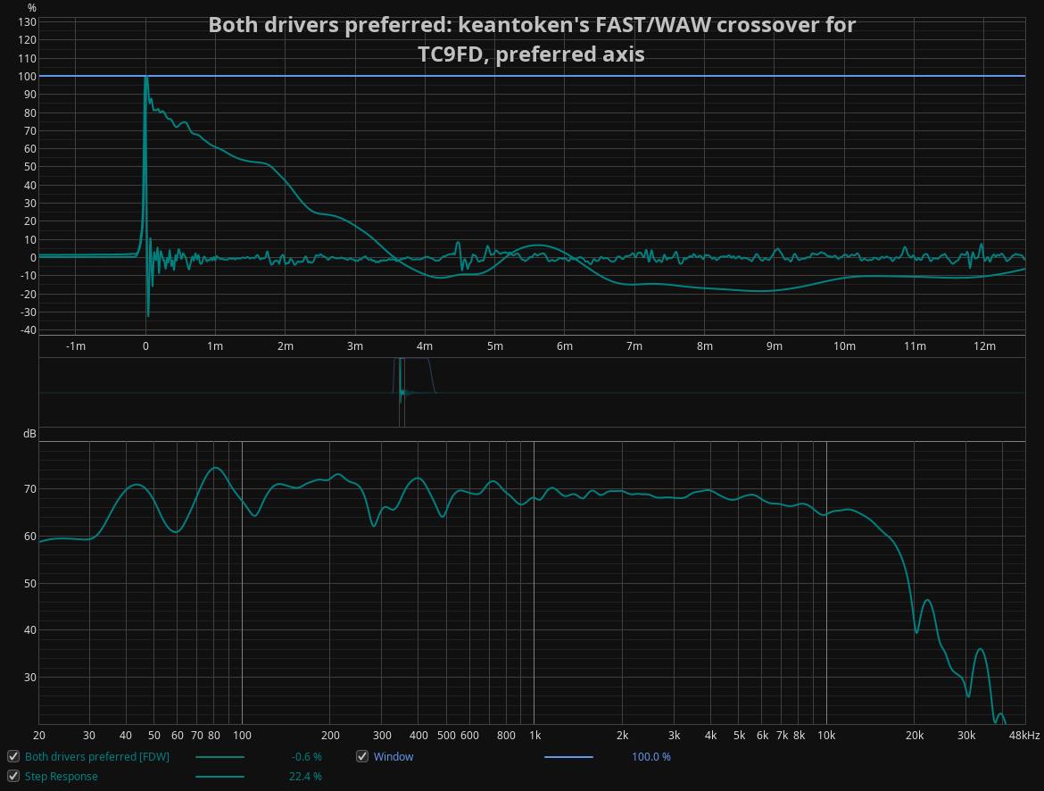

I measured the crossover response.
Above is the preferred listening position (from listening) because the baffle diffraction and tweeter ringing is concentrated on-axis. This is what it looks like more on-axis.
Looking at the impulse responses again, it looks like the problem is coming from diffraction, not ringing since the roughness does not gradually decay like ringing would.

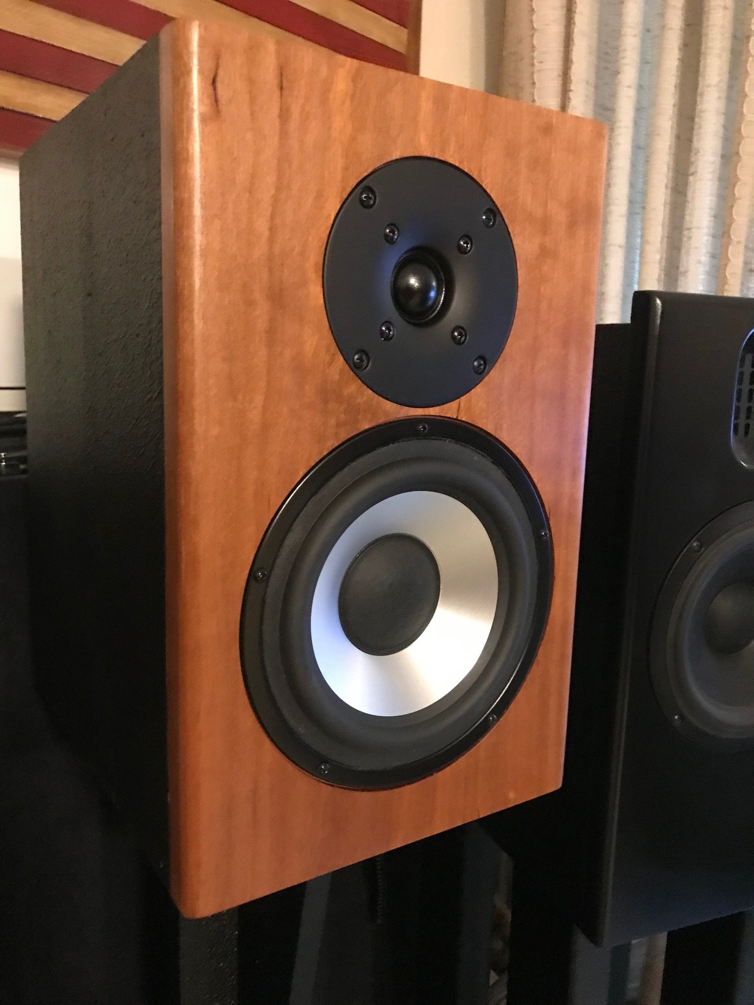

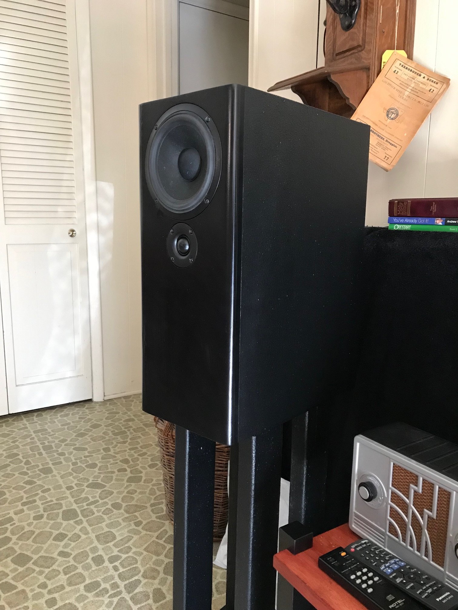

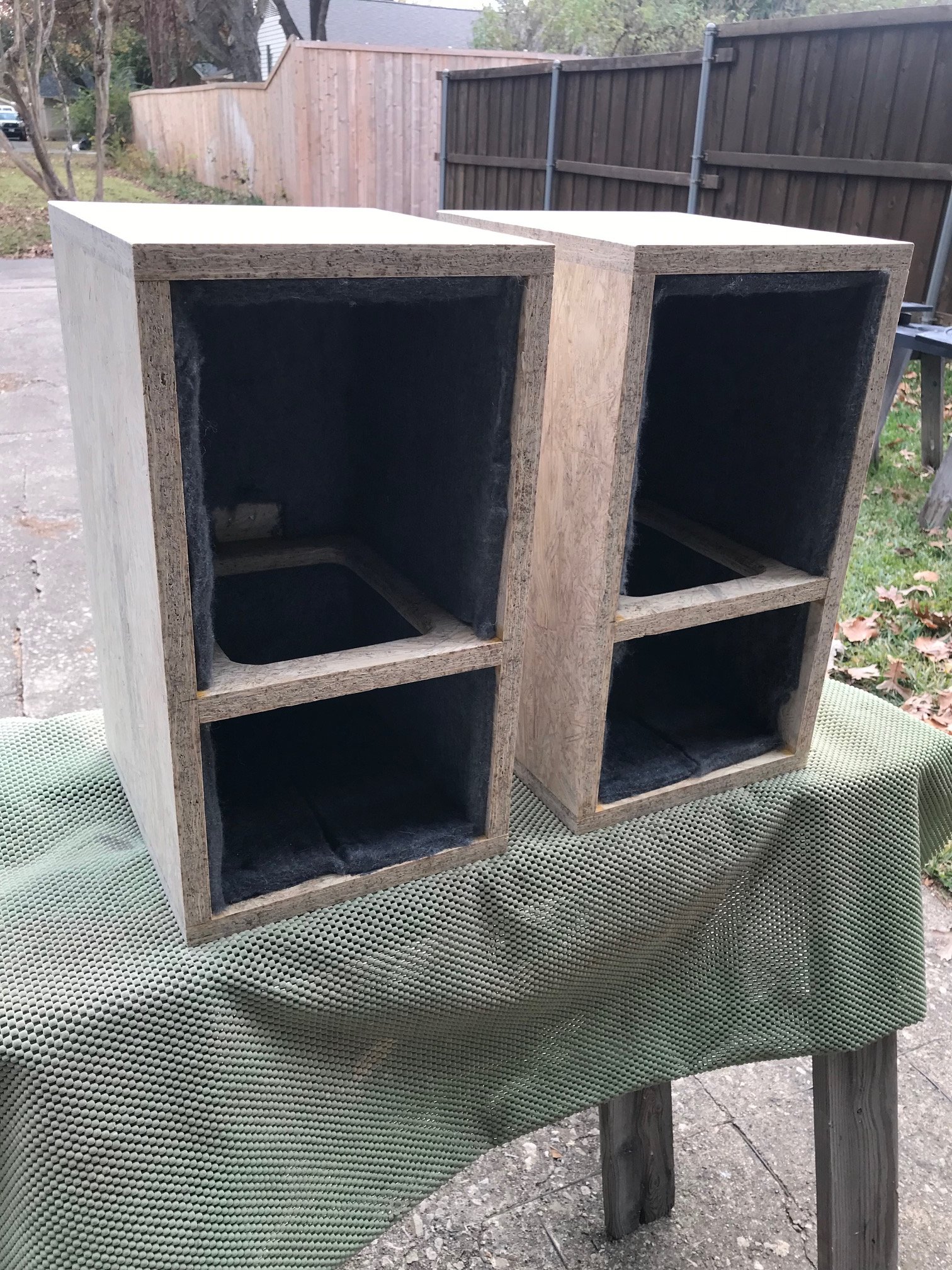

Looks pretty good to me. I hope they are working out for you. Attached are pics of them under construction. I'm currently using Neil Blanchard's transmission line speakers that work out well with my tube amp. 5 sided HF enclosures deadened with a Dynamat substitute. No idea as to internal volume. Have fun!
They are the best speakers I own right now. Clarity does not fall apart on loud passages. With the new crossover the life-like clarity means music is enjoyable without any lack of detail. The detail comes out naturally, so you can just casually hear acoustic details of the recording and space while enjoying the music. Without good tonal balance, recording quirks like proximity effect are indistinguishable from the tone of the instruments and voices, making them artificial and unreal. But with everything in balance and clear, you can hear the voice and you can also hear the microphone or the recording environment. But these things don't monopolize your attention, so you hear what you place your attention on, which is what you enjoy. You can hear as much detail as you want just by placing your attention on it. Just as in real life, we don't notice everything we hear unless we pay attention to it.
Glad to hear it. Wish I had the technical prowess to measure/simulate/design but, oh well. I admire your ability. Built many other published designs since then. My favorites have been Michael Chua's Dove and Neil Blanchard's MLTL. Both sound great using economical drivers.
