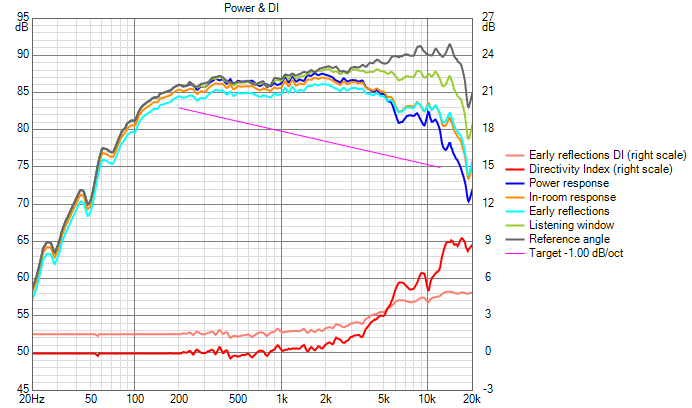

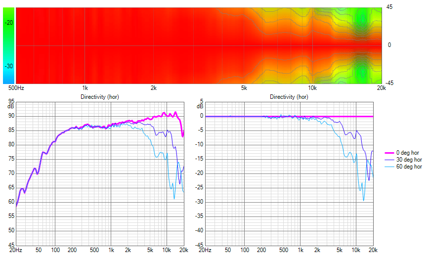

You might look at the post by Byrtt back here where he did a pretty careful study of the 10F driver using Vituix CAD.
https://www.diyaudio.com/community/threads/10f-8424-rs225-8-fast-waw-ref-monitor.273524/post-6075827
Spinorama’s:
As the XO point for the 10F is 900Hz, all the directivity info above is good.

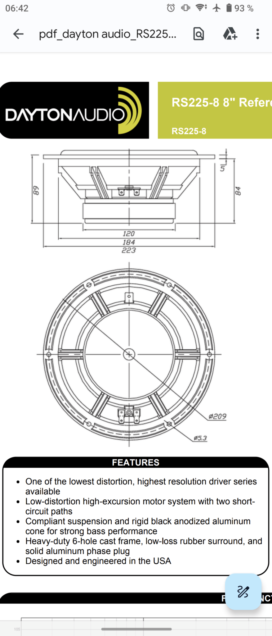

What's your experience with RS225-8 when sealed? Since there is no dust cap and the driver isn't hermetic around the phase plug don't you have any artificial whistling and chuffing? My experience with sealed enclosures is that it should be sealed for good, otherwise even a leaky screw thread will provide you with chuffing/whistling.
I'd really like to go a sealed route with RS225, but this thing bugs me.

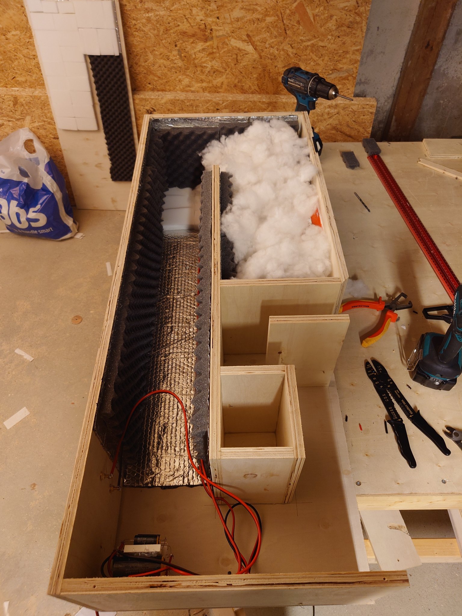

Starting to finish up my build. Made a few mistakes, but it's my first speaker-build so I feel I'm allowed to
The biggest one being that its in 15mm and not 18mm ply. They will be rebuilt at some point in 18mm MDF when I have the time. For now it has been a very good learning experience.
I have a few questions though.
Nr 1: For me it feels like the stuffing is going to collapse and fall down the rear chamber if i stuff more than just the front chamber. Do I need to add some sort of support for it to keep in place?
Nr 2: I dont have access to a DATS to measure when I have "enough" stuffing. Do other people here have any good tips on how to know? I have UMIK and REW to measure with. I have measured in-room, 1m on-axis and the response okay.
Nr 3: What about the last few bends in the TL, have people been covering this with foam/bitumen or is it only the front chamber and the rear part that is important?
Nr 4: My tops starts to taper off around 12k Hz. Is this to be expected?
Lastly, thanks to all that have helped/contributed to the design of the speaker. I have had it playing about 10-15 hours now and they sound quite good so far. Last bit of fine tuning needed and I think they are mint.
The side panel that is exposed to the bitumen has been covered with foam after the picture was taken.
You don’t need stuffing past the first 180deg turn. Maybe add some eggcrate foam on the bottom floor panel of the TL.
What do you mean your tops only go to 12kHz? If using 10F, should go to 16kHz or so.
You only need the bitumen/Noico butyl sheets in the front chamber. You can add it to the back panel if you like but probably not needed.
Good luck!
Good luck!
