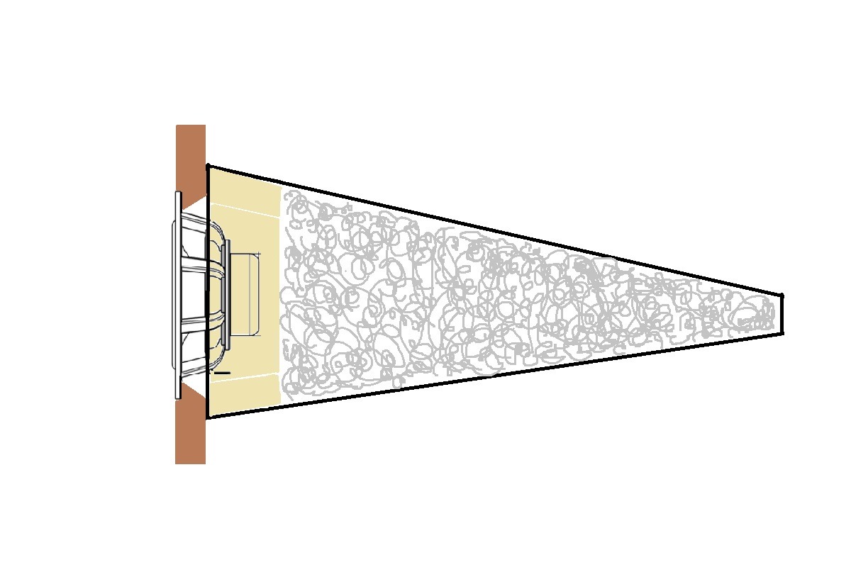

There might be a photo in this thread somewhere. But basic idea is that you want to line any hard surface adjacent to the back of the cone with felt or foam to prevent a reflection. Further into the cone you can use stuffing without the lining because the angle of the cone is steep.
Pictures would be helpful
Does this illustration help?
The poly-fill stops a little behind the driver, so that the cone has a little breathing space, and the poly-fill doesn't get into the driver basket assembly. The felt lining material is fixed to the insides of the walls of the cone (or similar structure).
Yes, the light brown area is where the felt is placed. Thickness would be around 10mm - 12mm (roughly 1/2 inch), and a single layer stuck to the walls of the cone shaped cabinet. If the felt is thinner like 6mm (1/4"), then 2 layers.

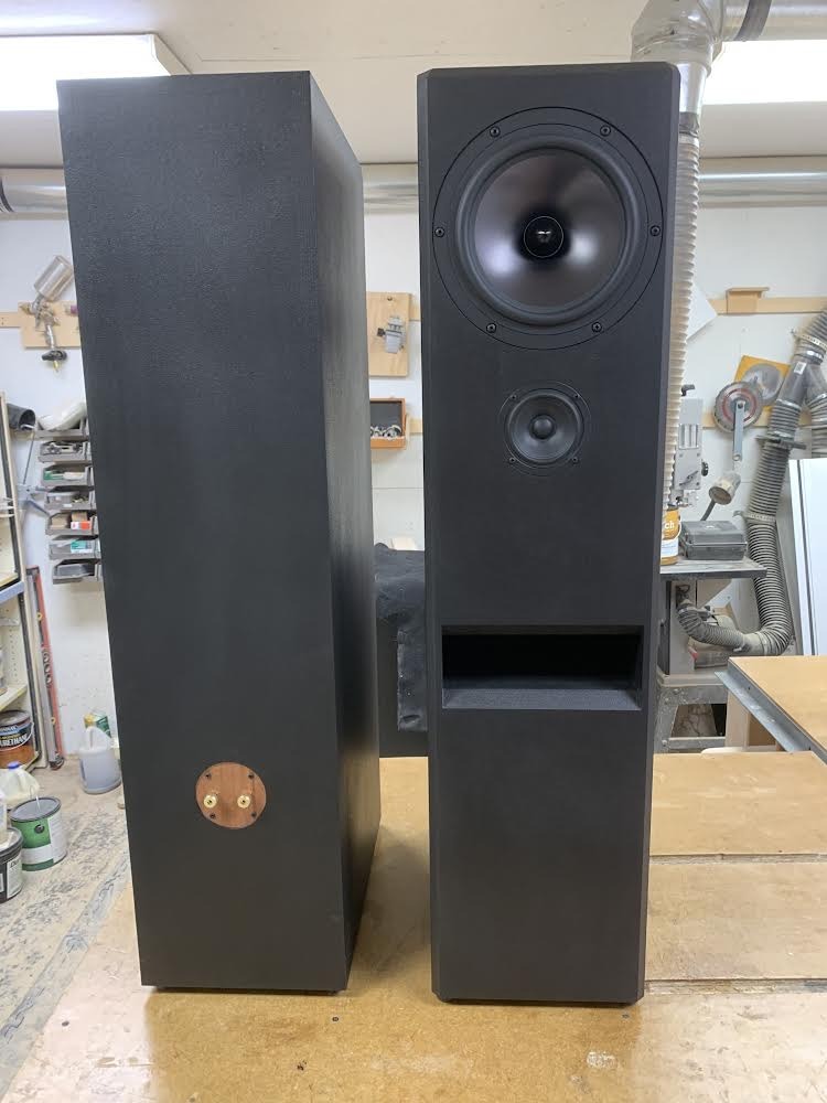

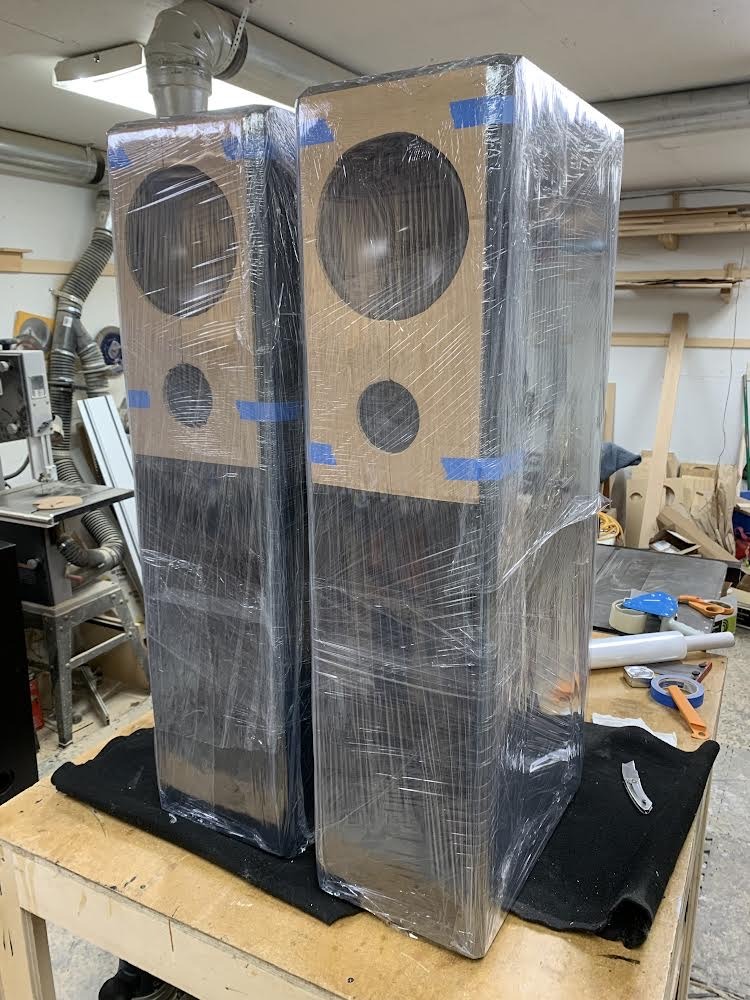

Good luck! Any more pictures or description of the packaging? The boxing up must be crazy…

They get packed with EPS foam panels and hard cardboard reinforced corners. Then wrapped in corrugated cardboard box. I’ll see if we can get more photos of how they are packed. I know it takes about 30min to unpack them. FedEx freight is usually how they travel.
