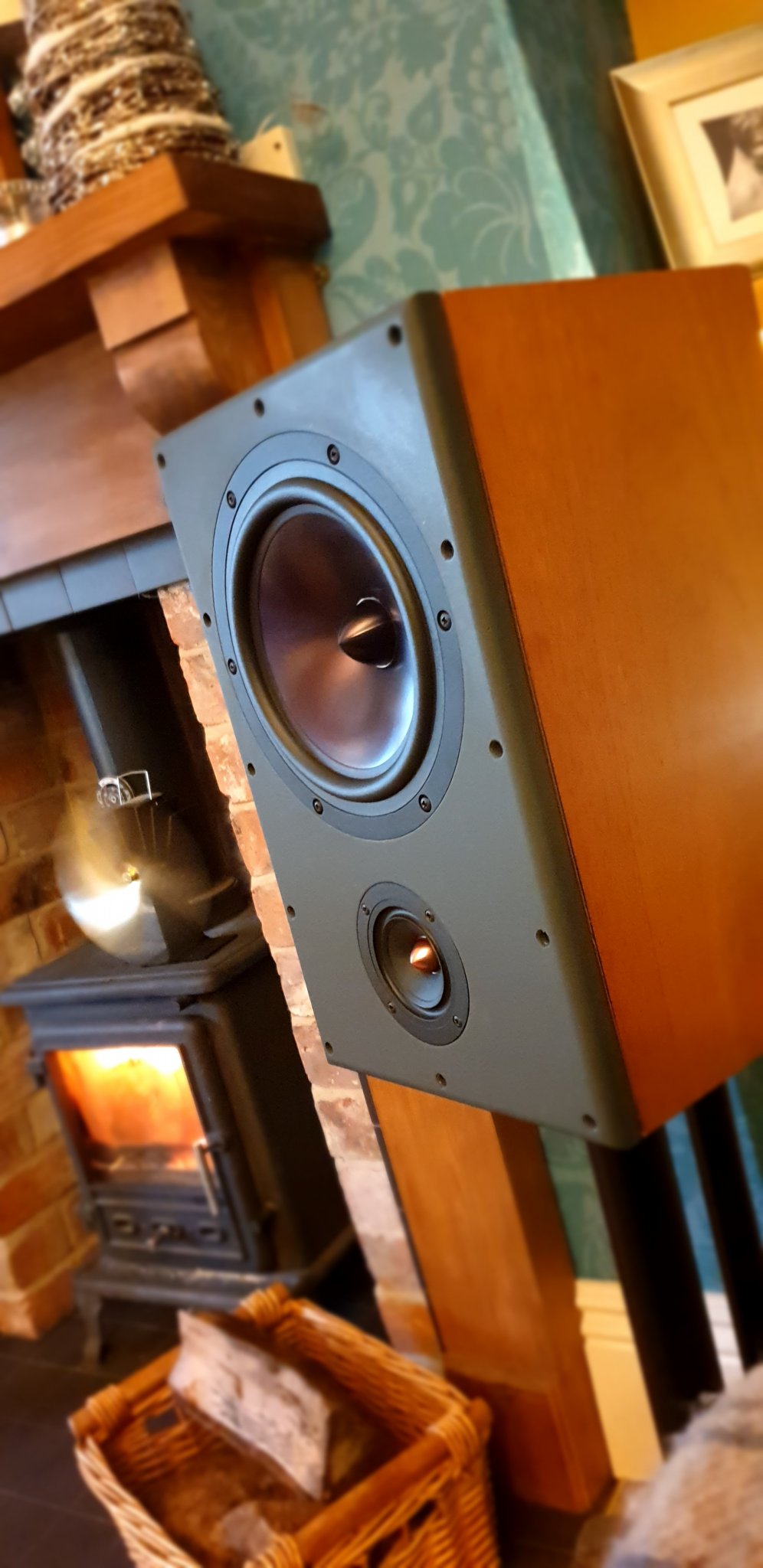

My present build for reference!
Reactions: schultzsch
Beautiful work, Yep! Congrats on your new speakers. I love the floor mounted angled up look with feet! Zebra wood is very cool too. I am glad the vented alignment worked out. We will keep your dimensions in mind for anyone else wishing to make a more compact box with deeper bass.
Jimk04, yours are sensational as well. A more conservative studio monitor look.
It’s nice to see all the creative angles people are coming up with for this speaker.

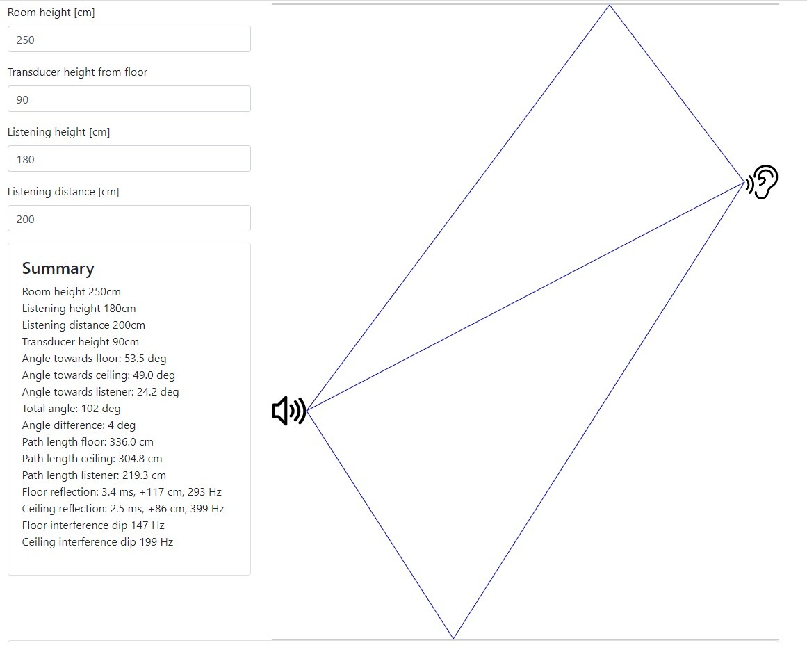

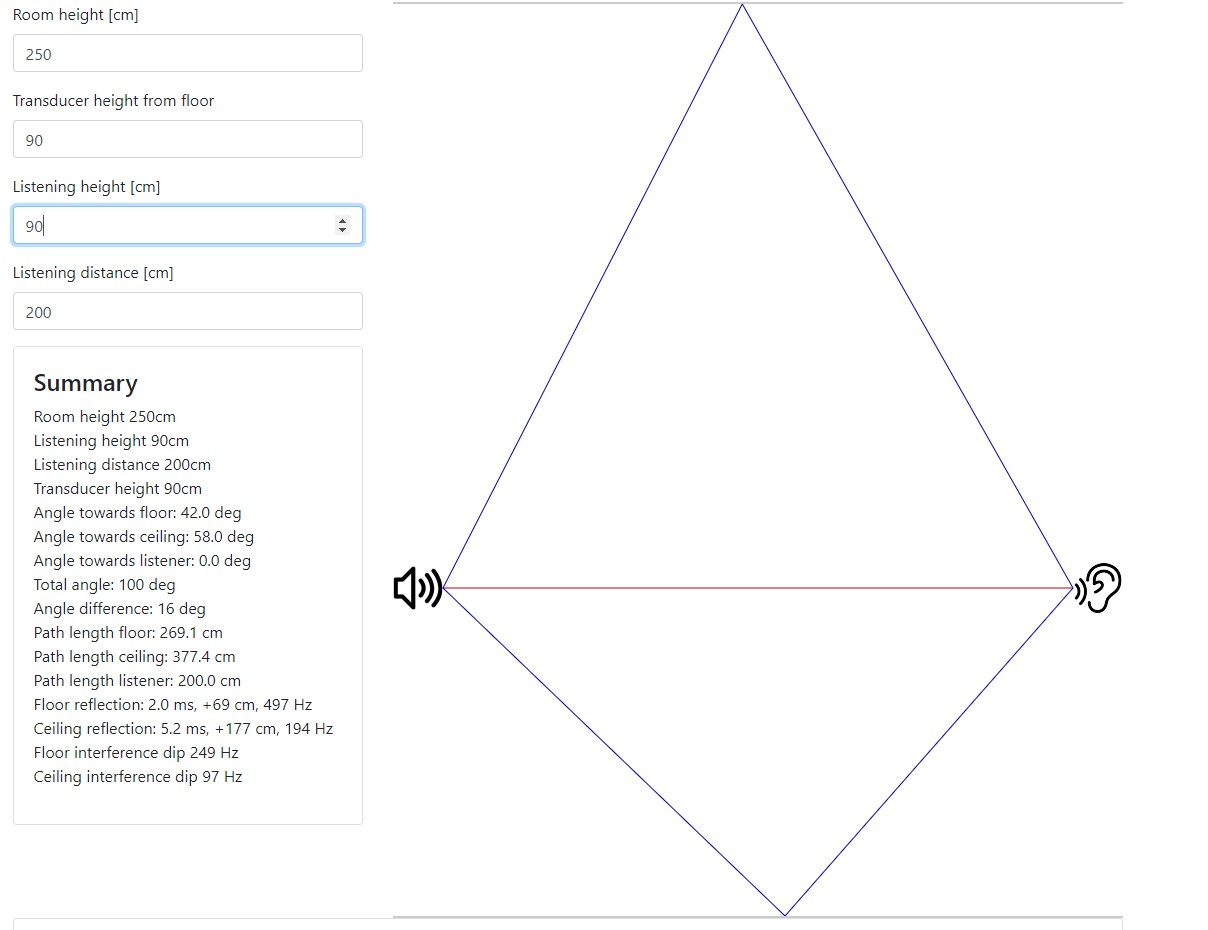

Note that there might be a floorbounce dip around 150Hz or so that would not be there as much with a higher stand-mounted speaker.
I forgot that you also have yours sitting on the floor, and even tilted up, the sound is probably 30 deg off axis so you will need the extra treble. It makes sense and so go straight through then. If you had them up on a stand with the woofer at ear level, you may need to go with some attenuation. And sitting on the floor with rear wall reinforcement, you probably have enhanced bass by 6dB and it may even make sense to use something like a Faital Pro 3FE22-8 (91dB) here with some attenuation for higher sensitivity to give you the treble balance you need.
Understood, this make sense (of course 🙂). As a matter of fact, in my xsim simulation I used the 15° and 30° response for the RS100, and this led me to remove the l-pad. I will give a try to the 3FE22 in the next weeks. Thank you again for all the precious comments/suggestions
This low dip requires rather long path length difference and are typically from ceiling if both speaker and listener is closer to floor (than ceiling). It is possible to get a dip this low from floor, if path length difference between floor bounce and direct sound is roughly 110cm, or almost 4 feet, 1/2wl at 150Hz. If listening distance is 2 meters, speaker is ~90cm from floor and listener stands up, head closer to ceiling than floor, then it would be floor bounce 😉 If listening distance is more than 2m, or ceiling lower than 2.5m the dips move up in frequency. More importantly, the high bass and low mids are full of these dips from various boundaries in the room, and the dips move quite a lot with the listener.
See attachments, made handy dandy calculator to inspect and illustrate stuff like this! 😀
