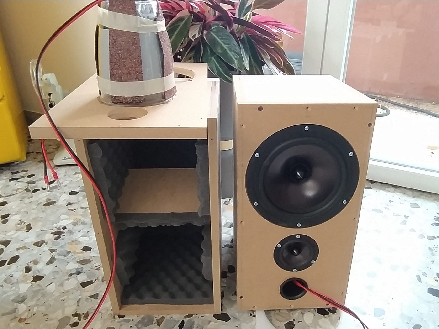

I'm planning to build the monitors with the B80s in a 24lt box (10" baffle) using the specific XO by xrk971, but I would like to get some more bass extension without the Linkwitz transform.
What do you think of a vented design just adding a ~30 Hz tuned port (5x25 cm)? The group delay, also reported at the very beginning of this thread, looks "fairly" ok to me as well as the overall frequency response.
Has anyone tried the vented option? Any suggested substantial changes at the design that should be made/simulated/tested?
Thanks!
Aatto made a bass reflex version - I think he used SB29 woofer and DSP so design was totally different. But you can make it a bass reflex vented port for more bass extension. The group delay won’t be as tight and you can already put a plug in the port to experiment with it on/off. I don’t see any harm in doing so. Just keep the 10in baffle width and driver CTC spacing the same. Make the volume whatever you need to optimize the tuning.
just want to share my progress on the ported design with RS225-8 + RS100-8. The net volume is about 27lt, with ports tuned to ~30Hz. Now I must wait for the last XO parts (the coils) that hopefully will come on Monday. I cannot wait to try them... Happy Xmas!

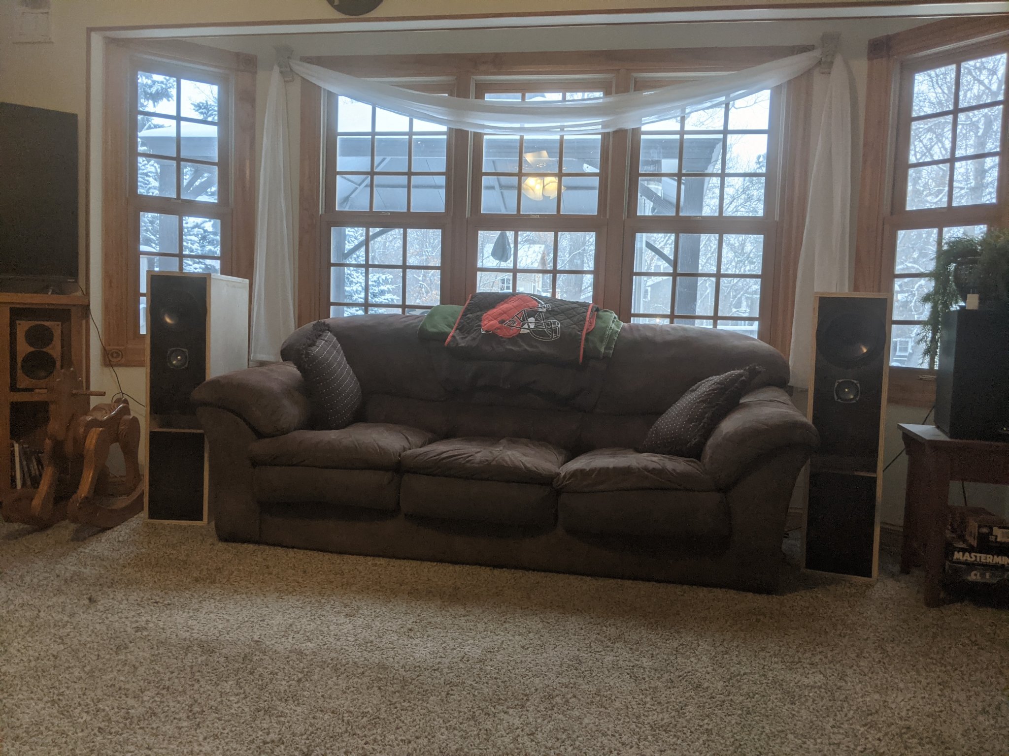

I finished the floor standers and am listening to them now. Trans Siberian Orchestra playing Christmas music. They really do sound great. The RS 225s are still fairly new, only a couple of hours on them, so I'm looking forward to them as the break-in a bit more. I'm running a Fostex FE85. I think I'll eventually go with the 10f/8424, but they sure sound good as is.

Nice work! Looks neat with a port beneath the RS100. What are you using for the rear chamber, a quart plastic soup container? You should cover it with sticky butyl auto sound dampening sheets. Noico etc.
Happy Xmas everyone !
Hi, the rear chamber is a 1.5lt plastic flower vase, with closed cell foam stuffing inside and 4 stripes of adhesive tar sheet outside. I've already used it for dampening purposes with good results, but I'm going to check its effectivness soon (I'm going to procure some Noico anyway).

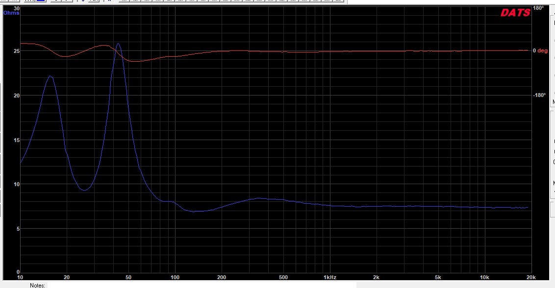

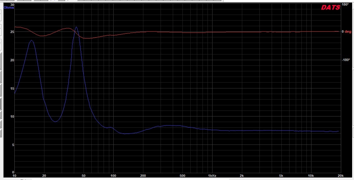

The speakers bound for Hawaii have been playing 24/7 for a week now. First measurement of impedance sweep shows everything is working well and probably needs a tad bit more damping fill to bring the peaks below 20ohms for tighter bass. Tuning appears to be about 26Hz, which is correct and shows that there are no air leaks.

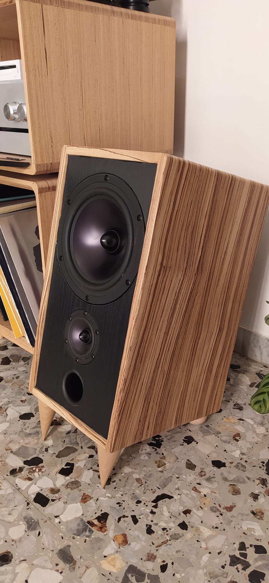

Hi X, just finished my couple of vented, they sound great!
I've slightly reduced the FR attenuation to ~4.5 dB (R1, R2 = 3.3 Ohm, 12 Ohm) cause I like a little bit more prominent highs.
Finish also came quite good, thank you for this wonderful project!

I like the extra bass extension a lot, but I had to carefully find the right amount of stuffing. With about 200 gr of polyester pe rspeaker they are now perfect for my room
