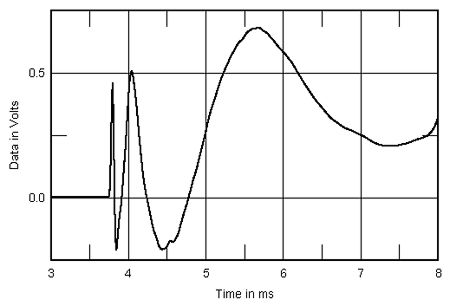

Carmody and Bagby are master designers and you can’t go wrong with their stuff. However, their designs rely on conventional dome tweeter and midwoofer type alignments. Typically with a crossover above 2kHz - so not a FAST. If you want a full range driver FAST approach then this speaker design is the way to go. It has a 1st order crossover which means the signal in and signal out have a flat phase relationship. This is great for enhanced imaging and sound stage. The transient perfect refers to its ability to reproduce percussive sounds accurately. Most multiway speakers do not use 1st order crossovers because it requires a driver with very flat wide bandwidth and no anomalous peaks. So people use higher order crossovers to avoid the need for wide bandwidth. This causes phase distortions and may result in the tweeter and woofer being of opposite polarity in order to prevent a cancellation dip at the crossover frequency.
Non transient perfect speakers will reproduce a sharp percussive sound such as a rim shot or guitar pluck as multiple smaller peaks spread out in time over milliseconds. This slight spread in time makes the sound less sharp and less distinct. Whereas in a transient perfect speaker they sound is crisp and clear and natural. Very much the domain of a full range driver.
One way to tell if a speaker is transient perfect is to look at the measured step response. It should look like a right triangle with a sharply rising edge and a slower linear decay.
Do a search for measurements of high end speakers by John Atkinson of Stereophile. He has said that of the thousands of speakers he has tested, he can count on one hand, how many were transient perfect and produced a right triangle step response.

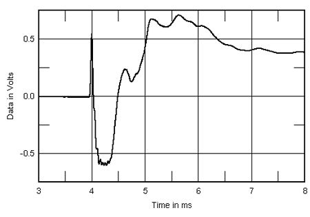

Let’s compare that to something also big and expensive like a Wilson Audio MAXX2 (or most any other high end multi-way speaker):
Full test here:
Wilson Audio Specialties MAXX2 loudspeaker Measurements | Stereophile.com
I am not picking on WA, because if you look at another highly regarded speaker, the B&W 802D, we get this for the step response:
So how to read these plots? A single hard percussive strike - should be a step function with a decay. For the 802D, these hard edges are spaced in time several milliseconds apart depending on whether the tweeter is making the sound, the mid woofer is making the sound, or the bass woofer is making the sound. And some of it is a rarefaction versus a compression of the air sound waves. What this does is make the percussion less distinct and less realistic.

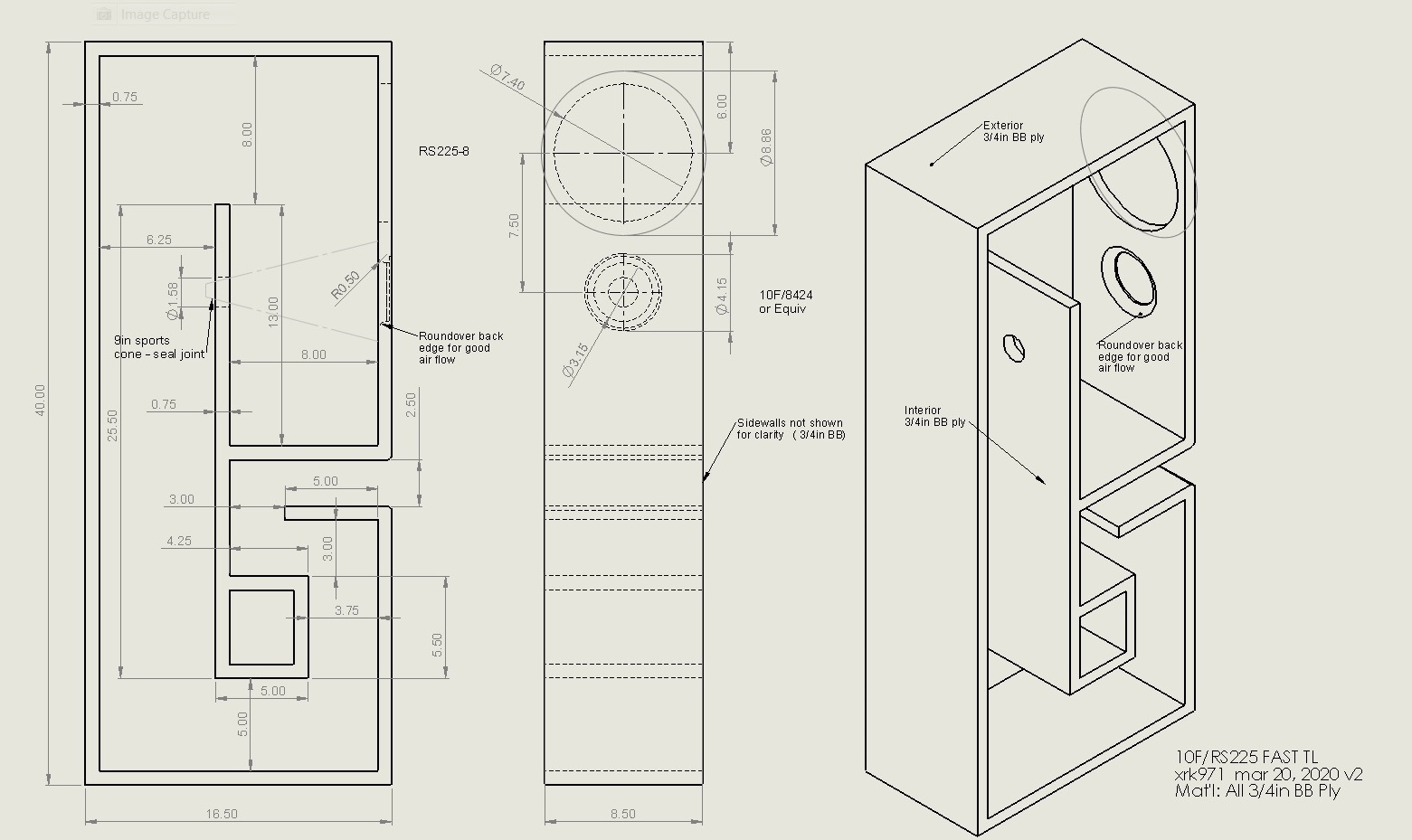

Yes, but will require careful measurements of the new driver mounted on the cabinet to get an FRD file. Then measure an impedance sweep for a ZMA file. Then load these files into Xsim or PCD and re-simuluate a new XO. Build a prototype XO. Measure and listen and adjust as needed. Honestly, it's a lot of work and I am not sure worth switching to the Esoteric line of drivers. If you are versed in XO design and want a project to keep you busy - this could be it. But it is almost a different speaker. The RS225-8 is the key driver for this speaker. Youc can use almost any 2.5in to 4in 8ohm full range driver and it can be made to work with simple resistor adjustment.
Ahhh, okay. I saw that you had tossed out a few variants over the years and didn't realize that it was the full range that was easy to swap, and the RS225 was a lot more work. Thanks for explaining that - and sorry if I unwittingly made an unreasonable request.😱
Just wanted to share an exciting development: a couple of guys local to my area are going to build some 3/4in BB ply 10F/RS225 FAST TL's and offered to make me a set if I share the cost of the materials with them - and help them with design questions and assembly. One of them is an expert cabinet maker, so I think this is going to work out really well. I am not sure if they are members on DIYA (yet) as I met them through a sale of one of my TPA3255 amps on my shop. But I sent them the plans and they are buying 6 sheets of 3/4in BB ply tomorrow. This is going to be fun. 🙂
We will document the build as it goes along here of course.
