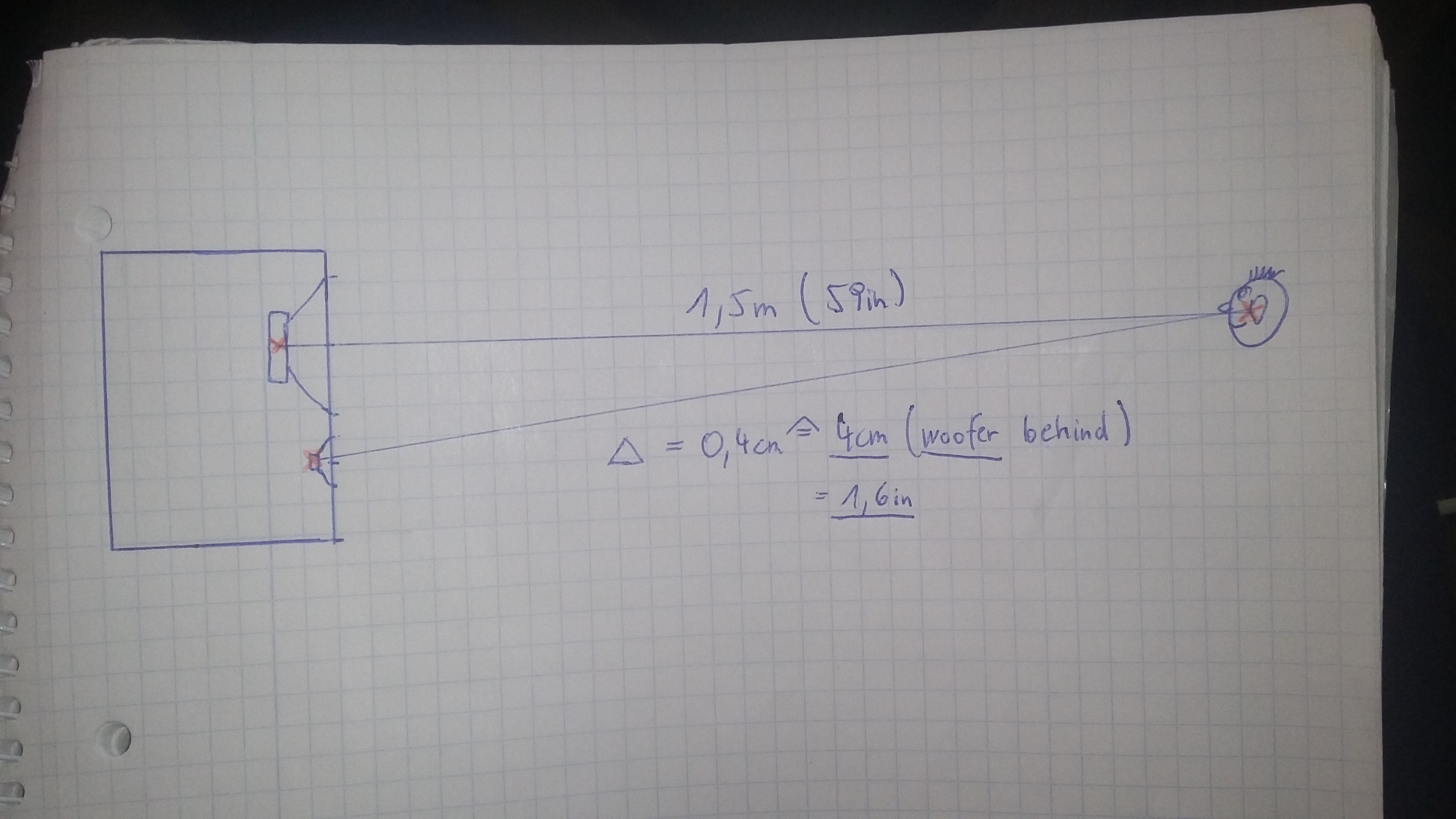

Florian,
You are correct that the tweeter needs to be set behind the woofer so that their voice coils are located at approximately the same location. The two need to start rising at about the same time. It’s just that the woofer moves slower. So my solution was to put the tweeter on the bottom, assuming the ear is at the woofer axis. This introduces just enough offset similar to a stepped baffle.
Hi xrk,
I do not agree with you. According to my post #2025 (see attached again), assuming that you listen at a distance of 1,5m = 5ft, the voice coils are not together when you listen on woofer axis. The woofers voice coils is 1,6in behind. So you are not listening with same distance for the two voice coils. Your solution is not enough offset, if you want both voice coils at the same distance. - But, that is actually not the point, I disagree with you, that the voice coils need to be at the same distance. In your case, your measurement or simulation, they DO start at the same time, but that means, that the top points of the step response are not together, as the woofer is slower, as you said. The point is, that the highest points of the slopes need to be together, and this means, that the woofer needs to start earlier! Then the measurement looks like my measurements what I did, with that bend in the rising slope. And then it sounds on the spot.

XRK:
With that I disagree, as I have explained afterwards.You are correct that the tweeter needs to be set behind the woofer so that their voice coils are located at approximately the same location. The two need to start rising at about the same time.
With this I also disagree. The offset XRK meant is too little for being the same distance for woofer and tweeter, and by far it is different than my stepped baffle with 6,1cm = 2,4 in offset.This introduces just enough offset similar to a stepped baffle
If you want to align the woofer and tweeter, they should play the same frequency. You can't compare a woofer (with crossover) IR to a driver that plays up higher. Make them play the same range and compare the timing of the peaks there.
Easy to do with some digital help. Just delay one of the drivers, make them play simultaneously and use a sweep in a range they can both play comfortably. Look at the distance between both peaks. Determining acoustic centers is best done acoustically. Not guessing based on voice coil positions.

Florian,
I think what you have discovered is that a 0.5ms delay between left and right can make the image sound “wider and more open”. This is a well known trick with headphone EQ to remove the “singer in between your ears” sensation and bring them outside your head. Try that sometime with headphones and a DSP delay using Audacity or jRiver.
A perfect right triangle SR may not give the best ethereal soundstage image, but it’s not adding something that probably wasn’t there in the original recording.
I am glad you found an alignment that sounds good to you. Note that with a Harsch XO - the delay is much greater. Yet it still provides the impression of a transient perfect pulse.
