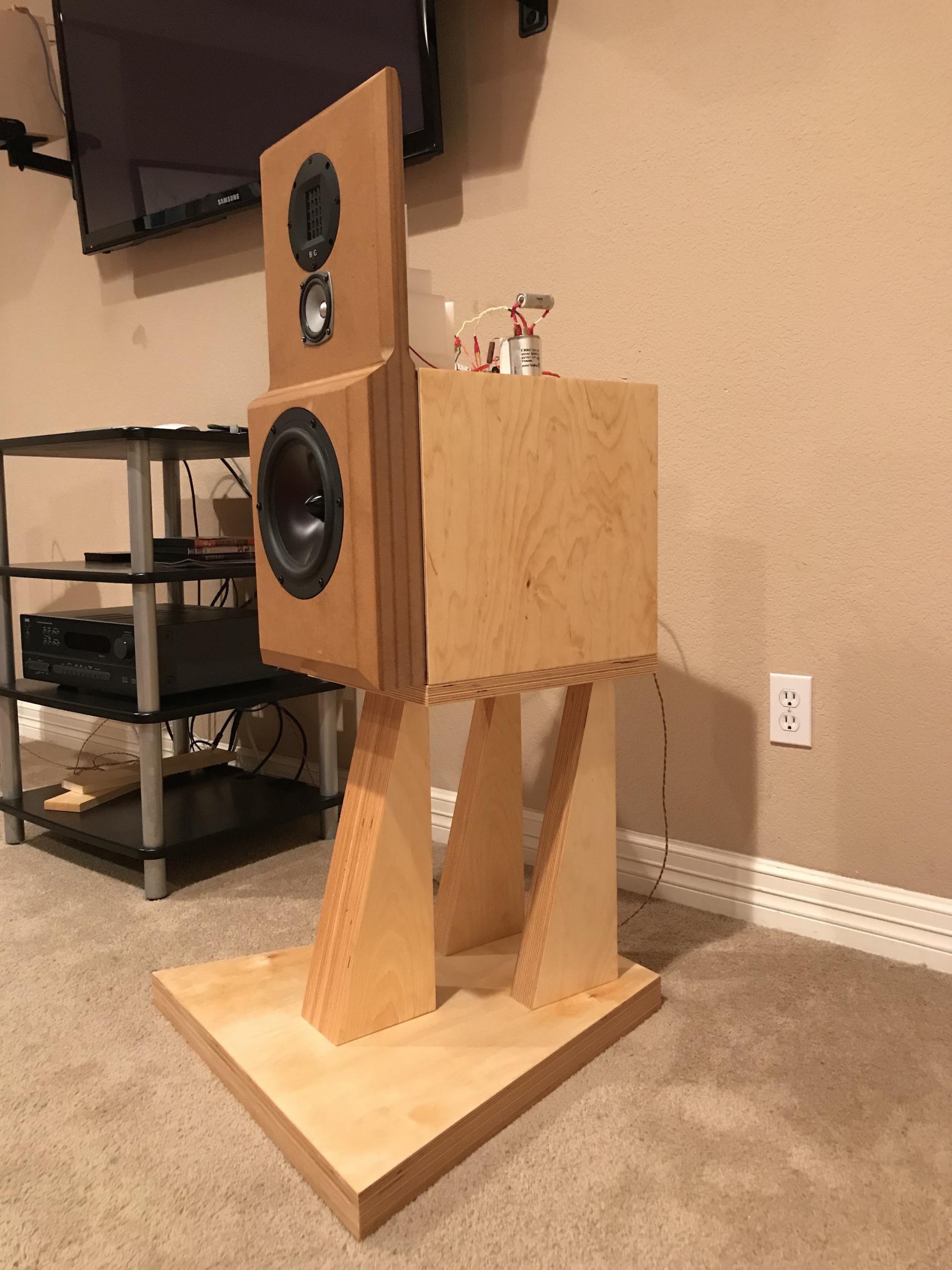

What do you think of building a ported cab for 225-4 and having rear and front longer as "legs" and mounting the PS95 mounted under as half a open baffle? so no sides or bottom to that section just front and back
Should work well - bass reflex will not be as accurate time as group delay is greater. But should be fine. Make sure you use crossover for 4ohm woofer.
I'll using your provided crossover for the Rs225-4 &ps95 linked in the first post. That's correct?
Yes, it was for RS225-4 and RS100-8, but the PS95-8 can be substituted just adjust the attenuation resistor to taste.
Sounds good. I wanted to use the rs100 but wife likes look of ps95 lol. Looking forward to this build- I'll get to purchase enough for 7 speakers in two weeks. These will be my new "floor" channels in our 7.4.4 theater
Build one first and see if the sound is good. I have not tested this crossover and the drivers myself so cannot guarantee it will sound like the RS225-8. Why don’t you get the RS225-8 and the PS95-8? I can stand behind how that will sound. Is there a need for 4ohm woofers?

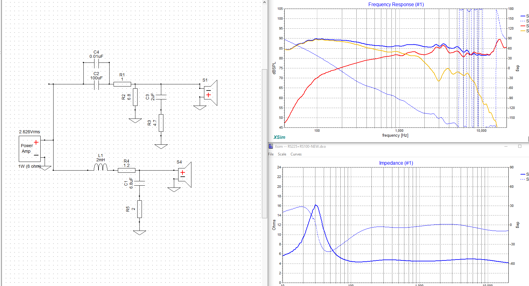

I have 10 RS225-4 already sitting around collecting dust. I used factory FRD for both in Xsim and applied your crossover design and it looked similar. Wasn't sure what to do with them until I seen this thread lol
Ah, yeah I don't have the PS95 yet. RS225-4 leftover from failed build lol I've been failing a lot. Also 5 6" SDS Peerless woofers 5 Dayton RST28F ��*♂️ chasing a sound.
Ok, if you have them already. It’s just you said you were going to get 7.
Heres what it simulates as in Xsim- I had to reverse polarity on PS95- doing so on RS225-4 is different phase.
Let me know what you think- Not sure what else to do with these 10-RS225-4 i have sitting around collecting dust.
There is a time delay if the woofer is on top and same as ear level. The delay will fix the phase flip that you had to add. It shouldn’t be reversed as that would not be a transient perfect speaker anymore. There is no reason that the PS95 would need to be reversed. Try adding equivalent of about 2.5in of time of flight delay to the PS95. Then try the XO tweaks.

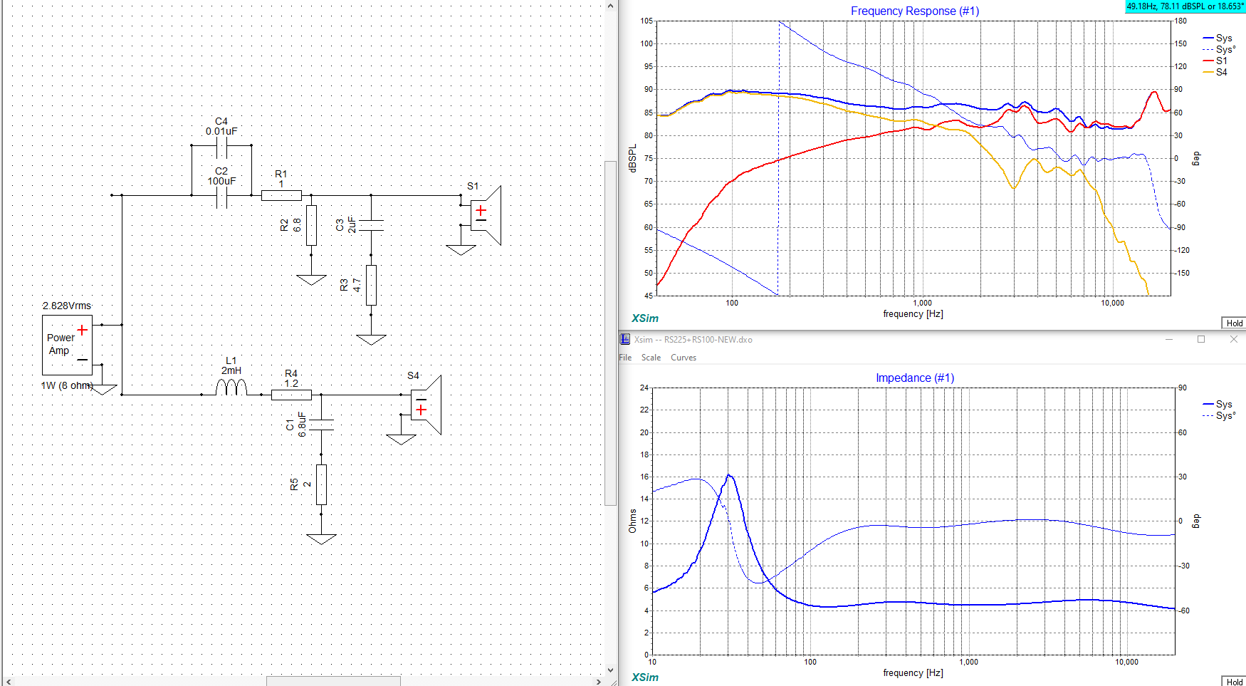

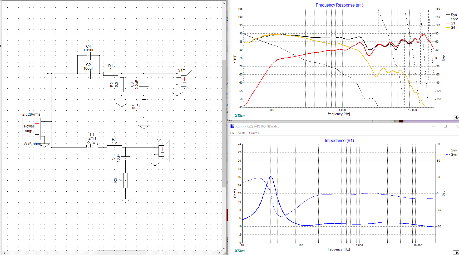

I added it- hows this?
That looks better (both drivers positive phase) but there is a lot of dips and peaks in the midrange. Is that just the natural non-flat response of the PS95?
Your cap on PS95 is too big, it will lead to distortion as it makes the PS95 play too low. Make that 60uF.
Look at the Step Response graph and check your time alignment that way. The phase should be relatively flat from 100Hz to 10kHz.
This woofer is more sensitive, make R1 a short (0ohm jumper) and make R2 open (not populated) and that should balance the treble with bass more.
Aim for 900Hz crossover frequency by adjustment of R3 and C3.
