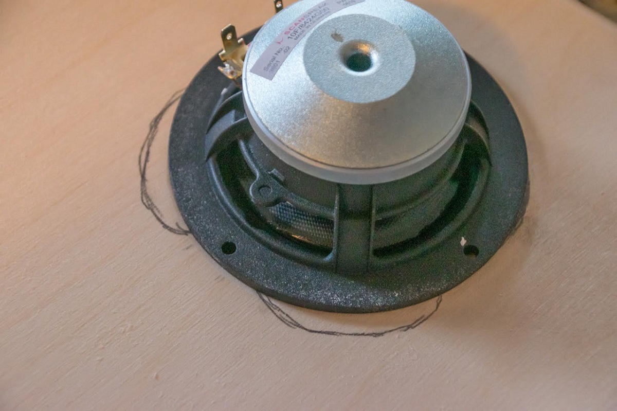

Cutting holes for the driver and adding round overs on the backside for good air flow:

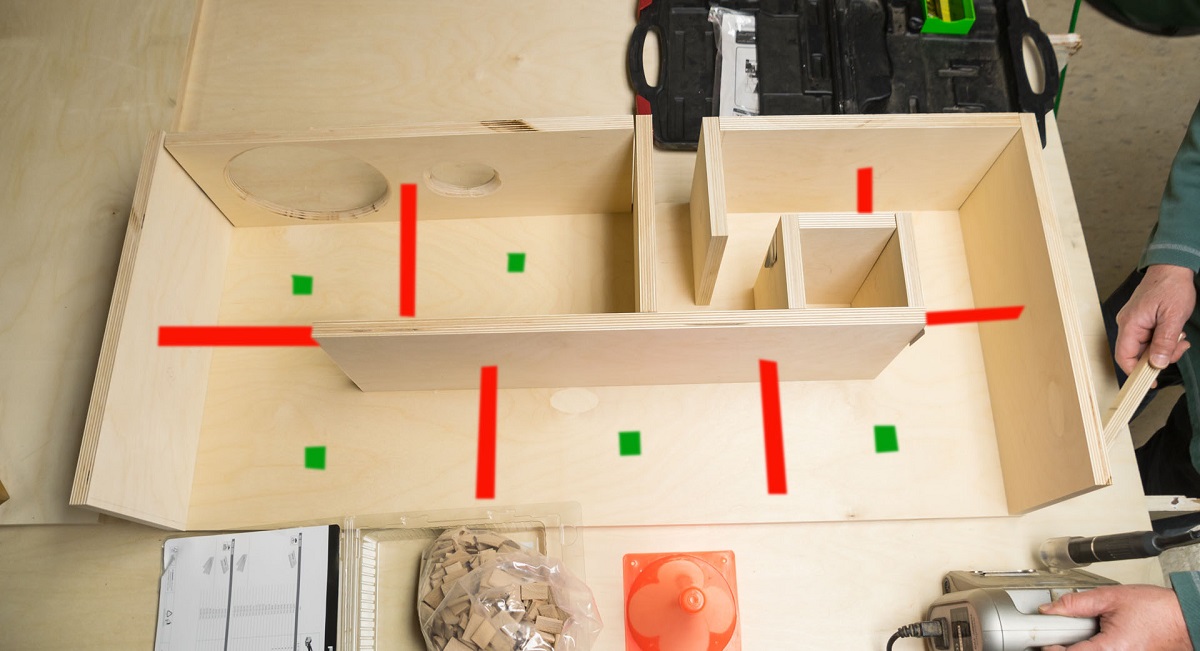

Bracing plan:
attachment.php

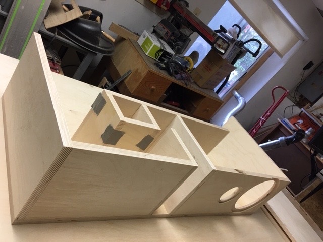

Dryfit test:
attachment.php
We are about ready for gluing up the first one today.

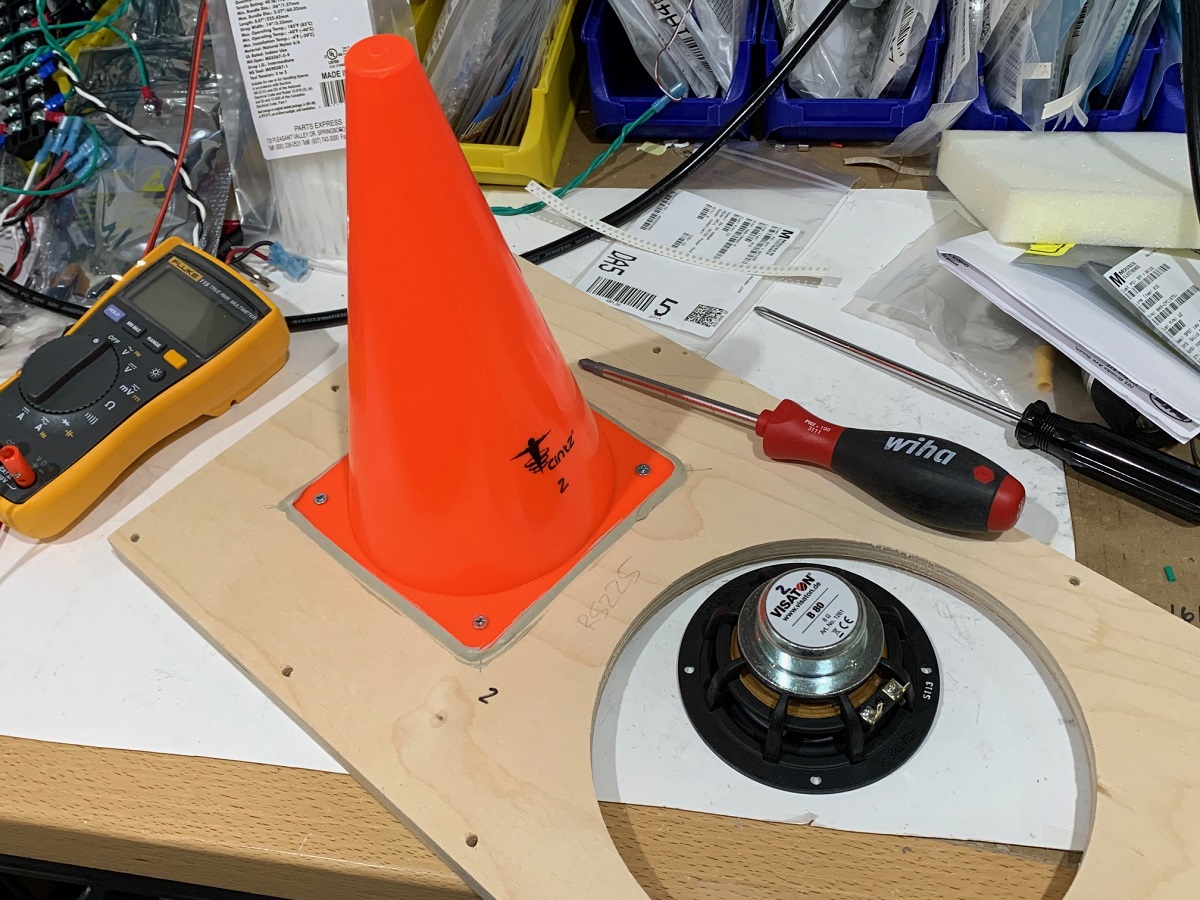

After getting some motivation from Zman01 on his impending B80/RS225 build, I decided to get cracking on mine. I have had these baffles cutout for almost 2 years now. Finally got around to gluing the sports cone to the baffle for the Dagger rear chamber. I used Loctite PL500 adhesive and 4 wood screws. I will test it out with the stock crossover with maybe less padding and see how it works out.
