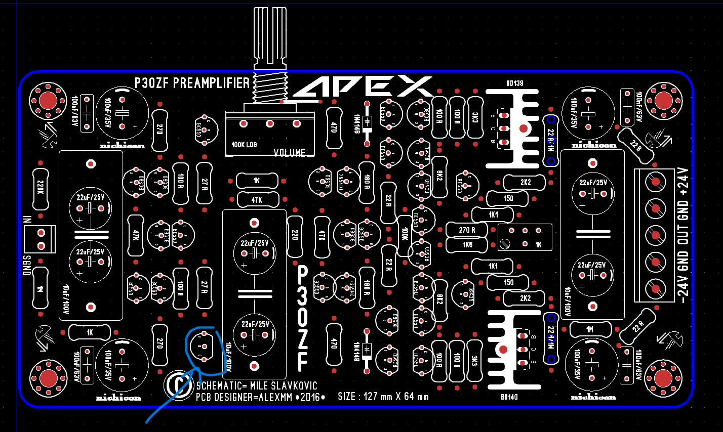

I finished my P30ZF yesterday in the late evening. Not heard yet.

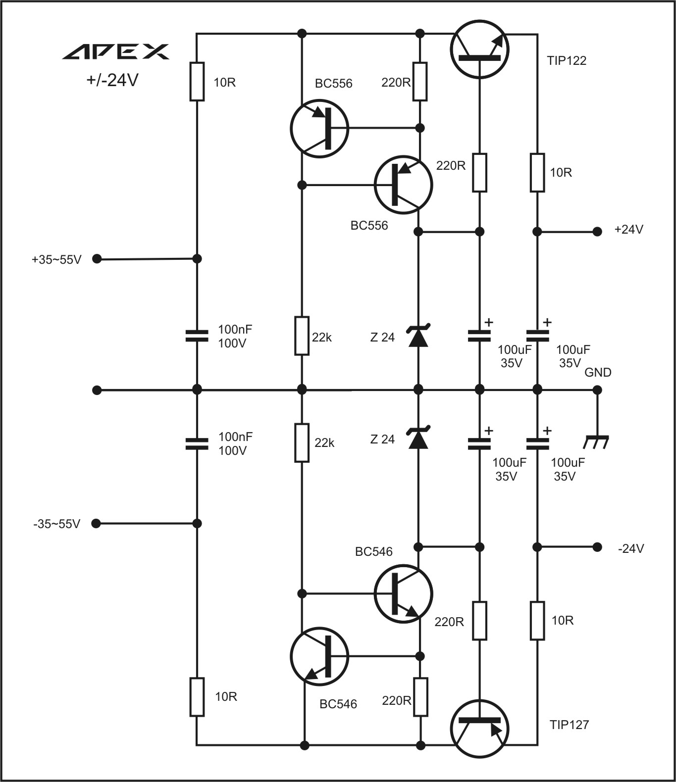

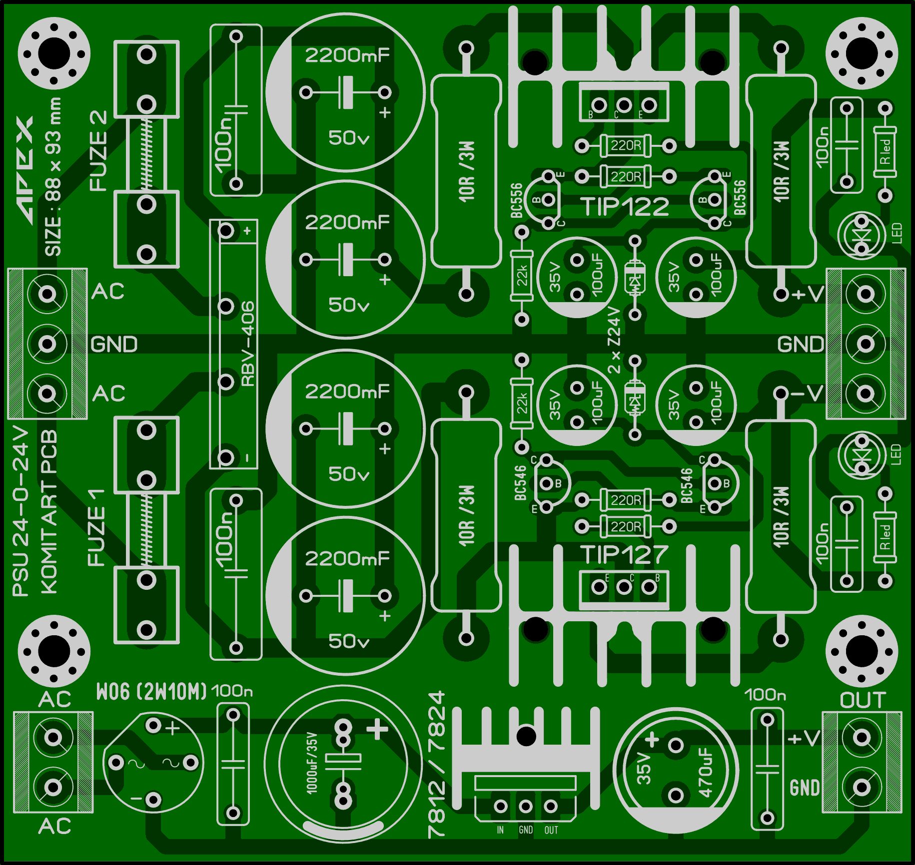

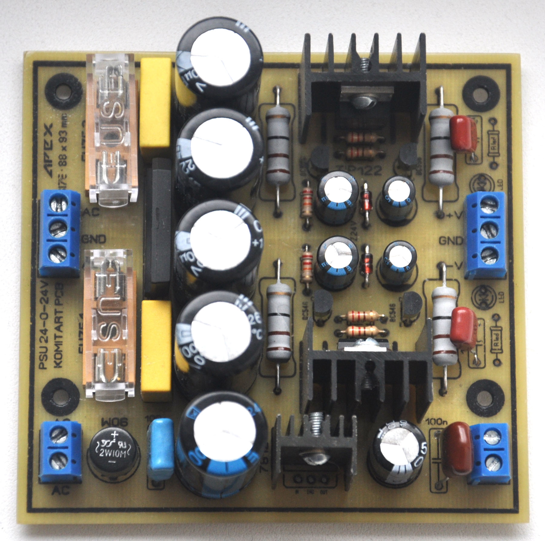

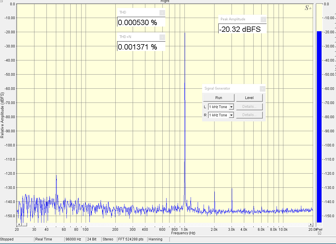

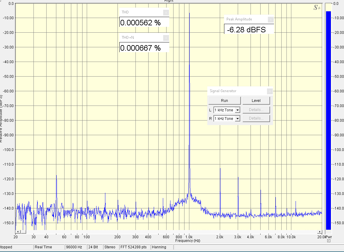

Dont know if a delay with relais is necessary, i built it in. The supply i an old one, which was build for an headphone amp in the past. The regulators are adjustet to +-24 Volt. The R-core delivers 2x18 Volt, 1 A.
I first had a little trouble with the BD140 on one channel. After 5 minutes the heatsink became very hot. I tried to find out some mistake, found none. The values are all ok, the transistors are soldered in on their right place. Changed the BD140 and one BC560 on the negative rail...the mistake was remaining.
I soldered a new board and all seems fine , only a little heat now.

Do you mean the problem with the heating BD140 wents away connecting the P30Zf to an amp ?
Too late..made a new soldering on a PCB 🙂
You must test preamp with amp connect to output, amp input impedance load preamp with 22k... P30ZF DC offset is very good for circuit without global negative feedback.
