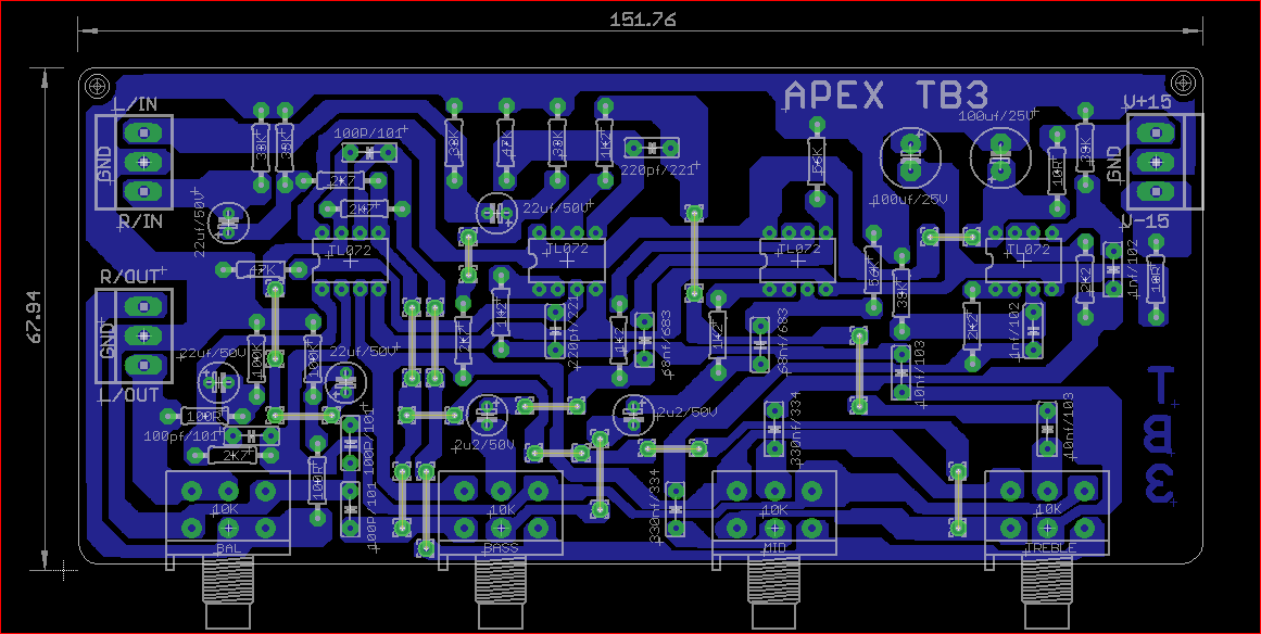

HI All,
Can someone give me the TB3 tone control (3 channel) BOM.🙂
see schematic #13,556.
many thanks,
Marco.

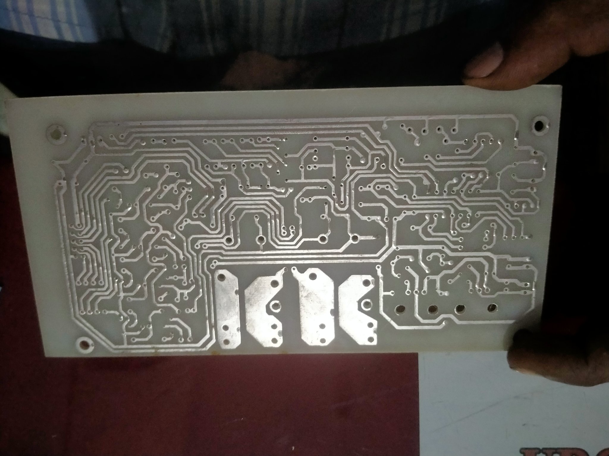

Looks pretty similar to Evens Audio Speaker Protector PT-230A .View attachment 1217676i found this protection pcb in old box but i dont have top parts layout....pls help me if anybody recognise this pcb please post its top parts layout...
Thank you

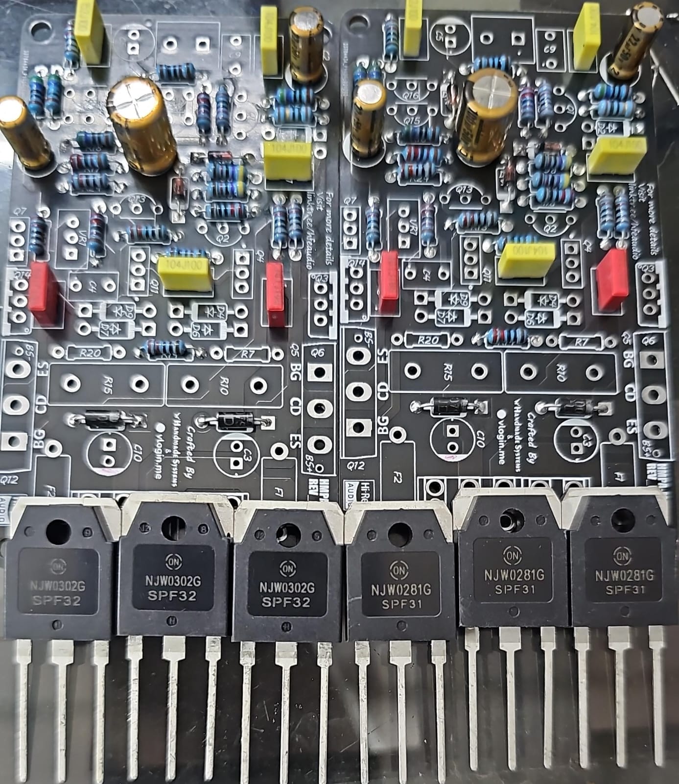

I am getting only 14 vrms @4r from my ax14 with two pair output transistors while using a 26 0 26 ( supposed to be 5 A ) transformer . is it normal ? what should be the transformer spec to get 80 to 120w or higher wattage without compromising safety and stability?
You will need a 35-40 Vac (dual or center tap) transformer. Will get you about 50-55 Vdc and provide close to 100 watts at 8- ohm. If you are asking about 4-ohm load, then step down to a 30-35 Vac toroidal. You are currently getting about 45% efficiency from your PSU, may need to increase capacitance or most likely go to a 7-10A transformer for that current load.
Wow, there is a lot here. I'm looking to make an amp for a pair of Apogee Stages, which can take a max of 20v and 50w and they're 3 ohms.
Is there a particular variant of this amp that would suit them?
I would look for the AX14 (2-pr BJTs) or the FH11/12 (2-pr mosfet) - with 3-ohm load you will need 2-pr, even with low voltage. Assuming 60% efficiency, the AX-14 should provide right at 50w, with the voltage drop of mosfets, the FH11/12 will likely provide closer to 40w at your 3-ohm load. I have built both and the mosfet has better low-end, but also a warmer midrange. IMO, I would go with the AX14 since there are proven easy to find PCBs and IMO easier to build and fault find if you have an issue. YMMV
AX14 it is! Are there any preferred PCB houses I can go too that might already have the PCB on file?
