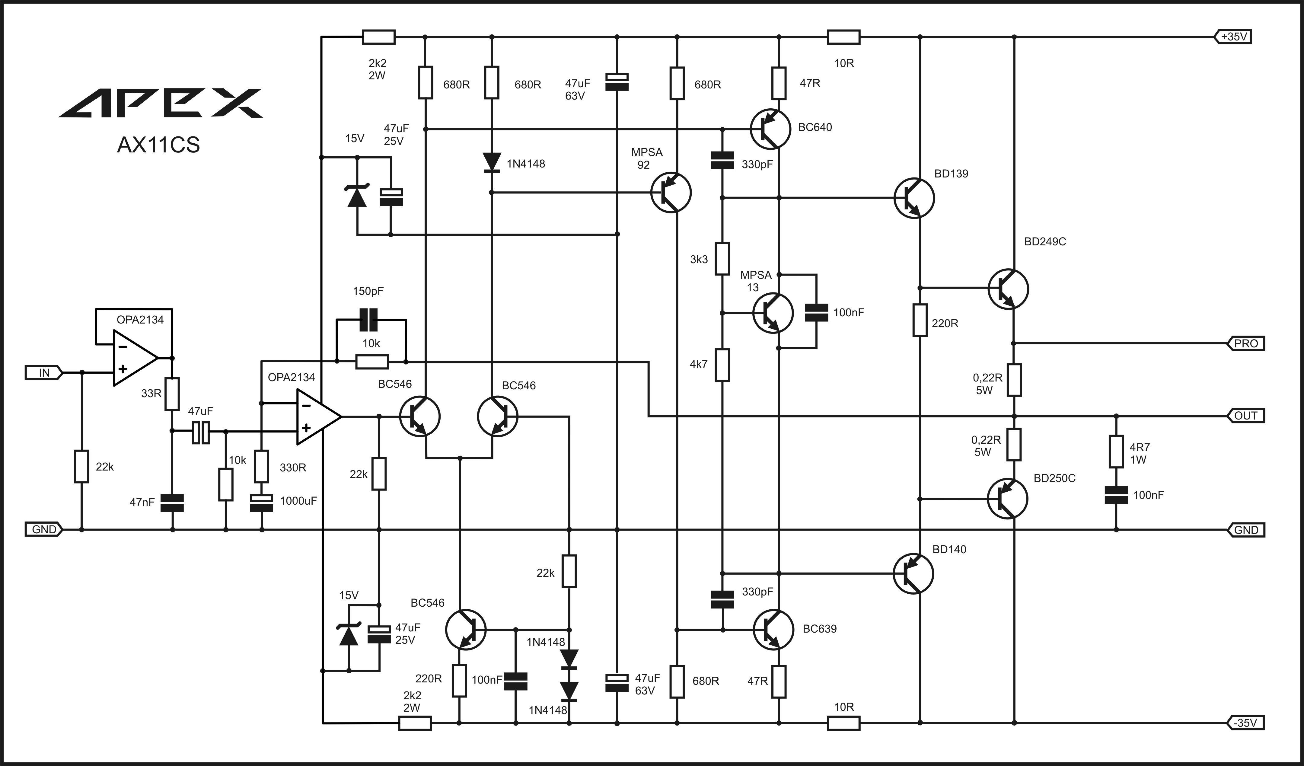

Hello sir Mile , what is meaning of CS in a AX11CS.
CS mean current source or something else.
And what is advantage with dual OP-AMP. Please explain.
Regards
CS mean Composite power amplifier.
Dual stage would be more precise...
Anyway, the first opamp is a voltage follower, meaning it gives at it's output the same voltage as it's input, just at a lower impedance.
To put it shortly, it lowers the impedance of the source signal.
I am not quite sure why there would even be such a requirement, 10k is a reasonable load for any signal source.
PS: I do not know if it was intended so or not, but the voltage spread of the VBE multiplier is way down, even for class B.
Voltage follower yes, active filter no!
The 100khz filter part is all passive, a simple RC filter after the follower.

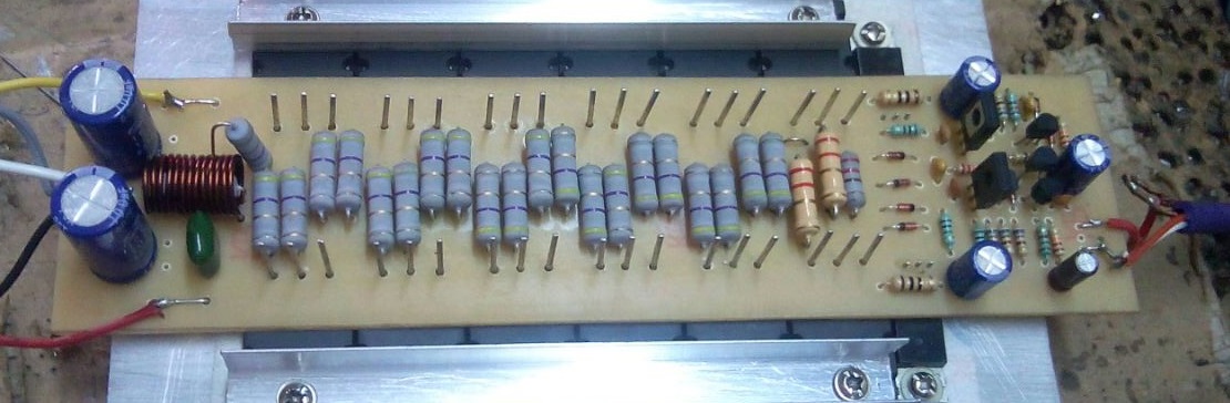

Layout for Apex BX20. I'll make one more version of BX20.
How did the amplifier turn out?
Are there any finished pics somewhere?

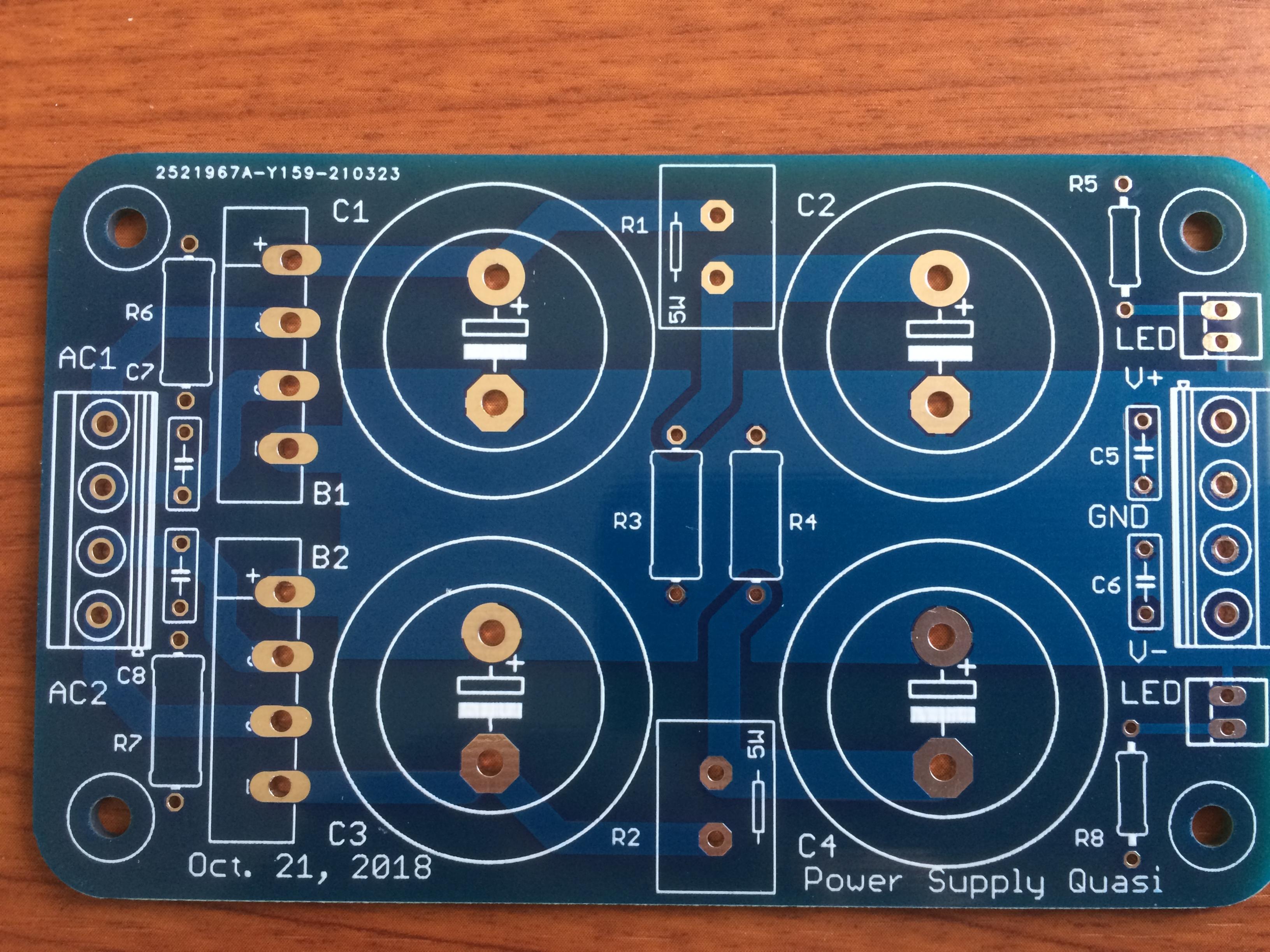

Power Supply Quasi
Hi Quasi
I have a few questions about the psu in the picture,
Technical Data:
It will be used in Class A amp circuit. (hiraga le monstre)
Capacitor: 4 * 22000mf 16v
Ac Input: 0-10 / 0-10 VAC
According to these data, what should be the resistance values of R1, R2, R3, R4, R6, R7.
