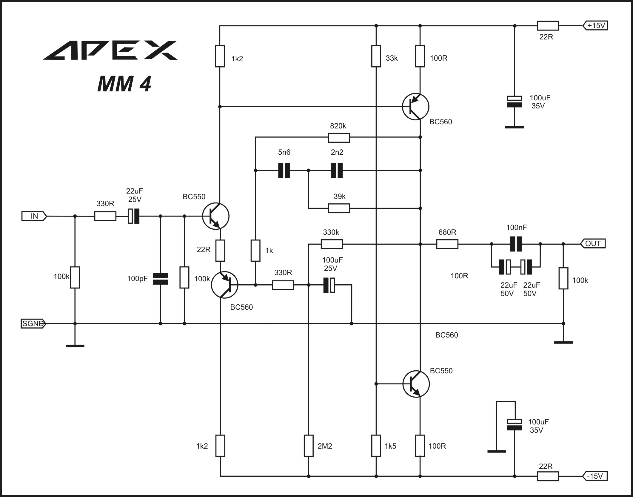

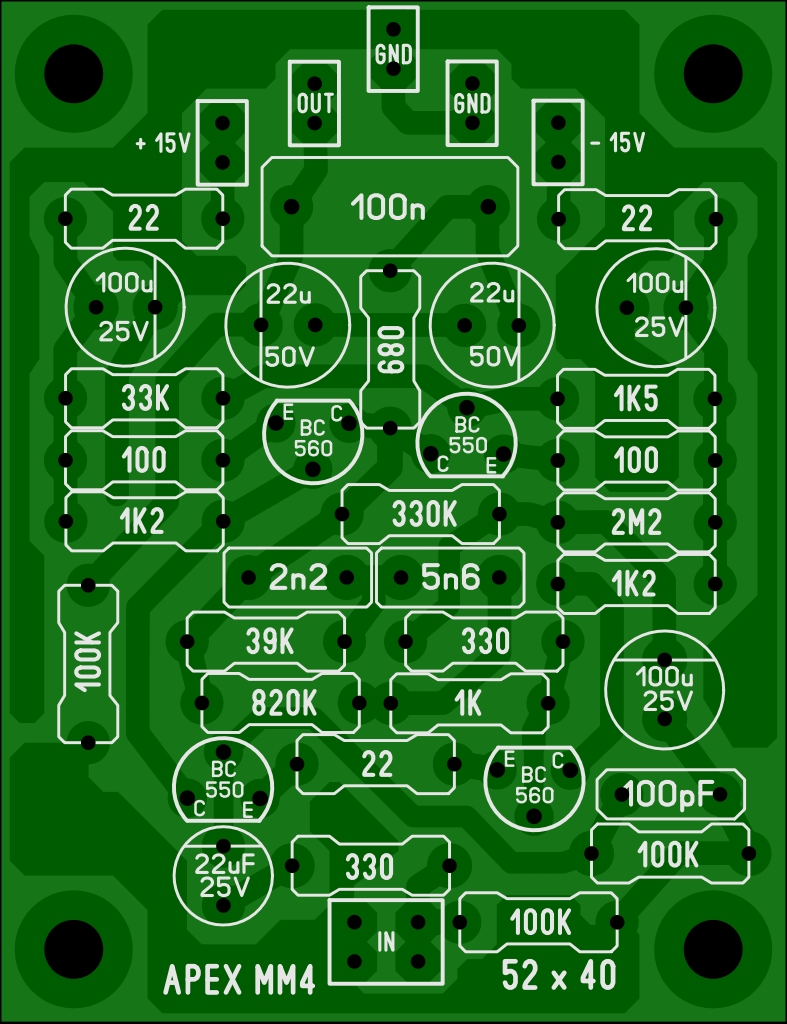

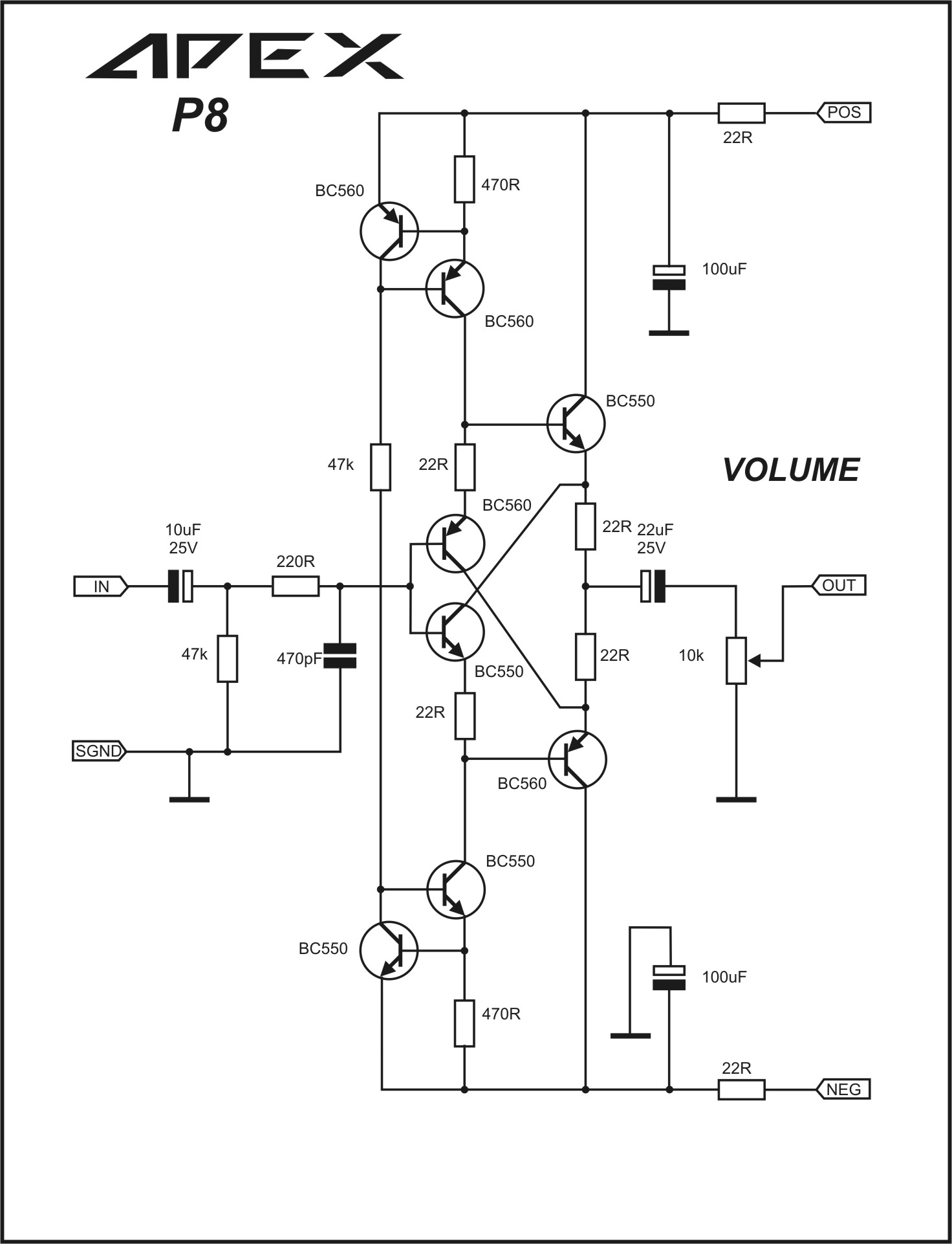

Hi, Guys!
What changes should I make to this circuit when powered by +/-15V rail voltage?
Change the 47kohm to 33kohm.

What transistors are replacements for BC550 and BC560? many used for Apex, One P30Z has 13 of each.
BC546, BC547, BC548
BC556, BC557, BC558
each Apex MM is - "moving magnet" and MC - "moving coil", depending of phono pick-up.
Thanks!

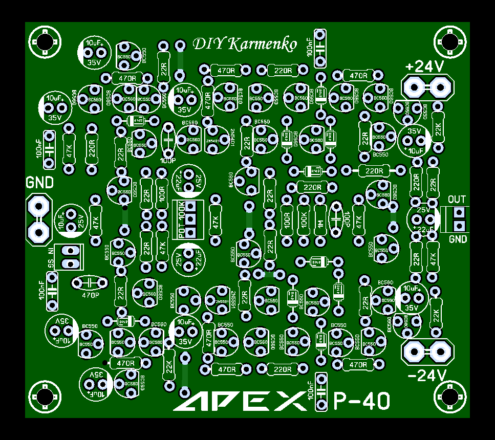

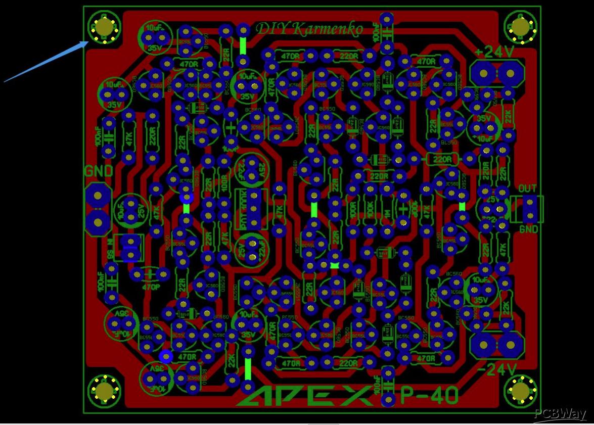

Apex P40 The correction lacked a couple of pins
Looks like the holes are not aligned. Trying to buy some PCB's for PCB Way and it failed the audit.. Hope you can help. Thanks for sharing.
BC546, BC547, BC548
BC556, BC557, BC558
I'm know aware that they're all on the same data sheet.. Thanks!
Joel if it's those extra "small" holes by the mounting holes. Just delete the smaller holes. They appear completely cosmetic. Or replace them with a single 3.2mm hole
Thanks Vostro. I deleted that drill file and all is good.. One day I'll learn Gerber modification, just viewing them at this stage!

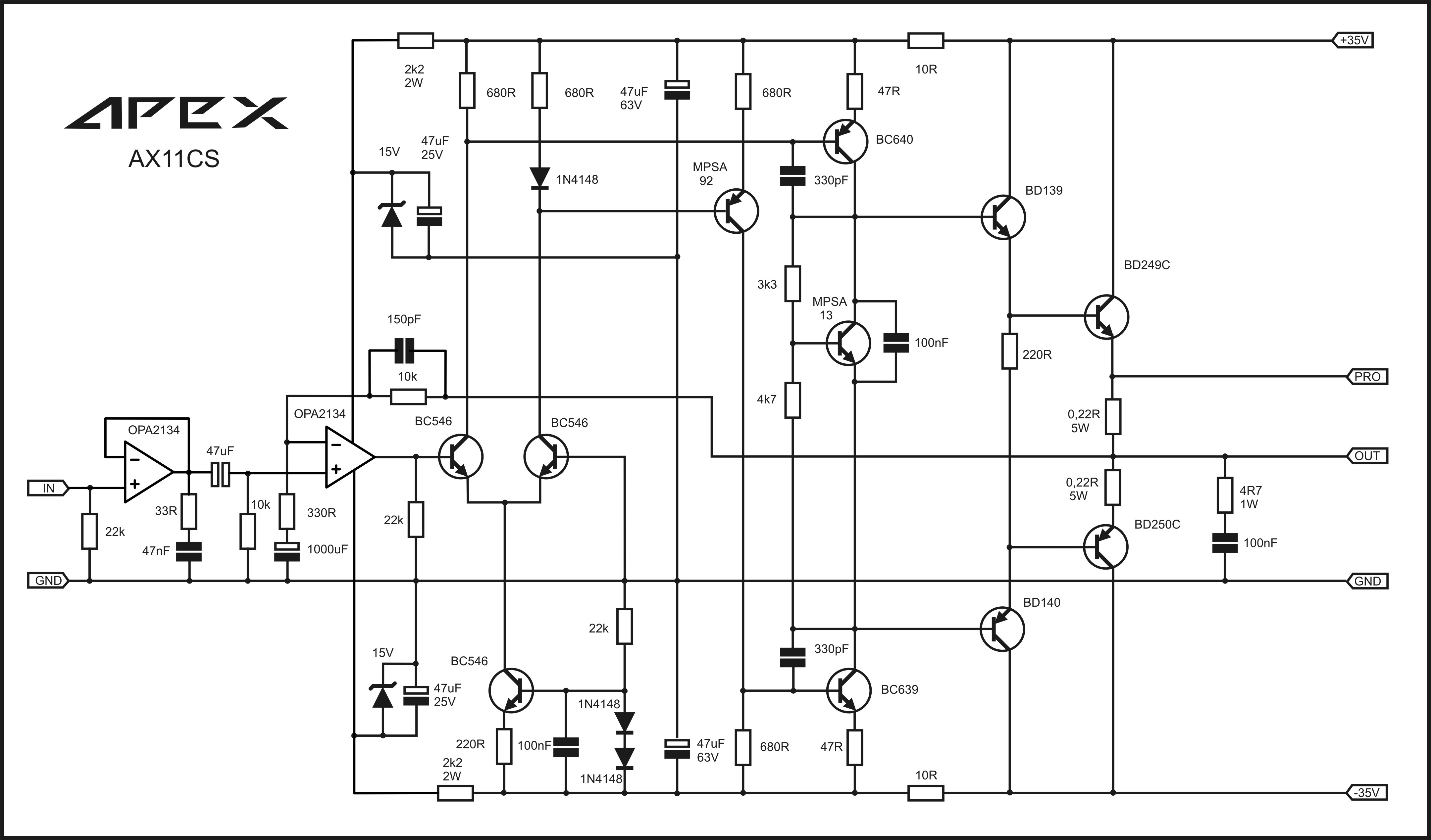

Hello sir Mile , what is meaning of CS in a AX11CS.
CS mean current source or something else.
And what is advantage with dual OP-AMP. Please explain.
Regards
